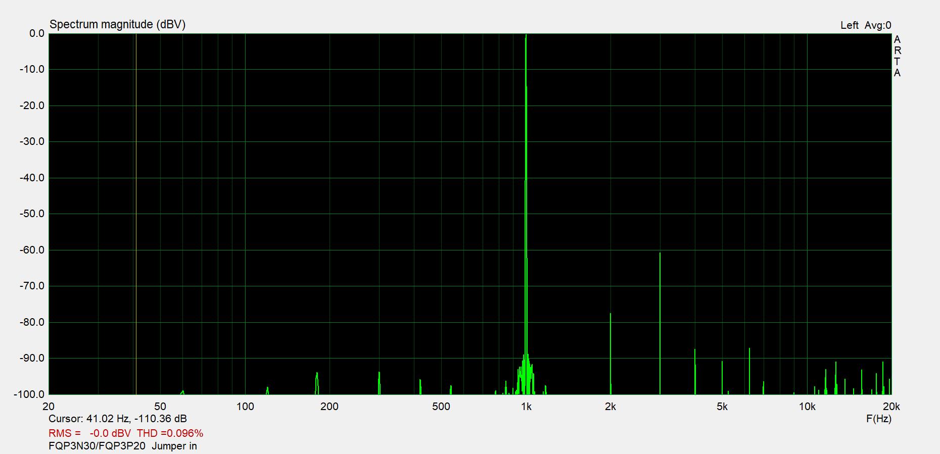

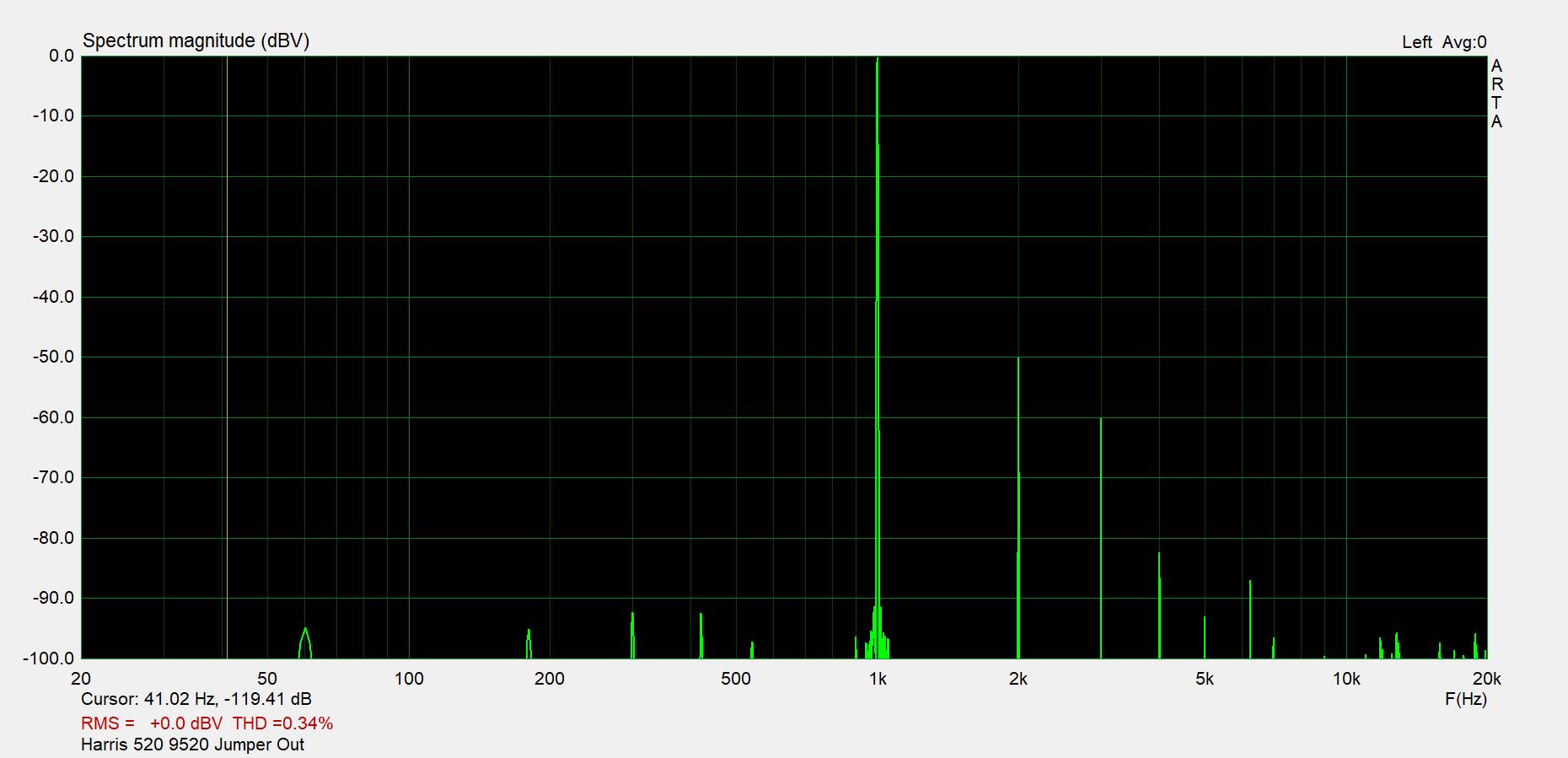

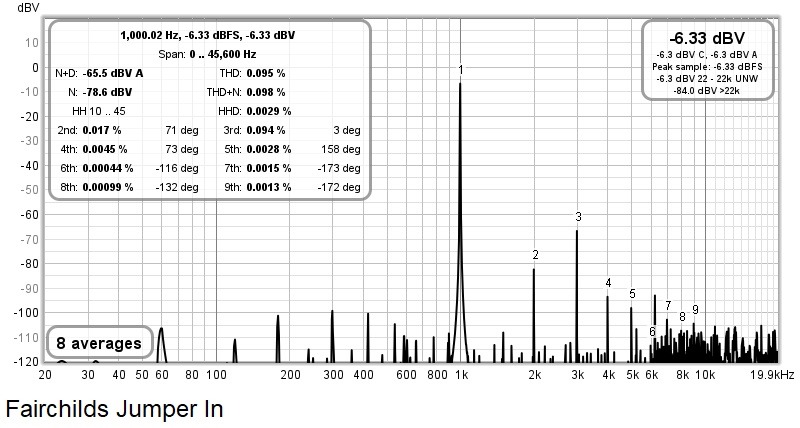

Great Kevin !Just for kicks I put some FQP3P20/FQP2N30 in an ACA Mini. It biases up just fine, but the pots are set closer to the end of their travel (almost fully clockwise). I have not listened yet. I have a second ACA Mini with the Harris 520/9520 to compare. Should be interesting.

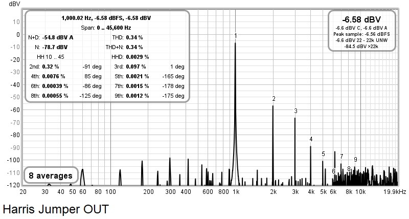

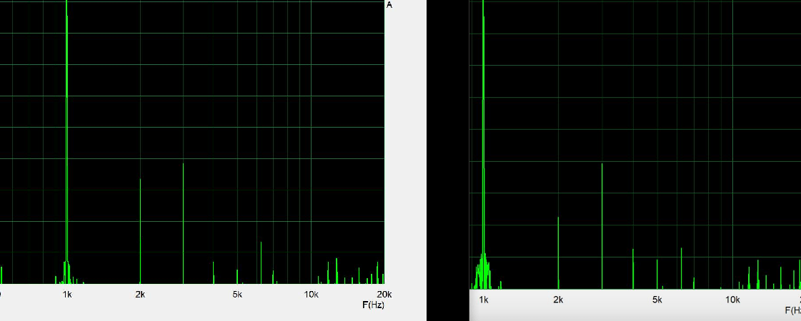

Here's what 1 watt output looks like on the spectrum analyzer:
View attachment 1109378View attachment 1109379

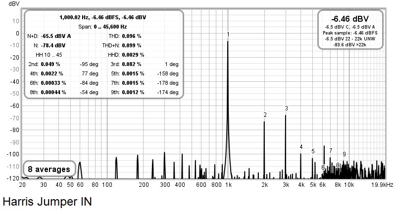

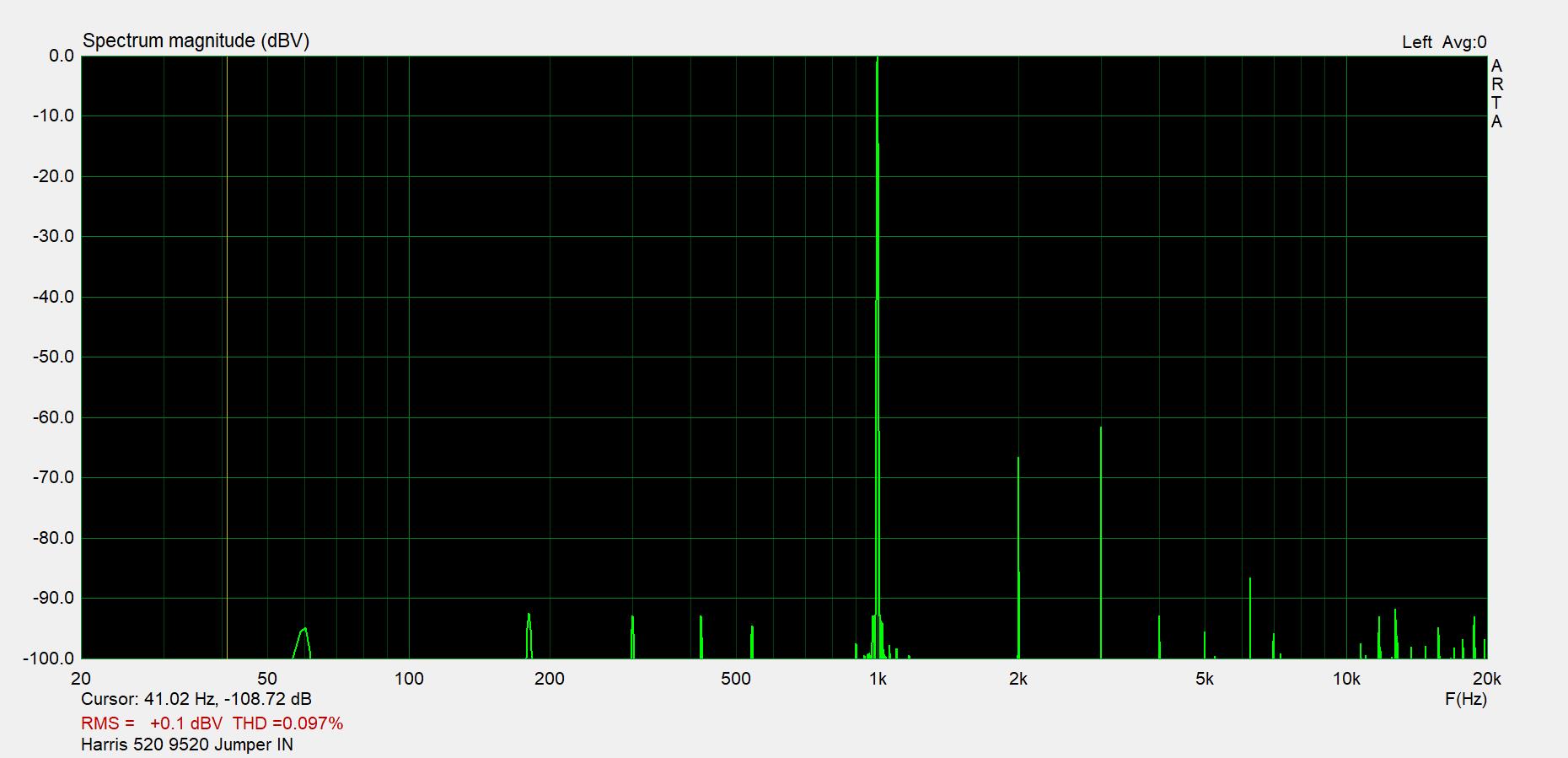

For comparison with matched Harris 520/9520 as output transistors:
I listened to the ACA Mini with the Fairchilds in it yesterday...it sounds amazing. I have not compared it to the amp with the Harris outputs side by side...yet. I'm not sure how much of the enjoyment I had listening yesterday was due to the Fairchilds, or I was just stunned by it's sound since I haven't listened to the ACA Mini in a while. I ordered another Meanwell PS so I can keep both amps warm while switching back and forth.
I was able to spend some time with both amps today. I thought the difference would be very subtle and I would have to "hot swap" them in order to hear that...I was wrong. To my ears the difference is not subtle and i prefer the ACA mini with the Fairchilds (jumper or no jumper) by a wide margin. It's like everything just snapped into focus.

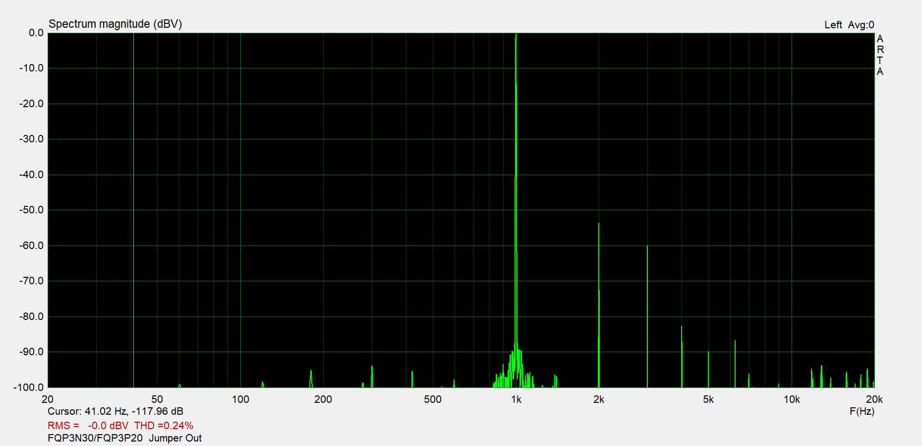

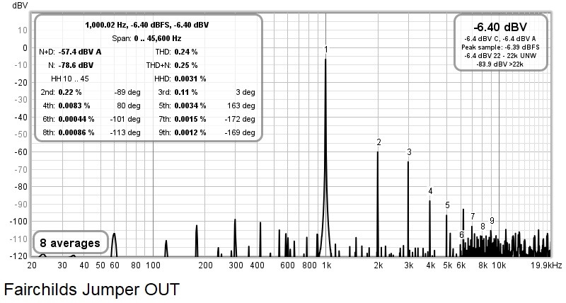

Hi Kevin,
In your post #1402, the graph on the right seems to be that of for Fairchild jumper-out.
Can you please post the Harris jumper-out one for comparison?
Thanks,
Dennis
Thanks,
Dennis
Och you are rigth there isnt Harris jumper-outHi Kevin,
Thanks,
Dennis
my 1403/06 post are wrong
Good catch Dennis...I grabbed the wrong file while attaching in that post.Hi Kevin,
Thanks,
Dennis
I'll make a clean post of all four graphs side by side.

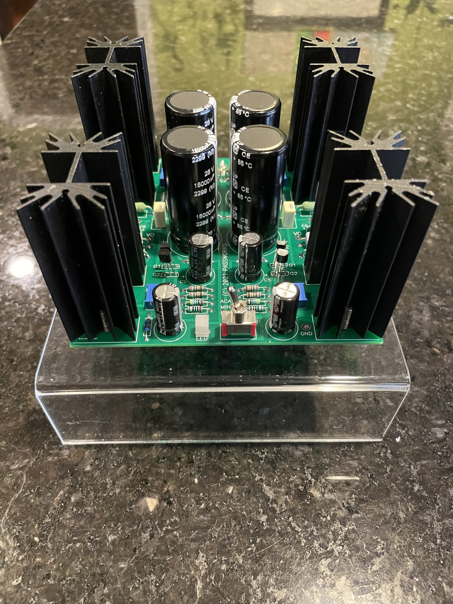

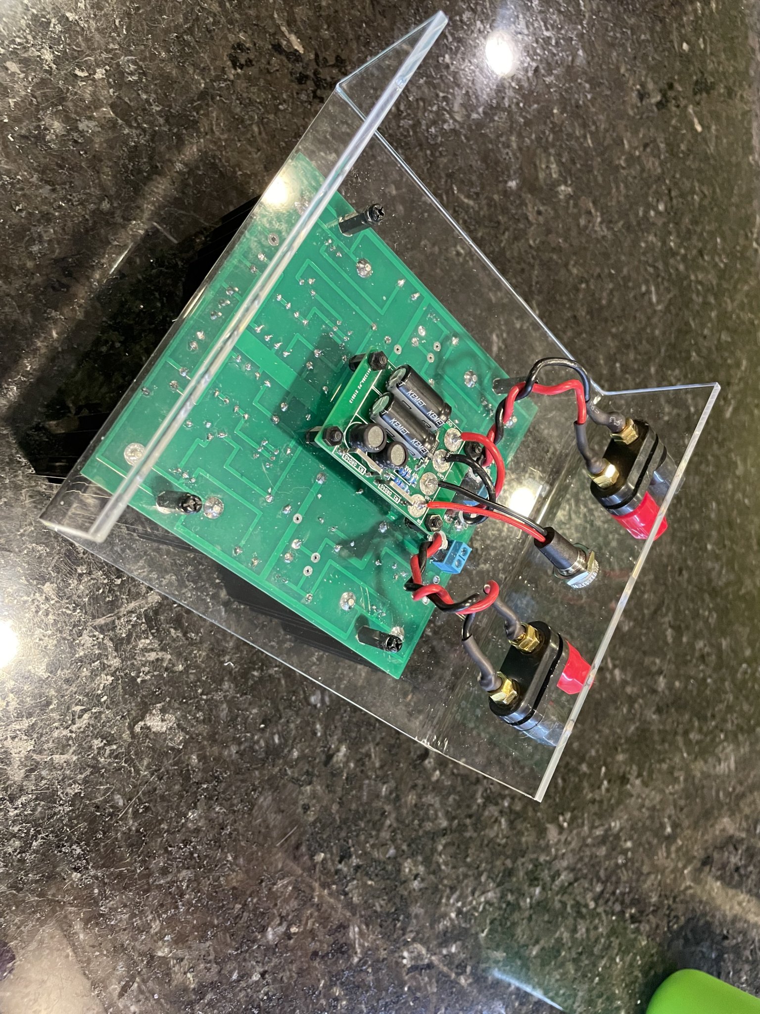

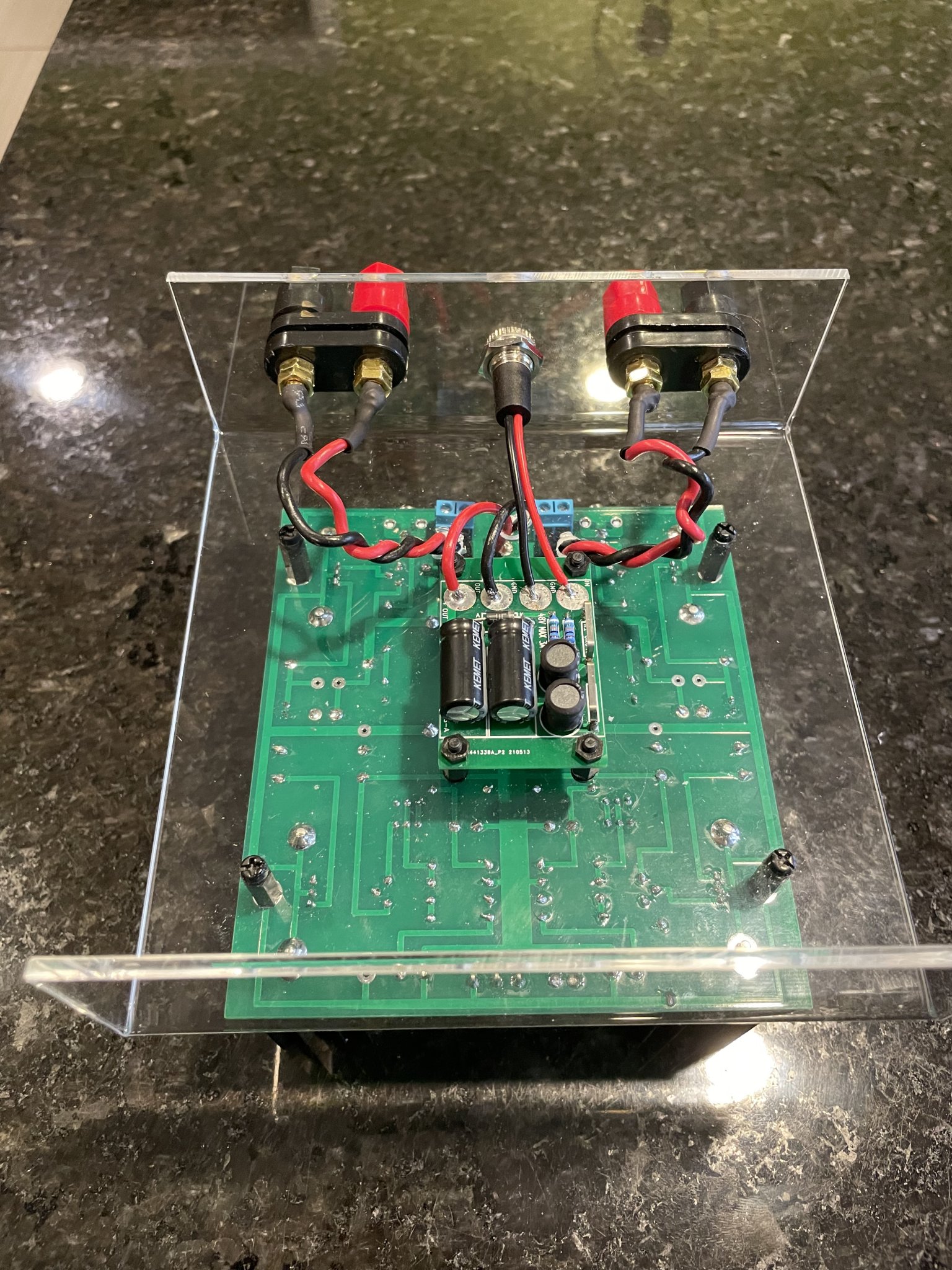

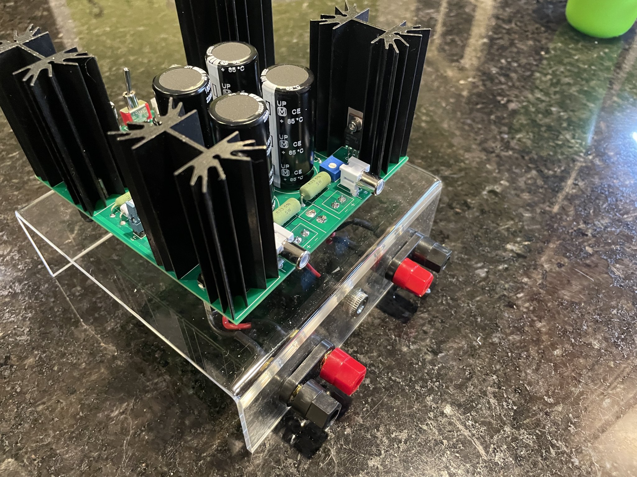

I added Mark’s filter and modernized the chassis. For those of you with access to The Container Store, this is a $10 6x6x2 acrylic riser.
Lovely build @rhthatcher !!
Looks like there's plenty of room under there to install several SMPS filter boards, for those who prefer to kill a mosquito with a bazooka. SMPS --> filter PCB #1 --> filter PCB #2 --> . . . . --> ACA Mini power-in terminals

Thanks Mark!
