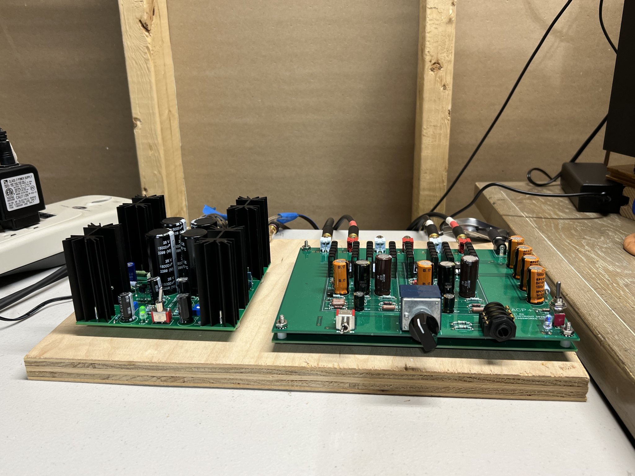

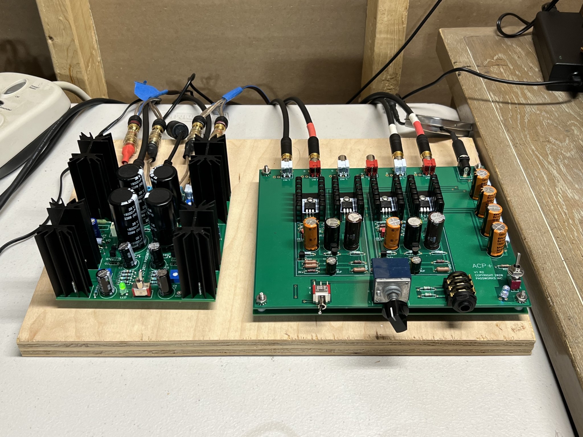

What a great pair. I’m loving how this combination sounds.
I’m using it with miro’s AD1862 DAC, Sony SS-CS5 speakers, and a Yamaha sub in a desktop setup.
I was using an Aiyima A07 amp with LM4562 opamps and the ACP+. The ACA mini just blows it away for me, i.e. more personal musical enjoyment.

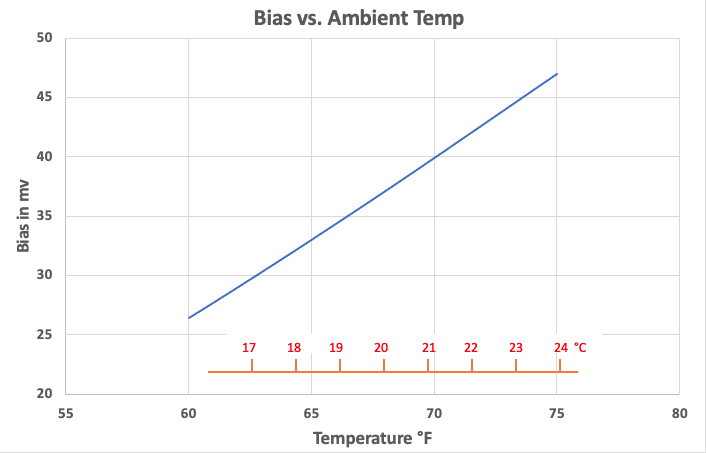

With the seasonal change in temperatures in my part of the world, I was able to capture how the bias voltage on the ACA Mini varies with room temperature. The plot below shows how, for one constant setting of the potentiometers, the bias changes as a function of ambient T. Measurements were only made at 3 temperatures (62°F, 65°F, and 69°F), but extrapolated a bit, assuming linear behavior.
The variation is not minor, and as Nelson Pass indicated earlier, bias is best set for the expected room temperature. It seems to me that that the need for seasonal adjustment should be anticipated.
Providing this with the hope that it is useful to others.

^. Thanks for sharing! 🙂. Wonderful stuff. A ~33% measured increase from 62F (~30mV) to 69F (~40mV) is notable.
- Note - bias current units would be mA vs. mV. I assume your measurements noted on the chart were the DC voltages measured between the two pads labeled VB. If so, I think your bias current would be those measurements / 0R75. Not particularly relevant, and it doesn't diminish your work. Just an observation.
Edited to correct my sloppy math. 😉. Too early and not enough coffee.
  • Thank You
Reactions: northpaw
Yes, I gave the bias values as mV across the Vb pads, as that is the way Pass intended bias to be monitored, and yes that corresponds to across R8 (0R75). Obviously a lot easier to measure that voltage than opening a connection to insert an ammeter.
The actual values were 29mV at 62°, 33mV at 65°, 38.5mV at 69°. Vo varied from 11.55V to 11.53V to 11.49V, respectively.
The bias at 69° was higher than I intended to run the ACA Mini at. It happened when our outside temps in southern New England rose to over 70° a couple of days ago, and the heat sinks felt hot, prompting me to check the bias. I also measured the temp of the sinks then, and they were at 50.3°C. I left all the settings alone, as I knew it was going to cool off the next day (and stay that way until Spring), and everything was behaving stably. In the heating season, the room varies between 62° (night) and 65° (day).
