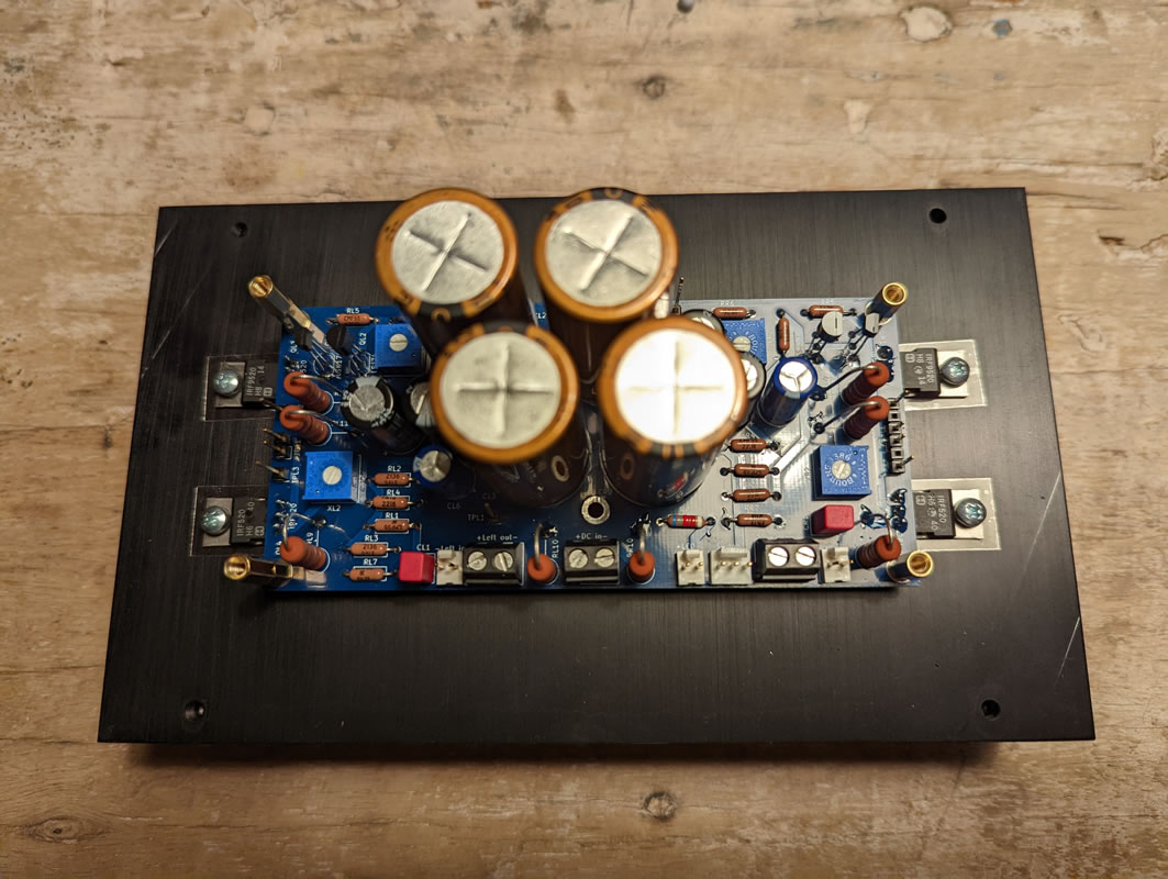

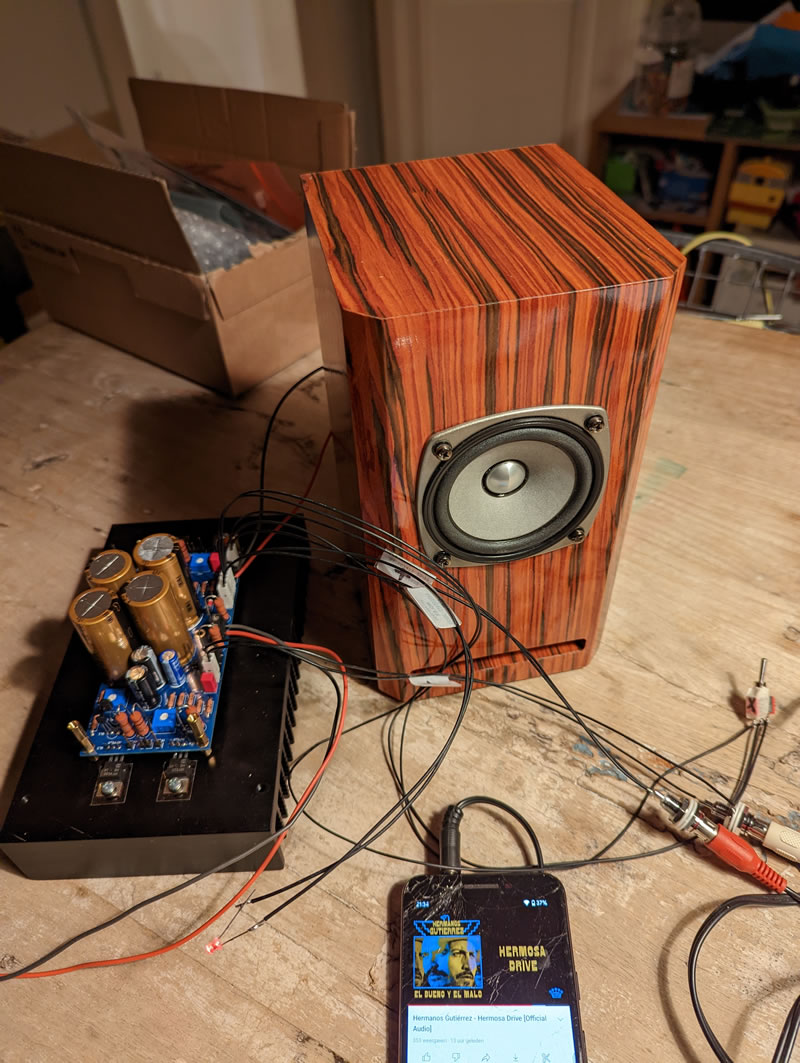

My version of the Mini is up & running and playing music 🙂 Big thanks Mr. Pass & everyone involved in making this fun and cool project available to all of us!

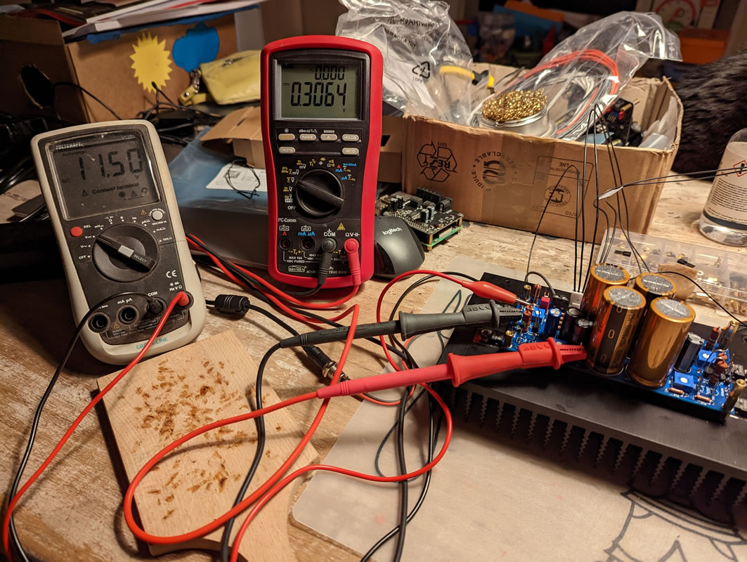

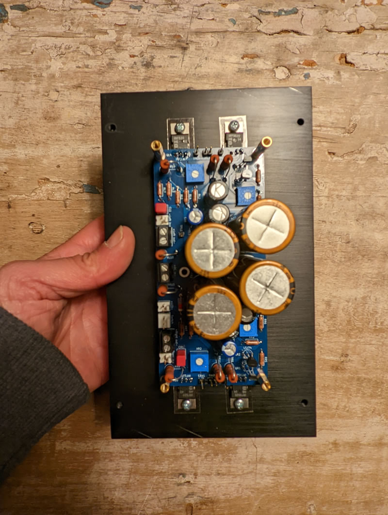

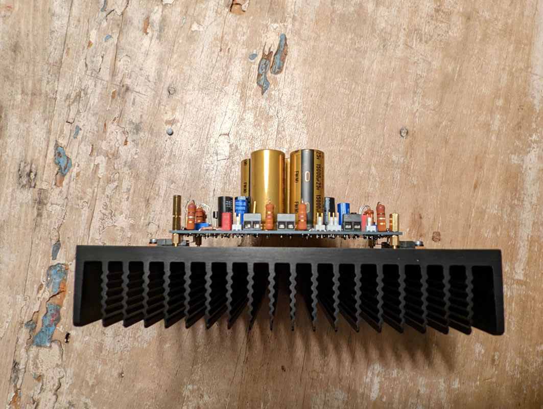

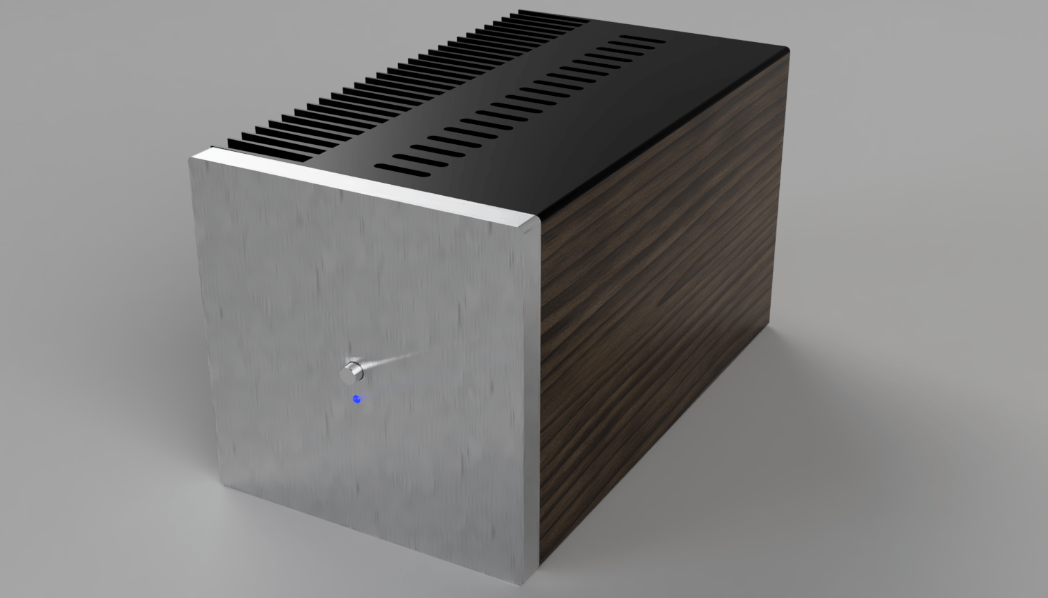

I always like to customize so I made my own pcb that can be fixed to a single bigger heatsink. Plan is to put it in a square(ish) case to protect it from the small kids and cats that are never far away...
If anybody wants the kicad files and/or gerbers, let me know, happy to share them

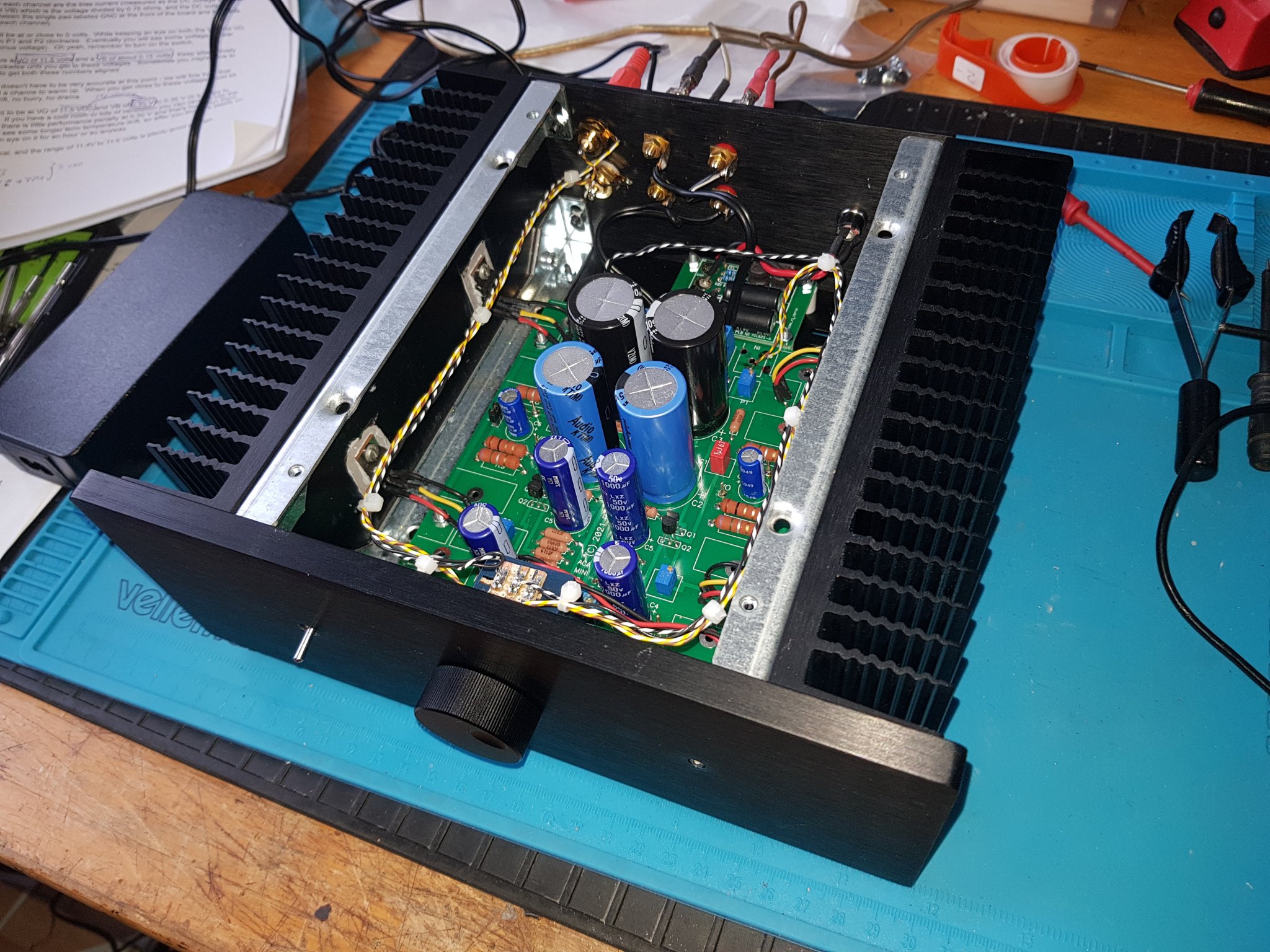

I am also building an ACA mini with quite big heatsinks. The enclosure is a Mini Dissipante.
With V0 11,5 and VB 0,3 VDC the heatsinks dont get hot. What would be the upper limit for VB without destroying the FET's?

In this build I inserted a 100k potentiometer as it was available on my private stockLooking great what value of volume pot did you use in your build!
In another version, built before, I have a 25k

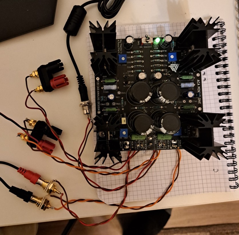

What a nice little toy - never ever I have built an amp so quickly 🙂 Not yet integrated into a frame, but already usable 😉
The board is by @jimk04, parts are from the official Completion Kit, the "a little bit too expensive" matched JFETs from the store, and Vishay MOSFETs.
The assembly and adjustment is incredibly easy - also thanks to the great (as always) guide by @6L6.
Big thank you to Papa!

The bias stabilizes pretty quickly due to the small sinks, being a short time constant. 20 minutes or so.
You can bias it pretty high if you want, as long as you can put your hand on the sinks...

My intention was to build an ACA mini with a very long life expectation: big heatsinks and 35V filter caps.
