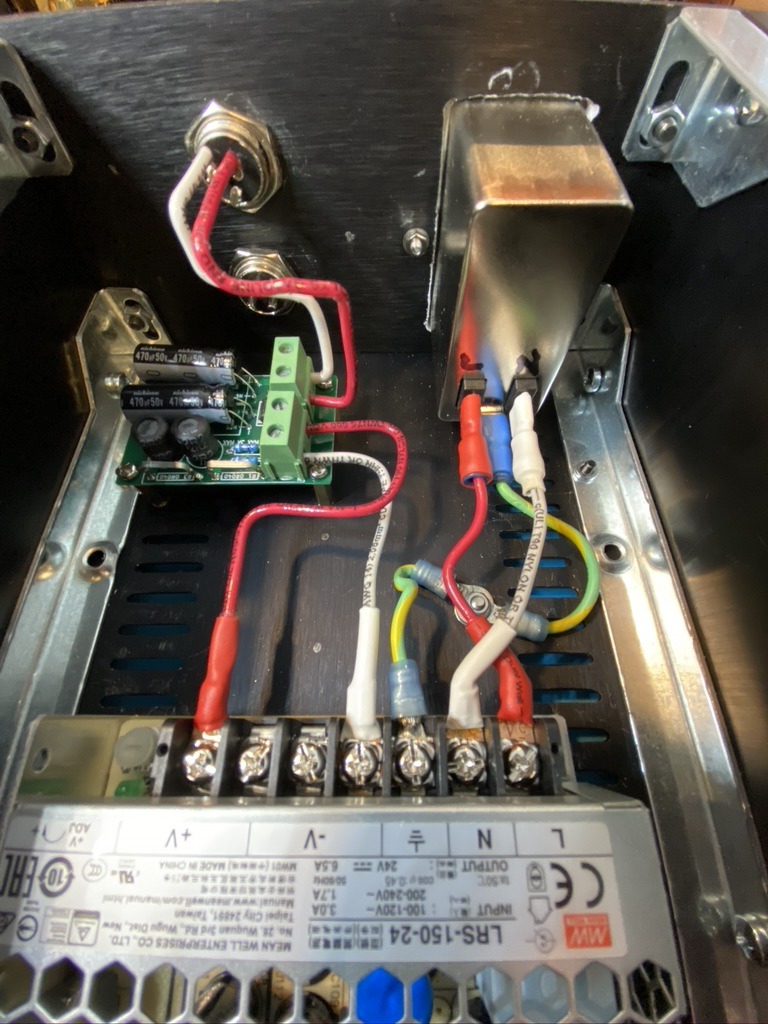

Different switchers have different capabilities to push through capacitive loads. Some put their max capacitance on their data sheets, while some do not. The P089ZB has a (very-low ESR) cap that is added to the circuit providing 24V to the Mini. Being a capacitor, its adding capacitance to the circuit. 😉 YMMV, but adding extra capacitance could tip any switcher into its capacitive problem zone, which usually manifests itself in tripping its short-circuit/reset or "hiccup" mode. Most switchers have a way to indicate this by flashing its power on light or some other LED.nicoch58 are you using the smaller supply with the P089ZB? When I use the smaller supply that comes with the completion kit without P089ZB I have seen the startup problem every time I forgot to turn the bias switch off before applying power. Every time .... no exceptions. Can the P089ZB affect that? I don't think so. Have you seen the ACA Mini turn on characteristics change when using the smaller PS with vs. without the P089ZB?
I am personally powering my ACA Mini with a bigger meanwell (LRS-150-24) through the P089ZB (see attached) and it starts up just fine. You can check out the spec here: https://www.mouser.com/datasheet/2/260/mwec_s_a0011714497_1-2274579.pdf

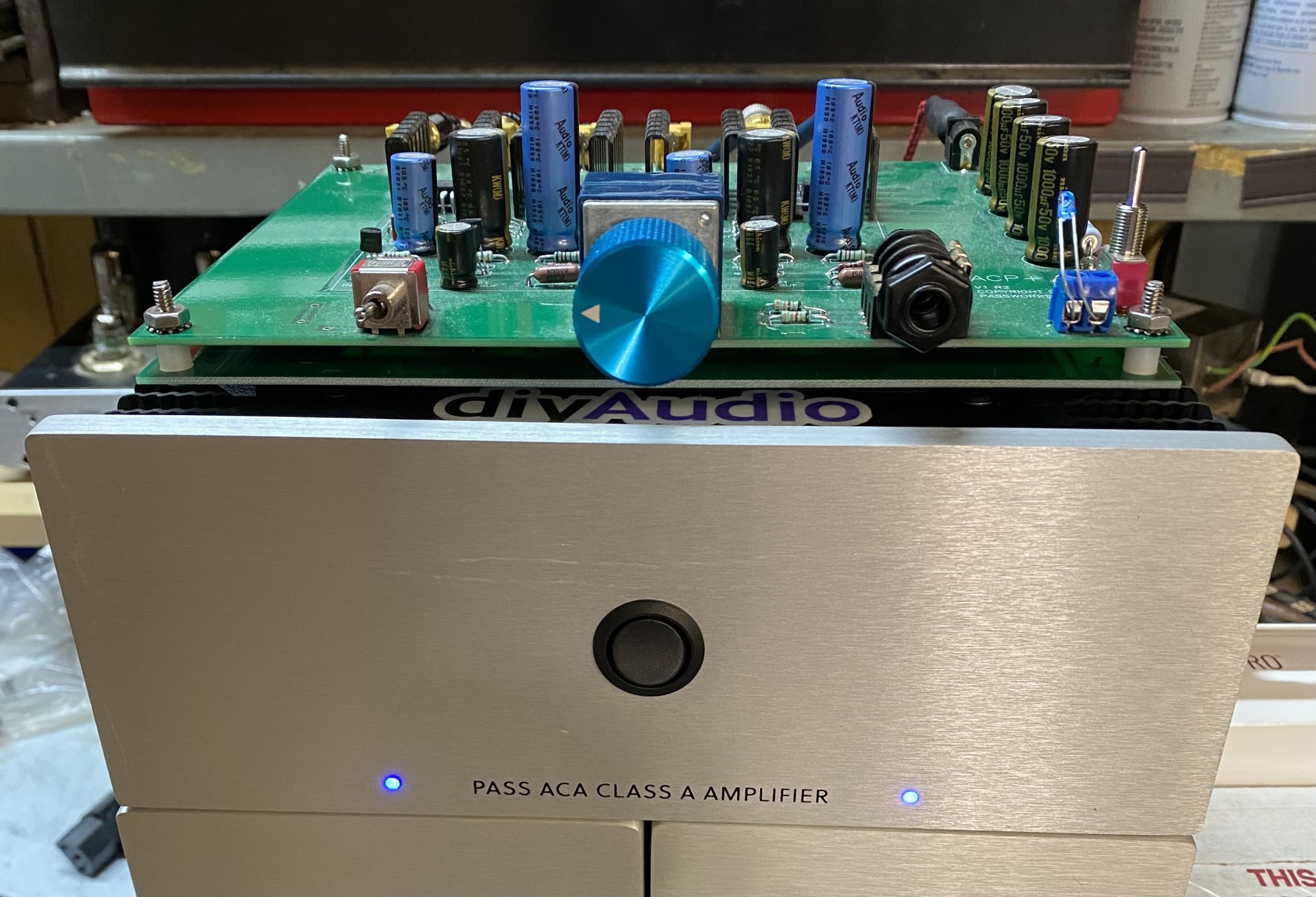

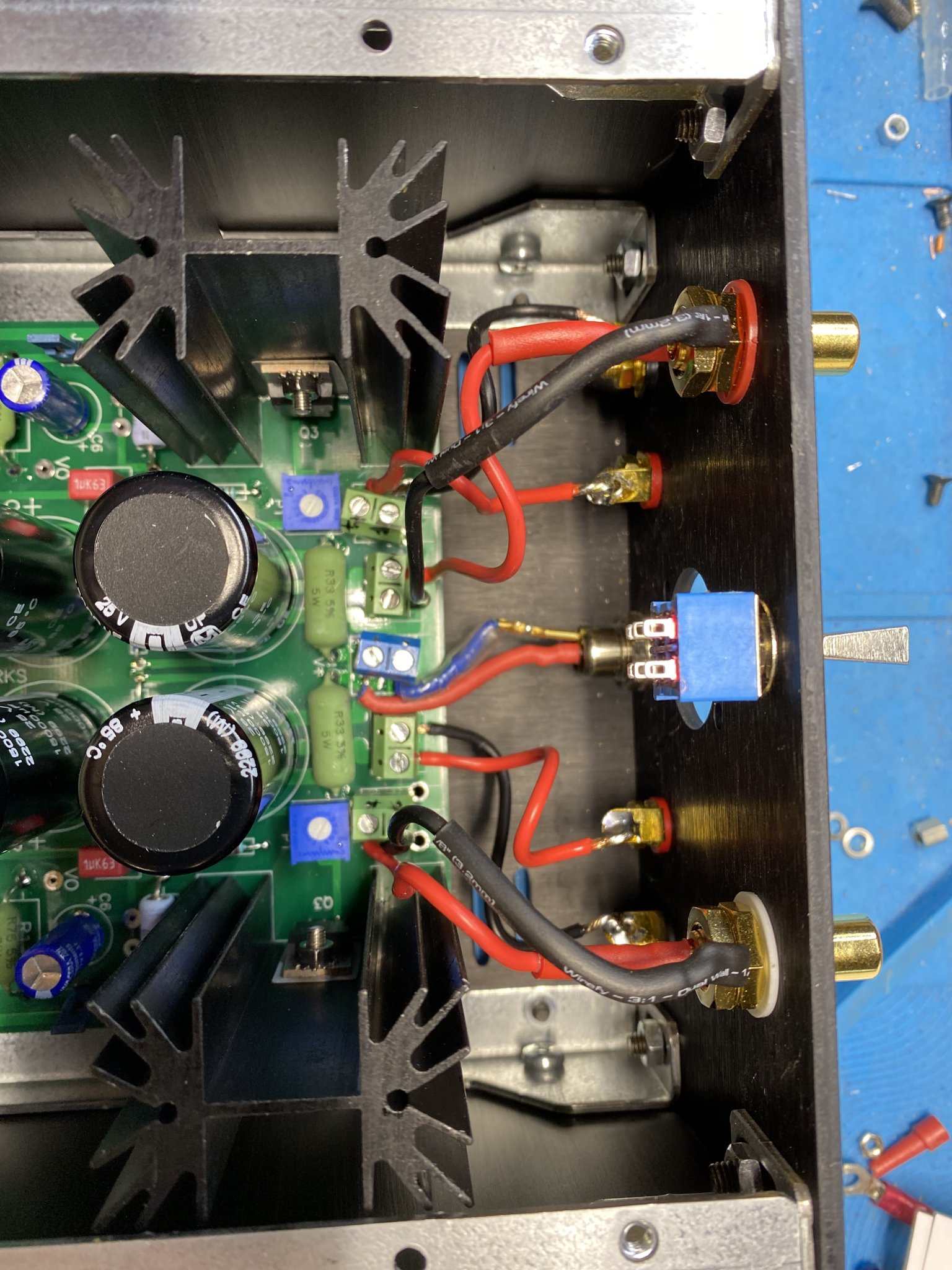

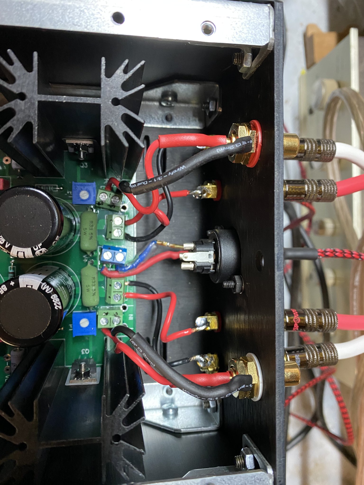

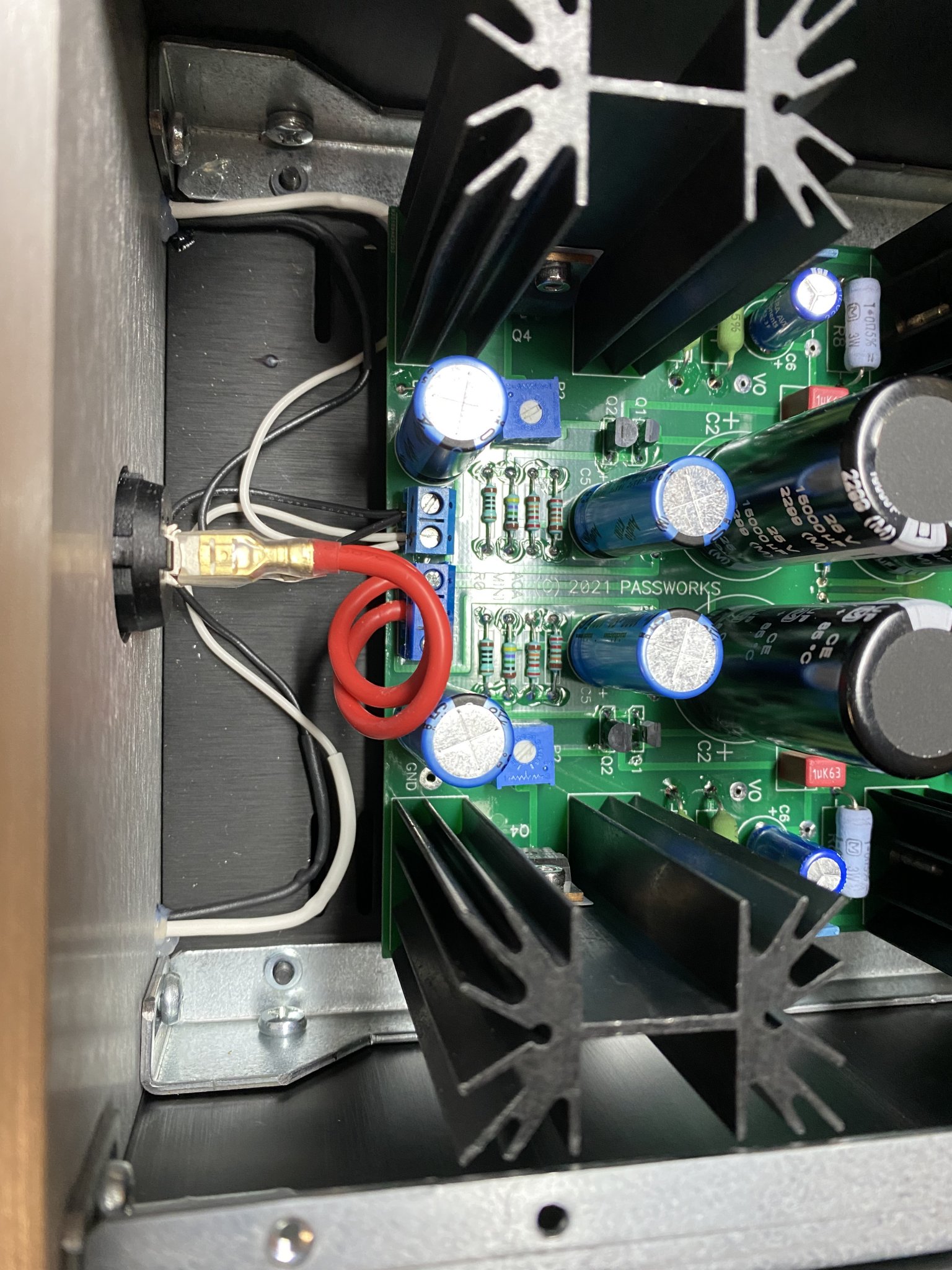

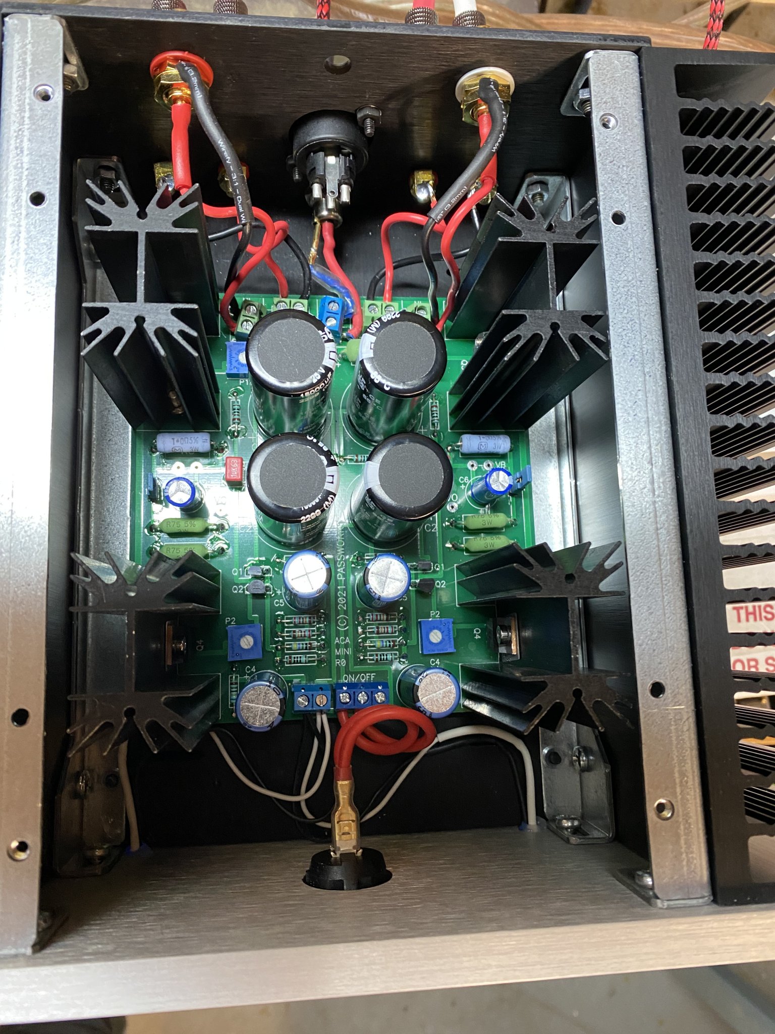

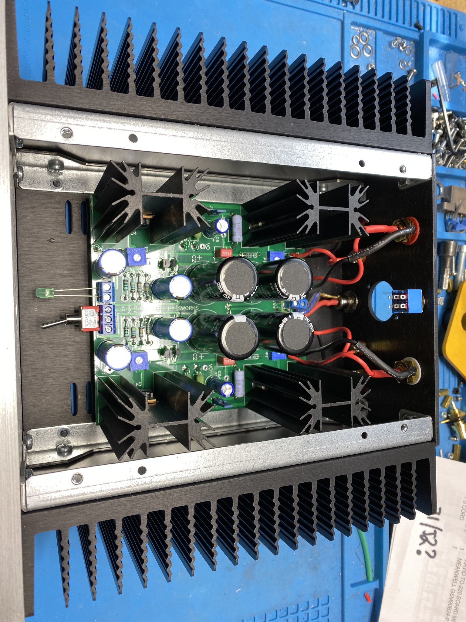

Hey folks,

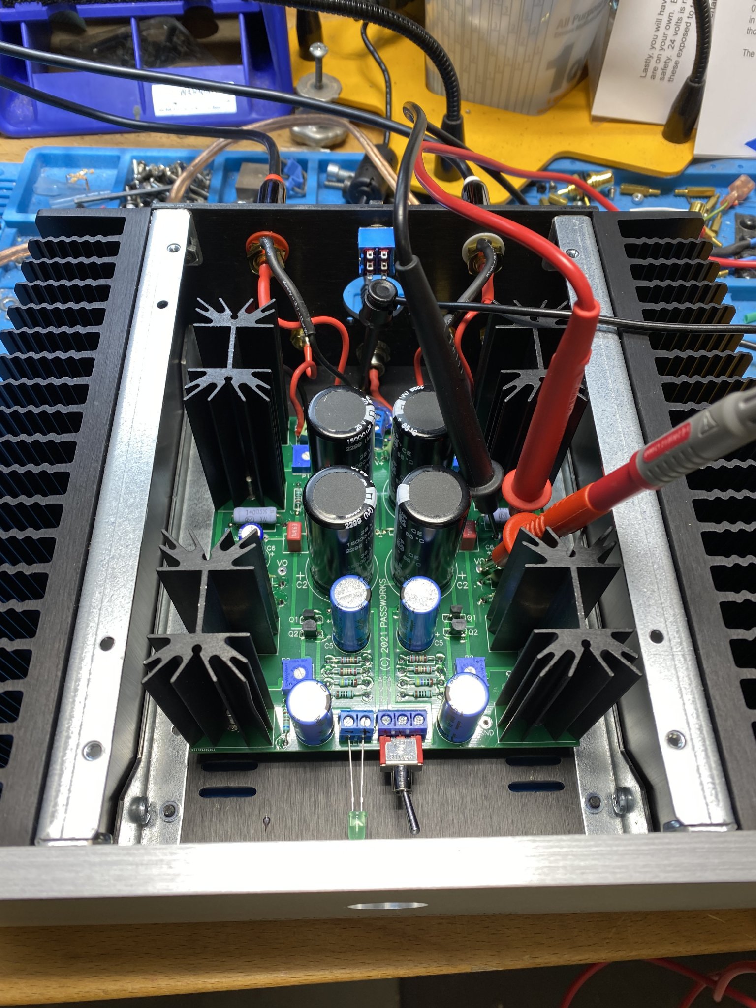

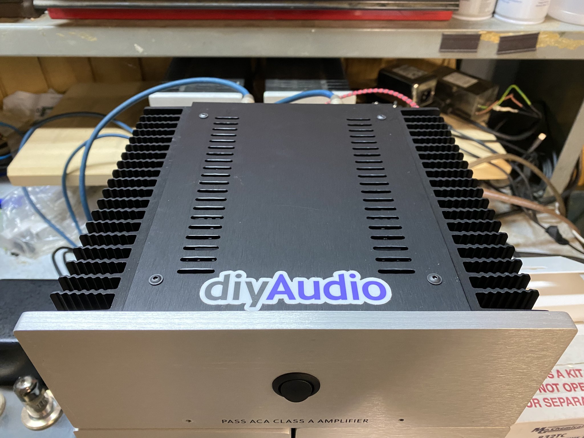

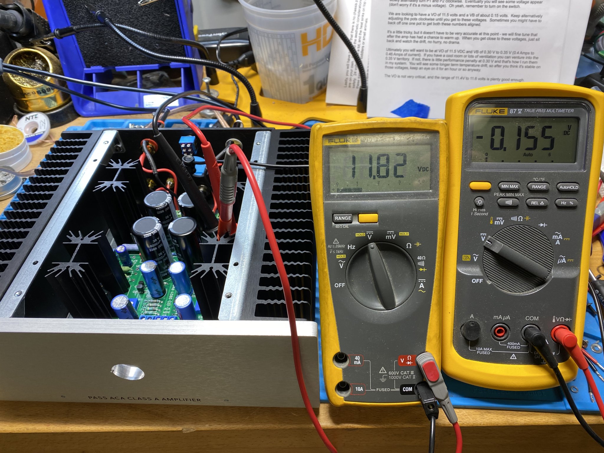

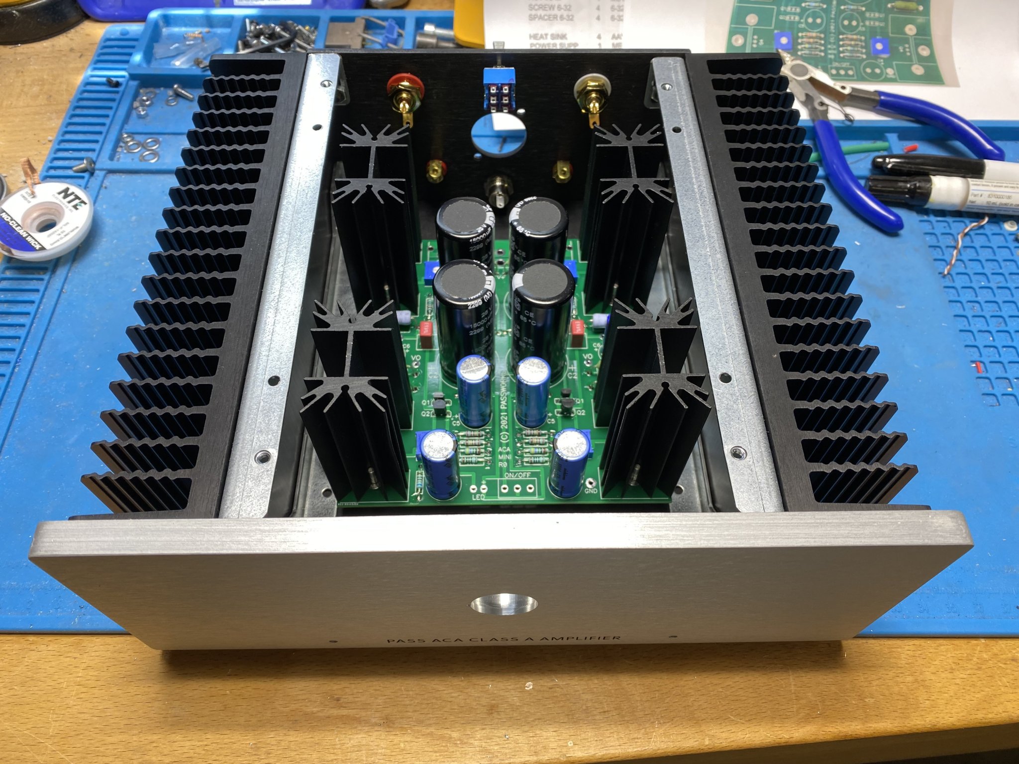

Last weekend I managed to get the ACA Mini built and installed in the latest stereo Amp Camp Chassis. I wanted to post pictures to give folks some ideas and show that it can be done as the fit is quite tight, but it will fit!
This amp to my ears, sounds better than an Amp Camp in all aspects. Its quite a sweet, tuby sounding 5 watts and for 5watts its quite dynamic and punchy. I was not able to get it to clip in my setup, driving it with the iPad + ACP+, and a max volume its quite nice! The characteristics are adjustable to your liking and I played around a little with the degen settings until I got it where I liked the sound of vocals being played through my test setup on the bench. I'm driving a pair of Vifa MTMs with it, and the ACAmini via one of my ACP+s and an iPad with Tidal and Spotify and it sounds pretty sweet. I can't wait to hook this up to my DAC and high-res Tidal later. Doing the biasing is also a good lesson/example in what an amp will sound like if you reduce its rail voltages or what happens when you move the bias from 0v upwards.
Some build considerations and questions. First, does it fit? Yes, it fits with about 2mm spacing on either side of the silver rails on the bottom. Two of the vent holes line up perfectly with the standoffs, so you really only need to drill 2 holes. Connect your metal stand-offs to the chassis. The rest are done for you. Second, does it over-heat ? Nope. I ran mine for 2 hours. Without getting out the IR temp gauge, it seems to run cooler than similarly driven ACAs on my workshop bench. The integral heatsinks sit right under the vent slots in the ACA chassis cover which is likely why.
Some final notes around the fly wires you see. Connecting the i/o is straight-forward: connect a pair of RCAs to the correct + and - points where the fixed RCAs go. The DC inlet and speaker jacks from your ACA stereo chassis/completion kit (or bring your own) connect to their corresponding +/- points on the board.
I used Euro-blocks to connect to the board for easy of removal/hacking later as I usually do. I did not connect the balanced/switch but I hear from a trusted source, that a bridged/mono configuration is coming, so don't toss those just yet! 😉
Onto the front, you see I used the stock ACA's power switch to interrupt the two positive lines from the switch and I left the other alone. On the other side, I jumped two blue LEDs into the euroblock there. I switched these to blue LEDs because this is a Pass Labs project and thats just how we roll around here with those. 🙂 The voltage across two LEDs in parallel is fine but if its too bright, add some more resistance.
The observant reader might ask why I didn't connect the MOSFETs to the integrated heat sinks. I wanted to prove a point: that the stock ACAmini would fit and function inside this box without any issues, which it does. You in fact can run it as I did at first, without the I/O connected to the chassis - just built it and stuck it inside the case with the LED/power switch, RCAs and DC input stuck into the euroblocks and the speaker wires soldered in. I did that to test the thermals before I spent a lot of other time on it. That being a success, the second one I've got queued will use flywires to jump off the 3 MOSFET wires to MOSFETs mounted on the bigger heatsinks and will set the rest up the same way. I might in fact, retrofit the current one that way if I have the patience to unsolder the heatsinks from the board.
Thanks again for a fantastic project Papa Pass!
--Tom

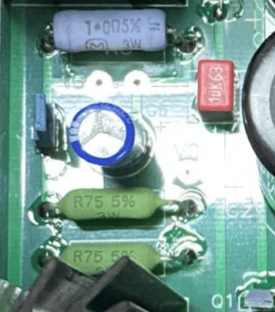

tha panasonic R11 is in the wrong positionHey folks,
