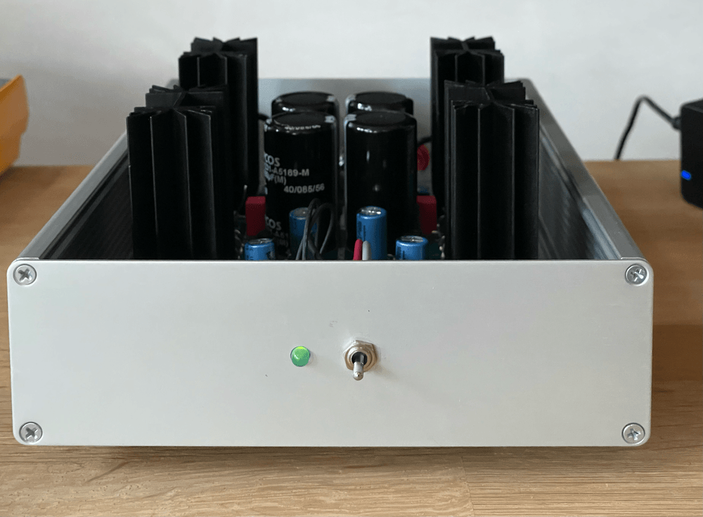

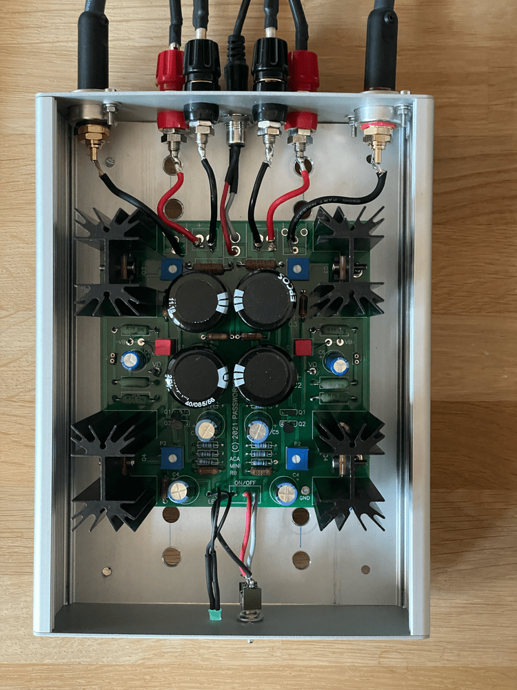

I am so into aca mini sound.
Reactions: 11 users

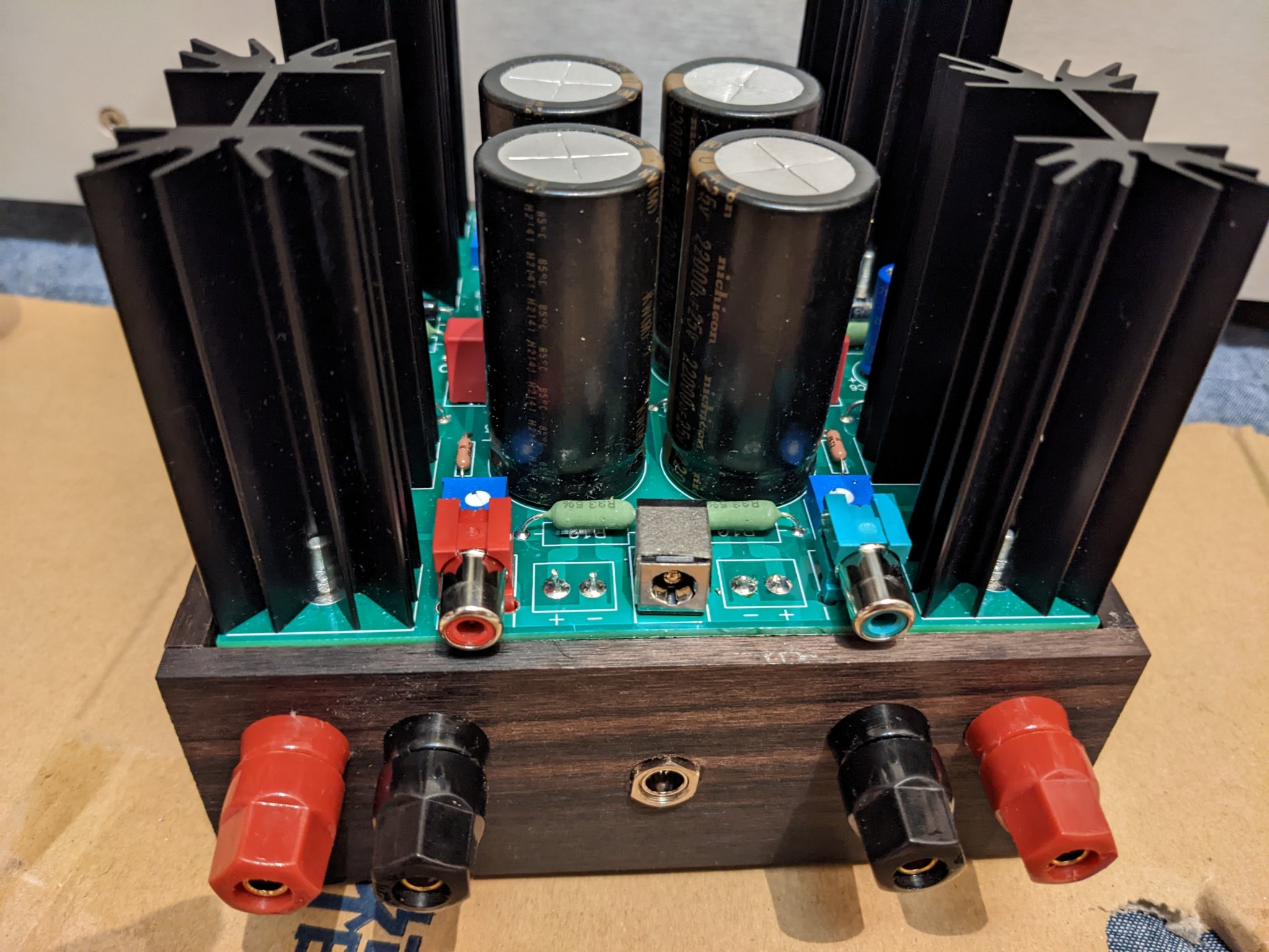

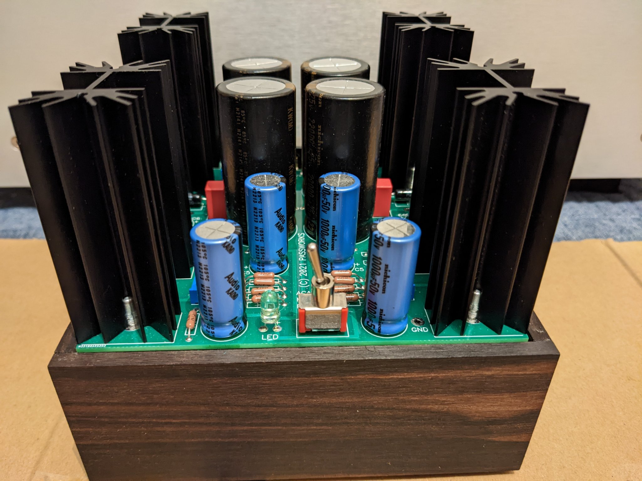

ACA mini plays nicely. :) I put it in same size as ACP+. The tricky part comes next, cut out the top.
It was fun assembling this tiny amp!
Reactions: 2 users
