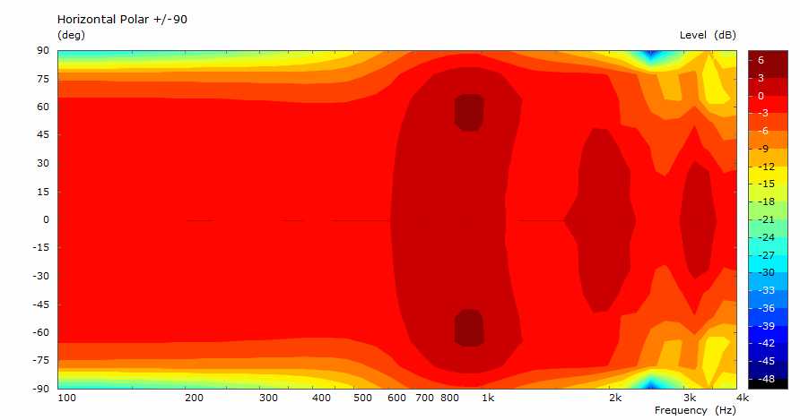

"It's not until at or above the dipole peak that you start to see the effects of baffle diffraction appear, and only if/when the baffle width is at least about 1.5 to 2 times the width of the radiating surface of the driver."
Right, that's what I thought, and why I didn't understand when you said:
"Firstly, diffraction is not what gives rise to oscillations in the on or off axis response from a dipole"
The "oscillations" in the image below are not caused by diffraction, since there is none. That is what I am talking about in the quote above. I probably should have used the term "response shape" but you were using the term "oscillations" in this post, so I picked up on that. Perhaps we are thinking about different things when we refer to "oscillations"?
Let me post and answer some questions to lead you through how I think about diffraction in dipoles (and other systems too).

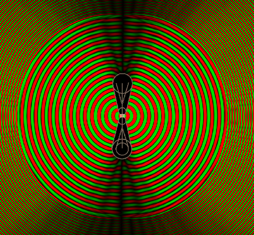

I do have some experimental data that suggests that MIGHT be possible. I have constructed a dipole from two 1" dome tweeters in small (circa 4") waveguides. From what I can tell, and guess, around 1kHz the separation distance just happens to be enough for constructive interference, and the SPL is raised there. If the real system followed the two-monopole model, as frequency increases there would be a series of peaks and nulls. Instead there are none at all. I believe that in this frequency region the waveguide becomes effective and the front and rear waves no longer wrap around to the opposite side. You get a very nice, near constant directivity pattern from the pair! Maybe these effects can be scaled up in size for larger drivers?
Hopefully you'll hang around for this and offer suggestions/critique. I suspect there will be several models presented.
Gotcha. Yes, I was talking about the on axis nulls above the dipole peak. BTW if you want to see the smearing effect of the torus baffle have a play with the ripple tank simulation, you can make a "waveguide" too, visually it can give a good idea of what's happening.

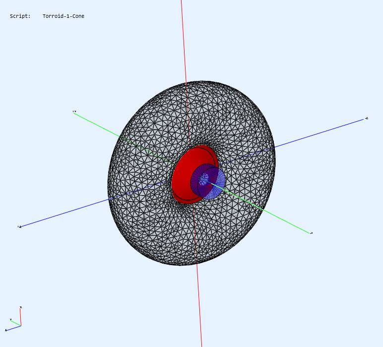

For completeness we should probably see the same driver modelled for the Torus shape?
Of course. I have it, but I don't like it. I was just waiting for feedback on the disc.

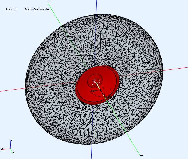

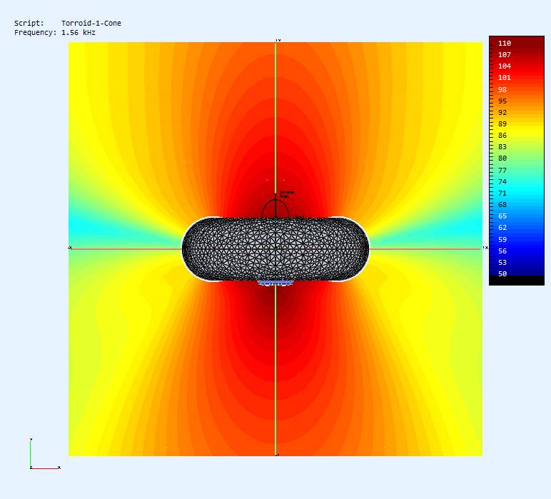

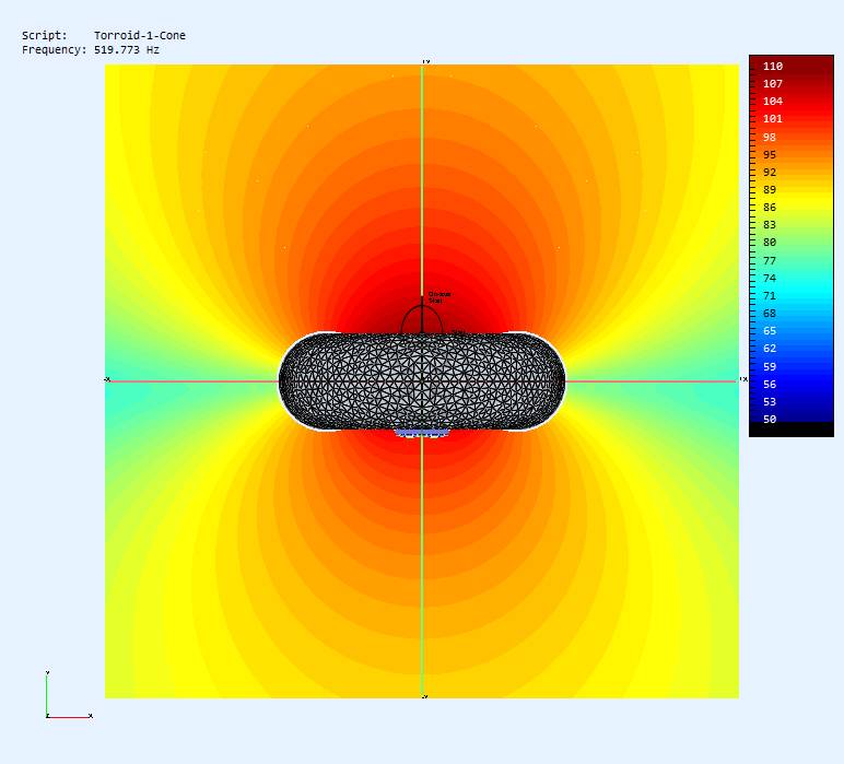

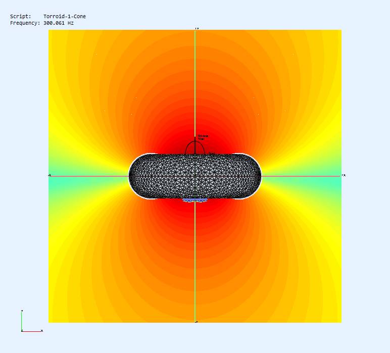

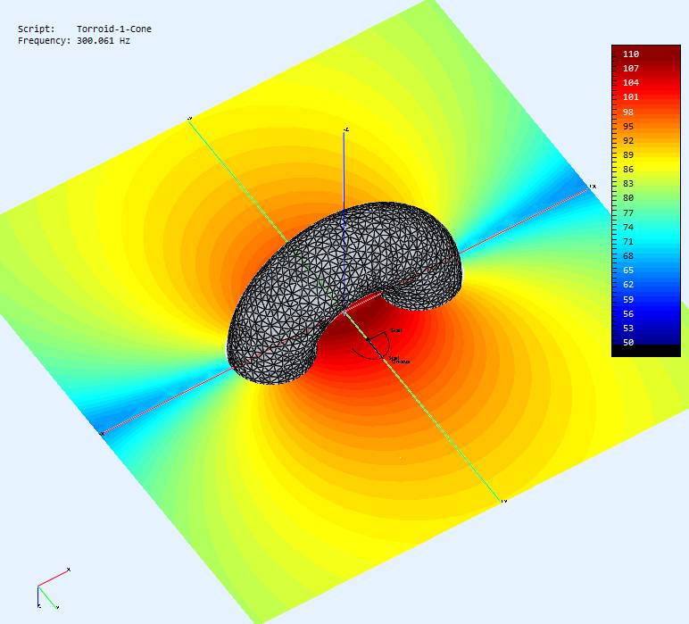

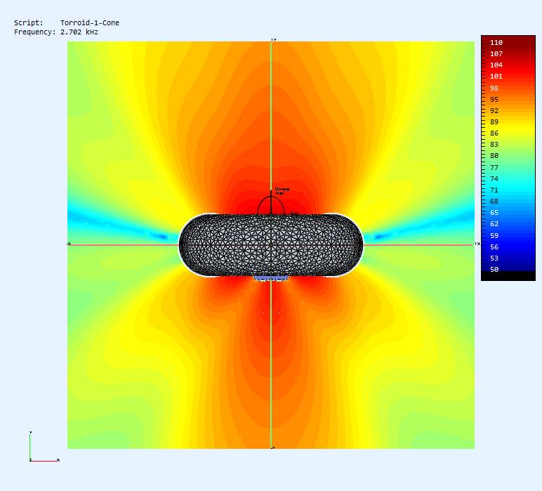

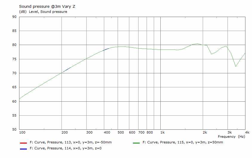

Here is the torus, ID=150mm, OD=450mm, rotated circle OD=150mm. Same driver as the torroid (disc).

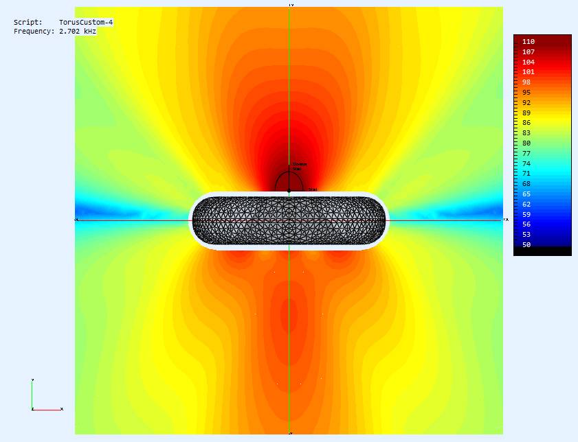

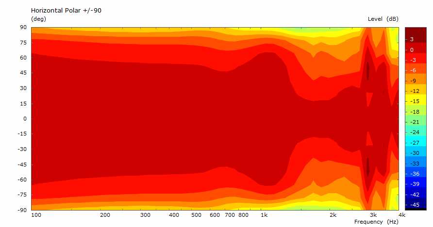

A few thing that stand out. The driver is mounted midway in the torus. The recess is causing HF issues with the woofer front and partial obstruction of the back. The front could be fixed by a flush mount or different exit contour. There is less clearance around the magnet and its causing field asymmetry. The lateral null has widened, but I'm not sure if this is good or not. However It did seem to reduce the axial ripple (nulls?).

Yes, the null will widen and not be as deep. I've found a simple straight waveguide helps the consistency of the null. This is ridiculously large but you get the idea, I attach the file as well if you want to change anything

I tend to think a wider null is better for reduced lateral reflections, but there will a cost with reduced forward beam width. So I'm not sure of how that nets out.

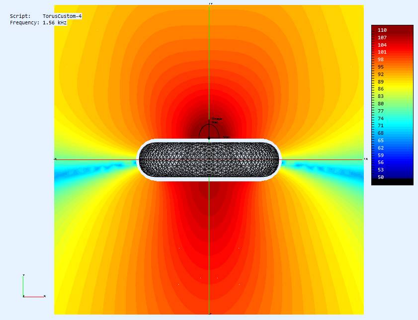

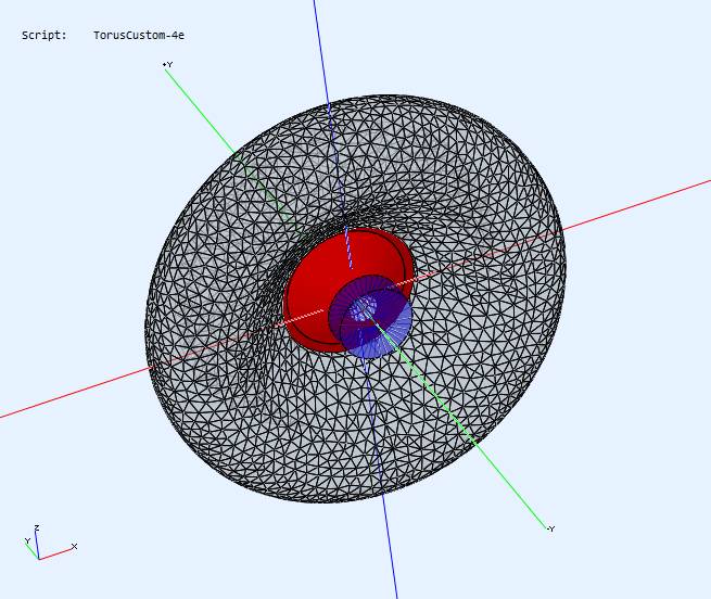

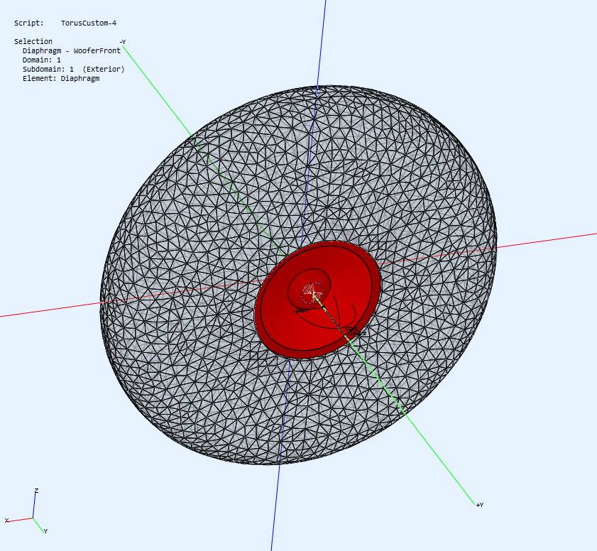

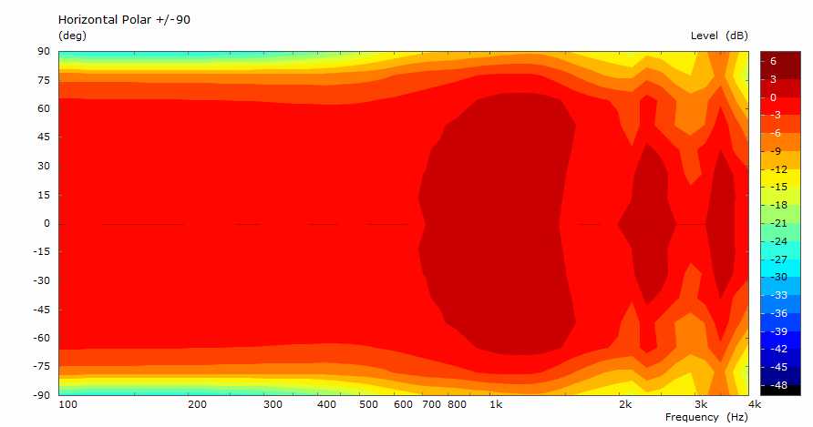

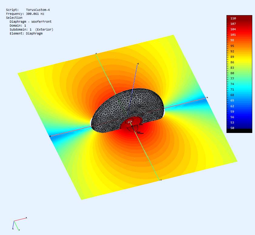

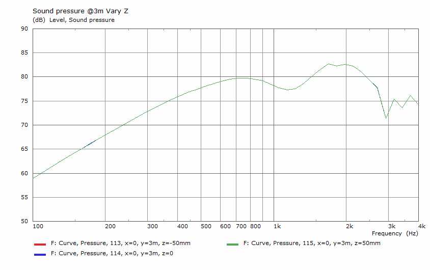

This is a torroid OD=450mm, ID=150mm, T=110mm, RoundOver=50mm and a generous chamfer (70mm) on the back to let the woofer breath.

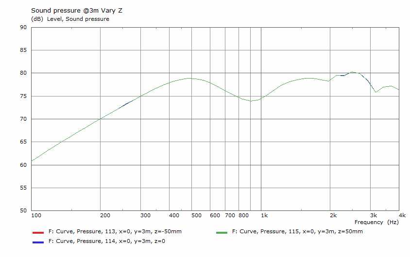

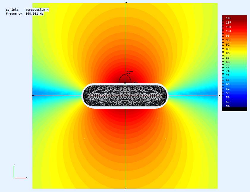

Nasty ? it's 5dBpp just like all the previous ones, only spread out more a bit more.
I wanted the woofer to be flush but I ended up moving it back 0.5cm to help flatten the FR. If I were in marketing that curve would be +/-2.5dB 🙂. The HF is preserved by moving the woofer to the front so the curve is flatter.
Next model will change the baffle diameter to help that "nasty dip" . 😀
Hehe, it's not much better than the simple disc, that's what I mean "nasty" 😉 I experimented with driver near the front, it didn't work well. Try a minimal waveguide see what happens

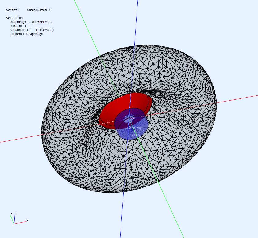

Similar to post #90, with the woofer recessed 30mm and woofer exit round over. The woofer exit still needs work as its causing ripple @ >2Khz.
The ripple tank simulation uses an "ideal" dipole source, so symmetry was easy. When I introduced any asymmetry it effected the way the diffractions were smeared at the "edge". Since this is a different approach to spreading the diffractions as a rectangular baffle would do, symmetry, I think, is more important. This is why I was also thinking of back-to-back drivers.
I know you are interested in investigating this "torus" shape, but that might not be a useful profile above e.g. 2kHz no matter what you do.
Can you simulate other cross-sections that are rotated around the central axis to create the solid shape? I would be interested to compare the torus results to more waveguide or horn profiles. Where the inner surface end (e.g. the termination of the horn lens) you would just join to the other termination (e.g. front to rear) using some kind of gentle roundover.
Like two of these, back to back and joined together at the edges of the guide:
You will probably end up with something that is more like a cylinder with bulging sides and a horn in each end.
