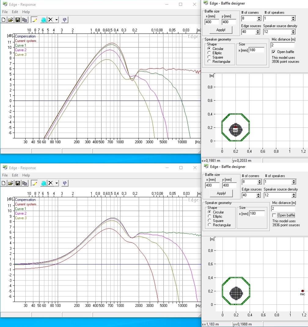

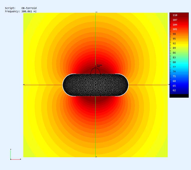

One more Edge sim, dipole vs. monopole baffle

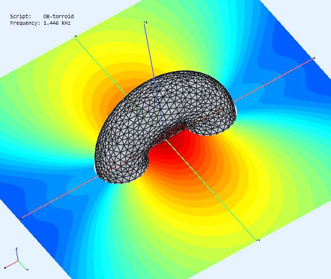

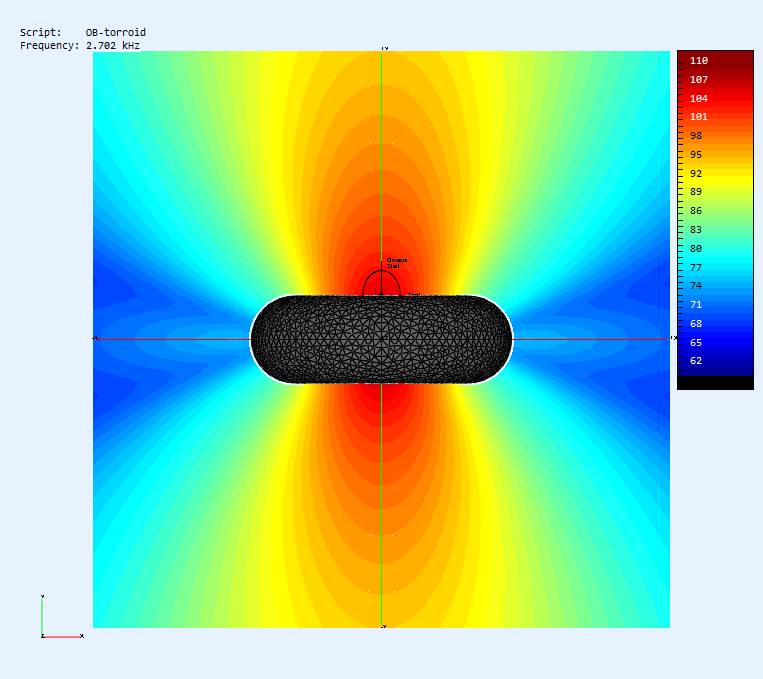

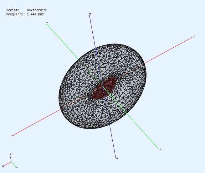

If the model is close to what we are talking about, then I'll generate the polars and FR. This is currently in 4pi space.
The torroid is 150mm dia circle with sweep radius 150mm . Close to XRK971's wheel barrow inner tube or that SS torroid. Currently using an ideal flat membrane driven by a DSA175 motor.

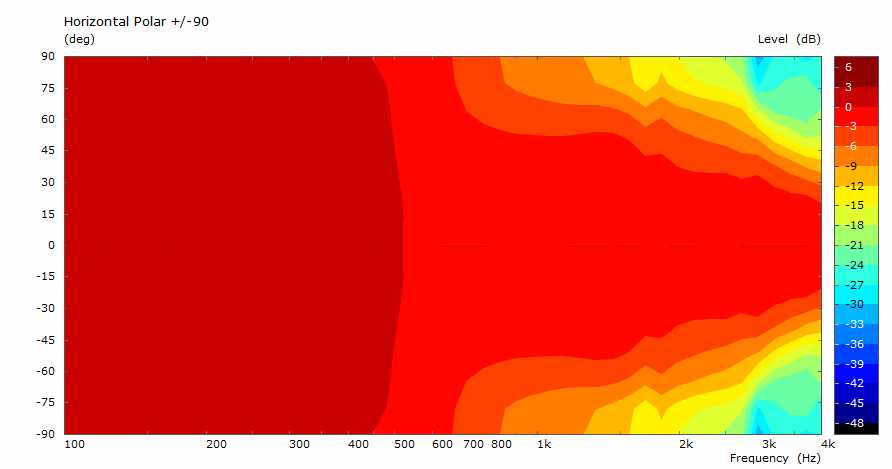

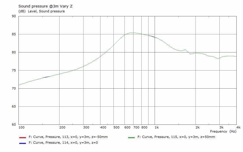

Here's a quick look. Keep in mind the driver is not ideal (flat membrane+DSA175 motor). The polar is normalized w.r.t 0 deg (axis).

Don, please make sim of a flat baffle same radius too! And show spectrogram to +/- 180deg of both! Looks like directivity transition is pretty smooth with minimal ripples!
I'm not sure same radius would be the best comparison? I've made the flat baffle larger as an approximation of the same distance around the torus curve.
