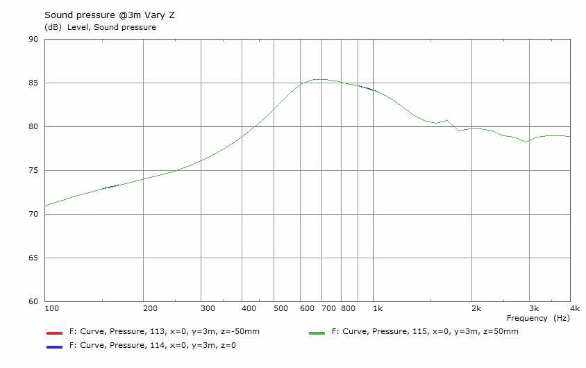

^ Agreed. The amount of diffraction will depend on pathlength to the edge. This seems to be ignored when I see people say a certain shape is bad. I can try a similar flat disk with radius to the apex of the torroid. I need to have some thickness to the disk as well.
So what's actually happening? Earl has been explaining it to me here, https://www.diyaudio.com/forums/mul...d-diffraction-baffle-edge-10.html#post6382802 but I'm not sure I'm grasping it properly, I'm pretty sure I'm not......
I read his comment. I think I understand it. There will be diffraction from the disc edge that should appear in the polars for a real disc with thickness. When I measure my speakers I can never escape diffraction showing up in the polars. I'll generate a simple disc for comparison.
Does he mean other than the cause of the ripples that appear on axis above the dipole peak? And, why aren't they showing up with the torus, does my post(s) that follows his make any sense? 🙂
Baffle edge diffraction with dipole radiationAh, I see what you are talking about. Take a "donut" torus. Install a baffle inside of the hole in the middle, then install a driver in that. Is that correct? Like this:
How thick is your baffle. If its very thin you won't see the diffraction at the edge because its coincident from the front and back. It should still appear in the polars.

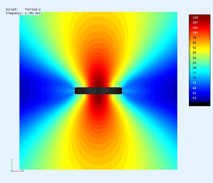

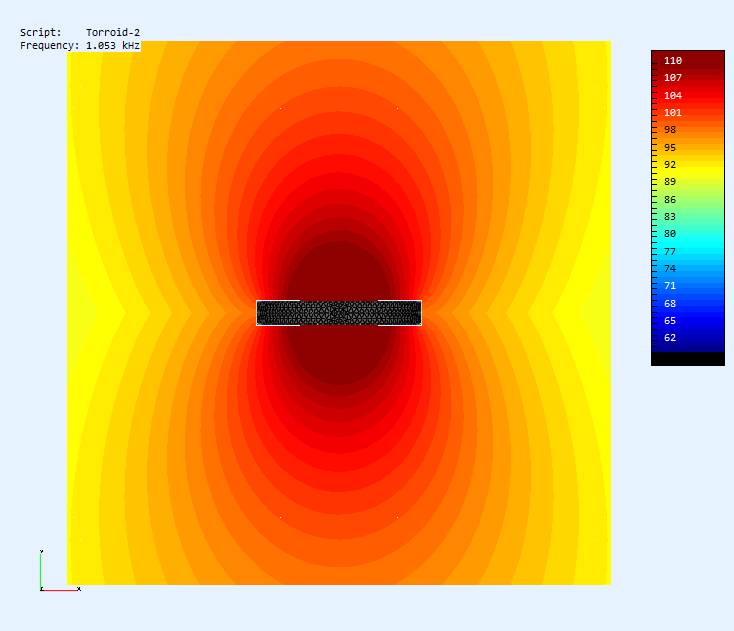

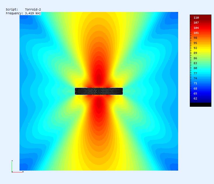

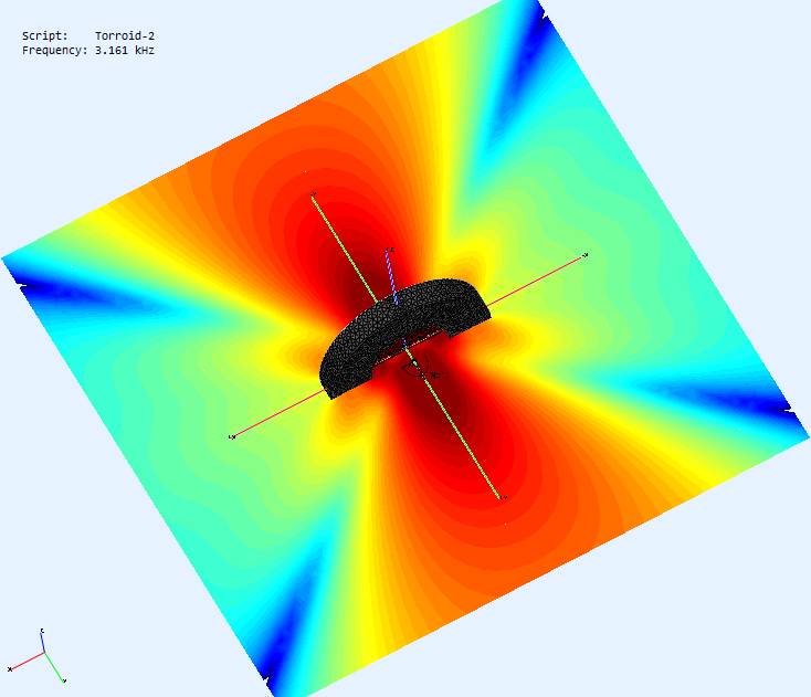

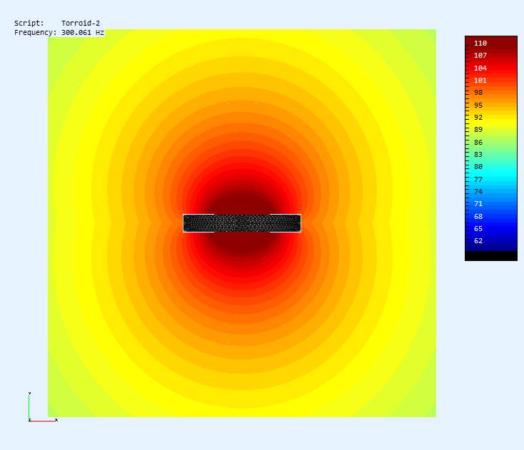

A flat disk with the inside and outside edges left sharp to promote diffraction.🙂 Same 6.5in driver as before but the disk is smaller as well.

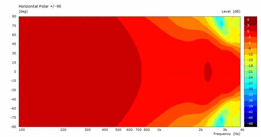

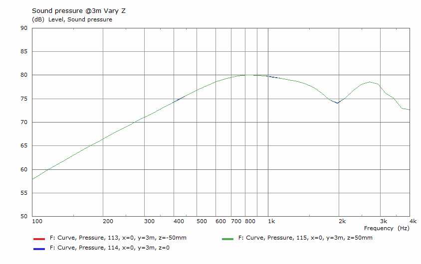

I still don't understand why there appears to be no on-axis interference nulls with the torus, I thought Earl was saying it was due to there being no diffraction?
He said "When a circular baffle is used in a dipole there will be on axis ripples from the edge diffraction, which will move lower as the radius of the baffle gets larger, going away for an infinite baffle. With a torus there won't be any significant diffraction (a small amount at LFs) so there won't be any axial aberrations. The directivity will change however - from an infinite baffle."
Firstly, diffraction is not what gives rise to oscillations in the on or off axis response from a dipole. In a boxed loudspeaker that IS what is causing the oscillations at the top of and above the baffle step, and the more regular the distance to the edge the worse these will be. In a dipole speaker it is front-to-back pathlength differences that give rise to cancellation or addition of the front and rear waves, and these result in the oscillations. Using a toroidal baffle shape will not change that.
A torus baffle does appear to change that, which also seems to suggest that the oscillations are caused by diffraction. The question becomes, if it's not due to diffraction, how is the wave from one side of the baffle travelling around to the other side?

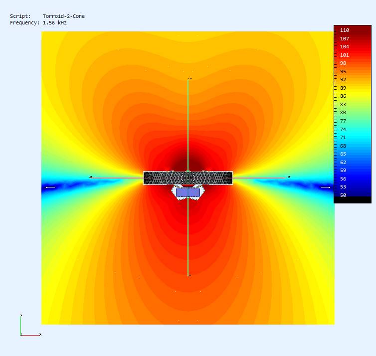

Its because of a simplification I did for the driver. I noticed the lateral nulls did not extend low enough and its being fixed.

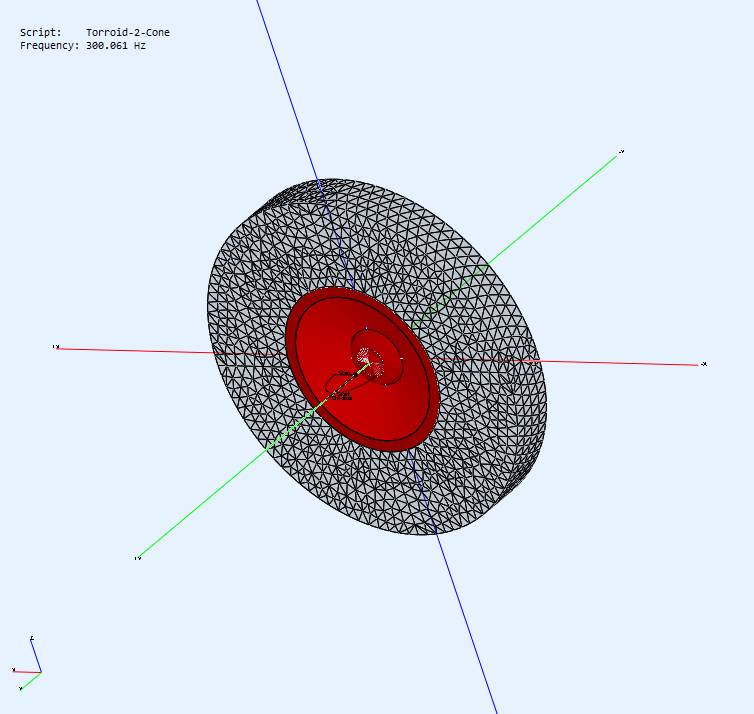

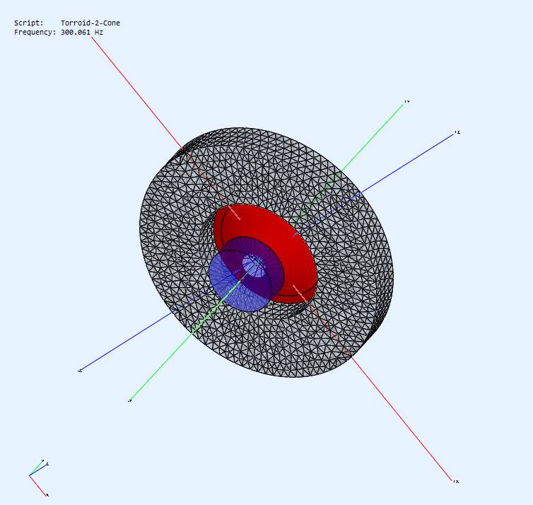

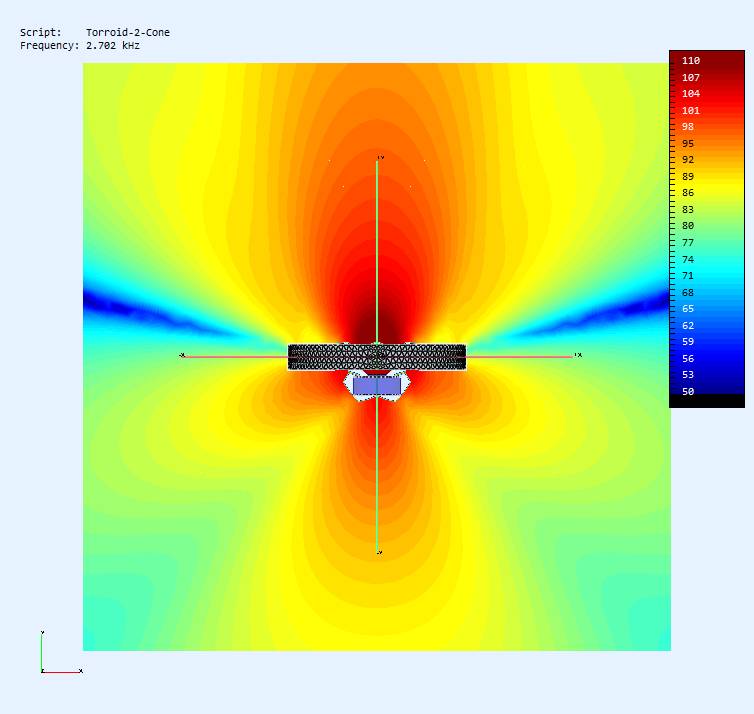

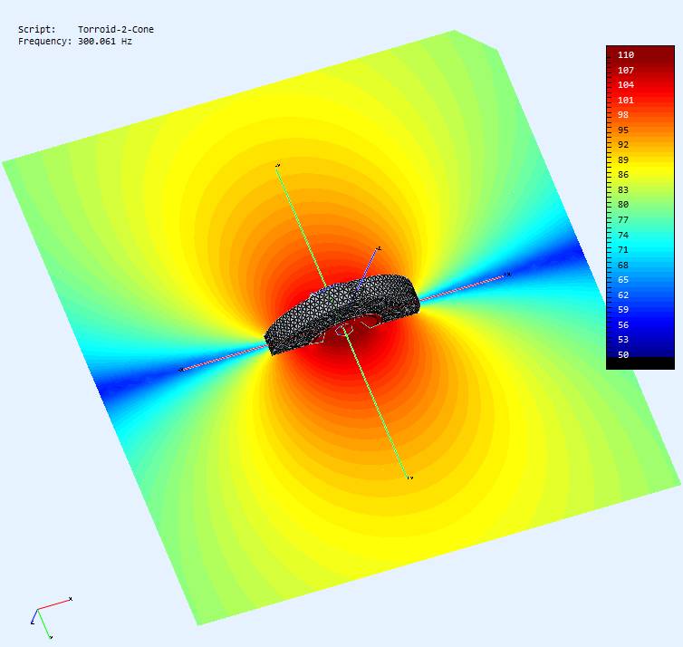

This is an update to the simple disc presented earlier. The driver membrane in the earlier model was too simplified (ie. mirrored) and did not operate properly in OB config. The lateral null now extends to lower freq. I'm usually only interested in one side of the driver 🙂
The disc ID=150mm, OD=300mm, T=40mm. There is a cone woofer model now mounted flush with the front. As the frequency increases the rear sound field will get diffracted off the magnet. There is some "whitespace" around the magnet, you can safely ignore, its just a visual artifact that did not effect the calculation.
Does this look more reasonable ?
Let me post and answer some questions to lead you through how I think about diffraction in dipoles (and other systems too).
Q: How is the wave from one side of the baffle traveling around to the other side?
A: This depends on the ratio of the size of the radiating surface of the transducer and the size of the baffle. At low frequencies at least, the baffle is too small to change the propagation of the wave, and the source is small compared to the wavelength, so the wavefront propagates everwhere like a monopole in free space. At higher frequencies where edges can cause diffraction, the wave will still travel "around" the edge of the baffle to the other side but it no longer strictly a monopole because of the effect of the baffle and edge diffraction. At high frequencies the size of the radiating surface compared to the wavelength causes beaming and the baffle is not well illuminated, so wave propagation is no making it "around" the baffle to the other side (well not very much of it at least).
Q: What is causing the "oscillations" in the response of a dipole
A: These oscillations are caused by the interference, constructive and destructive, of the wavefronts generated from the front and back of the transducer when they meet out in the farfield. This depends on the path-lengths taken (which determines the relative phase angle when they meet). Wave that are in phase meet and add, and when out of phase cancel. If there are a variety of different pathlength taken, you have to add up all the different contributions from each. This is why the baffle shape and driver location on the baffle both influence the dipole pattern.
Q: What about diffraction in open baffle and dipole systems?
A: Without a doubt there is diffraction occurring, but that is not the primary reason behind the dipole pattern.

First, let's examine the two-monopole model of a dipole. This is simply two monopoles, one out of phase with the other and separated by a distance in open space. There aren't any surfaces to diffract the wavefronts, so no diffraction can be present. Here are the predicted responses of this model, which is described in more detail HERE:
This shows the effect of the wavefronts generated by the two sources as they interact, for several angle on and off axis. Without including diffraction, the model correctly predicts a dipole pattern (at least for low frequencies).
Moving from this model to a real system with a real driver on a finite baffle, we DO see this response shape up to a frequency which is about where the lowest "dipole peak" is found (e.g. 680Hz in the image above). This region encompasses both low and medium frequencies, the latter of which SHOULD show some diffraction even if it has only a modest effect. But real systems don't show these effects in this frequency range. It's not until at or above the dipole peak that you start to see the effects of baffle diffraction appear, and only if/when the baffle width is at least about 1.5 to 2 times the width of the radiating surface of the driver. This last point is very important, and I think it is a great teaching tool about diffraction itself. So I will delve into that now.
