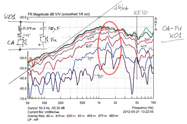

This is directivity of a 3" cone driver, wfrom SL with my add-ons, but the no-directivity issue is evident!

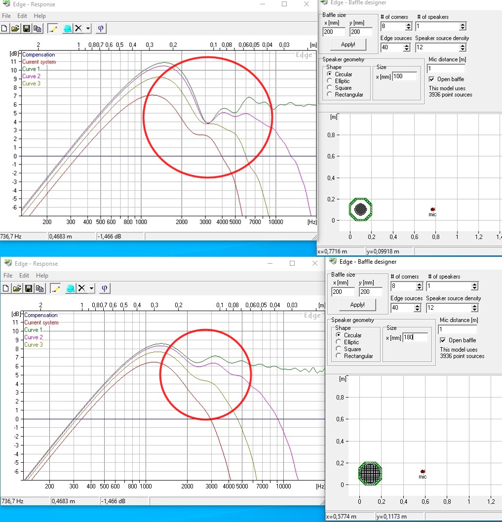

Edge excersice to show what I was talking about - same baffle different radiator.
Please let me remind that Edge uses ideal planar radiator - with a cone we get it's geometry and resonance irregularities added above dipole peak!

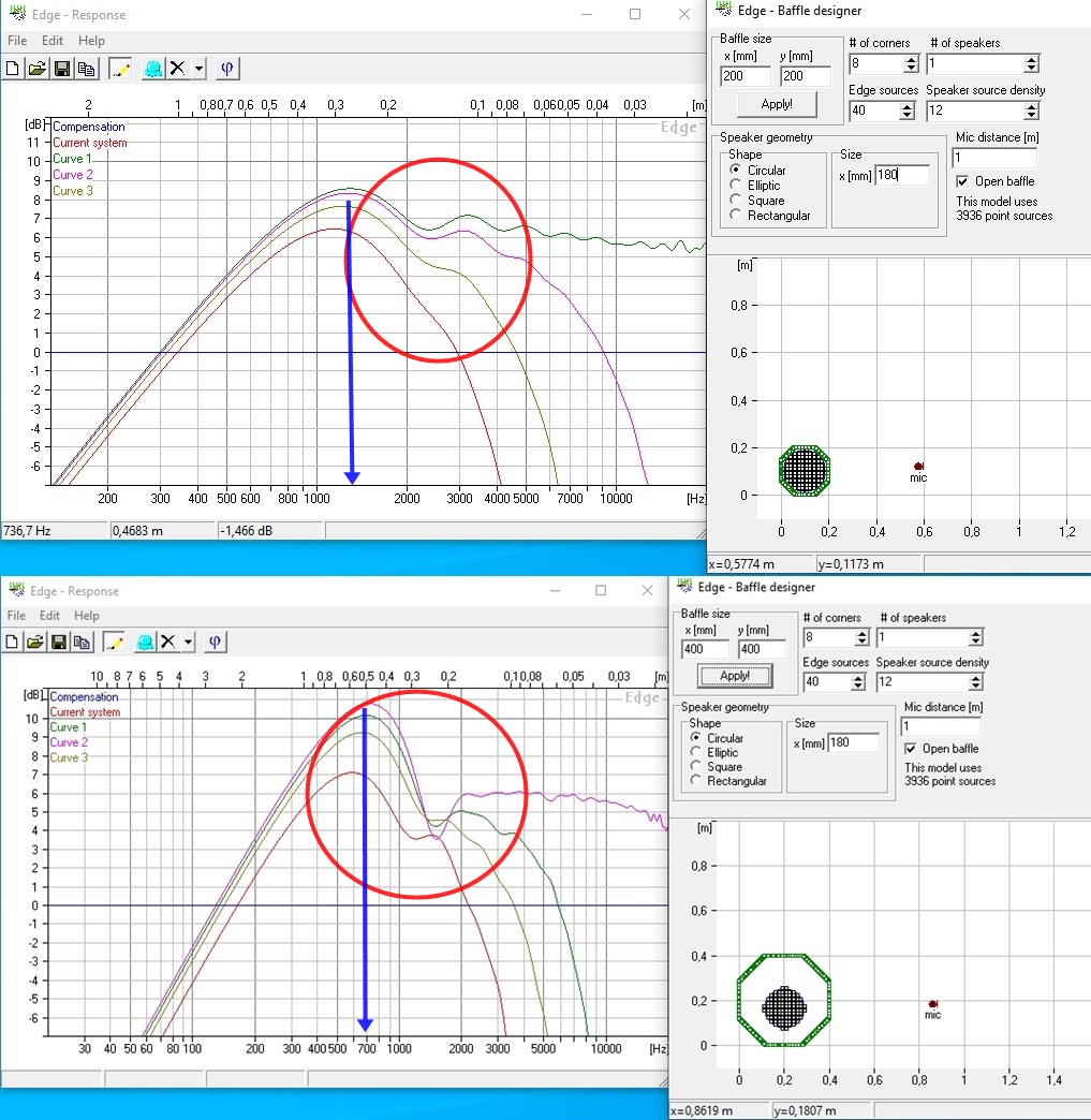

Edge sim with same radiator different baffle.
Interesting to see measurements of donut baffle, preferaby vs. flat baffle same diameter! My prediction is that there will be only small changes...
