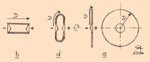

Take a look at figure d below, from here Electro-acoustic models
It appears to be possible, using a torus-like baffle, to spread the interference nulls in space and time, so does something similar to this diagram actually become a viable option?

I think you should, for your own sake, explain your idea in a little more detail. Please do. I don't want to put words in your mouth about what you are thinking here, exactly.
What you are showing is just a "thought experiment" showing how a tube can be squashed into an equivalent planar, circular baffle, and how the front-to-back distances compare.

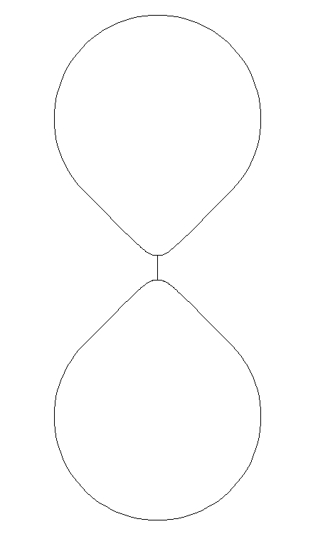

Ah, I see what you are talking about. Take a "donut" torus. Install a baffle inside of the hole in the middle, then install a driver in that. Is that correct? Like this:

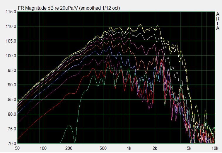

If I use a driver, without baffle (nude), it doesn't have any on axis nulls either. You can easily confirm this with the Edge when the driver radiating surface and baffle edge are close together. If diffraction is a problem, why would it not be worst in this case with a circular, sharp edge?
Using, for example, a nude 15" driver I only measure very smooth responses all the way up until the cone breakup region. Here is a measurement with better than 50Hz resolution to prove it:

If the torus shape seems to be worth pursuing then someone should definitely build it, possibly in a couple of difference sizes, and perform some high resolution (e.g. outdoor) measurements that will show what is going on in more detail than Allen's sims.
