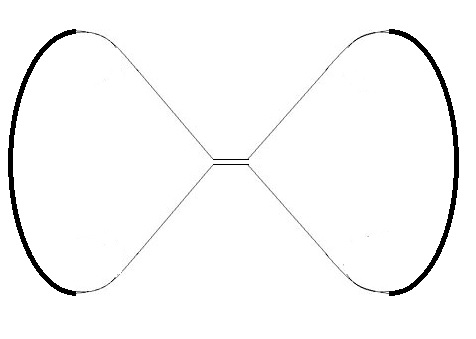

I did some crude photo editing to put two of those, back to back and close up the side. This would probably be pretty large, e.g. at least 18 to 24 inches wide so that the throat is large enough to accept a 4" or 5" driver. Maybe a ScanSpeak 10F fullrange or similar. Keep in mind that I have zero experience or knowledge of horn or waveguide design! The image was lifted from a web page on the oblate spheroid profile. I think it is mostly a strait (conical in this case) horn with an oblate profile to the lip roundover.
My cartoon is attached. I am calling it a "dogbone dipole" waveguide.

Can you simulate other cross-sections that are rotated around the central axis to create the solid shape? I would be interested to compare the torus results to more waveguide or horn profiles. Where the inner surface end (e.g. the termination of the horn lens) you would just join to the other termination (e.g. front to rear) using some kind of gentle roundover.
Like two of these, back to back and joined together at the edges of the guide:
You will probably end up with something that is more like a cylinder with bulging sides and a horn in each end.

The shapes were created in FreeCad and rotating curves (drawings) to solid is easy. Your drawing looks like an OSW. Is that what you intended?
Edit add : yes, I just read your second message

The OSWG magic is that little curvature in the throat. The rest is "conical" and it does not specify mouth termination. @mabat has a calculator that generates modified OSWG profiles that might be useful at higher freq but would not have pattern control at <1K for a horns of this size. Conical is close enough to test an idea. Thanks.

I am not sure about how necessary the throat "curve" would be if the source is large, e.g. 4".
Anyway, much like a large diameter CD on a horn, it will probably not work well above some frequency, e.g. 10kHz. But if you can get it to work up that high, you can transition to a forward only tweeter above that point.
It's relative to the throat diameter (starting point) which is just slightly bigger for a woofer 🙂 I've done them before. I'll add a generous roundover.

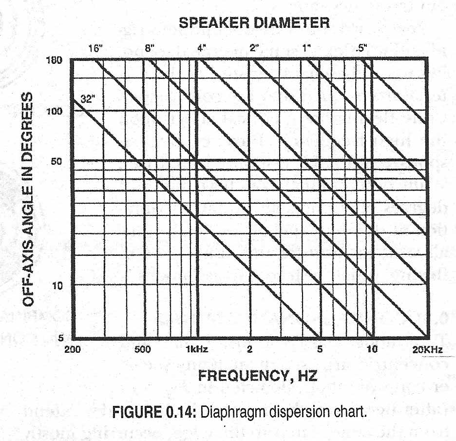

The directivity of a cone is mostly a function of its diameter, so it gets modeled properly. When you look at the previous polars you can see the beamwidth start to narrow after 1Khz. This chart is the ideal case for a simple cone (no inner whizzer cones).

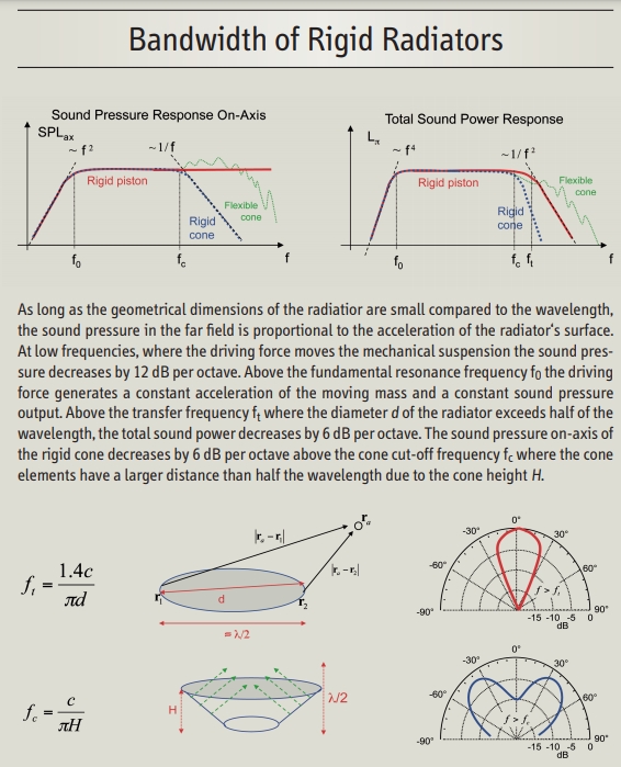

More about radiation by Klippel. A dome vs. planar vs. cone are all different! Cones have same pain as with dipoles, there is certain difficult range where radiation is not linear

The BEM sim assumes a rigid vibrating membrane, and its shape (flat, cone,dome,etc) is physically modeled. So radiation patterns will depend on the shape.
