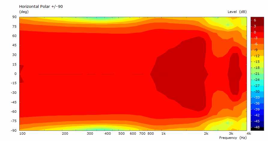

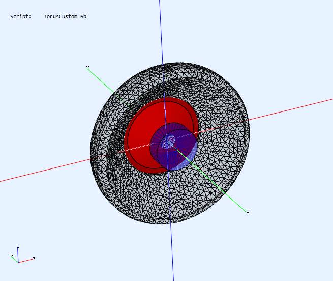

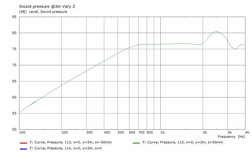

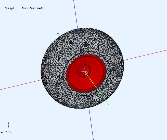

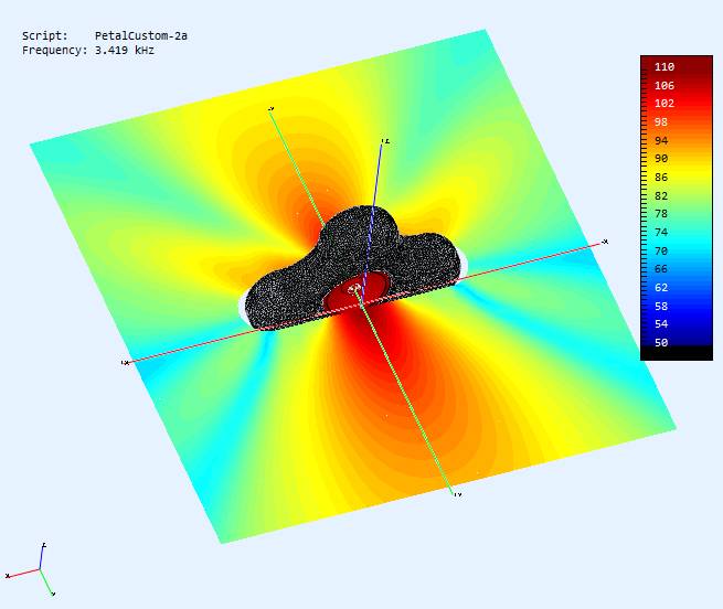

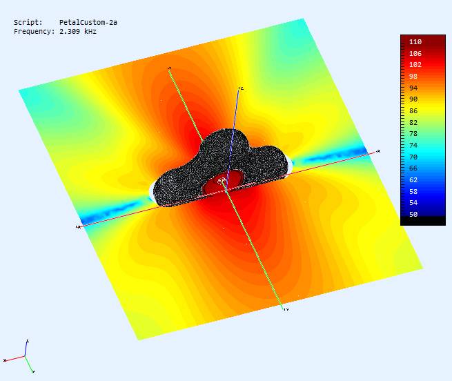

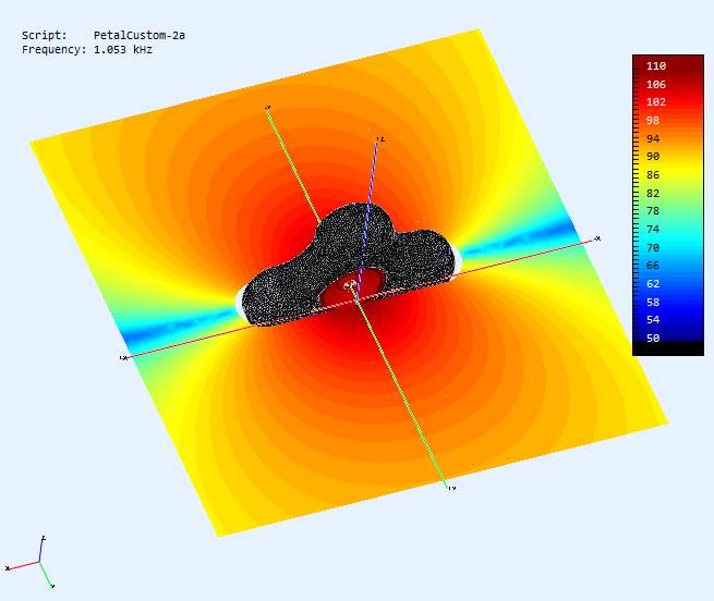

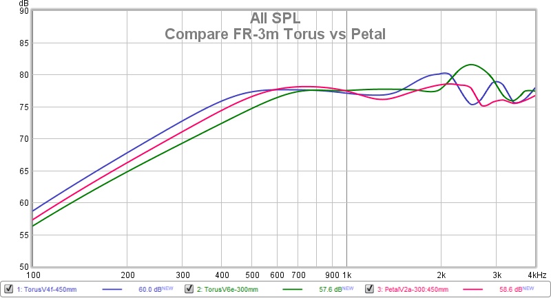

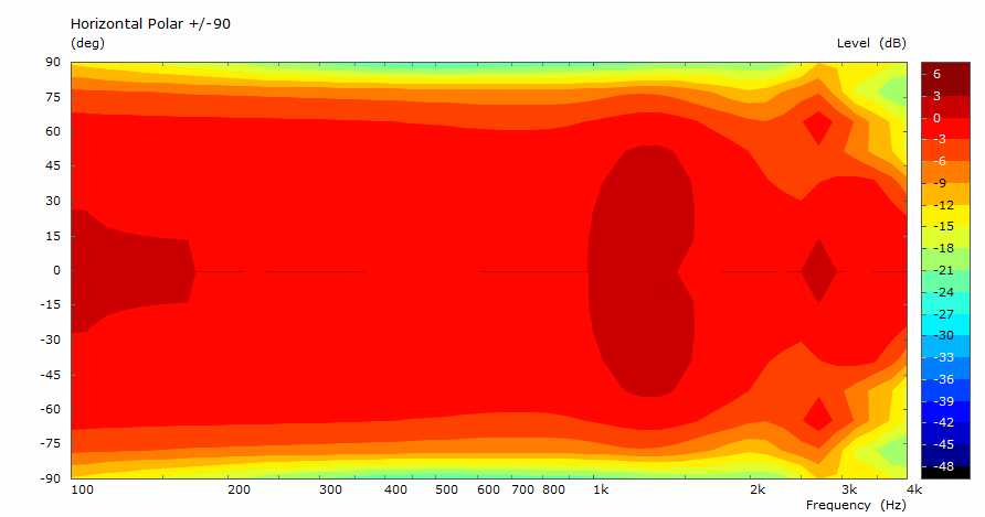

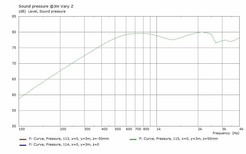

This is another torus, with a reduced OD=300mm and T=80mm. The LF rolloff freq has increased and the first peak is at a higher freq. The field shapes are the same as the previous

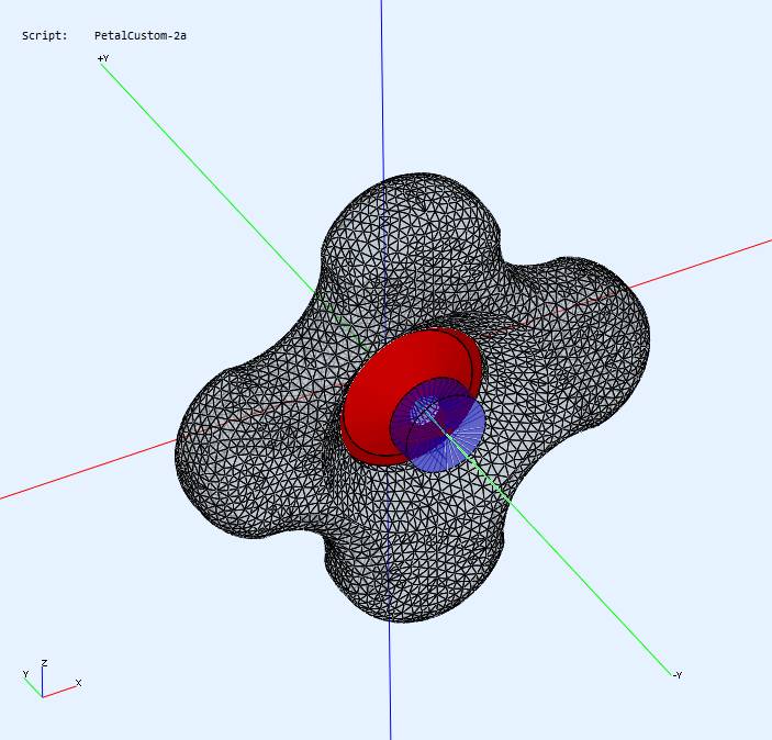

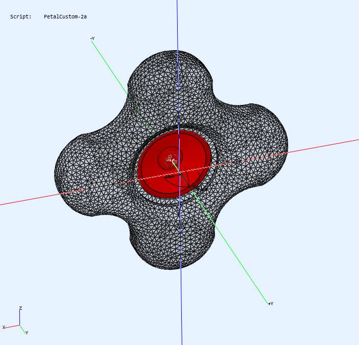

This modified perimeter with the "petal" arrangement. I would prefer odd #petals but used even numbers instead to get 1/4 symmetry for reduced simulation time. The petals vary from 300mm to 450mm, so that's 2xDriver to 3xDriver diameter. It can be compared to the previous torus sims.
The last pic has the 3 designs overlaid to compare them.

Your last couple of sims are interesting, particularly the lucky clover. At HF it looks as if there are effectively two polar patterns superimposed, a good demonstration of what happens with a varying baffle shape?
Combine the last two sims and you end up with Mattes' "flaffle" 😀
