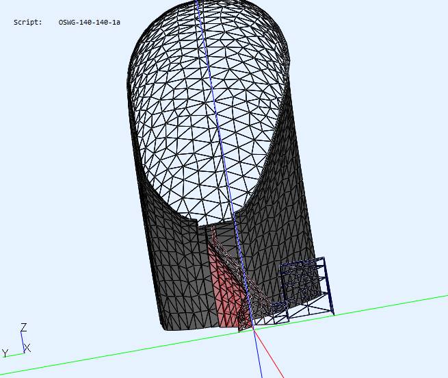

I use the built in Diaphragm generator. So it has the basic parts : 2 sided cone (front, rear), voice coil, magnet, and dust cap for the BEM side. The electrical side uses the LEM model for T/S parameters.
Try separating the front and rear cone sides by a small amount (5mm) using either "shift" or "t1".

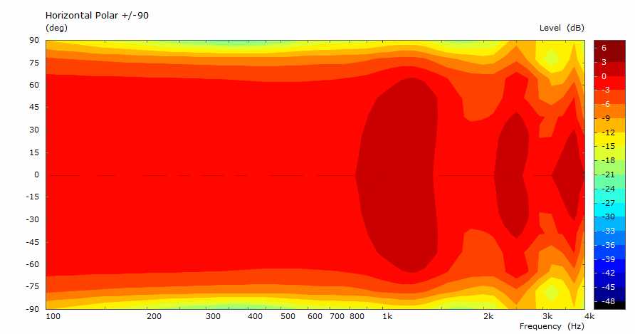

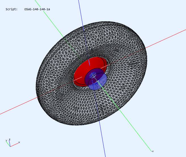

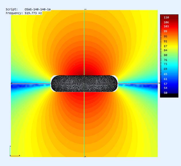

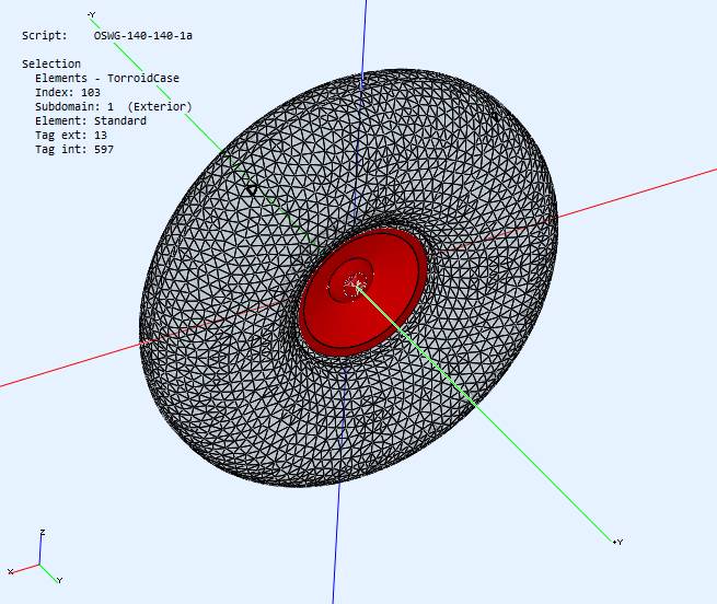

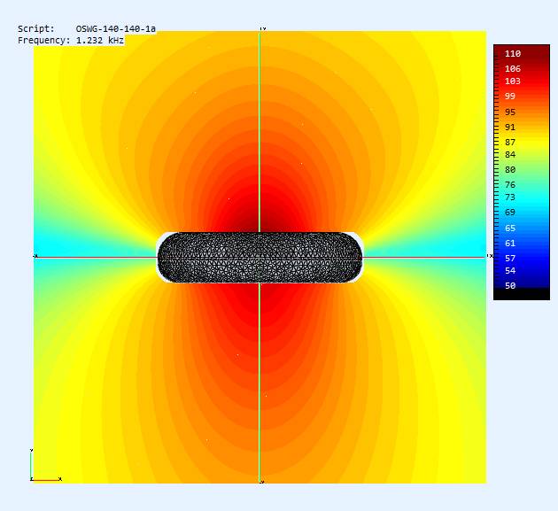

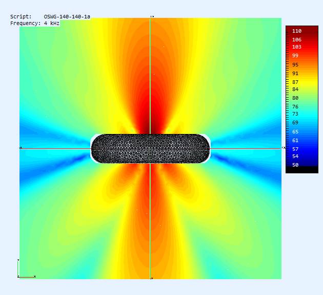

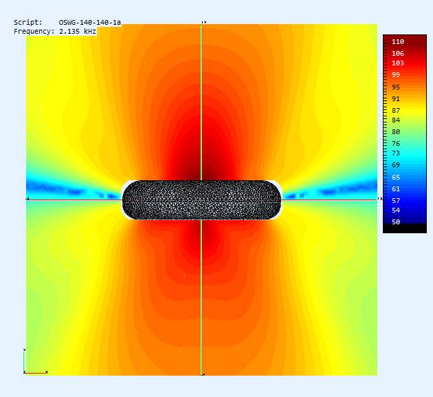

This is a continuation of the torus OD=450mm except 140deg OSWG are used for the exit profiles. It has a similar driver offset and exit areas to the previous torus Did Siegfried Linkwitz miss a trick?
Looks like it could use some more tuning. I was expecting to see less HF ripple. The driver exit profile (140deg OSWG flare) is the same on both sides, but due to the driver offset, it expands to a larger opening on the rear side.

I am using AKABAK 3.I use the built in Diaphragm generator. So it has the basic parts : 2 sided cone (front, rear), voice coil, magnet, and dust cap for the BEM side. The electrical side uses the LEM model for T/S parameters.

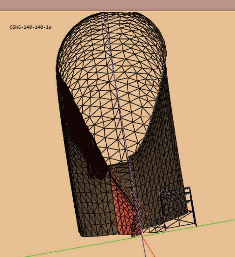

I made nearly similar BEM and LEM with T/S, 2 cones. But you use some trick to get results with only one subdomain?
On other simulations I use always 2 subdomains: interior, exterior and interface plane between them.
Can you upload or send some of you torus simulation file?

I use both ABEC and AKABAK, but this project was in ABEC so I converted it to AKABAK for you.
There is no trick, both sides of the driver are facing freespace so only 1 subdomain is needed. Imagine a naked driver suspended by a wire. This is an unusual case, normally I have multiple subdomains for the same reasons you mentioned.

Could the slower rate of opening at the edge of the driver be effecting the HF?

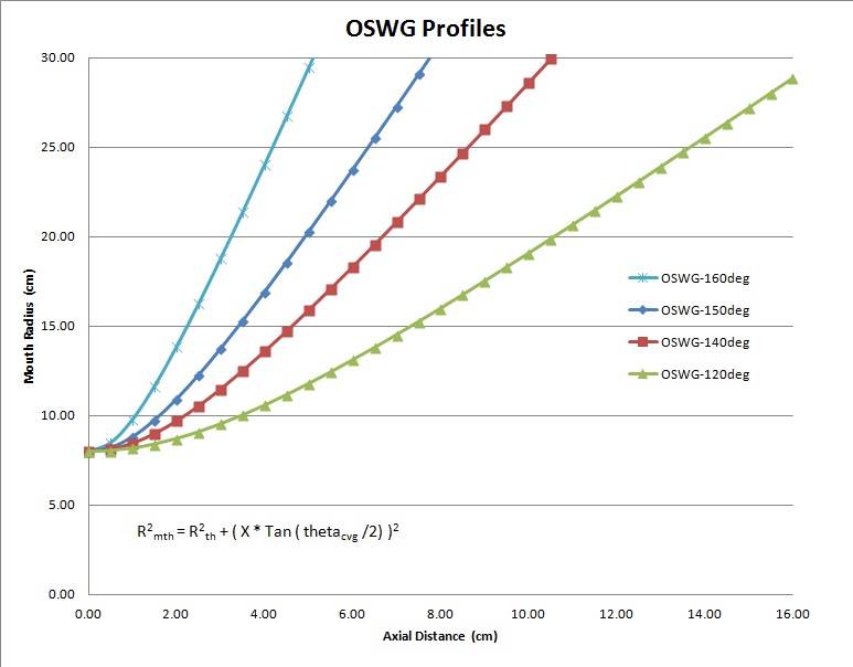

Maybe. I was hoping the deeper rear exit horn (larger mouth) would control the wavefront better (to a lower freq) but clearly it needs improving. In theory, the WG would reduce the diffraction and interference between the two sides at higher freq. It might be a matter of finding the right OSWG coverage angle. A few more trials 🙂

Can you try a shallow conical waveguide like this?
The more shallow the contour, the wider the coverage. So that drawing (moustache ?) would need to increase coverage from 140deg to 160deg. I was thinking of reducing the coverage to 100-120deg to have even more focus.

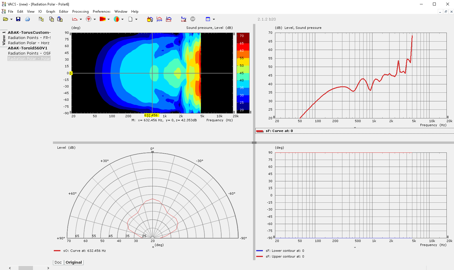

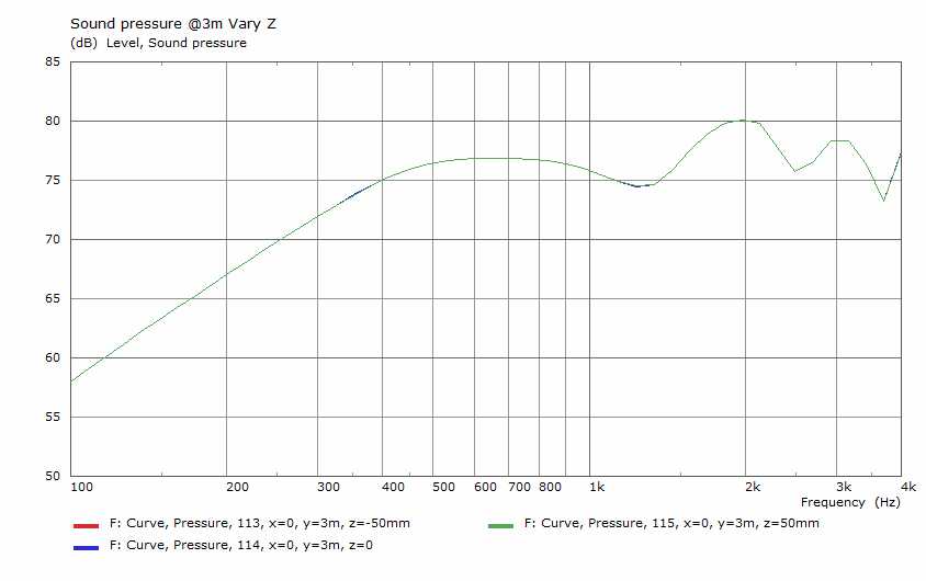

I upload my AKABAK file here. It is made basically in same way as yours, one subdomain only, but result is not reasonable....
As it is not using symmetry and lot of elements are involved, calculation of simulations take about 5 hours. Torus shape is not very meaningful, made just for testing of Akabak simulation.
