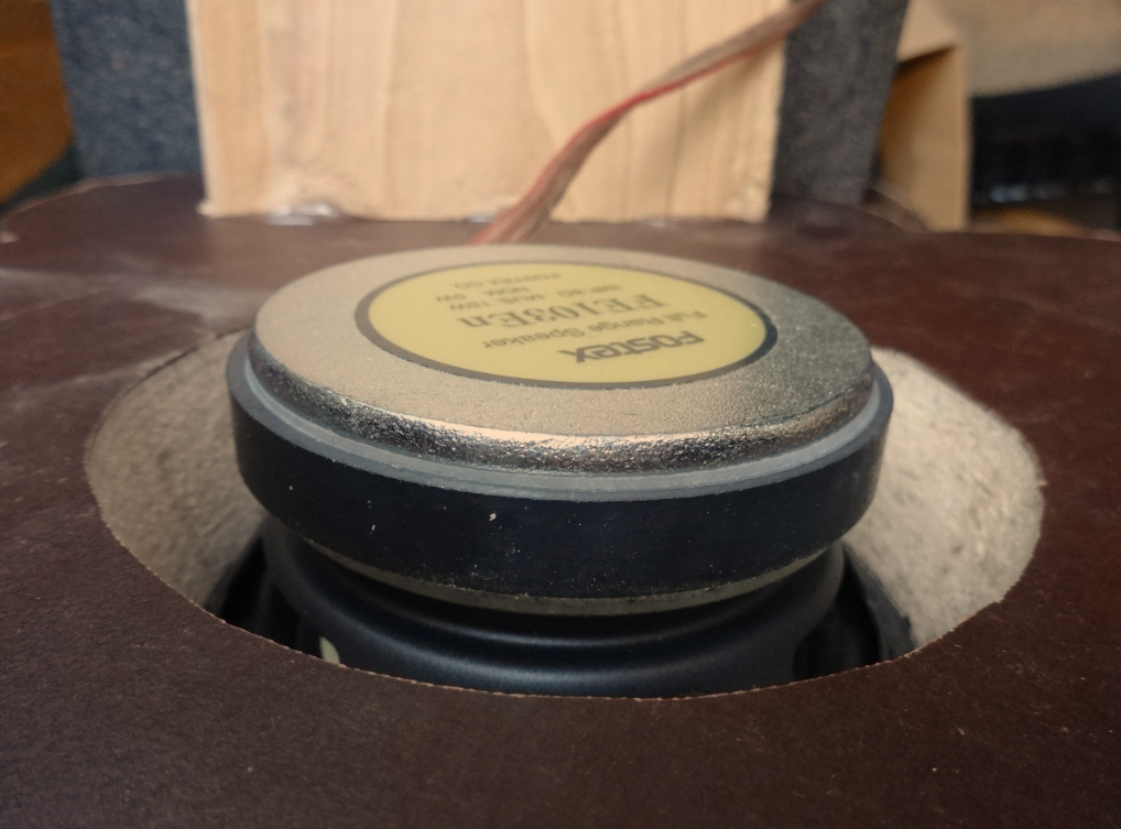

Inspired by the discussion here, I made these for my FE103En drivers. I used the cutouts from my 18" WA's - at least a better fate than the garbage can. That can happen in due time./QUOTE]
What material is that? 2" polystyrene? like stuff used for insulation.

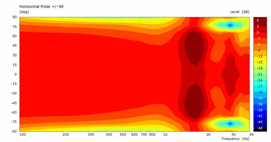

I will just refer you back to what Linkwitz wrote, and I quoted (I think in this thread?) that the on- and off-axis responses should be as similar as possible. When you have the "lines crossing" you are for example getting off axis beaming while you have an on axis null, or vice versa. If the response is EQ'd to be flat on axis, it will make the problem worse. These features tend not to go against what SL suggests is how to make the "room disappear" and the loudspeaker sound good.
The scale on the y-axis in Don's plot shows that these features are only a couple of dB in magnitude. It's up to you to decide what is acceptable, but that level of crossing is certainly not all that bad in my opinion.
It does seem quite small and over a relatively narrow angle, I could imagine listening near field with two ears 😉 it might even average out quite well?
I would think a gated swept sine, with the speaker kept off the ground and away (360deg) from other objects would be sufficient to measure diffraction. The driver is not going very low so a short gate time (3ms) would be enough to try it indoors.
Thanks, Don. It's actually 1.25" MDF, from a desktop that I'd used on another project. I'll give REW a shot with the short gate time.

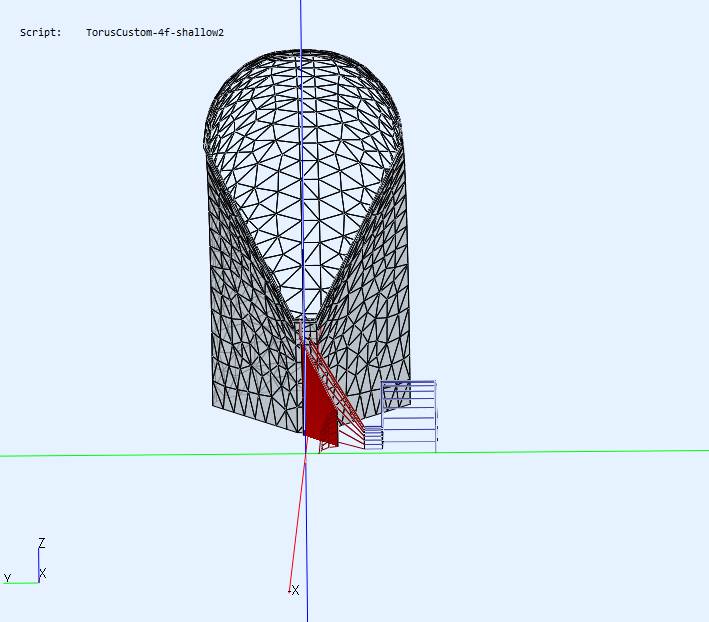

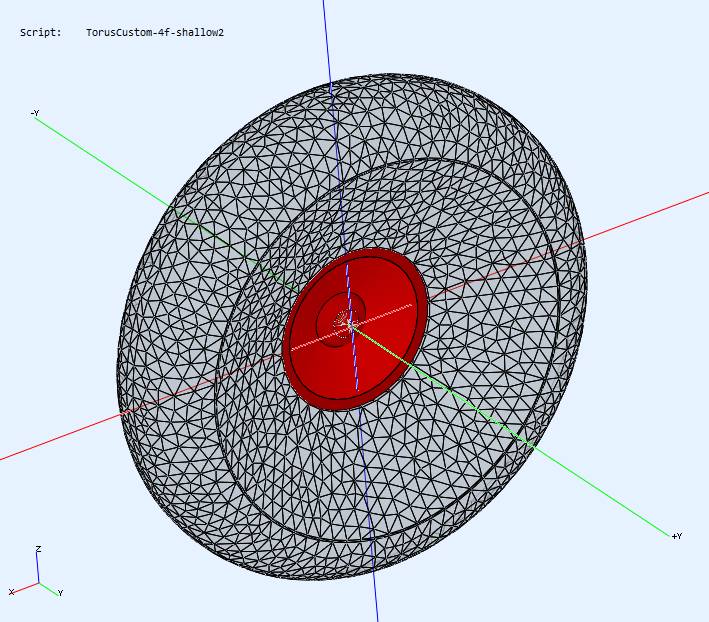

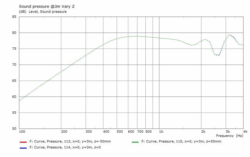

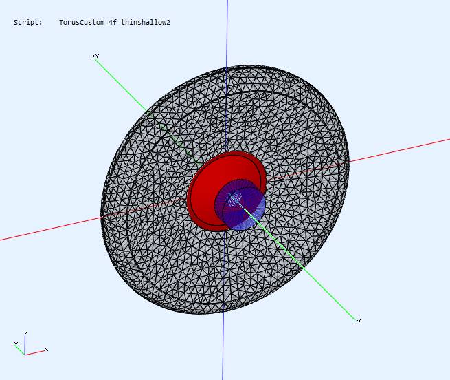

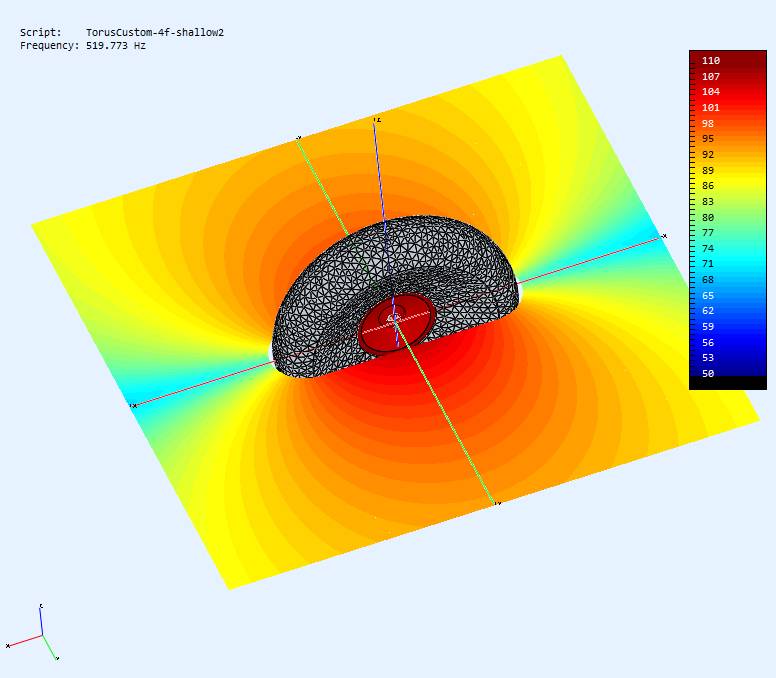

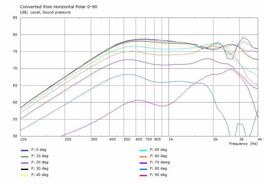

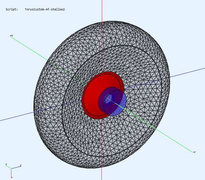

Don, do you mind, as a comparison, making it symmetrical, ie, moving the driver back to centre and making the exits the same front and back, a conical waveguide to near the edge?It's better than I was expecting. I think this improves it, because it reduced the 2K bump with little cost elsewhere. So it's good suggestion. The pic shows the axial response overlayed to compare them. The polars are similar for both.
Sure, here it is. Similar dimensions to the previous (ID=150mm, OD=450mm, shallow conical exit symmetric). What are you looking for ?

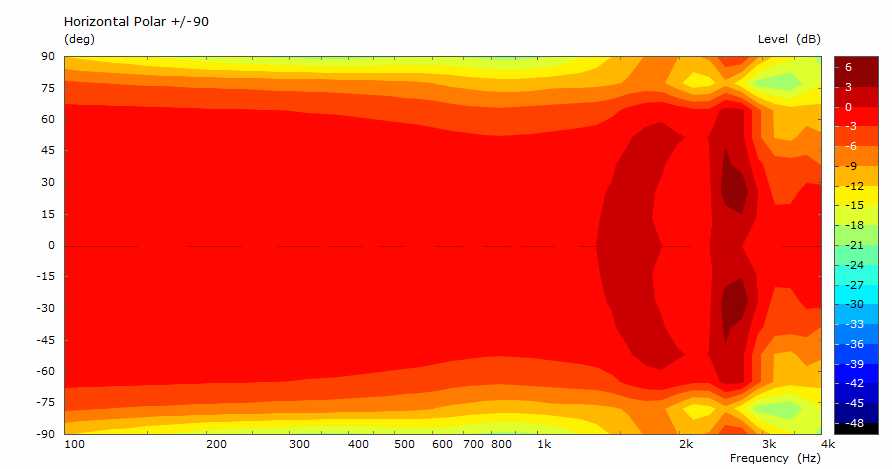

Thanks Don. That doesn't look too bad 20-30 degrees off axis 😉 I wanted to see how it compared to the original torus and how effective a simple conical waveguide is. I'm also looking for something relatively simple to construct using the starting point of a torus, ie an innertube, tyre or similar.
Why do you think it isn't as good as the last one, driver too deep?
The differences were an attempt to smooth out the axial performance. The driver was offset (not centered to create a difference in exit delays) and the exit flares were different (differences from magnet+cone backside) attempting to offset to front/rear radiation peaks/dips. What ripple was left (IMO) could be reduced by making an irregular perimeter on the torus. It could also be further refined with some surface damping.
We can test your idea by making the torus thinner. My CAD models are parameterized so I change a dimension and get a new model 🙂

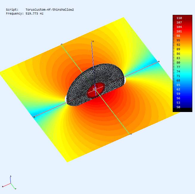

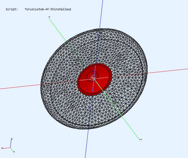

Perhaps we've been focusing too much on the notion of a torus, my idea stemming from what Earl Geddes said, it seems a shallow waveguide with a rounded edge works better.
This one has [ ID=150, OD=450mm, T=60mm] so the thickness and edge fillet was reduced (T=110mm on previous).
There are earlier torus versions presented where the torus was deep enough to make waveguides/horns for the front and rear exits. These are better IMO because they start to assert wavefront control @>1Khz and reduce the energy seen at the edges. They would still benefit from an irregular perimeter IMO. Always fun to see the outcomes.
