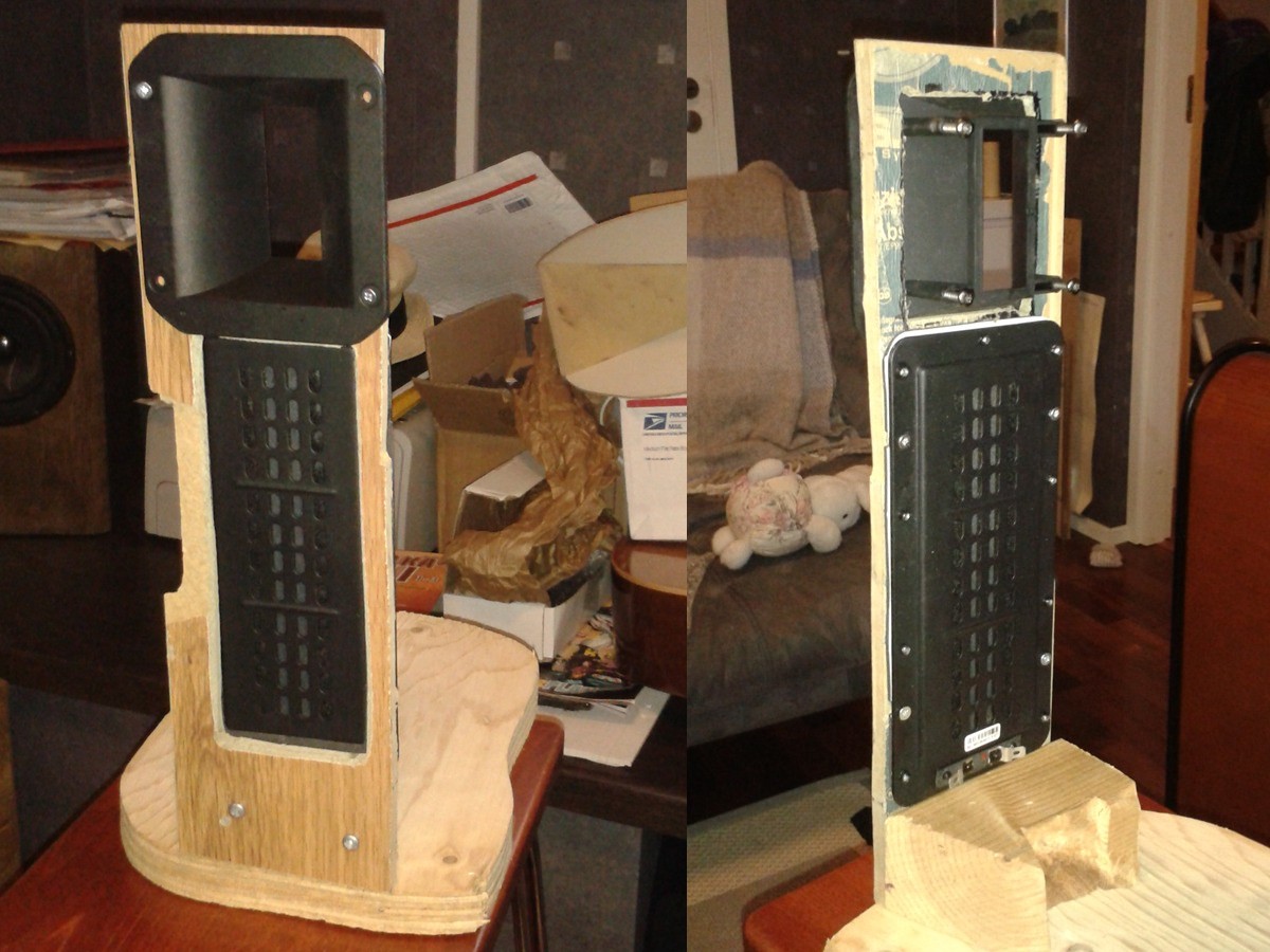

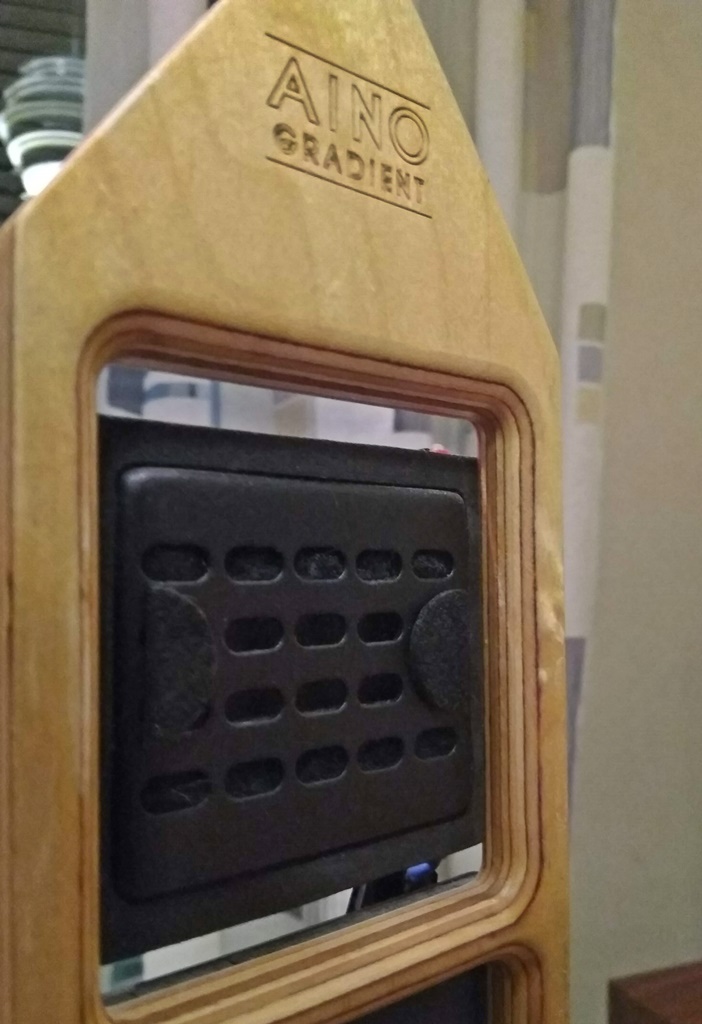

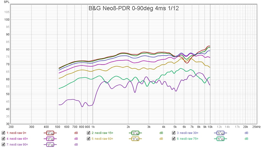

Here is planar magnetic B&G Neo8-PDR nude without eq, 4ms 1/12 smoothing, in test baffle. I didn't find backside measuements, but it is just the same, but in my AINOGradients Neo8 and Neo3 are set on plywood frame, which makes diffractions around 6-8kHz to frontal sphere because drivers are attached on the backside of the frame.

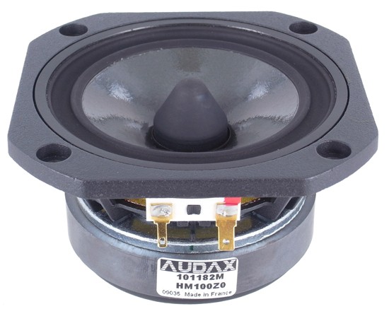

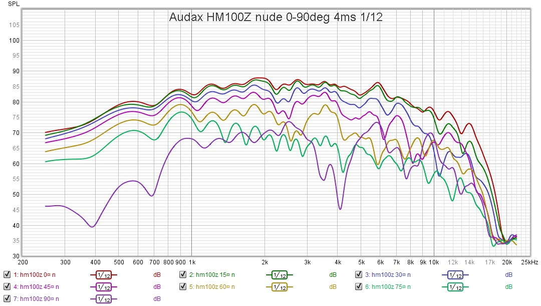

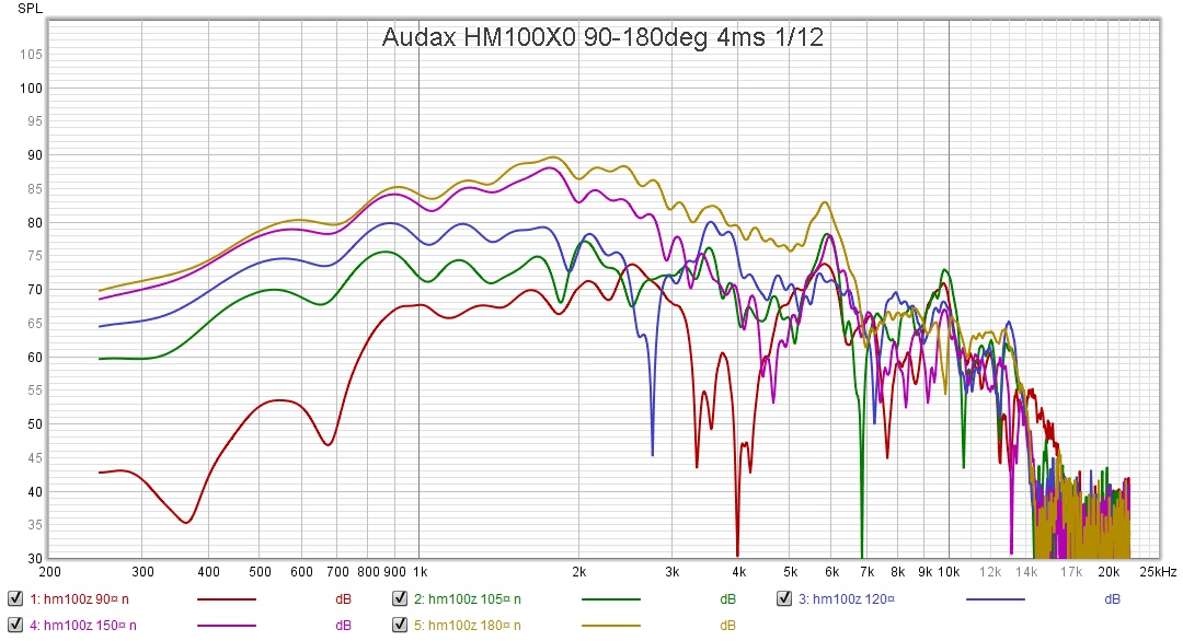

Here you are, measured by me in 2013 - a 4" midrange nude 0-90deg and 90-180deg.
Not so nice above 2kHz!
Audax HM100Z0
Thanks for sharing that data.
How important is the quality of the rear direction radiation. It must be an acceptable trade off in order to remove the box. I don't see many examples of people trying to correct it by making a phase plug over the magnet. The exception may be using planar drivers like you've shown so there is no magnet and more symmetric radiation.

My first version of AINO's had two 3" cones and tweeter with wg. It sounded very nice but measured not-so-nice off-axis. The main problem was lack of treble in the room way off-axis. On-axis sound at spot was also a bit strange, too sharp in treble, because of this.
First I replaced cone-mids with Neo8, then added a rearside tweeter. I also changes xo from LR4 to LR2. Then finally purchased Neo3 tweeters. Every change made the speakers better in measurements and overall sound, but that last change muted treble transients remarkably. Overall sound signature was however better, more balanced throughout the spectrum.
Fortunately this was a diy project and I managed to get the measurements and sound that I like! Most hifi-friends have conventional or horn speakers and they prefer the sharp sound they have at home...
