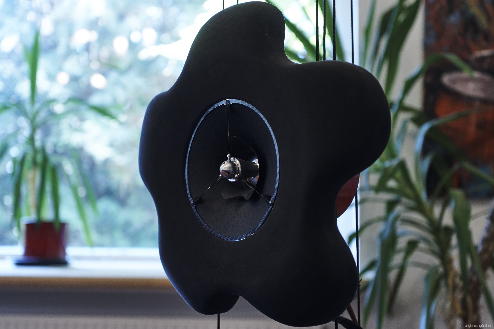

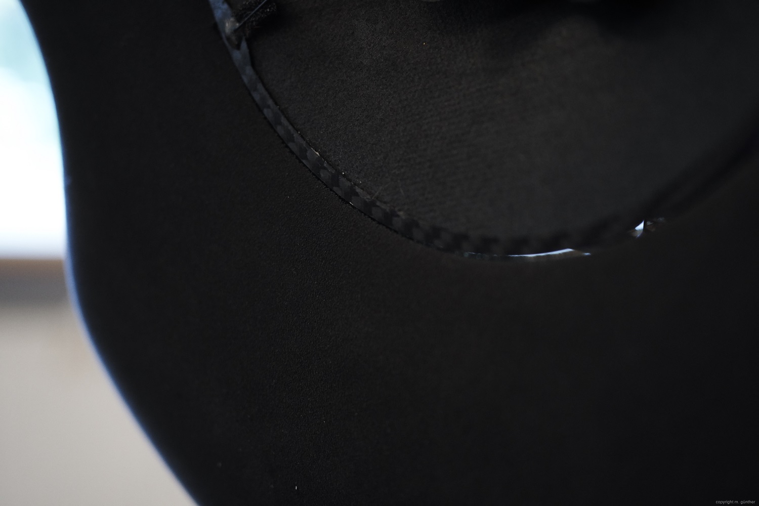

I believe these large bits are intended for stationary routers. A 38mm bit on a hand router, well... be careful. The biggest router I found would not allow this without base plate (aluminium) modifications, so I decided to stop at 25mm. And I´m always happy when this part is finished and prefer routing with my smaller, better Festool router.
Generally, I would think that a large chamfer is a nice alternative and may even be used as a design element, as Scott suggests.
Somewhere I´ve read that a rule of the thumb for roundover radius is 1/10th of the baffle width or more to be effective. But surely, the more the better applies here, and with the largest roundover possible you´ll end up with a sphere, or nearby. This will have it´s own effects on the drivers response.
From another perspective, I find it interesting to care about transition from the driver´s cone to the baffle. In the flowers, I´ve tried to maintain the most even, undisturbed flare or path from the cone´s central area to the baffle edges, and I think that this is important. For that reason, I described the flowers, even with their funky look, as a form-follows-function design. The only design element without function is the polishing of the counterweight and the AE´s phase plug...

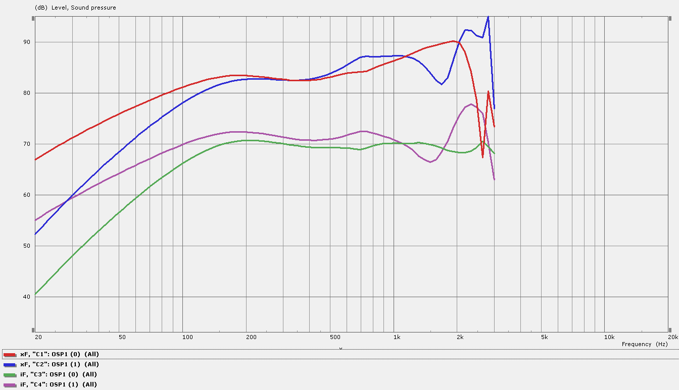

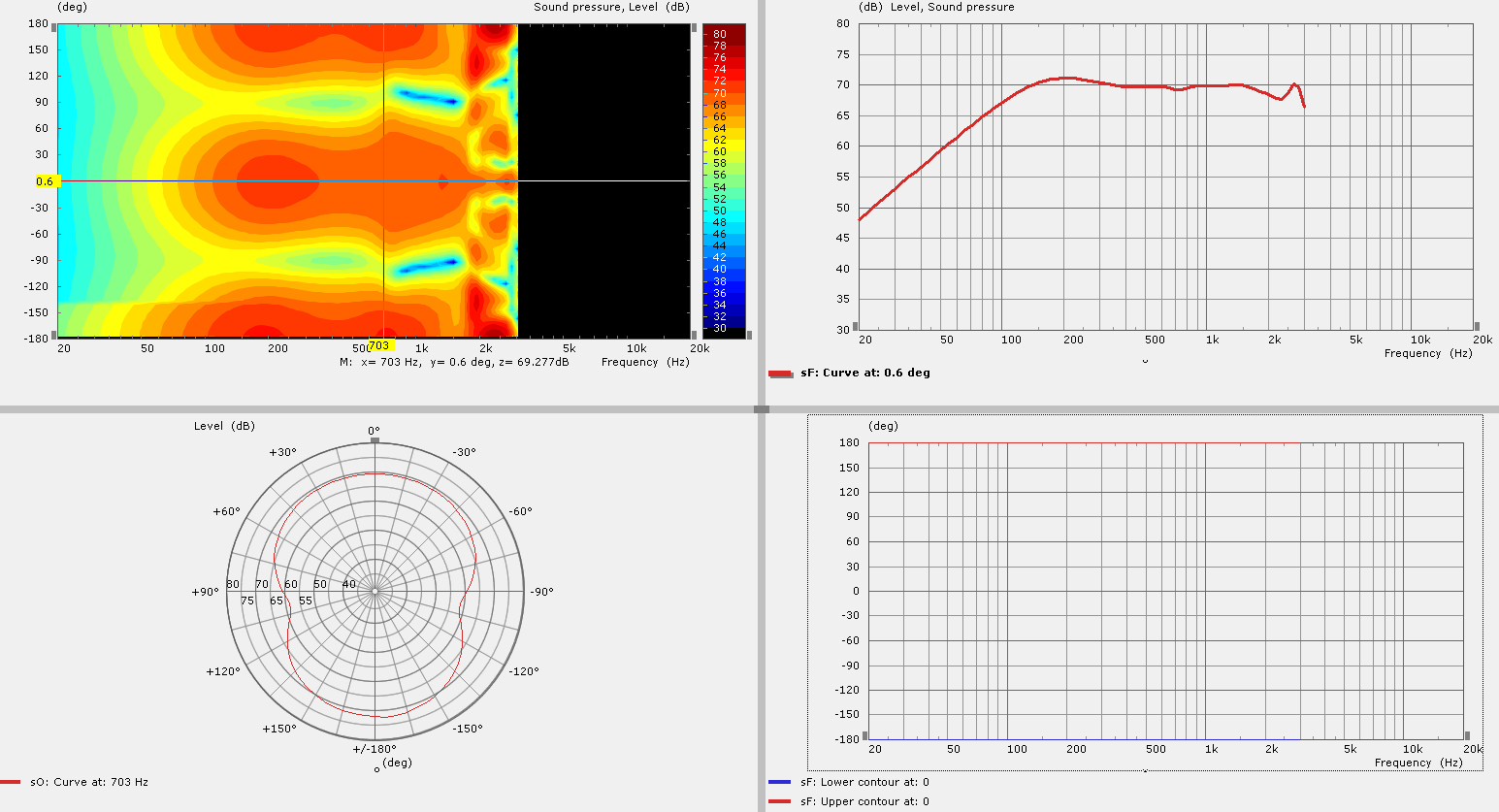

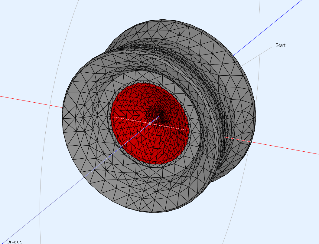

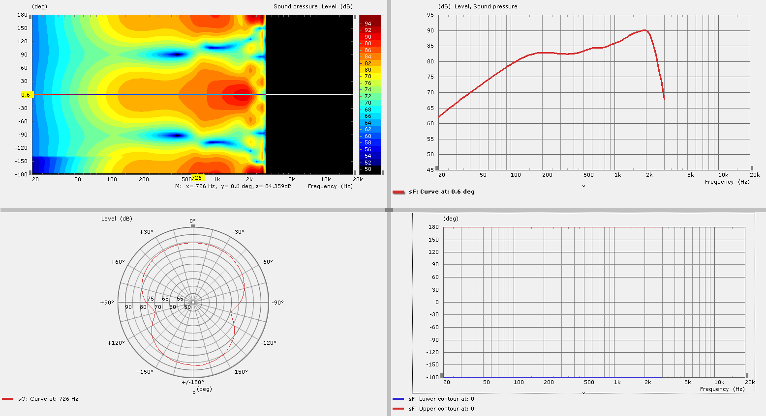

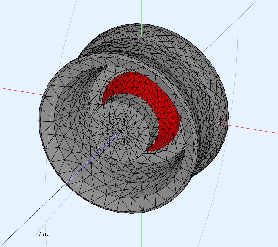

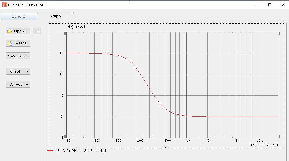

I simulated this "wheel" OB on Akabak 3 with 6 1/2" speaker and find torus like "tyre" seems better, specially in polar plot. Also this type OB drives Akabak to the limits. If I change meshing type (bifurcation vs. delaunay) or meshing size, even if mesh frequency is much higher than simulated range, I get very different results.
Some results. Wheel is: OD 260 mm, ID 172 mm, speaker 6 1/2.
Polar plot is with 2 different speaker cone meshing versions. First Bifurcation, second Delaunay meshing. Simulations are one others copy in all other details. SPL curve is compensated with +15dB low shelf filter, to get usable mid response. Results are very different. I prefer Delaunay, but its level is obviously not correct, speaker has sensitivity 87 dB 2.83Vrms/1m. Simulation is also made on 2.83Vrms and for 1 m measurement distance.
I added also on axis response comparison, C1 is Bifurcation front 1m, C2 rear 1 m, C3 is Delaunay front, C4 rear.

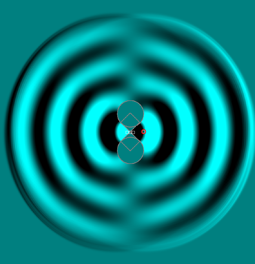

FWIW here is a Falstad simulation of the torus baffle.
http://www.falstad.com/ripple/Rippl...+559+491+0 e+0+457+531+559+633+0 P+1+559+509
It has good blending with the cone slope so the front is more free of discontinuities than a spherical baffle. However any interruption of air space has a circumferential resonance, and the torus is no exception. You can see this in the form of the wavefront wrapping around the torus and re-radiating toward the front. What the torus does is it minimizes the possibility of waves re-radiating from discontinuities before they reach the rear.

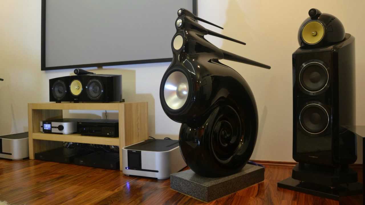

The circumferential resonance is what the long tail is for on the Nautilus speakers (image attached). On measurement microphones the concept is the same, rather than a flat back a long tail is preferred so that there aren't discontinuities at the back to re-radiate the wavefront forwards. Such features are visible in the impulse response.
Okay, to be fair I'm not exactly sure if this was the intent on the Nautilus, but I'd like to think so.
So if you want to improve upon the torus and the nautilus, I suggest giving the torus a teardrop shaped back with a long tail. This serendipitously provides a useful internal volume for an infinite baffle design. I suppose it can't be made into an open baffle without worsening the shape for diffraction. Hmmm...

In my understanding waves in a continuous medium pass through each other, they do not bounce off of each other. This can be seen in the ripple tank. Plus, my examples have no rear wave, and the second is not an open baffle.
EDIT: What that means is that when two wavefronts overlap, they don't change direction just because they occupy the same space. It would be a different story if the air density of the wavefronts was significantly different as in a shockwave.
But that does make me realize that if it were an open baffle the back wave would effectively double the diffraction.

The simulation is visually misleading in this case. If you disable the rear radiator you will see that the forward wavefront wraps around the whole assembly and radiates forward again. This is true even if the rear source is radiating. So there is still a time delayed diffraction wavefront, even if it is hidden by the main wavefronts.
EDIT: This is why I also use the pulse source and not the sine source, so that all this is visible.
