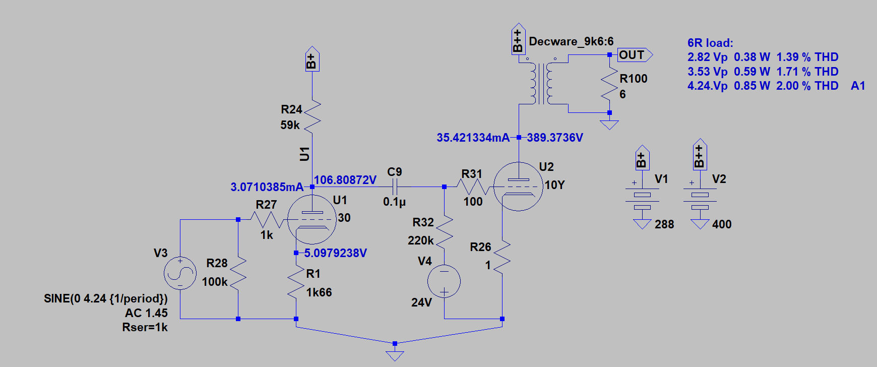

If you increase the bias voltage (decrease the anode current) the #30 will be even more unusable in this situation.
Even at 5-6V RMS capable able to accomplish this grid swing.
The "best scenario" is fix biased 10Y SE (at this B+, only A1), but in this case the A1 border at 3V RMS input.
euro21: Thanks for the simulation. If I use a thoriated tungsten tube, it will be an 01A in the driver position for a IDHT output tube. The 10Y and like look great, but they are expensive, and I don’t have any handy. Someday maybe.
The 01a capable to swing 40Vpp at 2V RMS input (active load, 300V B+) with -about- 0.4% THD.
