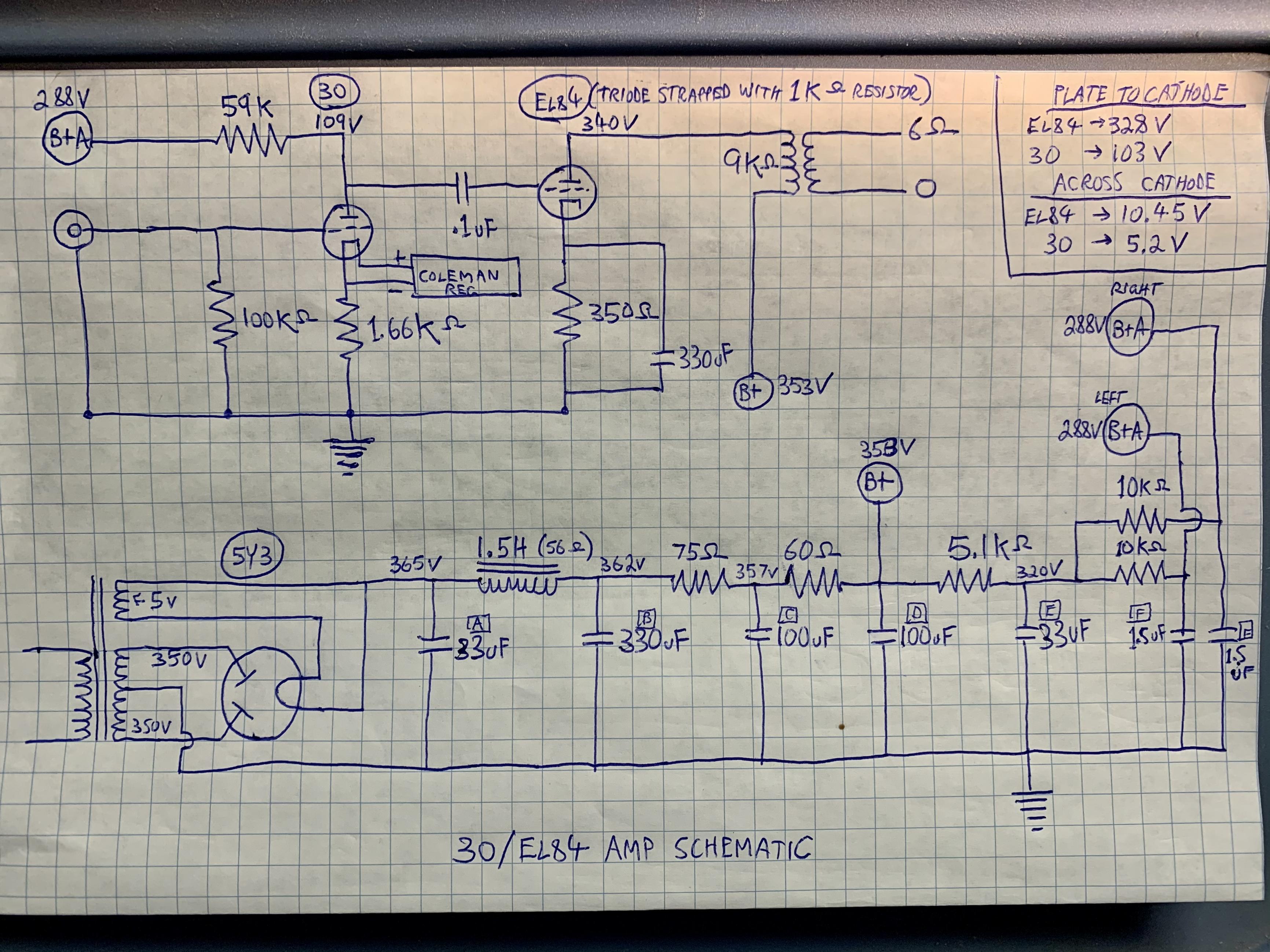

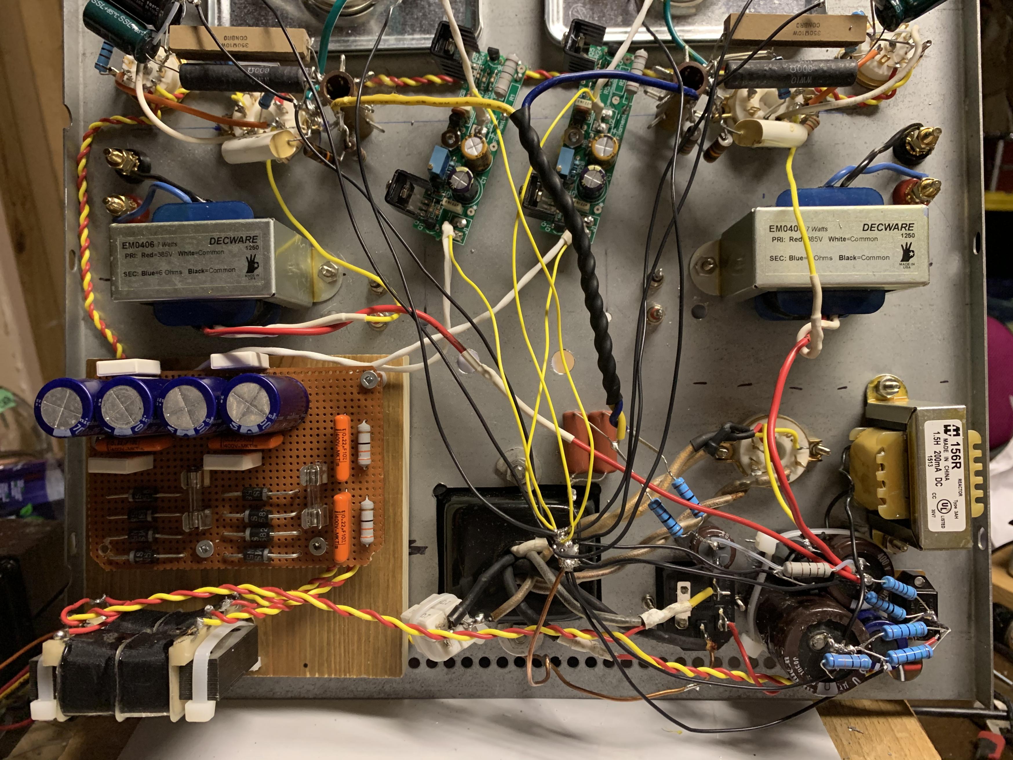

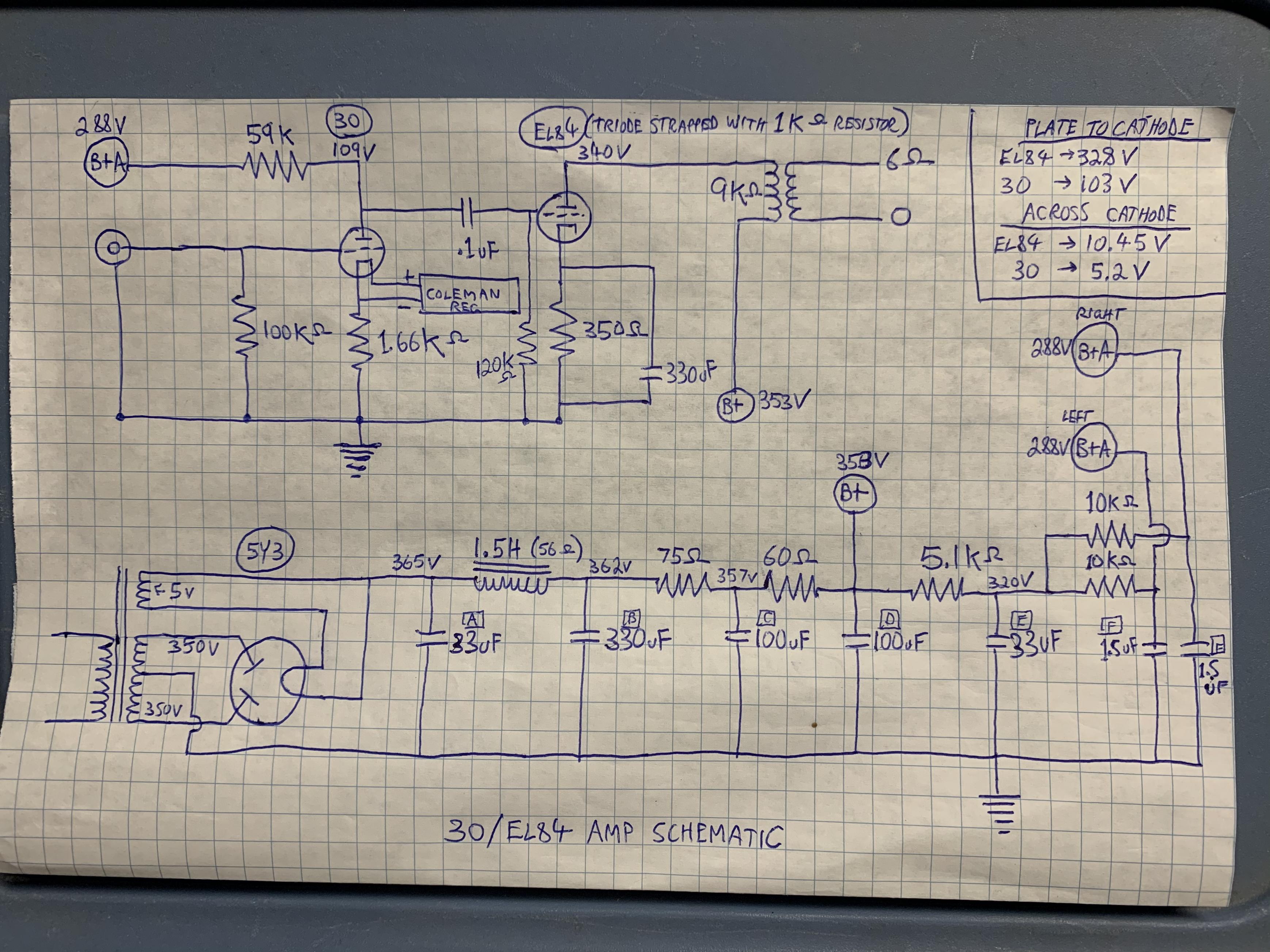

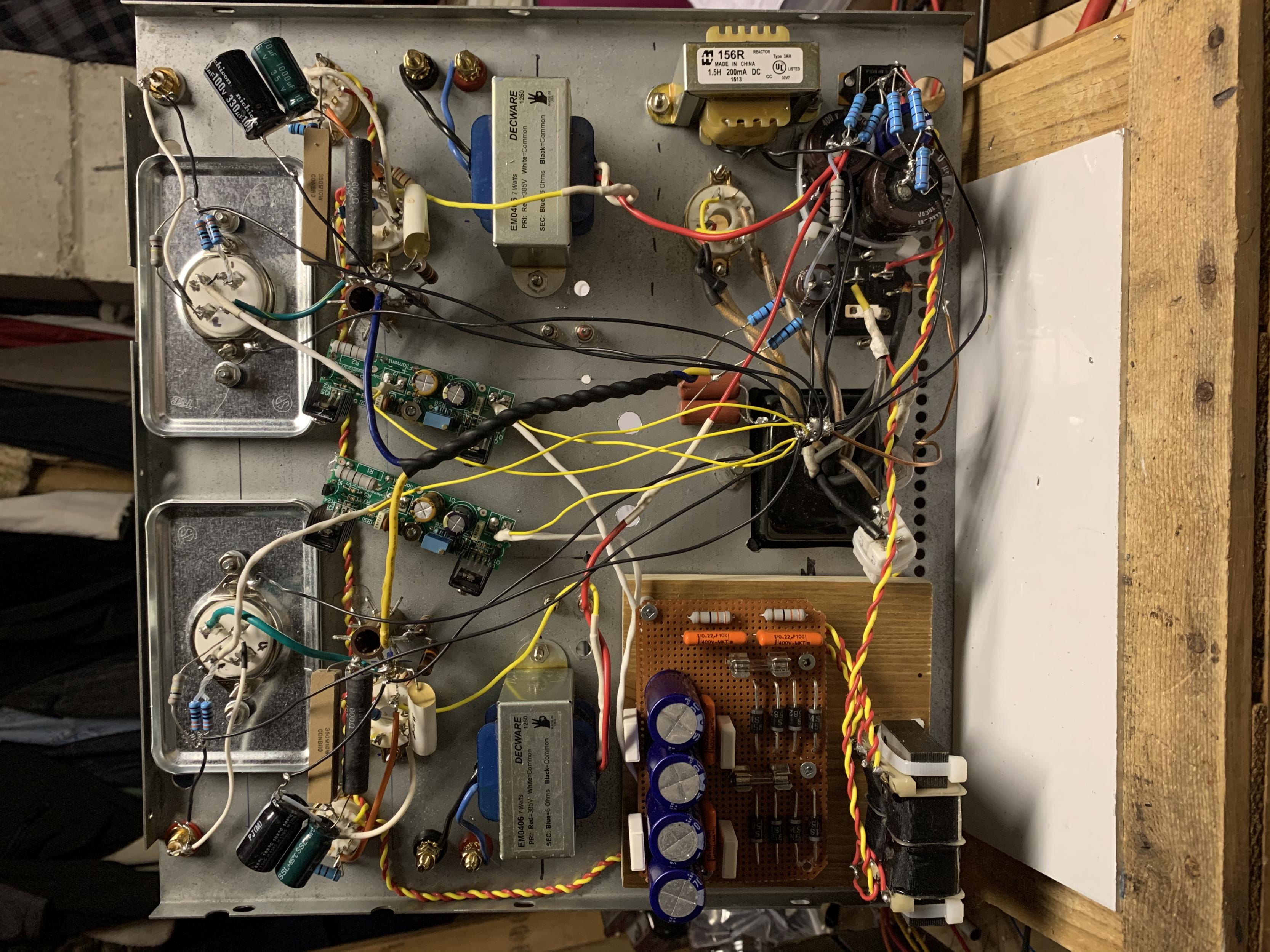

Here are three photos of the most recent attempt to get rid of the hum in the amp.
The white wires going from the raw power supply to the Coleman regulators, and from the regulators to the filaments, are now shielded pairs, with one end of the shield returned to ground with the yellow wires.
I moved the Coleman regulators closer to the sockets, and I added a ground wire to the star ground from each socket mounting plate, which was previously floating with respect to ground.
Previously, I had the raw filament DC supply in a separate steel box. I tried it with and without the box, and it seemed quieter without the box. It is now mounted on a wood platform and not connected to the chassis electrically.
Please let me know if you would like any closeups or other angles for photos.

6A3:
1. If this most recent attempt to reduce hum doesn’t work, I will try a battery for the 30 filaments next. Even if it does work, I will disconnect the regulators at some point and try battery filaments anyway to see which I prefer.
2. I am using Coleman filament regulators.
I have about thirty 30s. Please do explain.
Yes, the hum is always there, just less audible with the 6V6s. Also, there isn’t enough gain with the 6V6. It sounds nice, but will require the additional gain that my DSP crossover can provide when I use the amp as a treble amp in my two way speaker setup.

I had a 01A to EL84 amp breadboarded. I was unable to get the hum out of it in its breadboarded form. As I mentioned earlier, breadboarding is pretty useless with my current setup. The (very sensitive) speakers I use are in a different part of the house, and I would have to haul the breadboarded amp there every time I wanted to test it properly. It was an interesting exercise, and I will revisit it, but I need to better setup my work area for it to be an effective tool. Most importantly, I need to find a pair of (or a single) sensitive speakers that I don’t care about to test with.

Is there a complete schematic of your amplifier in the 300+ posts on this thread?
Which Post Number?

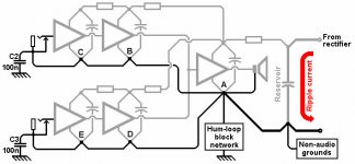

We should have been able to solve the hum problem by now, obviously we have not.
Ground loops are perhaps the most tricky cause of hum.
B+ ground loops, input connector and input tube ground loops, negative feedback ground loops, etc.
Wiring layout can also inject into grid circuits.
Wires with lots of ripple current into them can also generate magnetic fields.
The wire from the rectifier to the first cap of a CLC B+ filter, for example.
The wire from the rectifier of the filament supply to the first filter cap for another example.

Is there any chance that there is a power transformer or filter choke that is spraying AC magnetic fields at the type 30 plate?
If a magnetic part of a tube has an AC magnetic field nearby, it can cause that part to vibrate.
A part of the tube that vibrates will cause modulation of the tube DC current, in this case, it will be at 2X power mains frequency (2 alternations of magnetic field per cycle), and appear as hum.
Which Post Number?

I tried removing the power transformer and putting it away from the chassis on long leads. This resulted in more hum than when the PT was on the chassis. When I returned the power transformer to the chassis, the hum did not go back down to its previous level. It may be the PT. I will try switching the PT for a different one.
Please have a look at the photo of the amp’s bottom for an idea of the layout of parts. They seem fine to me, and certainly not unlike many of the IDHT amps I have built without any hum.

I will post a schematic shortly.

Hi Tiz,
At first, the very long (black) grounding wires from #30 ground points is needless.
At second, the #30 socket screw "grounding" also unnecessary, it's connected to top plate.
The signal (for each tubes separately) loop be so short, as possible.
Create the individual local grounding points for each stage.
The grid leak resistor, the cathode "ground", the stage power decoupling capacitor negative pole (and other part belonging to this stage) must be "grounded" here.
And after it, connect local grounding points to channel ground star point.
The cannels ground star points connected to HV PSU last smoothing capacitor's negative pole.
Finally, the top plate "grounding" must be also so short, mostly near to mains connector (via resistor ... or not ... or floating...)
p.s. Try to separate hum source, disconnect 100nF capacitor leg from EL84 grid. If hum remains, the first stage OK.

euro21: I’ll have a look at how what I did is different from your suggestions and change it. The ground point that looks like it’s on the socket screw is actually on the plate that the socket is attached to. That plate is not connected to the top plate because it was set up to reduce vibration, and there is no electrical connection between the socket plates and the rest of the chassis. I added the two ground wires to see they would help, but they made no difference.
My understanding of star grounding is that it is common practice to group the grounds by stage, signal, PS etc. and then run them to the star ground, but that individual wires from each grounding point is the ideal. I will try it both ways to see if it helps.

"That plate is not connected to the top plate because it was set up to reduce vibration, and there is no electrical connection between the socket plates and the rest of the chassis."
In this case why not "grounded" it with 10..100R resistor directly to #30 local star ground point (grid leak and cathode resistor common point)?
Each long black wire is an "antenna", must be leave of its.
p.s. Please read carefully my last sentence in #337 post!
