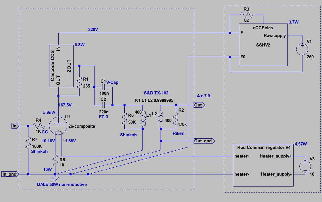

If it helps, attached my #26 preamp schematic and input->tube part picture.
The input selector switching both "cold" and "hot" wire of RCAs.
From input selector the signal "cold" and "hot" wires go to the #26 tube grid leak (Shinkoh) resistor.
From grid leak resistor "cold" point black wire goes to the channel ground bus.
The R.C regulator is near to the tube (on the side of heatsink) -next to input selector switch-.
The 10R 50W filament bias resistor "cold" point goes to the ground bus.
The power supplies are in the PSU box, connected to preamp box via umbilical.
The channels "ground" tied together only in PSU box.

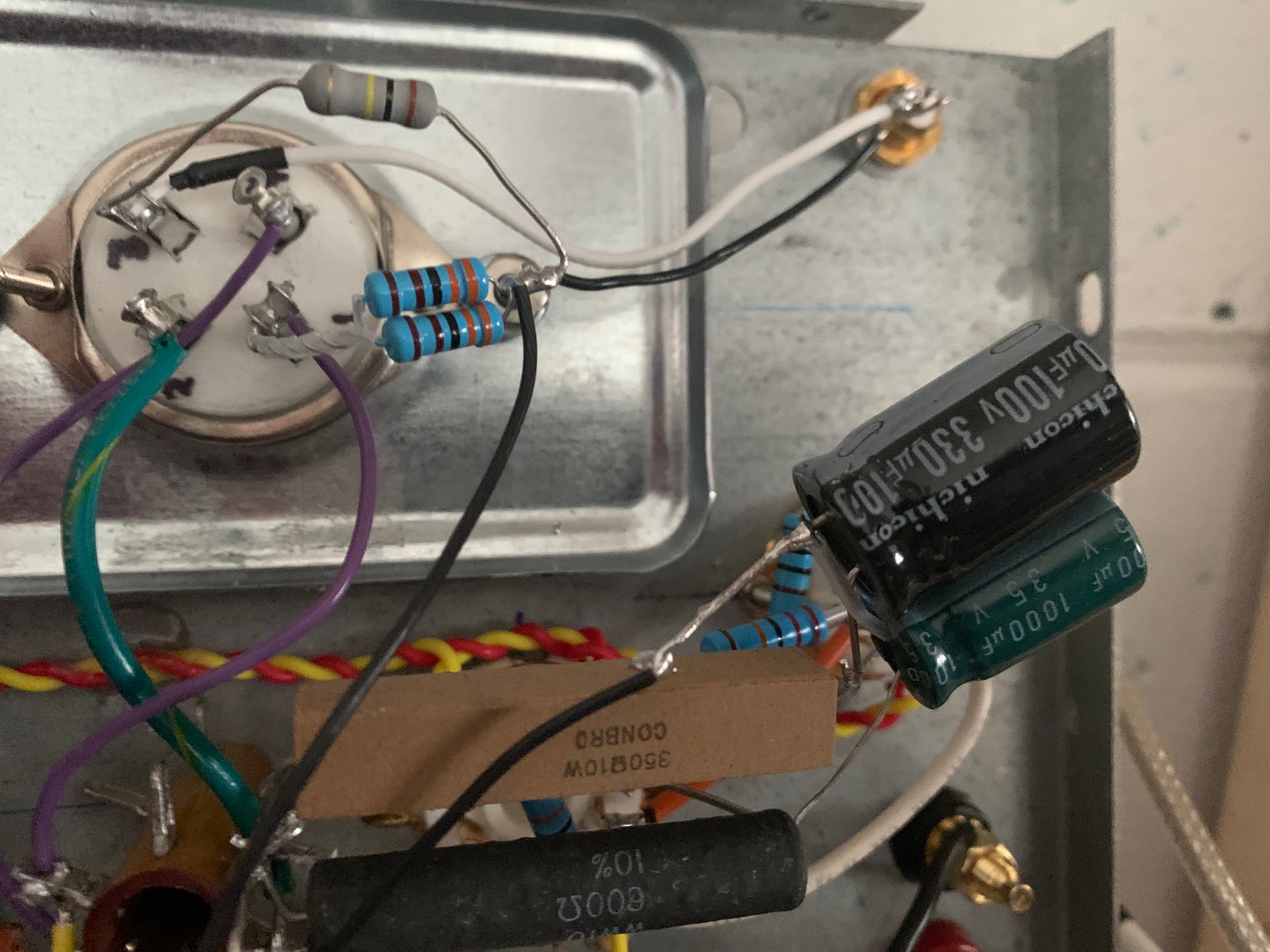

Please have a look at the attached photo for details on the inlet to valve construction. The RCA inlet is in the top right of the photo, and the 30 socket on the left.
The white wire is shielded and goes to the grid. I had the white wire's shield connected to ground prior, but in this photo it is disconnected. The hum is the same either way.
All black wires go to a star ground. The twin blue resistors are the cathode resistors for the 30. Cream coloured resistor is the grid leak. Purple wires come from the filament regulators. The green wire brings B+ to the plate. The metal portions of the valve base are attached to a rectangular metal plate that is not electrically connected to the top plate.
I have tried grounding and floating the ground of the speaker jack with no change to the hum.
Holding the loose transformer and moving it around the top plate generates extra hum only when the transformer is very close to the 30 tubes.
Before removing the power transformer, the amp had a quiet, but still audible, hum. It did sound great though. With the PT removed, and longer wires attached to the PT in order to position it away from the chassis, the hum is very loud. Taking the PT off the chassis made the hum much worse. It was not what I expected.
My feeling at the moment is that I have made an error in the wiring of the amp somewhere that is causing this problem, or that in my attempts to repair the amp I have loosened or broken a connection or solder point. Tonight I will go through the amp point to point checking part values and solders.
Please let me know if there is a problem with the wiring. It was all much neater before, but I have switched so many things around that it isn't anymore...
euro21: Thanks for the schematic. The schematic is for filament bias, so you have the negative filament connected to the ground of the input jack and to ground generally.
In my photo, the only connection to ground that the filaments have is through the 30's cathode resistor. Is this the right way to do it?
You show both a grid leak resistor and a 1K grid stop resistor. I didn't include a grid stop resistor. Should I add one?
The grid wiring looks good - I don't see any risks with that.

Is the filament bias resistor-grid leak resistor-RCA negative tied to #30 socket M3 screw?
The whole ground wire/bus structure must be insulated from top plate. Please measure it.
It would be nice to see the whole bottom wiring.
Is the filament trafo still a Hammond 229B16 ? This should work very well: it's designed for low external flux, and the split-bobbin design means low coupling of common-mode noise from the primary.
If moving the PT away from the chassis increases the hum, this suggests it is a victim, rather than a villain. Filament supply trafo (and Raw DC parts) are susceptible to common-mode noise, simply because you can't ground them. So the chassis may have been shielding the 229B16 from the HV PT, or the rectifier.
Using shielded (twinax, audio 'patch' cable, or microphone cable) cable from the Raw DC board to the regulator input is worth trying, if you have some cable at hand.
The wiring between HV PT and rectifier, and from rectifier to HV caps also needs to be short, and neat, or it can also cause coupling to the filament supply.
Rod: Yes I’m using the Hammond 229B16. In previous trouble shooting, I detached the filament PT and raw supply from the chassis plate, as it was in its own little steel box. Moving this steel box away from the chassis had no effect on the hum.
The hum increased when I took the HV power transformer off the chassis, but I don’t think it was because I moved it away from the chassis. Holding the transformer and moving it around the chassis only increased the hum when I put it right next to the 30 tubes. I think I broke or moved something in the process of removing the HV PT off the chassis.
I have a quantity of shielded cable, and I will try using it to get DC from the raw supply to the filament circuit, and then to the filaments.
The power supply wiring is relatively short and neat. I think I have made an error somewhere and haven’t found it yet.
Hi Tizman,
The filament is cathode biased, and the two resistor, the grid leak resistor, and the RCA negative are not tied to the screw. It does look that way in the photo. The entire filament supply floats.
Part of me is wondering if you're just expecting too much from the 30 in terms of hum.Before removing the power transformer, the amp had a quiet, but still audible, hum. It did sound great though.
When you say the hum was quiet but still audible, if that was at idle with no music playing, it might be as good as can be expected from a 30. After all, the 30 does have a reputation for having more hum than some of the other DHTs.
Obviously, if it was audible with music playing, that's not acceptable.
Also, it might be helpful if you could post a pic of the entire under-chassis area. There may be something about the overall layout that's influencing the hum.
Just to rule out any issues with the filament supply, I would suggest you temporarily try to heat the tube with a battery which is, of course, what it was designed to use.The filament is cathode biased, and the two resistor, the grid leak resistor, and the RCA negative are not tied to the screw. It does look that way in the photo. The entire filament supply floats.
The filament is 2v and only .06a. A single AA battery will give you 1.5v and starving the filaments tends to help too.
