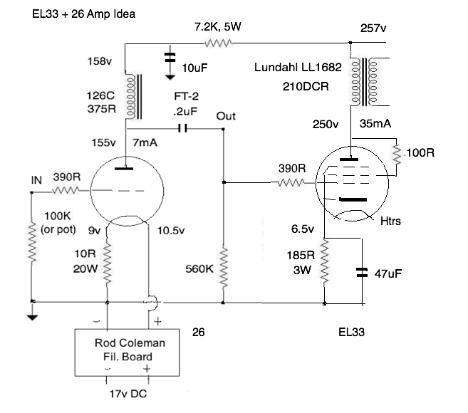

Driver stage has alternated between 26, 46, 47 and 10Y. All better than 2P29L, 4P1L or 112A. 10Y now also rare and high prices, and I've finally settled on the 26. Plenty of stocks and It sounds very good indeed in filament bias with a resistor load. Resistor needs to be 39K or more so B+ around 350V. For hum purposes, put a grounded aluminium tube over the 26s. The synergy is very good between the warm and liquid sounding 26 and the neutral and clean EL12n or E80L.

Andy: Thanks for the update! Once I finish my never ending 45/46 build, I am going to revisit the DHT to triode strapped pentode configuration. A reasonably priced DHT front end followed by a reasonably priced triode strapped pentode power section has worked for you, and you have already tried far more configurations than I’ll likely ever get to. In my case, I’ll use a 26 to a 7868, as I have a bunch of both on hand. My 30 to EL84 amp sounds good, but was not properly optimized to kill microphonics, and the use of a steel chassis caused issues with magnetics, both the power and filament transformers, inducing noise into the circuit through the chassis. That amp still sounds good, and taught me not to use steel, and to use a separate chassis for the Coleman regulator and power supply. Thanks again for the update!
