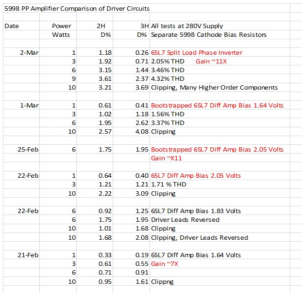

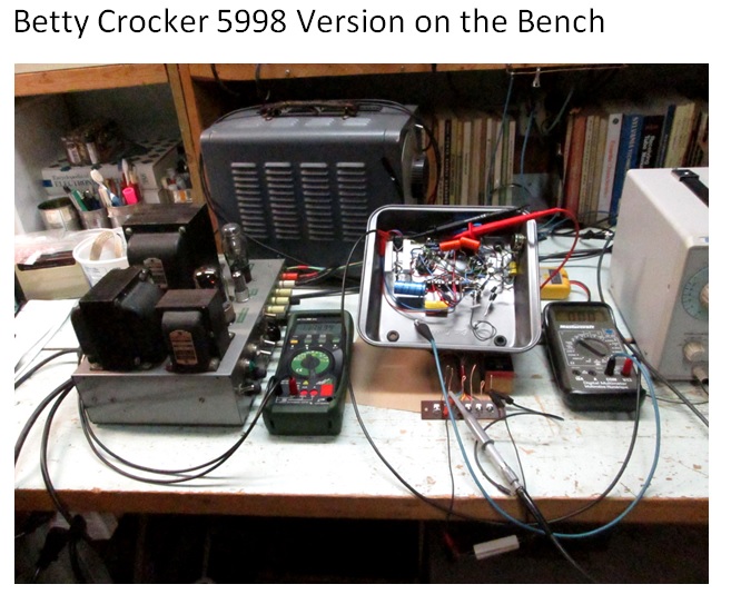

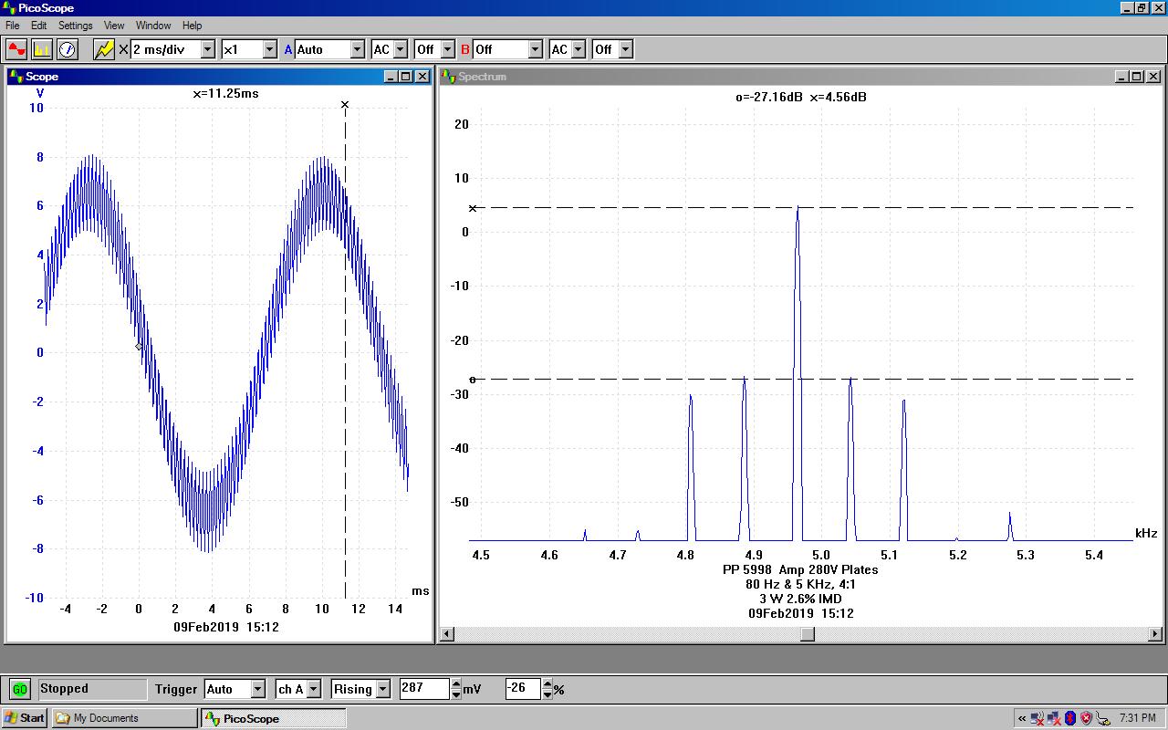

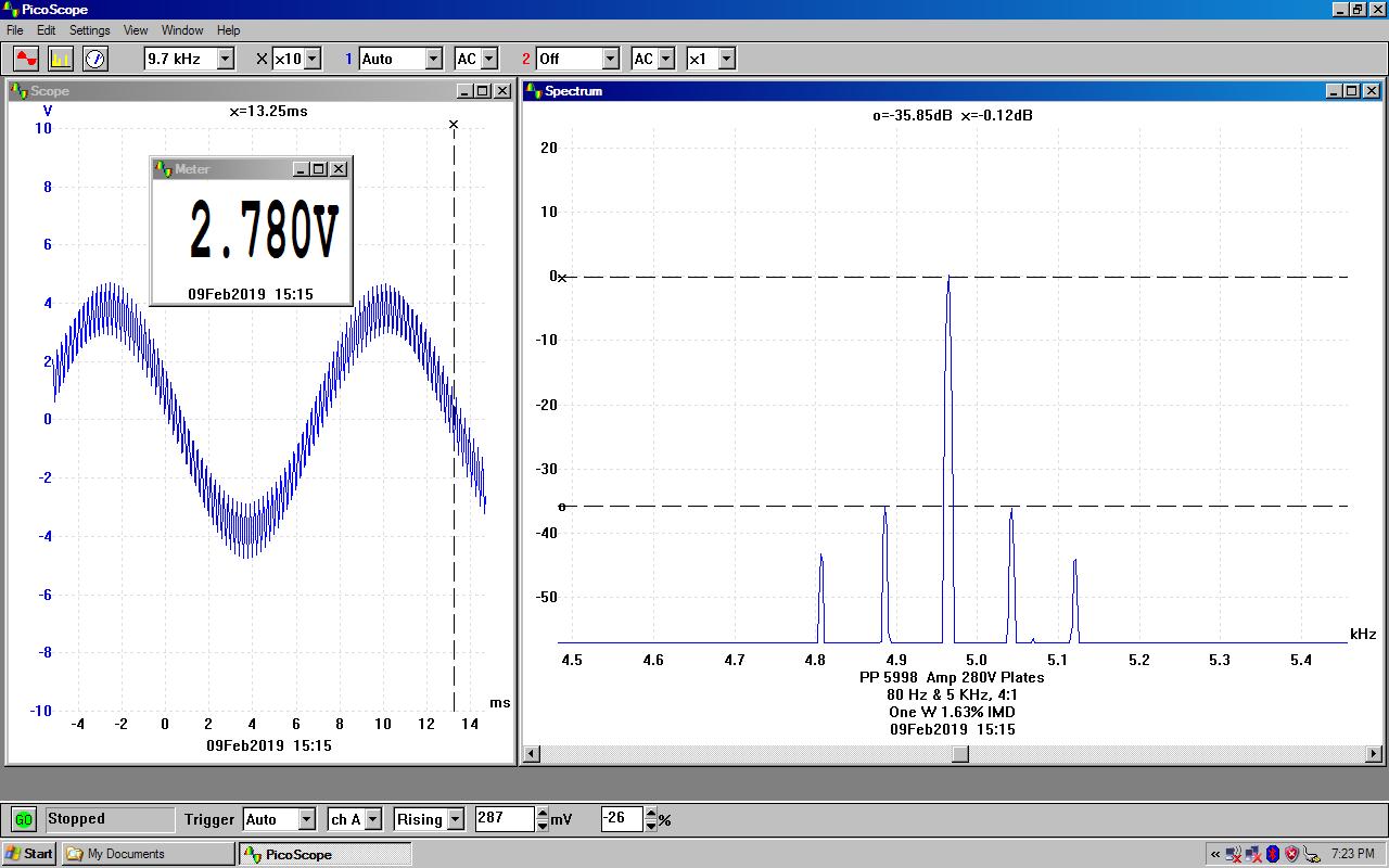

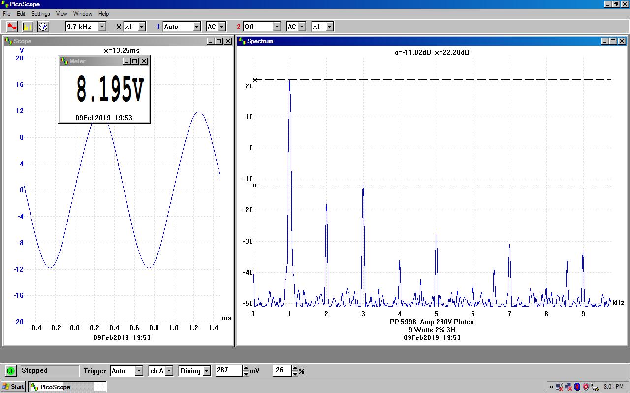

Real Performance Measurement Data on the Bench
Phoo! On all the straw men populating DIY! Lots of talk about their marvelous amps. But seldom seen is any measurement data to back up their claims. So here are some real measurements on a real PP 5998 Amp in hardware so all can see how it performs. No NFB & the 5998 is run inside its dissipation limits. Why don't we see more of this for all those marvelous amplifiers out there?😀
Its a sure thing that none of you have ever worked in a research lab. Where the application of Cooke's Variable Constant to the Measurement Data is frowned upon.😱

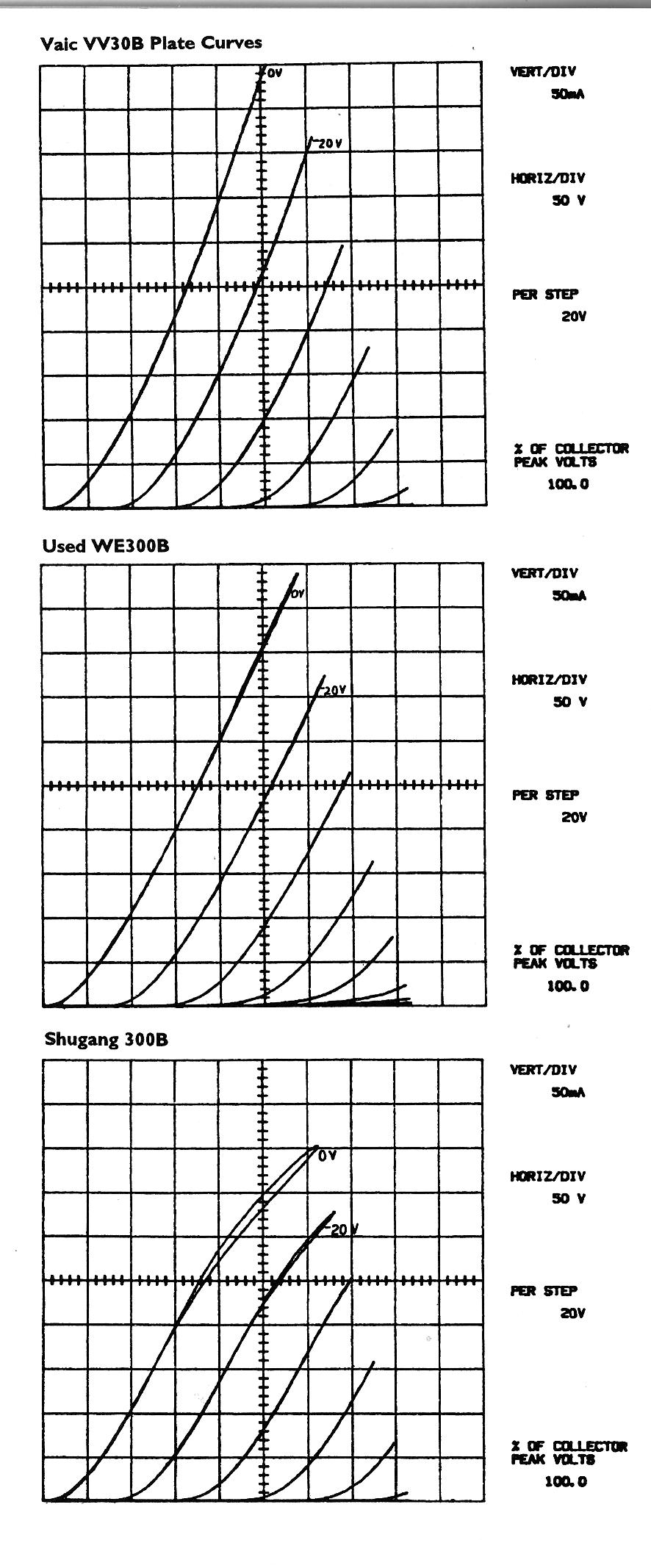

And all 300Bs are not equal. See the attached plate traces of some 300Bs run about 20 yrs ago. The Shugang sample shews sagging & open trace. That will give your expensive SE amp an interesting personality. Some may prefer that. The situation is probably not much different today.
