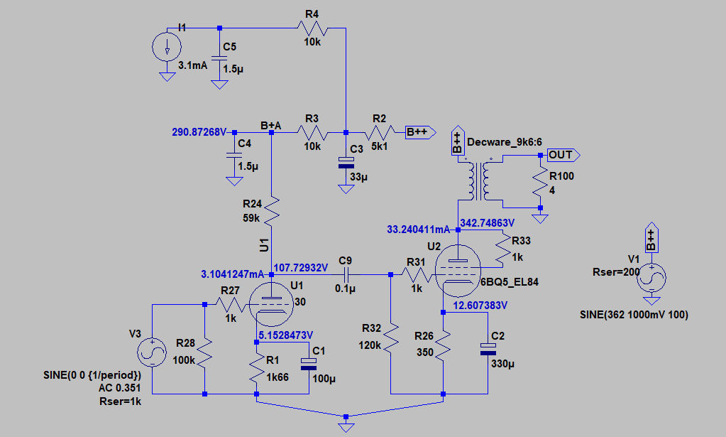

FlaCharlie: I listen to the amp daily, but I have put working on that amp aside for now as I have a couple of partially finished Pass amps (an Aleph J and an ACA) that I need to finish up. The amp took about four times as long as most amps do for me to complete. I did add a 33uF cap per side to the 30 nodes, but didn’t notice any change in sound. I am using La Scalas for testing, and they do have a -3 DB cutoff at around 55 Hz.
The only reason that this discussion came up was that several folks commented on the 2.2 uF value on the 30 nodes was “too low”, but not based on anything other than what is common usage. I asked for a definitive answer on how to figure out an appropriate value, and Bill Brown linked Loesch’s article. Other than that article, I still haven’t seen anything else from anyone else.
I don't understand this "problem". 😛
At "B+A" point al least 60dB PSRR (relative to B+) due to the PSU C-large R-C-large R-c filtrating.
The #30 anode current alteration is marginal versus output tube current, so "stressing" of PSU mainly due to the output.
The magnitude of "last C" of #30 anode circuit is almost negligible, the 1.5uF as good as 33uF.
If the B+ has 2Vpp hum, on the output only 36mVpp (shorted input), so the 35dB PSRR "thanks to" SE output.

euro21,I don't understand this "problem". 😛
Thanks for your comments.
I was one of those who had questions about the use of such a tiny cap to supply the input tubes and, as I said when I raised the question, it was mostly due to the fact that all the other designs I've seen, some from legendary designers, use a much larger cap.
Tizman speculated that the reason Decware used such a low value may have simply been to reduce cost. From what you're saying, it looks like that is likely the best explanation.
The introduction of Loesch's article, while interesting and perhaps valid in terms of sizing the B+ cap, just served to muddy the waters, though. Yes, it does discuss cap size, but it's all about the B+ cap that supplies the output tubes, whose requirements are vastly different than the input tube.
So you have confirmed my earlier suspicions that Loesch's calculations, which may be useful in sizing the B+ cap, are totally irrelevant when it comes to sizing the cap that supplies the input tube.
The Olson presentation is certainly informative but, as I pointed out, it has nothing to do with cap size at all. So it also is irrelevant in terms of determining the size of the cap that supplies the input tube.
Your conclusion seems to be that even the use of a tiny cap to supply the input tubes is sufficient. So it seems like perhaps there is no, single, optimal cap value for the input tube supply.
As for the claim that the PS forms a high pass filter, I followed the test procedure I suggested to Tizman earlier using my breadboard system.
While I'm waiting on some more DC Link caps to arrive, the cap I have clipped in to supply my input tubes is a 50uf motor run. I used a 50hz tone and listened with the 50uf cap and then with a 0.1uf 630v film cap. In a high pass filter such a drastic change would result in a much higher rolloff frequency and the 50hz tone would be greatly diminished, perhaps even inaudible.
While I have no equipment to measure with, except my ears, the 50hz output was the same level with both. So, no, it does not form a high pass filter.
I also compared the 50uf cap and the 0.1uf cap with music playing. Nothing with a lot of bass, just jazz. I couldn't hear any appreciable difference. I also monitored the voltage on the caps with the music playing and remained essentially the same and stable. It's possible that extremely bass heavy music may have an effect on voltage stability, I'll leave that for someone else to investigate.

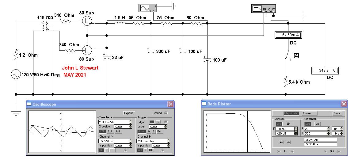

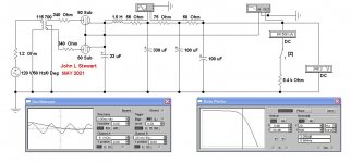

The Enlightenment Part A
Ordinary Power Supplies used with toob applications always use a Low Pass Filter. With a bit of luck that removes the PS ripple/hum that occurs at the rectifier cathode. But allows the DC to pass.
The LP filter in Tizman's PS has a 3 db down point at 5.88 Hz. Then drops like a rock, ultimately at 24 db/octave. At the point where the output stage B+ is connected the ripple is almost non-existent.
There are no vacuum tube models in Electronic Workbench. But a simple work around uses power triodes as a substitute. That way the rectifiers simulate the real thing with a 3/2.s forward conduction curve.🙂

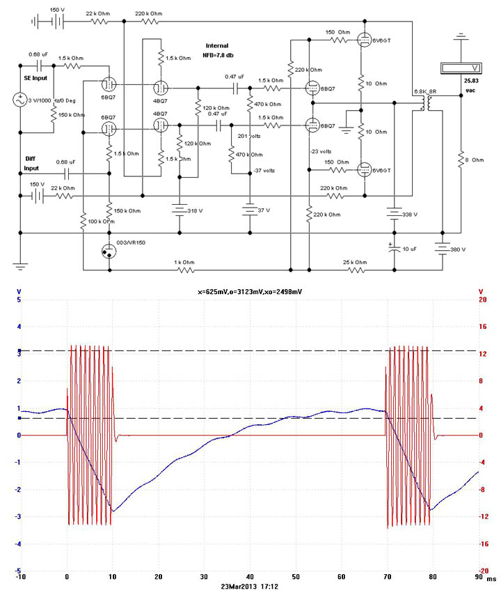

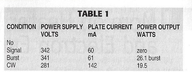

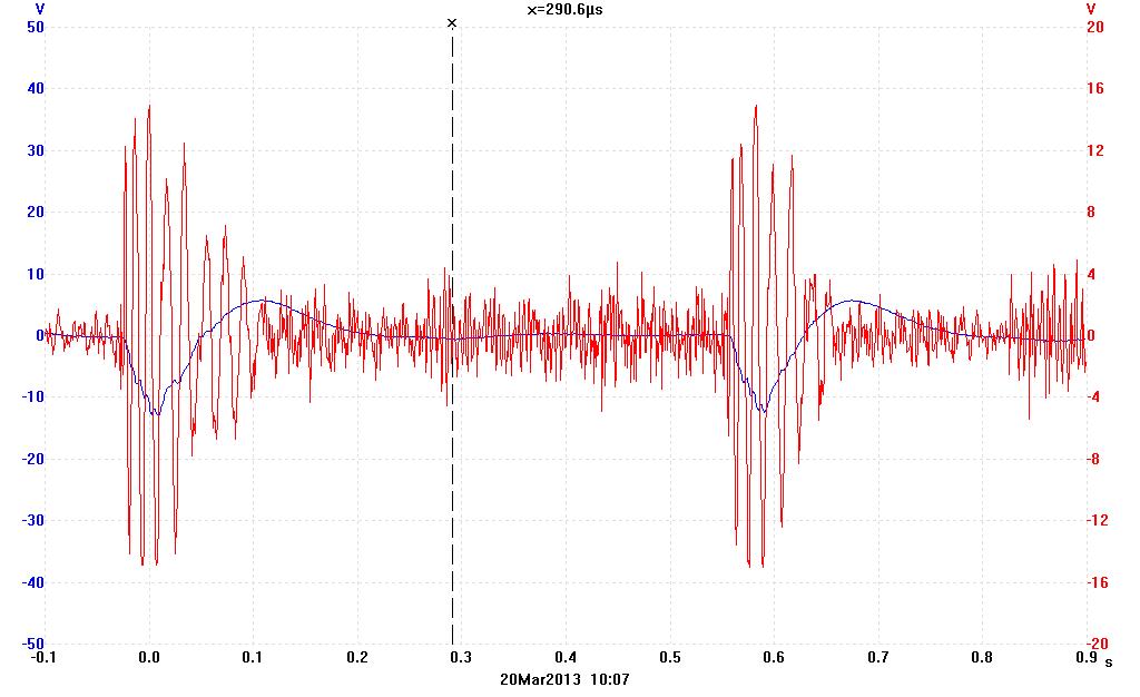

The Enlightenment Part B
IT = CE………………………a very useful relation. So in these examples we can see the change of voltage on the final stage supply cap as program material is run. The supply cap in this case was 100 microF. There are two examples, one playing a CD of Peter Gabriel’s performance of Salisbury Hill, the other a 10 Watt, One KHz burst.
The amplifier in test is another of my brain storms, Class AB2 6V6’s built in 2001. I had a few objectives in mind, try Class AB2 & measure overhead available with a limited PS. Also try a differential cascade front end with output plate NFB to the upper grids of the cascade. The PP loadline is corrected for Class AB2, that is the steeper line.
Peter Gabriels performance results in a 12V drop on peaks (blue trace). Stuffing the numbers into the relation tells us the extra current supplied by the final cap for about 50 ms is ~24 mA.
The 10 watt bursts of One KHz look like only 3.7 mA. Need to check that, looks like the 10X probe was not dialed in.
The Burst Gate was built in about the same time.🙂

jhstewart9: I asked the question initially to see if I could find a method to work out a capacitance value for a given node. Several folks told me that the value chosen for the capacitor on the 30 tubes in my amp was too low at 2.2 uF. I asked how to work out an appropriate value, and Bill Brown linked the Loesch article. There has been some questioning of that article’s relevance and correctness, but I’m still waiting for someone else to tell me how to do it properly if that article is incorrect. Nothing yet....
“the 1.5uF as good as 33uF” is the case when listening. In fact the other amp to which I added capacitance to the driver power supply node sounded worse with the extra capacitance.
There was no hum from the B+ once the bias resistor bypass capacitor was added. This of course is a separate issue from the capacitor sizing.

All I have is a digital meter. When I experimented with the tiny .1uf cap I did connect the meter to the cap and watch it during startup and later with music playing. I was measuring voltage, though, not current, since increases in current draw would lead to a decrease in voltage. And I was measuring the cap that supplies the input tube, not the B+ cap that supplies the outputs.If you have a analog multimeter pls check charging and discharging pattern of the capacitors. Usually charging is smooth discharge is not. Yes, in general Film caps are better.
I saw the same pattern with all the cap sizes I tried (.1uf, 5uf, 50uf) during startup and with music playing regardless of cap size. With music playing the voltage only varied a tiny bit. This variation was in the range of .1v to .2v but it didn't seem to correspond to the music so I figured it was most likely due to small variations in wall voltage. Perhaps an analog meter would be better or some other more sophisticated equipment.
The graph that John Stewart posted seems to be the most accurate and revealing information that's been presented in terms of showing how much charge a music signal is actually drawing from a supply cap. I'm not sure how he measured it or if it's a simulation. But, as with the Loesch article, the graph shows the effect on the B+ node that supplies the power tubes. I would expect the results to be quite different if the input tube supply cap was being measured.
I've never spent much time trying to determine an "optimal" value for any particular PS cap. I've always figured that having a bit more capacitance in reserve is a good idea but just don't go so large that it has a negative effect.
So I just try to strike a vague balance. I doubt I could hear the difference between "ideal" and "close enough".
Calculating the minute details may be an interesting technical exercise for an EE or someone who enjoys that aspect of design, but my brain doesn't work well in that realm.
Of course, smaller caps recharge more quickly than large ones. If you play around with the cap charging calculator I posted, you can see the details.Yes and no. Usually charging and discharging time and the smoothness for these functions are better for smaller caps, be it elec or film.
So I figure the balancing act is to use a cap that recharges relatively quickly but is not so small that it ever runs out of current. Of course, this assumes that the ripple is acceptably low.
That would suggest that the under 5uf caps that you and Tizman are using would be good choices to supply the input tube. But, as I said, I couldn't hear any difference between 5uf and 50uf when both were film caps.
