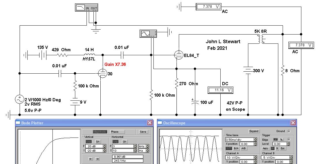

For Tizman's amp the easy way out is a common 9V battery at the bottom end of the 30 grid lead, the negative end pointed at the grid. Here again only microamps are required so long as the input signal does not draw grid current.

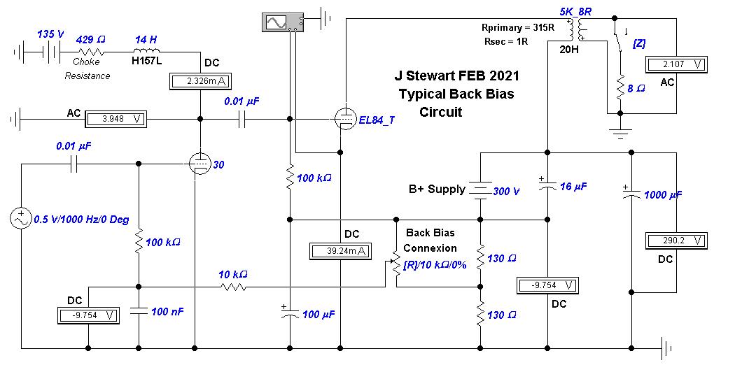

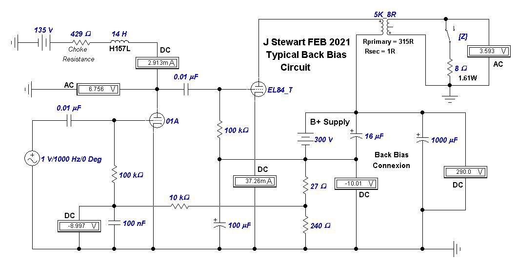

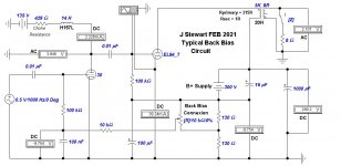

Another slick way out is back biasing, also popular with the olde timers. The required bias is developed in the amp negative return lead to the PS. Easy to do, no pain suffering or agony. I'd bet a few DM that Wiseoldtech has seen some of these too. 🙂

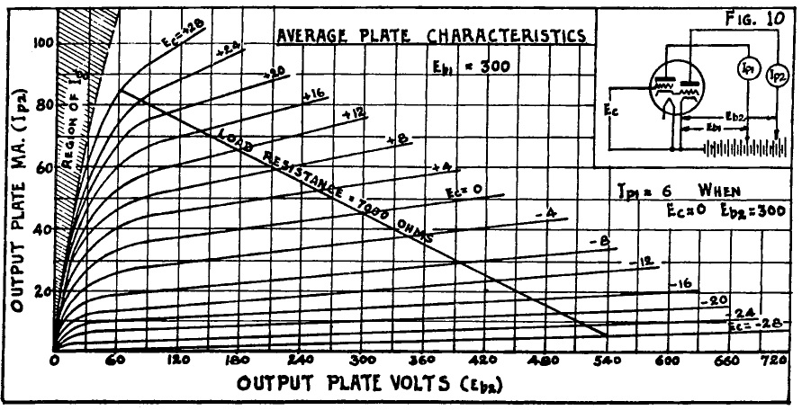

Without counting the squares in order to estimate the plate resistance rp of the 6B5 slope of the plate curve looks about 1/3X the load Rl, so 21K. We can get a very good first estimate of damping factor (DF) of a tube by comparing the plate resistance to the load resistance in the circuit. DF is approx Rl / rp, so looks like about 1/3rd (7/21) for the 6B5. The OPT will reduce that further to the load. Very much like a pentode

As an example, the DF of the 45 at 250V is 3900/1610 or 2.42. That will provide a lot more control to the loudspeaker than what is possible with a bare 6B5/6N6G...............DF ~1/3rd.

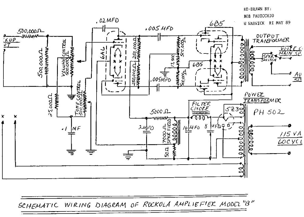

One amp using these is the Rockola, schematic attached here. Not sure how many were built. I think Wurlitzer used amps built by others, perhaps some were this one. The Wurlitzer amps I did see were usually PP 6L6s. Maybe someone could enlighten us.
Many designs published in the '90s faded quickly into obscurity. This one has not. It's a highly regarded design which is still recommended today as one of the best for those who want to build a 45 SET. I suspect hundreds (possibly thousands?) have been built since it was introduced. Perhaps there are better designs out there, but it's an excellent amp with a long-established track record. So if "catching on" is the measure of a good design, it seems to qualify.
Yet, somehow, my 26 - 6N6G "inverted" SET sounds better. And not just by a bit. More realistic and detailed. Much better soundstage. When playing thumpy, bass heavy tracks the bass is solid and well controlled. Not a hint of flabbiness. And it sounded better with all of the various types of DHT input tubes I tried, including the 30 and probably 8 or 10 others.
So, if the 6N6G is as much of a turd as has been suggested, the amp's superior sonics must be the result of my design brilliance.

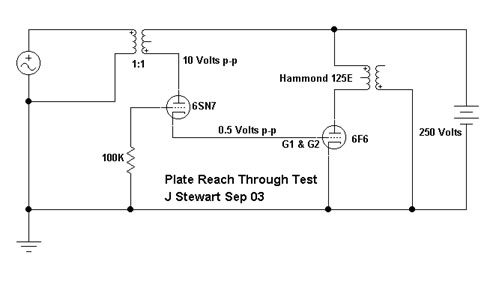

Think I mentioned in March you can connect the 6B5/6N6G driver plate to the output plate & get a lower mu triode like the real thing. But audio power is limited, just as it is when we do the same thing to an ordinary power pentode. Someting you can easily try to satisfy your curiosity.🙂

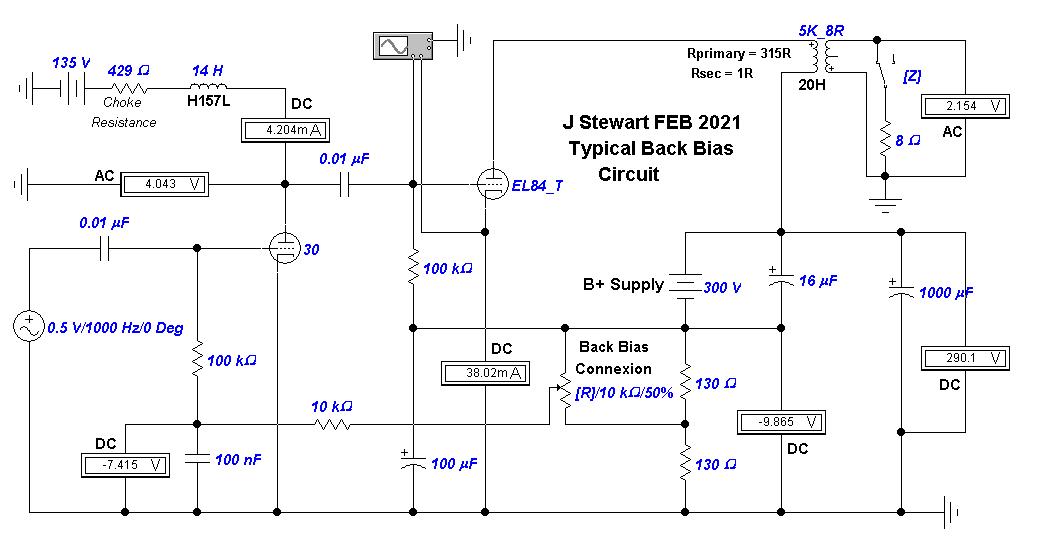

Adjustable Back Bias for the 30
This simple hookup allows the plate current of the 30 to be set over a range of 2.3 mA to 6.5 mA.😎 Max bias sets minimum current as we would expect.
Thanks for the sims John.
I remember that you suggested connecting the input plates to the output plates, although you hadn't previously commented on how this would affect the tube's amplification factor.Think I mentioned in March you can connect the 6B5/6N6G driver plate to the output plate & get a lower mu triode like the real thing. But audio power is limited, just as it is when we do the same thing to an ordinary power pentode. Something you can easily try to satisfy your curiosity.
I tried it and the maximum power output does go down a bit but the sound is even more detailed and the bass is better. I need to spend more time listening but my initial impression is positive.
Does this method add feedback and affect the damping factor?
I'm wondering if that's the explanation for the sonic change or if it might just be the change in the voltage supplied to the input section plate. Previously, the input's plate was about 21v higher than the output section's plate due to the drop across the OT primary.
Would there be a difference between supplying the input plate directly from the output section plate and supplying exactly the same voltage from an additional RC in the power supply?

With the plates tied it's operating the two sections in a sort of "quasi parallel" configuration. How that works electrically, I don't know. I don't grasp these technical aspects well.
To test the question I asked earlier - if the effect was simply voltage related - I did try adding another RC section to the PS and varying the resistor value. This brought the plate voltage on the input section closer to the output plate than it was when I had it connected to B+. It behaved the same as it had when it was connected to B+. Maximum output was higher than with the plates connected and it seems to sound essentially the same as connecting to B+. So the change in sonics is not simply due to a change in operating point.

So in view of the above I've made an amp with linked sockets for both EL12n and E80L. Both freely available in Europe.
Driver stage has alternated between 26, 46, 47 and 10Y. All better than 2P29L, 4P1L or 112A. 10Y now also rare and high prices, and I've finally settled on the 26. Plenty of stocks and It sounds very good indeed in filament bias with a resistor load. Resistor needs to be 39K or more so B+ around 350V. For hum purposes, put a grounded aluminium tube over the 26s. The synergy is very good between the warm and liquid sounding 26 and the neutral and clean EL12n or E80L.
So there we have it for a tried and tested combination which is simple, very good value and has the DHT sound in spades. Just 2 stages so very direct and detailed sound. I'm happy and all my 300bs, 2a3s and 6C4Cs are back in the cupboard. Putting the DHT first in the chain really works - it's a true DHT sound and I love it, especially on vocals and piano, but tone is good all round especially on acoustic instruments. I'm not going back to 300b/2a3 with high gain indirectly heated tubes. That was a cul-de-sac for me, never liked any of the driver tubes the way I love DHTs.
But an EL84 does not need a lot of gain. I was more interested in the 3a5 sound in the way that Andy ticks off boxes for his preferences.
You need to get 26 tubes from the USA. Buy a bunch while they are good value.Where do you get your type 26? Have you tried 3a5? Now they are really cheap and plentiful.
I've tried pretty much all the usual DHT small tubes - I invested in a lot of stock, most of which I've sold. I've listened again and again to all these in A-B tests over 15 years. My shortlist eventually came down to 26 or 10Y. Honourable mention to 46, 47, 2P29L, 4P1L, 112A. And 01A superb if you have the right circuit but I don't use active loads. Yes I tried 3a5 - good like a lot of other DHTs but didn't make the shortlist. I sold off a number of perfectly good DHTs - amongst others 30, 30 special, 31, 71A, 3a5, 2E22, 1624, 1G4, 1H4, 1J6G, 3B7.......
I tried 3A5 as preamp and much prefer #26 "sound".... but now -for years- use 801.
