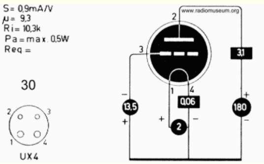

I had moved the pots because I wanted to try the many different 30s that I have on hand without having to go into the amp each time, and as a way to to be able to easily test and compare them. I’d rather avoid the hum and put up with going into the amp to adjust though. I’ll put it back where it was.

I changed the pot back to the original one and put it in its original position on the PCB. The hum seems to be unrelated to the position of the pot, as it was basically the same after moving it back.

Thanks for the quick reply Rod. It appears that the pot wasn't the source of hum. If it is the tube itself picking up hum, the only thing nearby is the 6.3 Volt filament heater wiring for the power tubes. If that is indeed the culprit, would DC elevating those heaters help? DC elevation is easy, and I'll give it a go if it might help. I am considering using DC heaters on the power tubes if DC elevation won't help.
With respect to the proximity of the filament regulator PCBs to the power transformer, the PT transformer is top mounted, with a small part of it under the chassis, and it has end caps so the portion below the chassis has a hole where the wires go through, but is otherwise shielded. The PT is mounted with 4 silicone washers between it and the steel top plate. While this may be the issue, moving the regulators further away from the PT didn't make any difference to the hum. The large pots that were top mounted were much closer to the PT and had about 4 inches of wire going to them. Going back to the original pots on the PCB also made no difference to the hum. I just don't think the hum has anything to do with the regulators or the pots.
The B+ is super clean, and the amp has a star ground.

I have a few pairs of metal shields that fit the 30 perfectly, and I tried them a few days ago. They did not seem to affect the hum. DC elevation or DC heaters for the power tubes are probably my next step.

I tried shielding the twisted pair of heater wires that go by the 30 tubes, but that didn't make any difference. I tried elevating the heaters, because that was easy to do, but that made no difference as predicted. Based upon these results, and on your advice on DC heaters, I think I have exhausted the possibilities related to the heaters on the power tubes and their wiring.
I am left with two possibilities. One is that the PT is inducing hum into the circuit through either the top plate or through direct radiation, and the other is that my DIY raw supplies for the filament regulators are to blame. I am going to use two of the Coleman raw supply boards that came with the filament regulators and see what happens.
One thing I observed that may be relevant is that the hum volume increases briefly when I shut off the amp. This is not something that I have ever come across. Normally, whatever residual hum that I have had in an amp has immediately disappeared once I switched the amp off, and the music would continue briefly with no hum until it faded off to silence. In this case, the hum gets substantially louder for about 2-3 seconds after shut off.
