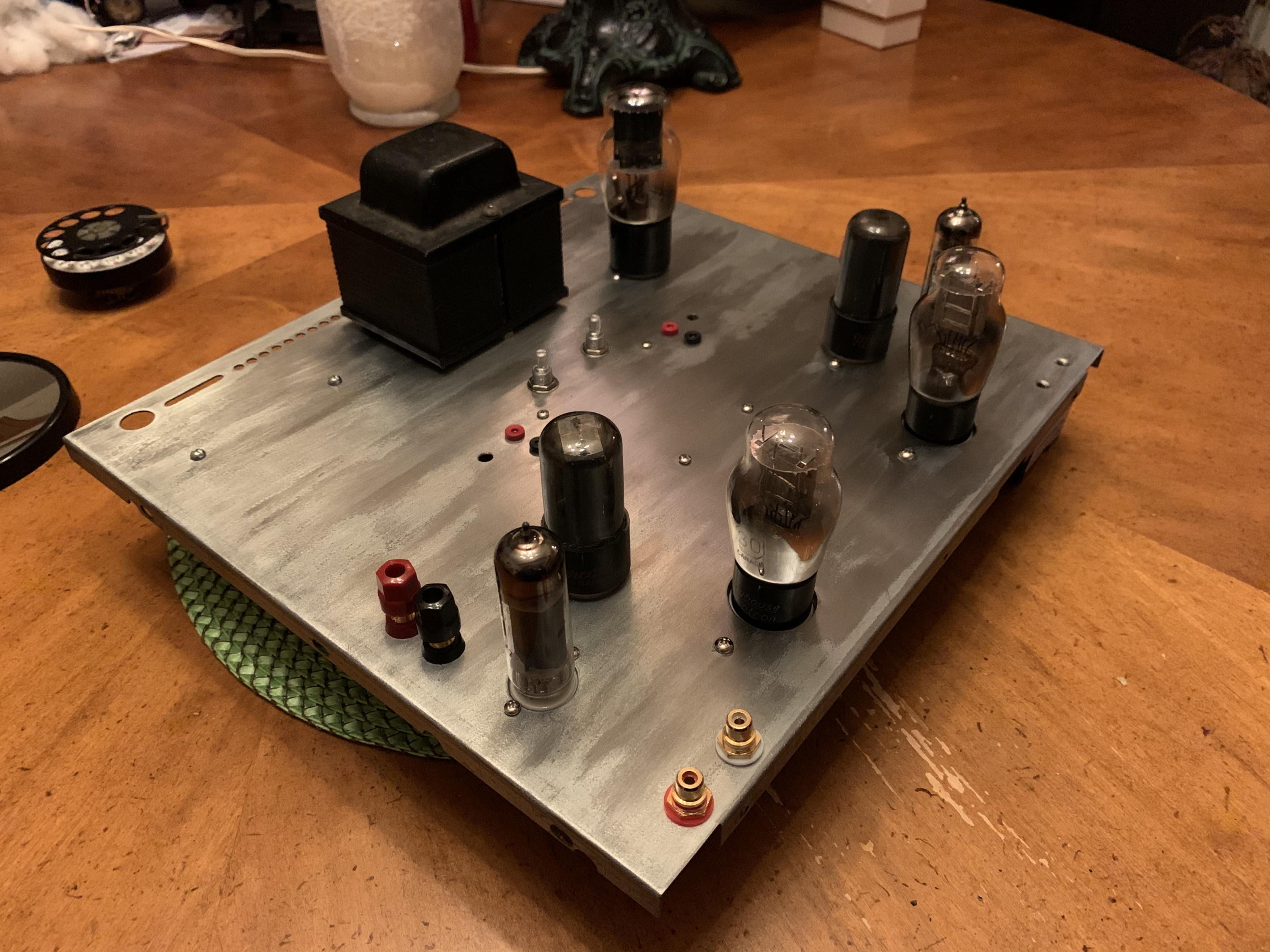

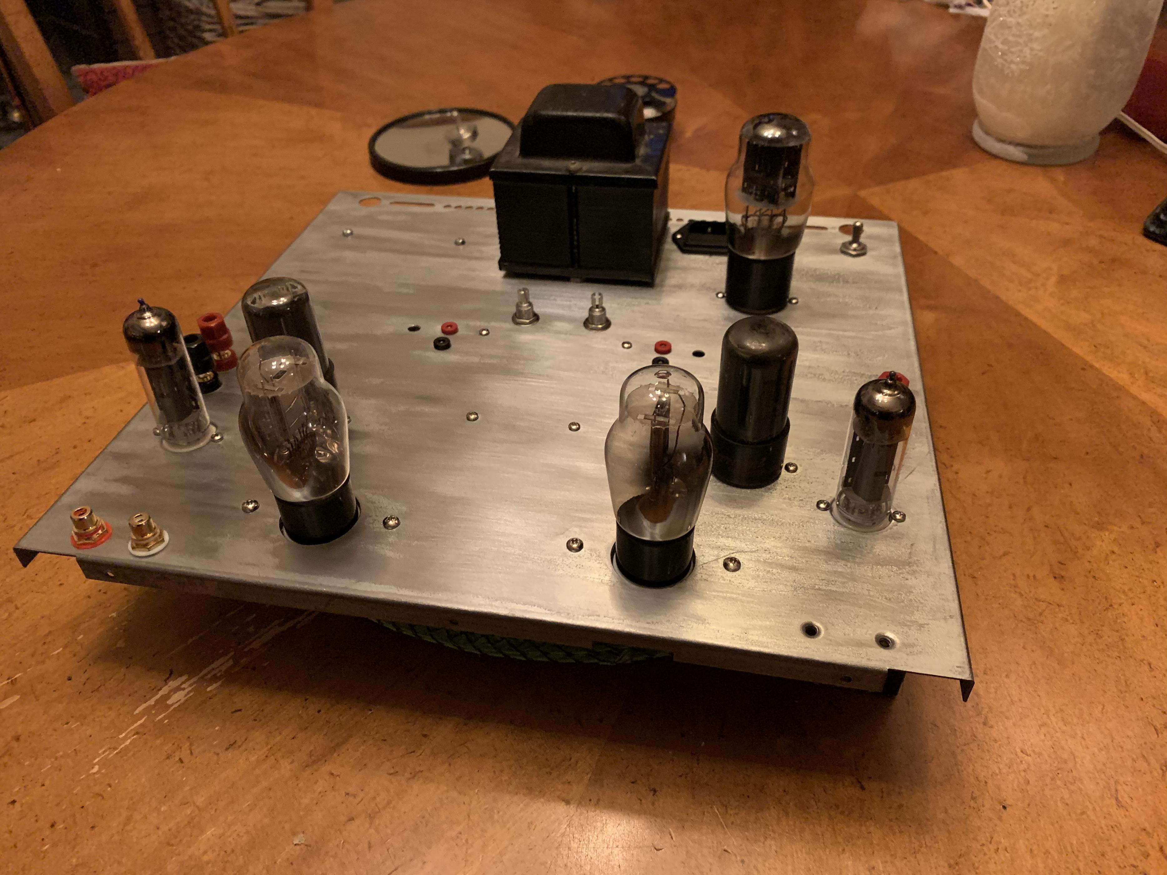

Type 30 into EL84 or 6V6 with 5V4 - top plate
Here is the completed top plate of the amp that this thread gave birth to. I ended up using the 30 because I have many, and because this build is intended mostly as an investigation of what a DHT to IDHT amp sounds like. I haven’t permanently installed the OPTs as I want to swap a few different very small and very inexpensive ones in to see if these small OPTs do a good job when used only above 600 HZ or so. I will use my 01A and 26 tubes in a dedicated preamp in the future. The circuit and power supply are not installed yet, and not entirely finalized. The photo shows the amp with all tubes in but, in use, either the 6V6 or EL84 will be used, and not both. The 5V4 is for a bit of delay on the onset of the B+ as it is indirectly heated. The top plate of this amp is the bottom plate of an old console amp that was badly corroded. I used a wire brush on a drill to strip off the corrosion, and this is the end result. Patina galore. Not for everyone I suppose, but it works for me.

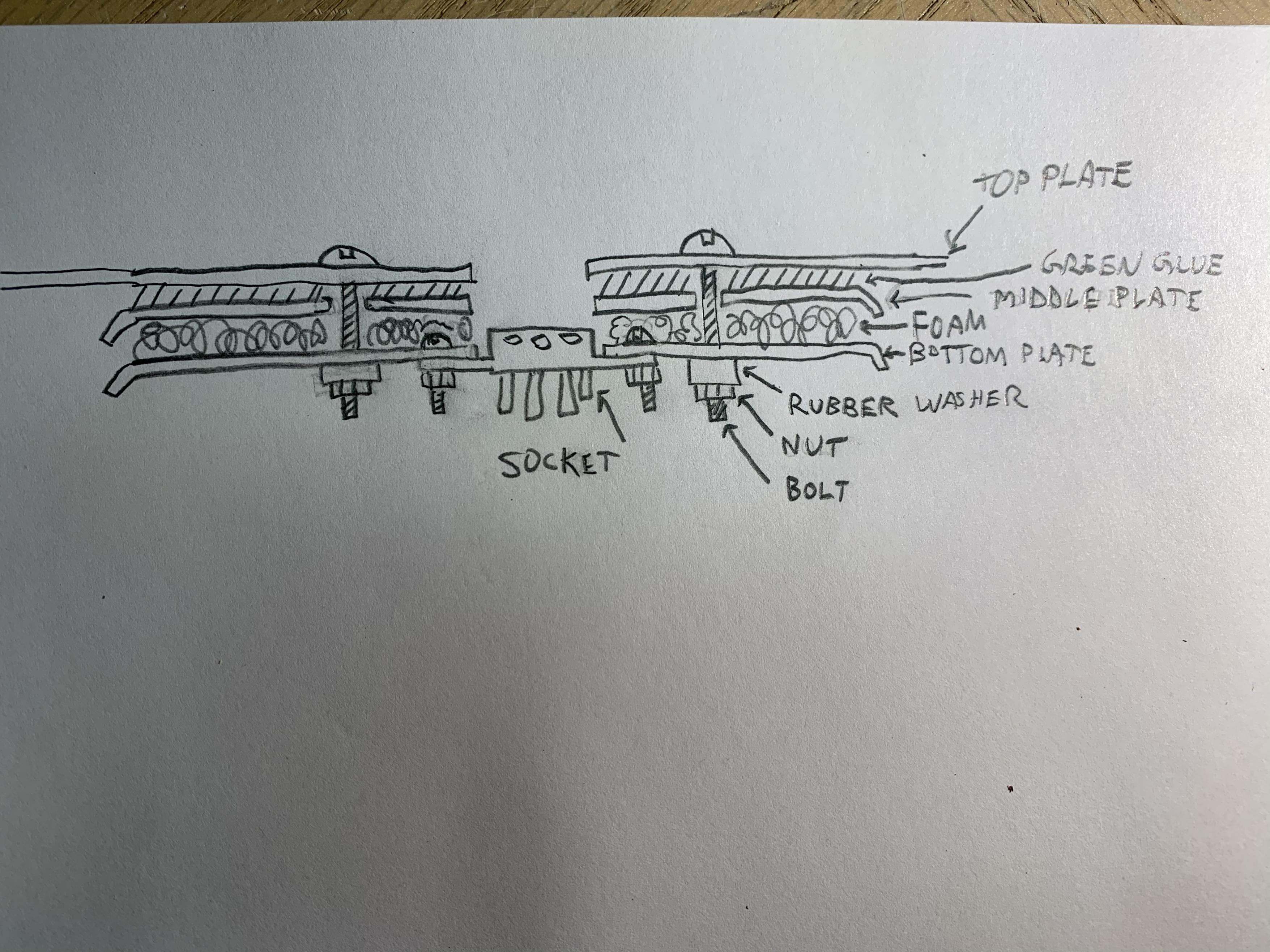

Good work. How thick is the top plate? You may like to put a piece of cork sheet inbetween sockets and top plate for type 30 tubes, if you have not used already. Also you may try isolation for the transformer, it may help 30's microphony. Waiting for your sound impression.
Regards
Minhaj: The transformer came from an old radio, and was vibration free in that application, which had more current draw. That said, I will still put something rubbery and flexible where it makes contact with the chassis. Thanks for reminding me. The chassis isn’t particularly thick, but it is steel and rigid. There are a lot of heavy things bolted to it underneath, and more will be added. The entire top plate will be attached to a thick wooden frame with rubber bushings as insulators. The 30 sockets are screwed into a steel electrical cover plate with a layer of rubber foam glued to it, and that plate fits into another identical plate that is pressed up against the top plate with a layer of Green Glue in between the electrical plate and the top plate. So, there is the plate that has the sockets attached to it, then a layer of foam, then another plate, then a layer of Green Glue, and then the top plate. The plate with the sockets attached to it is not in contact with the top plate. The entire assembly is loose so that when you push down on the socket from above, the socket moves a bit, as it does when you push the socket up from from underneath. See the attached amateurish drawing for more details.
