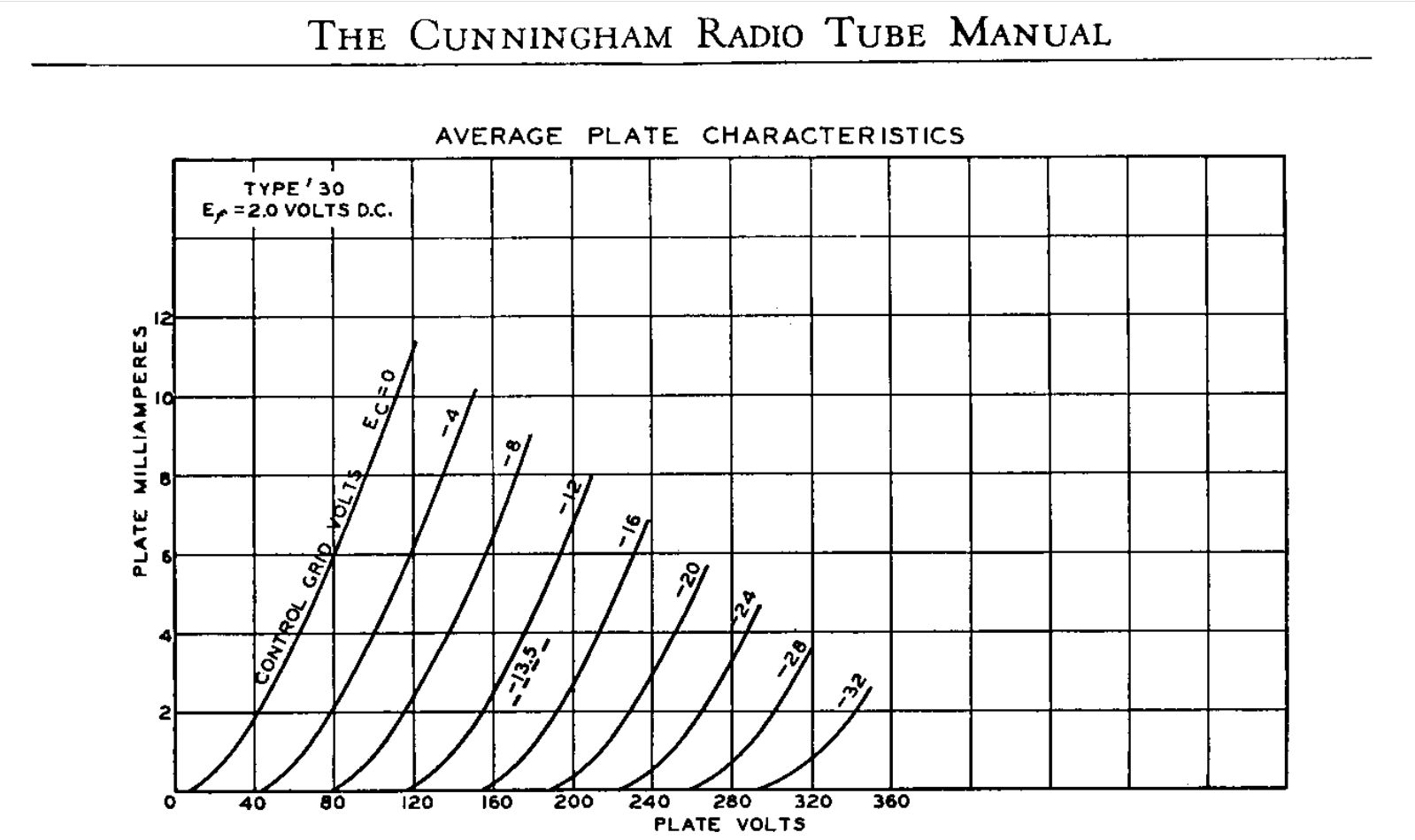

Quick question. I’m looking at lower voltage operating points for the 30. 100-115 volts. What should I consider as being the upper limit for current draw for a 30? In the class A1 amplifier portion of the data sheet it shows 3.1 mA, but it doesn’t say it’s a maximum. Would 4 mA be okay? 3.5 mA?
If you see the datasheet, for example the -4V grid voltage curve, the current at 100V 4ma, at -about- 115V 5.5mA.... but it depends of tube condition.
If you see the whole datasheet, the mu, rp, gm curves shows data at even 8mA anode current.
The accepted opinion -in the case of ancient datasheets- that curves "end point" represents the suggested maximum dissipation curve.
The 4-5mA region (at 100-120V) is within the safe range.

euro21: No dissipation limit on the data sheet makes me nervous. They seem like a fairly sturdy tube with a biggish plate. 3 mA will be fine though. Thanks!

The data sheet says "Plate voltages and the corresponding grid voltages should be determined from the CHARACTERISTICS and the curves in order to maintain optimum performance and freedom from distortion."
The plate current range is from 2.5 to 3.1 mA in the table. Plate voltages shown range from 90v to 180v, which is listed as the maximum.
I'm generally of the opinion that voltage and current can be fudged a little (within reason) and that dissipation is more important. I'm definitely not the smartest guy in the room, though.
Of course individual tubes will vary and the two I was using measured 3.15 mA and 2.93 mA in my setup.

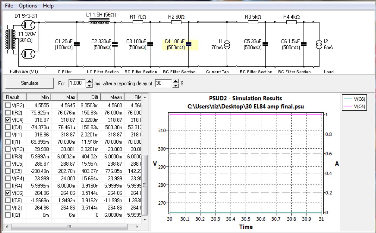

Power supply for 30 tube and EL84/6V6 amp
This is the power supply as it is in the amp. The PSUD2 simulation shows 2 millivolts of ripple on the power tube B+, and 3.5 microvolts of ripple on the 30 B+. This seems low enough that it shouldn't be audible through the La Scalas. There is no volume pot on the amp at the moment, and the amp has barely enough gain for the regular 2 volt source I am using for testing. A bit more gain would be better, and I may put together either a C4S CCS or the Bartola Gyrator for that purpose. Before that, I need to sort out the hum.

euro21: Good to know. It’s already there, so it’s easier to leave it in that remove it. It seems odd that I am still getting some hum with the Coleman regulator on the filaments, and the low ripple that I have from the power supply. Is it that DHTs are more prone to hum? I am using very sensitive speakers, but it’s been easy to keep IDHT amps quiet with these same speakers.
1. I always consider RMS reading
2. I didn't need this much capacitance in my dht amp
3. Of-course dhts are more prone to hum
4. Fore more gain you may like to use 841 (mu 30), 3b7 (mu 15), 3a5 (mu 15)
If you feel you need to improve you PS please tell us! You don't need more than 2pi for B+ and 1pi for B++.
