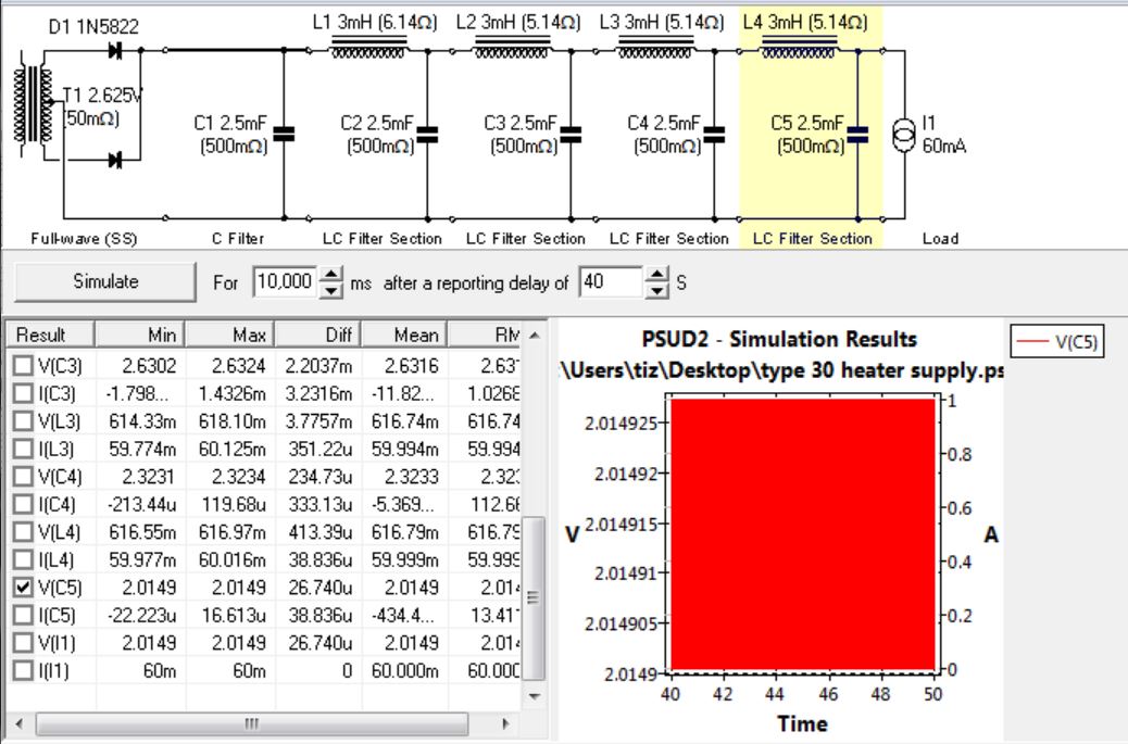

I have decided to keep it old school and simple . . . The 30's filament is only 2 Volts at 60 mA, and I have around 25 (!) Hammond 154B chokes at hand, so I decided to try a CLCLCLCLC filament power supply.
What you're describing is neither old school nor simple.
Old school and simple would be to use a battery to heat the 30. I once tried a 1LE3, which is a battery tube whose filament current is about the same as the 30. I heated it with a regular alkaline battery and it lasted about 24 hours. Rechargeable batteries with higher capacity are available so this is not impractical at all.
I know folks here are into complex circuits but I'm a simpleton, so your PS for a tweeter amp seems ridiculously complex to me. To each his own, of course. And if using up a bunch of chokes is a priority, it certainly accomplishes that. Hell, why not throw a couple more in for good measure. 😀

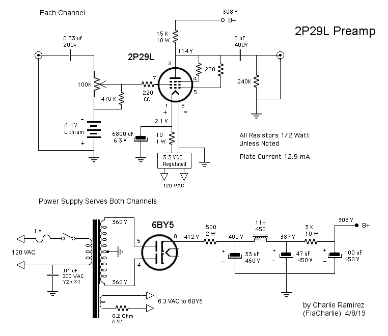

I breadboarded a 2P29L preamp a while back and it had excellent highs and the tube was not microphonic at all.
Since the 2P29L had more current draw than the 1LE3, I heated them separately with ridiculously tiny SMPS like these and they were dead quiet.
AC-DC Power Supply Module AC 1A 5W 220V to DC 3V 5V 9V 12V 15V 24V Mini ConvJju | eBay
I used a 10 ohm 1w dropping resistor to dial in the voltage and added a 6800uf 6.3v cap, although I'm not sure if it was necessary. I don't have the equipment to measure, but I compared this arrangement with a battery and I couldn't hear any difference at all.
If you search, I posted a thread on it. Here's the schematic. I'm following the same path with my current project - a higher quality SMPS for the filaments and battery grid bias, but I added a VR tube and plate chokes.

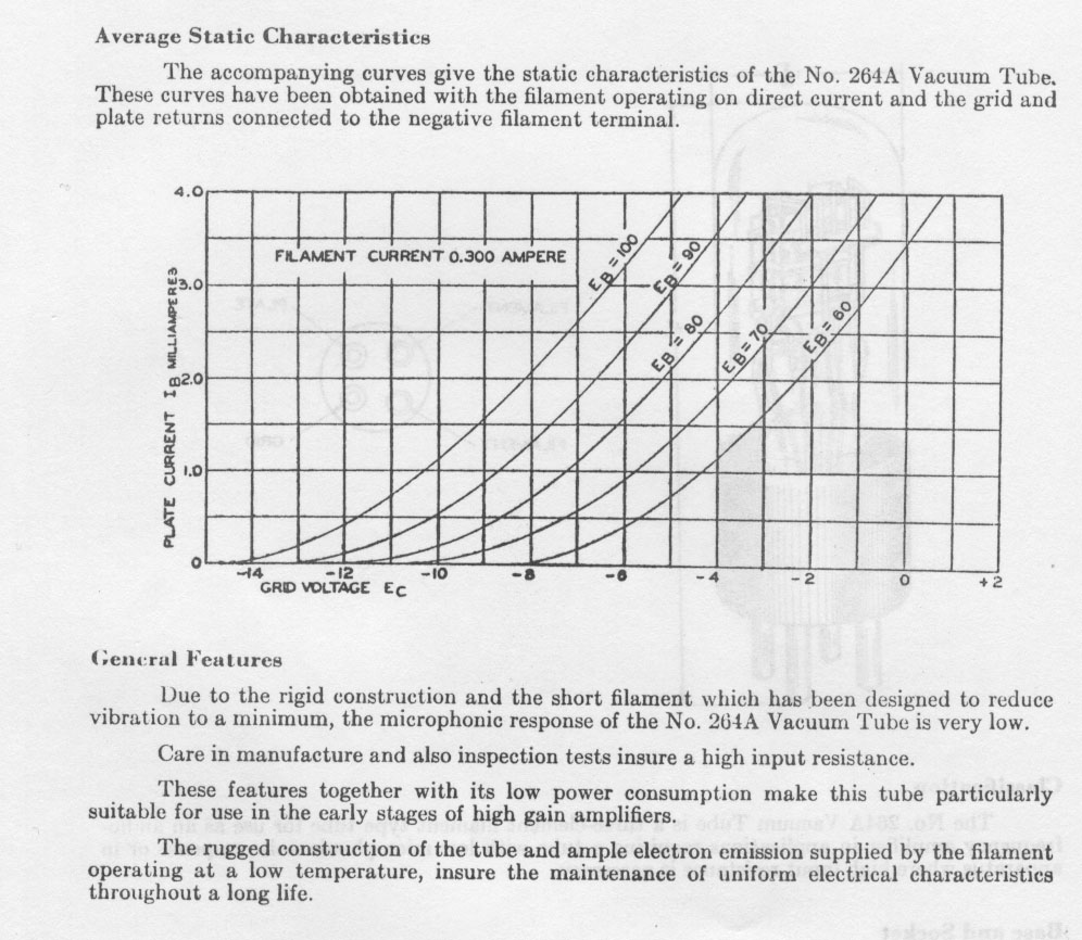

WE264 or 864
Are built from the ground up to suppress microphonics. But I've never used one in audio. However, just after the Earth cooled I built a regen receiver with a WE264 I scored from my buddies father whose was a movie projectionist. The filament ran OK using discarded 1.5 volt, #6 Cells from the local telephone exchange. The B+ came from a 45V 'B' battery, common at the time. It ran great thru a set of 2K impedance headphones. The antenna ran out my bedroom window to the chicken coup.🙂
