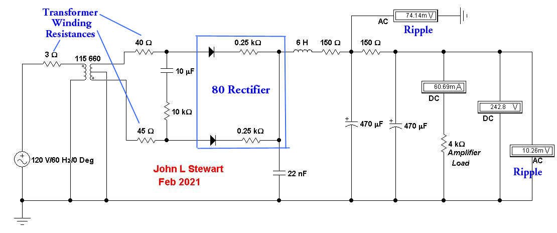

Tizmans PS EWB Solution
A first pass shewing the resultant DC & AC potentials at the load & after the first LC filter section. There are no vacuum rectifiers in EWB, altho it can be tricked by using a low mu tiode such as a 6080 as a starting point. So the 80 rectifier is simulated by a pair of silicon diodes & series resisters,
The halves of the PT are different resistances since the HV winding is done serially, the 2nd half wire length is longer since it is wound over the first half. This results in a line frequency component in the ripple that is not filtered as well as the rectified ripple. The LC filter sections are 12 db less effective at the line frequency. At times this causes a problem tor SET amplifiers if the line frequency is close to one of the loudspeaker resonances in their system. No problem in this case, any resonances are far away.🙂

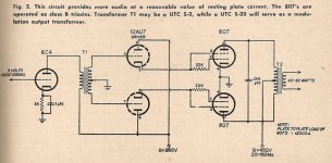

Follow on of my Post # 144:
For the push pull 6C45pi-E and KT88 amplifier, I did not want to have to use all the parts that it takes to have a negative power supply, for the LM317 current sink. So I used Positive battery bias.
Using the positive battery bias, the grids of the 6C45pi-E were at about +3.25V.
But there was no appreciable grid current, because the cathodes self biased in concert with the LM317 current sink.
The current source was set for 20mA; 10mA per 6C45pi-E.
The 6C45pi-E plate loads were 19.1k (at least as well as I can remember).
The KT88 tubes were Triode wired, and drove a 6000 or 6600 plate to plate output transformer.
There was no negative feedback used (Well, the Triode wiring is negative feedback).
The 6C45pi-E tubes had 2nd order distortion cancellation, because of the cathode to cathode connection, and the LM317 current sink.

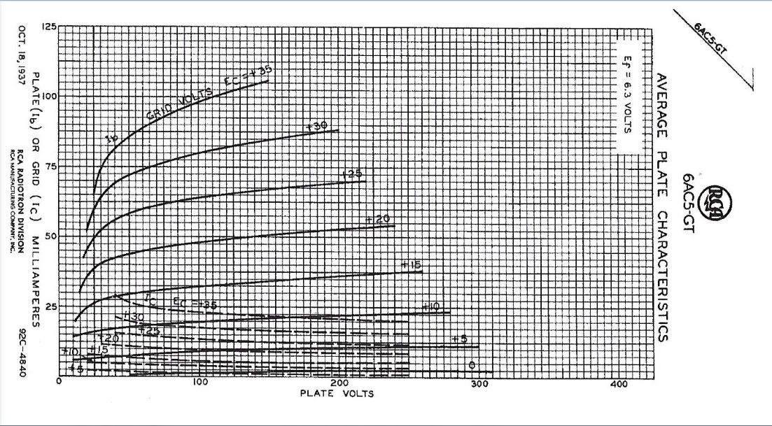

Thanks for the additional info, John. I was aware that the combination of the 76 and 6AC5 could be used to mimic the 6N6G. It hadn't occurred to me that a pentode like the 6F6 could be used in triode mode. It's nice to have the two triodes contained in a single bottle, of course, but those are all great alternatives.
A few questions . . . In one of the attached documents you said, "most power pentodes when run as triodes with G1 & G2 strapped together have quite a high mu."
I've only seen triode strapped pentodes with G2 connected to the plate, typically with a 100 ohm resistor. Is this a misprint or can G2 be connected to G1 also? If so, I assume no resistor is necessary. Correct?
Not a misprint, the circuit is connected as shewn. Quite a few power pentodes can be connected in three different ways. In the early to mid thirties several tubes were developed & circuits devised to use them. Often the ordinary triode hookup as the driver, the low impedance of the triode version is required in that position. Refer to the 46 & 49 sheets.
Does connecting G1 & G2 result in higher mu than with a G2 & Plate connection? If so, then a pentode could effectively be used to produce 3 different levels of mu, depending on how it's wired, not just 2.
The mu is higher & so is the plate resistance. The result is very pentode like. Complete with the pentode knee. The loudspeaker damping is poor, just as it is while operating as an ordinary pentode.
The 6F6 tested rp of 15K with the plates tied together & 51K in the pentode mode.
The mu was 13 with the plates tied together, a result of the driver 6SN7 mu of 20. Those numbers are related. The pentode mu was ~36.

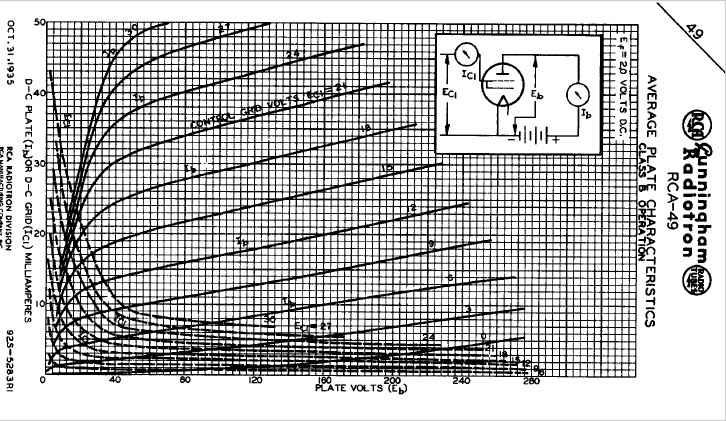

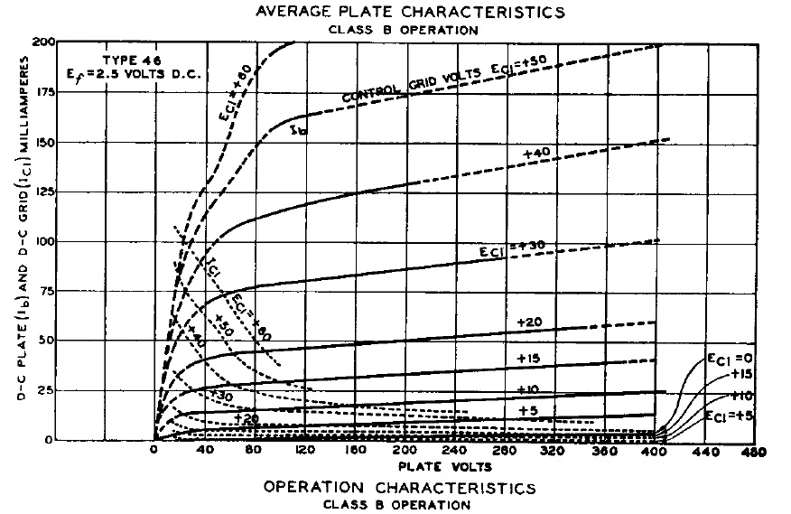

A quick question that I can't seem to find an answer for. What is the maximum plate dissipation of the 01A?
No spec for Pd was given or seems to have been published for many of the early tubes. Unfortunately, Alan Douglas who probably could have helped us died a few years ago.
But could be held to a safe limit with at least 27K running from a 250V supply. If the plate settled at 1/2 that the PD would be (125V)* (4mA) ..............or 500 mW.
There is a power version & high mu version covered in the attachment.

For the PS pls check the DC resistance of the primary & secondary HV windings, I'll plug that back into the EWB simulation. The measured HV might be lower than the calculated value since the EL84 is pulling heater current from your PT as well, that loads the primary & the end result shews up on the final HV measurement. These simple simulation don't make any allowance for that.
The power transformer’s primary resistance is 2.1 Ohms, and its secondary resistance is 90 Ohms. The B+ voltage at the plate of the EL84, as measured by my DMM, drifts around a bit, but the drift seems to be a product of other items that share the circuit. When my portable electric heater on the same circuit turns on, the B+ drops by 15 Volts. Measured with the heater off, the voltage does still move around. Over the course of a one minute period, the voltage went from 207.9 at the start to 211.2 at the end. In the next 2 minute period the voltage moved between 210.8 and 211.2. My feeling is that the fluctuations are due to the 6 portable heaters in the house turning on and off.
