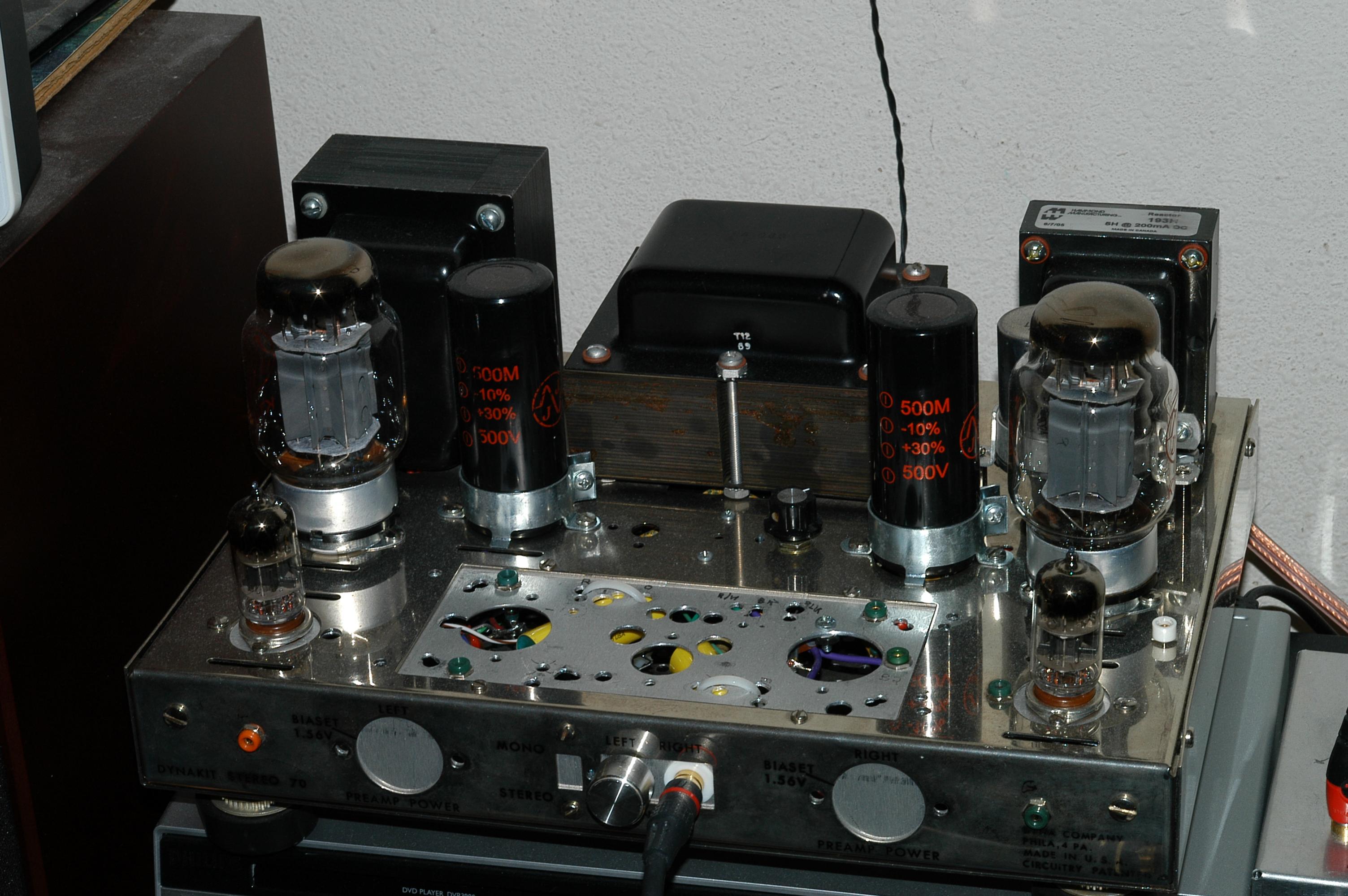

There has been a request in this thread, for photos of my battery biased tube amplifiers.
So I am attaching one photo. This is the last amplifier I built that employed battery bias, and in a way that I had never done before.
There were other battery biased, and other self biased amplifiers before this amp, but after this one, I did not use any form of battery bias again.
This amp was built on an old Dyna Stereo Chassis (I hate steel chassis).
The 2 input tubes are 6C45pi. The cathodes are connected to the ends of a 25 Ohm pot, and the pot wiper is connected to an LM317 Current Sink to ground.
One 3V lithium cell is connected from the volume control wiper to the grid stopper resistor.
In this case, I connected the negative lead to the volume control wiper, and the positive lead to the grid stopper.
The other 3V lithium cell negative was connected to ground, and the positive lead was connected to the grid stopper resistor. I did it that way to raise the two cathode voltages to give the LM317 enough voltage across it to work with signal, not just the quiescent biasing.
That is the first and only time that I used the battery + lead to the grid stopper.
All my other battery bias amplifiers had series connected batteries with the - lead going to the grid stopper.
I always did use the serial connection from signal to the grid stopper.
After this amplifier, I started using different cathode coupled phase inverter tubes, and other current sinks that had a lower burden voltage, so I did not need to use the battery bias in the way I did for this amp.
The 6C45pi tubes had matched plate load resistors.
I used RC coupling from the plates of the 6C45pi tubes to the output tubes grid stoppers.
The KT88 tubes were individually self biased, with individual bypass caps.
They were Triode wired, with 100 Ohm resistors from the screens to the plates.
The push pull output transformer was custom from Electra Print Audio (thanks to Jack Elliano).
The power supply used the original Dyna power transformer. I used 1500V solid state diodes, and the input cap was either a 1uF, 2uF, or 4uF “motor run” cap (I can not remember which, just use enough to get the B+ you want). The rest of the filter was a 5H 200mA choke, 500uF, a series resistor (100 or 180 Ohm), and another 500uF cap.
The first 500uF ran the KT88s, and the second 500uF ran the 6C45pi’s.
That should give you a little bit about the topology.
Now, for the picture (attached).

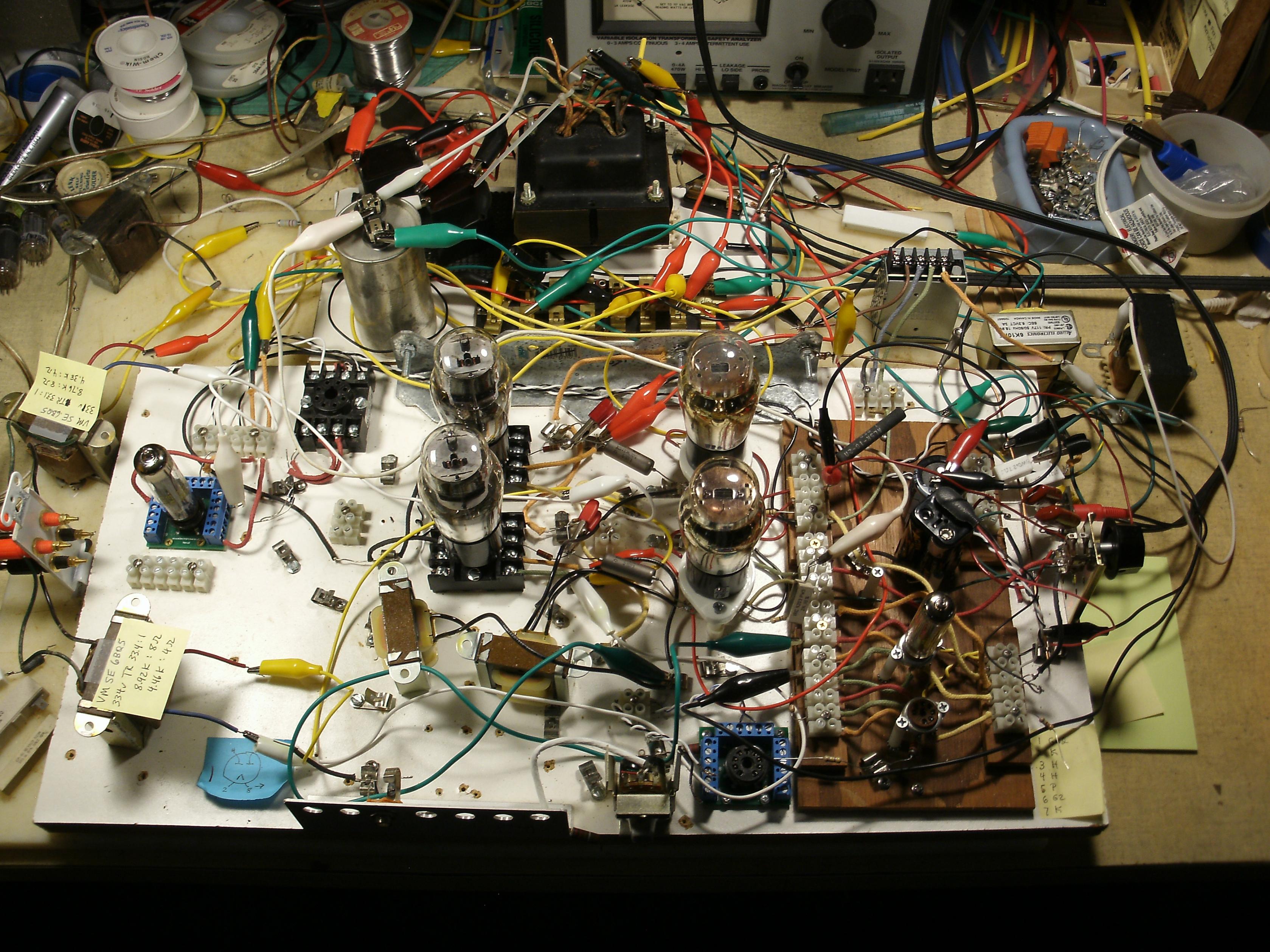

Your breadboard arrangement is much better organized and quite spacious compared to mine and I'm having none of the issues you mention.
Here's a pic. :eek: Quite frankly, it's embarrassing. I gotta put together a more organized breadboard at some point. But if this setup is dead quiet, there's no way your breadboard is the source of the problems you're having. There's gotta be something else going on.
Perhaps it's because I'm using an ST version of the 01A. Are you using a globe?? I've heard that globe versions of all these old tubes are much more microphonic than their ST versions.
I get no ring when I tap quite hard on the breadboard itself or the table it's on. When I tap the tubes I get a very brief ring but it disappears quickly. I don't consider this an issue since I don't tap on tubes during normal operation of an amp. I've had indirectly heated tubes, like the 12B4, that actually ring much more.
As minhaj pointed out earlier, chokes need to be designed as plate loads, so resistor loading may solve the hum problem. I'm using the cheap Hammond 156Cs and they're randomly placed right in the middle of a my mess of a breadboard. No hum. But they are designed as plate chokes.
Since your PT is vibrating, could it also be the source of the hum? You might try using a different one or a bench supply if you have one. I build using scrounged parts. The PT in mine was rescued from a dead R2R recorder. I ran this amp for ~12 hours straight and the PT barely gets warm at all. I'll use a scrounged vintage transformer every time if its specs allow.
I know you're building this as a tweeter amp. If you have a crossover of some type installed could that be causing a problem? My bench speakers are maybe 90-92db so I can't say what might be audible with 100db+ drivers, but mine is dead quiet right now.
I'm using the same basic setup as the schematic I posted earlier (post #36) that uses the 26 as input tube. The only difference is that I'm using a 5v version of the Meanwell SMPS, a 0B2 voltage regulator in place of the 0A2, and -4.5v battery grid bias instead of -9.78v. Plate voltage is ~98v and each 01A is running at ~3mA.

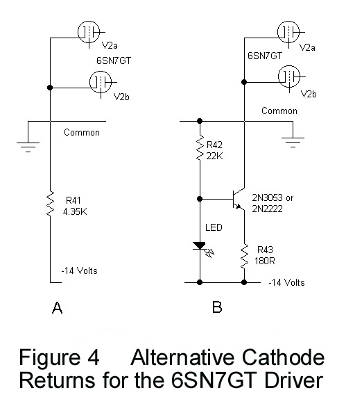

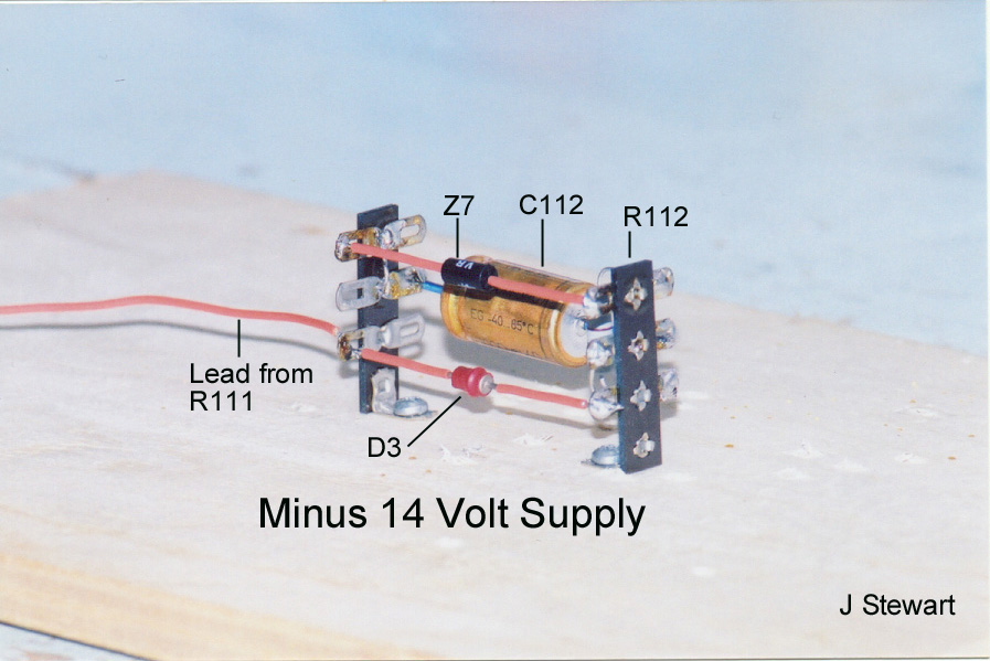

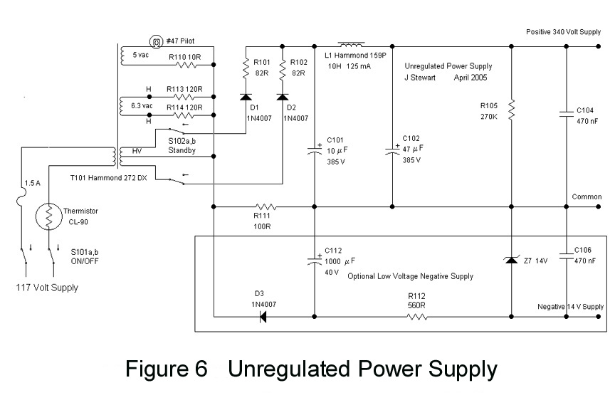

Was the diff amp tail taken to common or the -ve grid supply that provide bias to the power tubes?
I mistakenly assumed the diff amp tail would be taken to a negative supply, something I've always done. But some are not, the most common I can think of is in the Mullard series of amps. So for 6A3s amp the 3V cells would work. For those who would like to avoid the batteries refer to the attachments for a clean solution.:) And apologize for inserting this into Tizman's thread.
