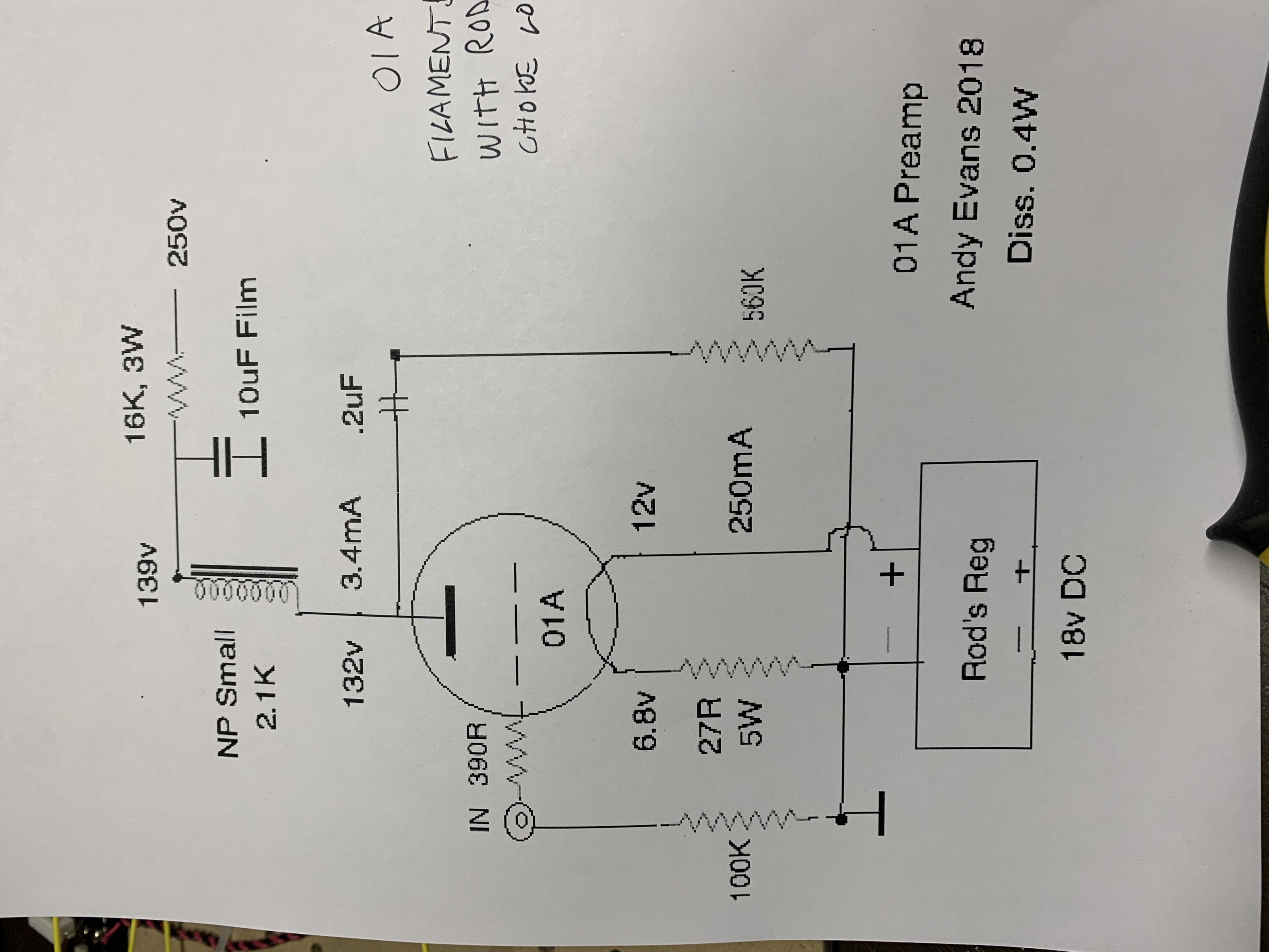

Andyjevans: As per the photo of your 2018 01A preamp circuit attached, what is the output voltage of the power transformer used? I’m using Coleman’s raw supply PCB, and I used 35 Volt capacitors when I built it in order to be able to use filament bias if I decided to.
i used two 24v/12VA transformers for one supply and a single 24+24v/25VA for another. In one supply I used a couple of Hammond 158T chokes in CLC which gave me 15.5v out, and I used a different operating point for the 01A. in the other I used a much larger choke with less DCR and that gave me a higher output voltage - may have been choke input or a very small cap. Didn't write it down.

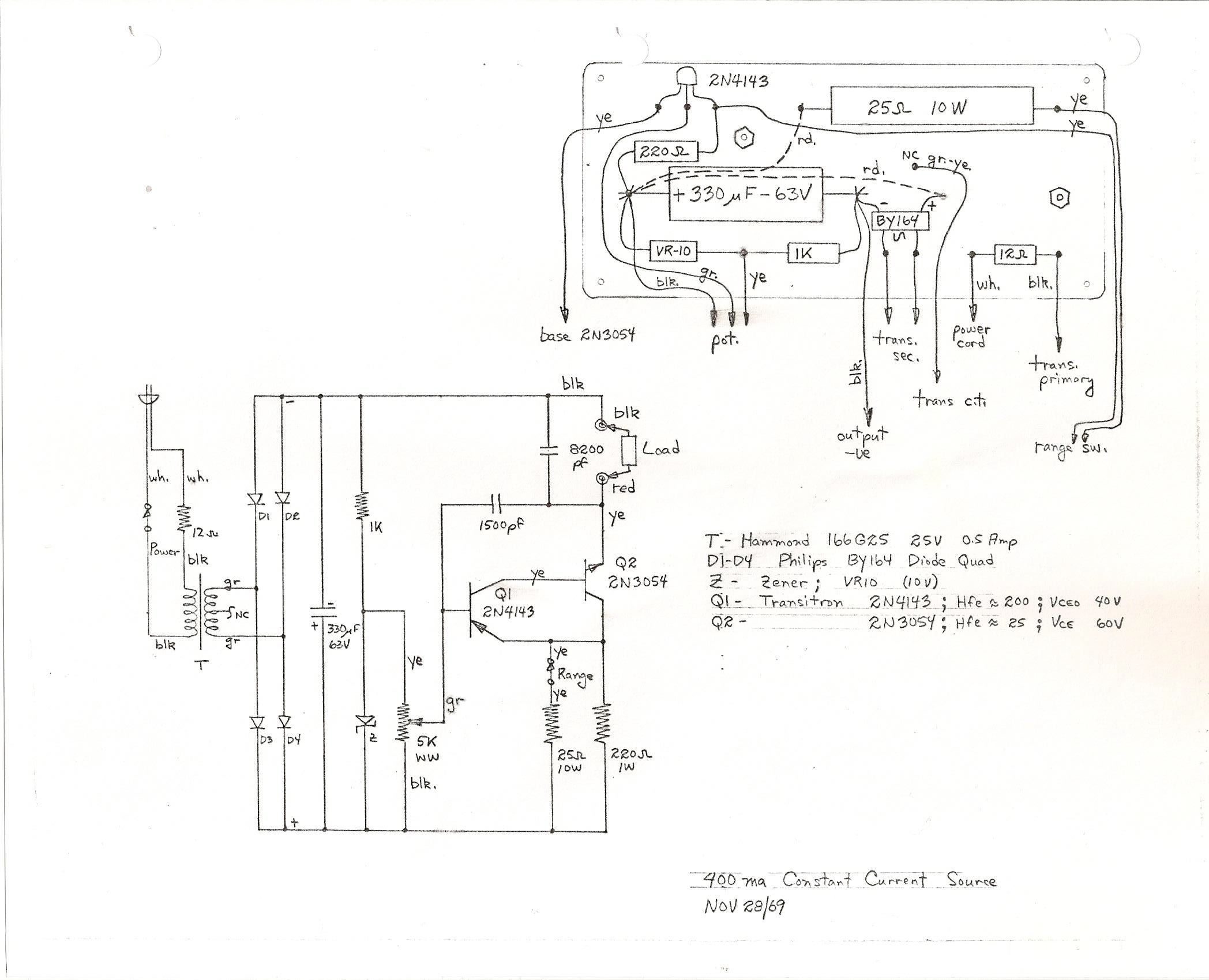

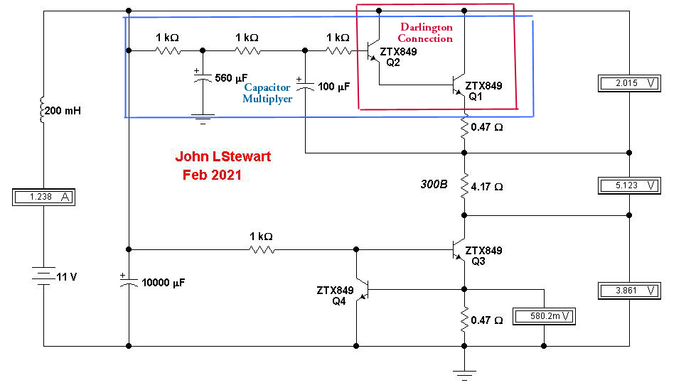

The circuit as shewn will not work
But easy to fix. The schema has Q1 & Q2 wrong way around. Q2 is holding Q1 off. So a simple rearrangement into the Darlington connexion is the fix.
But will still need another circuit for the 40V or more required for the 300B bias.🙂
Hi John. The schematic you just posted doesn't appear to correspond to the one posted by euro21. The first and second pair of devices are a ZTX849 into a MJE15032 or 2ST1480FP. In your schematic, you show a ZTX849 into another ZTX849. Is this a different version?
Sorry. Here it is.
Open the link in euro21s post. The schematic indicates the schema to be the 2010-7 model. As is it won't fly. But could if QI was a PNP transistor, then inverted. A common connexion in many SS output sections.🙂

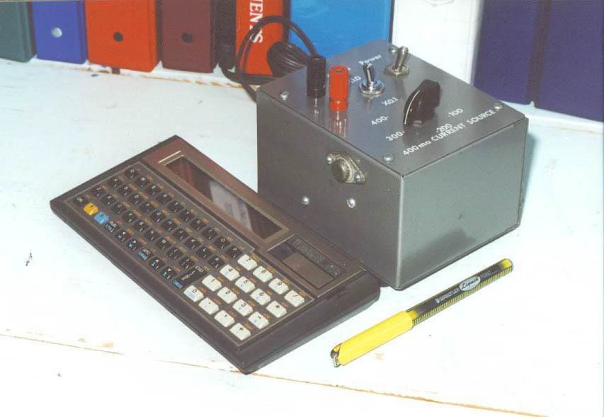

I've used that hookup, the advantage there is only one base-emitter junction to drift with temperature. Here it is in a piece of test equipment, a variable CC source. I've used this box a lot, real handy for testing low resistance in transformers & chokes. And SS diodes.
