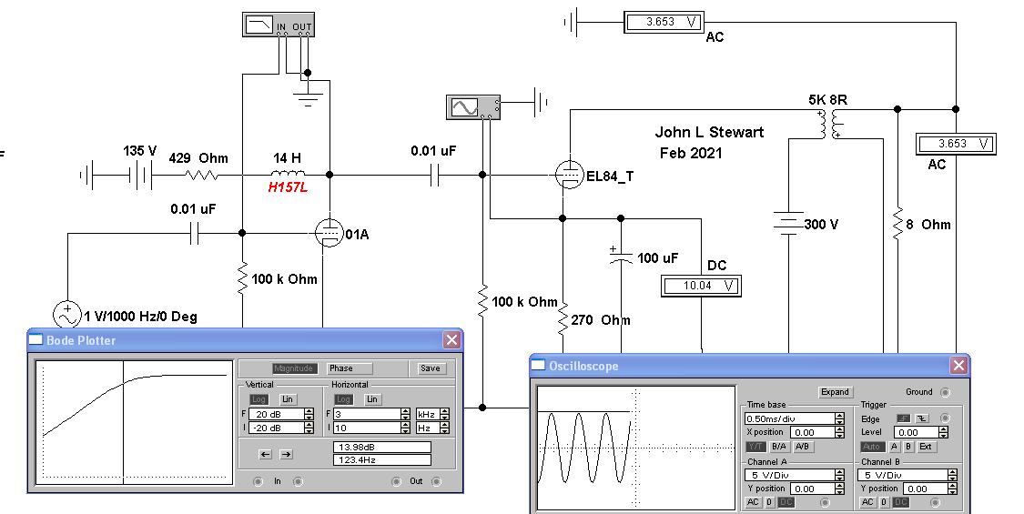

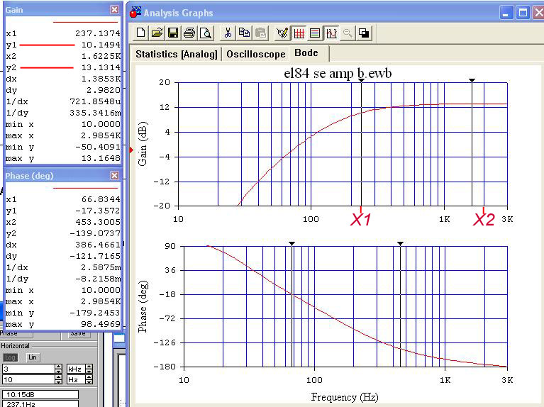

That would put the response 3db down at the specified frequency (500 Hz). If you would like to keep more of the signal at that frequency the choke needs to be a bit larger. 5H would probably be OK. But the RC coupling between the toobz needs to rolloff much lower than that. Same for the OPT.
If the OPT is also down that much the choke should probably be larger. Don't want too much attenuation at 500 Hz, could happen if the choke & OPT roll off at the same place. What OPT did you settle on? If you've got some specs, I'll do the calcs.

My actual crossover is at 630 HZ. I used 500 HZ as a target to give me some margin in case I want to use this amp with a different HF section, a different two way, or change the crossover point to a lower one.

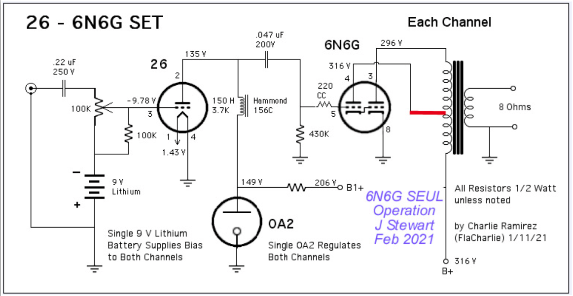

I have a 01A to 6V6 amp ready to be breadboarded, but also want to try an EL84. I would like to use the 6V6 or EL84 triode strapped. I also want to try a 26 as a driver, and possibly a 31 or 71A. If I get 1 clean watt out of the amp from about 500 HZ and up, that will be plenty for my HF horn.

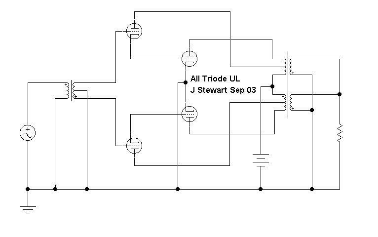

6N6G Etc
Charlie, you might find this interesting. I didn't have any of those weird toobz from the 30s & 40s, so I rolled my own. Here are some bench tests of a faux 6N6G, formed by a 6SN7 & 6F6. Did it work? Damned right!

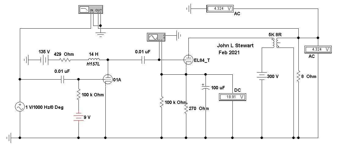

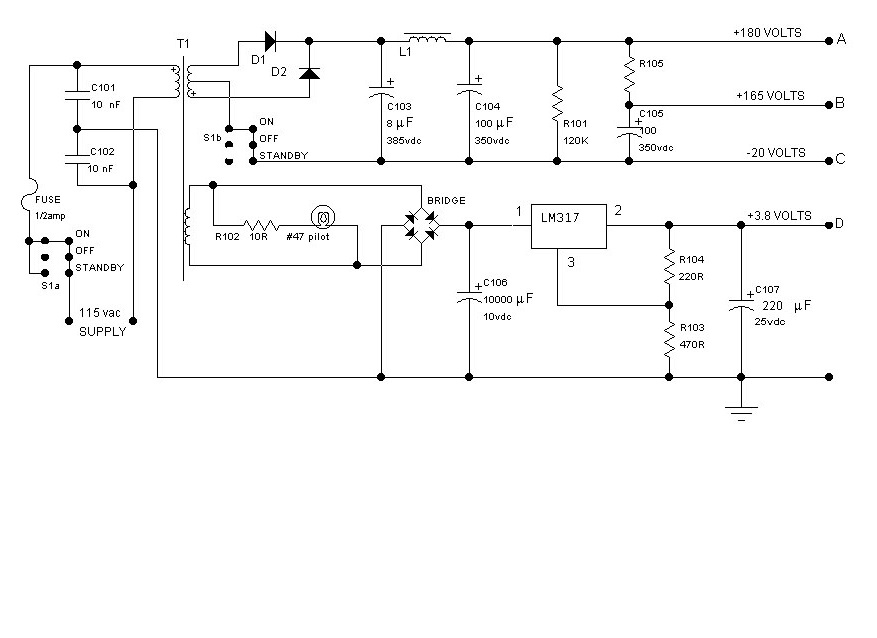

I’m here! I am moving forward slowly with breadboarding a 01A and 6V6 combo. I found out last night that the newly adopted regulated bench supply that I wanted to use for my breadboarding has 1.5 Volts of ripple on the DC output. Up to this point I have mostly built amps up on their intended chassis from already existing designs, or modified existing designs. Breadboarding is entirely new to me, and so are DHTs, so it’s going slowly. So far, I have built the breadboard with all its corresponding tube socket attachments, wired the 6V6 heaters, and built the Coleman regulator and its raw DC supply and tested it. Most of my time spent on this has been on researching the use of the 01A as a driver tube.
Clips at about 1.5 Watts.
Thanks John. What is the value of the cathode bias resistor on the 01A in this schematic?
For the simulation I used a fixed 9V Battery. So could for now use a 9V small battery for that. Easy to do, last as long as the shelf life of the battery.
Is the 9 Volt battery supposed to be on the cathode of the 01A?
The 9V battery needs to apply -9V thru the grid resister to the grid. Ideally, no current ever flows from the battery. In real life, the battery would live for almost as long as if it sat on the shelf.
Some experimenters put the battery in the cathode circuit were it is continually charged while the cct is running. Most batteries don't like that, they need to be in a controlled charging cct where the current is held below some fraction of its capacity. Not a good place for a non-rechargeable battery at all.
Always better if the bias battery can be in the grid circuit, just like it was in ancient times when 01As were like flys.

As John says, it can be in the cathode, with the + to the pin and - to ground. But you need to use a rechargeable in that position. I ran 27s using a "9v" battery in cathode bias in an amp for quite a while with no problems as long as it was used regularly. If I used it sporadically, I would have to remove the battery and recharge it in a charger because it would lose it's charge.Is the 9 Volt battery supposed to be on the cathode of the 01A?
Recharging was a pain, so I switched it to battery grid bias, as shown in the schematic he posted and the one I posted earlier. With battery grid bias you connect - to the grid and + to ground. You also need to add a cap on the input to block DC.
I switched to using 01A in my amp yesterday. I'm using -4.5v on the grid which is provided by 3 AA alkaline batteries. I'd swap in some lithiums in a final build since their shelf life should be ~10 years. Plate voltage is 98v measured to ground. Plates are choke loaded using a Hammond 156c and voltage is regulated using a 0B2 regulator tube.
I used that operating point because the 0B2 needs a minimum current of 5mA and the data sheet lists a max plate voltage of 135v for the 01A. If I had stuck with my "9v" bias (actually ~9.78) and used a 0A2 regulator I might have been pushing it with both tubes. I used a 9v and a 0A2 with the 26s, as seen in my schematic.
The regular (non-rechargeable) AAs are about 1.5v each and a "9v" is usually somewhere around 9.45 to 9.8. Rechargeables measure a bit lower, AAs will be around 1.2v.

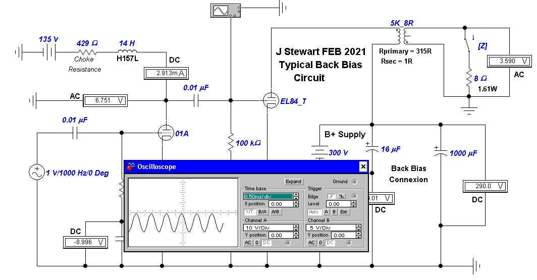

Front End Bias, No Batteries, No Diodes Fixed

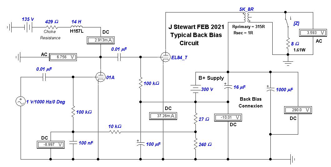

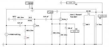

All on the 01A EL84 Amp. using back biasing One volt on the front end drives the EL84 to clipping, see sine wave touches zero volts on the scope. Using the switch Z to open circuit the output allows a rough estimate of DF, looks like better than 2.
THX to Chris Hornbeck for pointing out my gross circuit error a couple of days ago. Thought I'd found a shortcut on the bias thing.
Thanks for the schematic and fix. I will start with the EL84 instead of the 6V6, as I have all the requisite bits. How does this schematic fit in with the Rod Coleman filament regulator?
In general I've never used other people stuff, I like to grow my own. Sometimes I save a circuit for reference such as this time. I checked the thumb drive where I save that kind of thing & came up empty. Send a link or the schematic, I'll take a look.

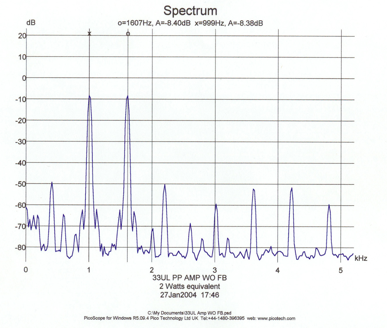

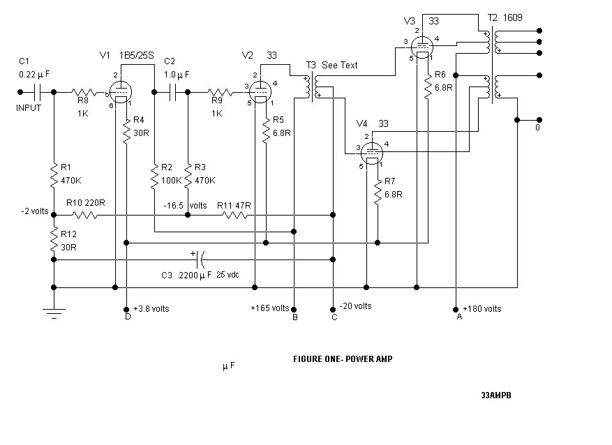

Attached how I did that on the PPUL 33 Amplifier. This one is also using back biasing. The performance is very good using such low powered 2Volt filament tubes.
John: I don't have a schematic for the Coleman regulator, but based on FlaCharlies schematic, which also uses battery grid bias, it appears to be a straightforward hookup. This is a link to his site and the regulator...

Since you have installed socket for rectifier you can design a proper PS for your amp. You need not to worry about your bench PS or you may like to have some kind of regulator at the output of your bench supply.
Again as this is your first bear boarding project you may like to use 2700r 1/2 watt resistor for cathode bias + 220uf bypass cap. Once everything is up and running you may go for battery bias (everybody does not like battery bias sound though).
