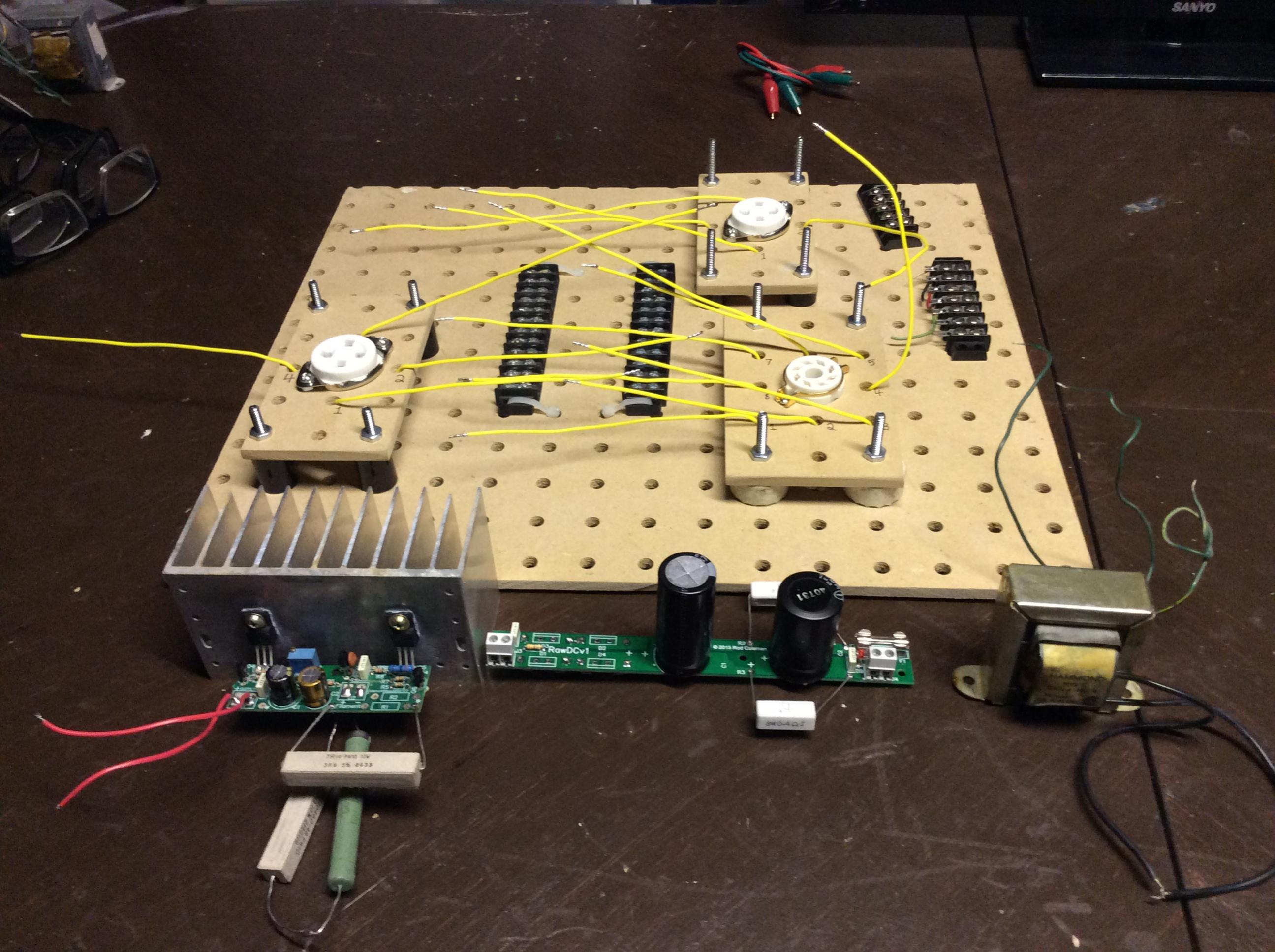

Progress
I have put together a breadboard, and a Coleman regulator and its DC supply. My first attempt will be a 01A driving a 6V6. I have a tube regulated bench power supply for the 6V6, but need to build the power supply for the 01A. I have a socket on the breadboard for a type 80 rectifier that I will use for the final power supply.
Separate supply for 01A not needed in my opinion. If B+ supply for 6V6 is higher that 01A supply you may use RC filter from 6V6 B+ and done with that. However, this is your goat.....

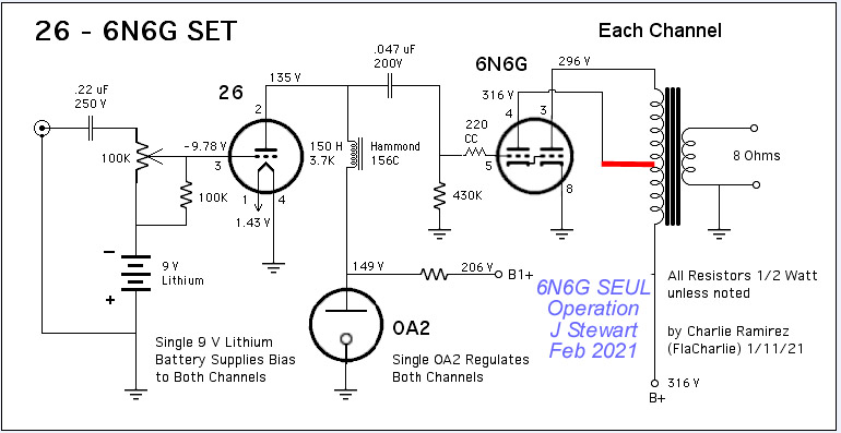

Internal NFB
R25 & R34 are part of a NFB network formed by 25K (R24) in parallel with about 8K, the rp of the 26. Then that in series with 10K (R34), all that in parallel with 470K (R32).
So the 490K resister R25 is driving back into 15.53K. Not much NFB, just 15.53 / (15.53+ 490)
I'm curious..... what do resistors R25 and R34 add to the circuit?

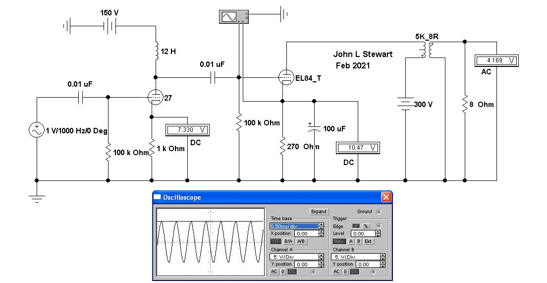

71a as driver with EL84 SE is good 1.5W amp.
Sample: a little modified RH84
The EL84 in that example is running pentode. Tizman wants to run SET.

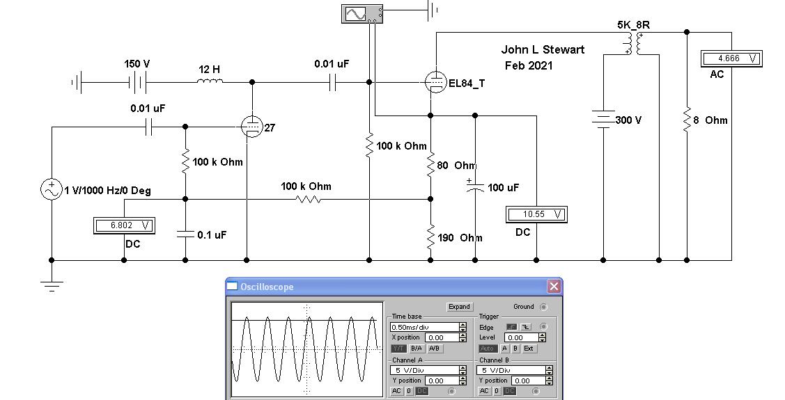

Front End Bias, No Batteries, No Diodes
In the A cct front end ordinary cathode bias is used. In cct B the front end bias is obtained from the output tube thru an RC decoupling network. Not new, was often used in the 1930s receivers. Should work well with 1930s toobz.

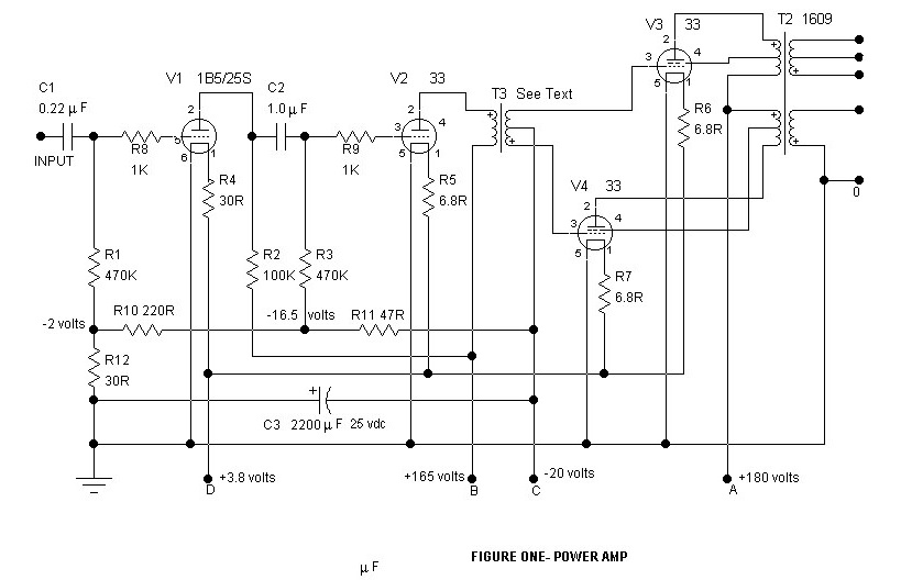

That's a lot of positive bias?
YOS,
Chris
You are absolutely correct Chris, I got it the wrong way round. I'll fix that on the morrow, it should be shewn as 'back bias'. Think I'm gettin' old.

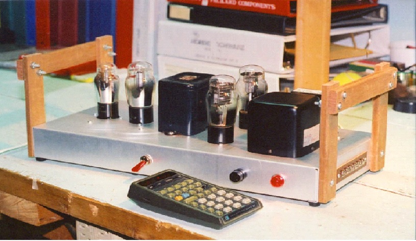

PPUL 33s Driven by Triode connected 33
This one was built as a proof of concept about 20 yrs ago, it does work. Real well, in fact. The back bias network is R10, R11, R12 & C3. All of the amplifier B+ current passes thru that network on the way back to the PS on the -ve end.
The Electronic Workbench simulator does not respond to +ve bias values, otherwise that earlier sim I put up would have caught my silly mistake.
