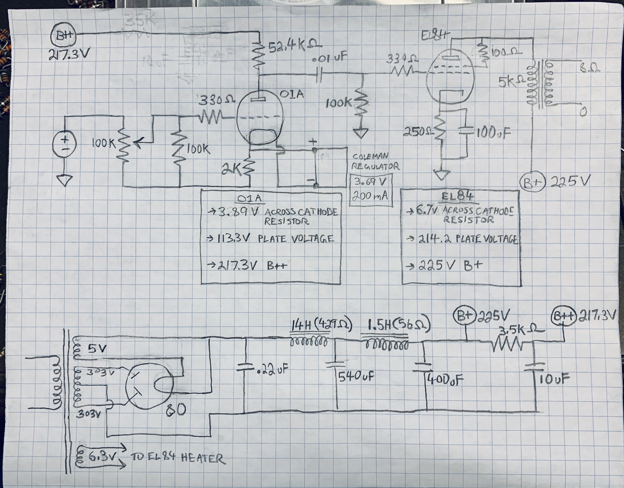

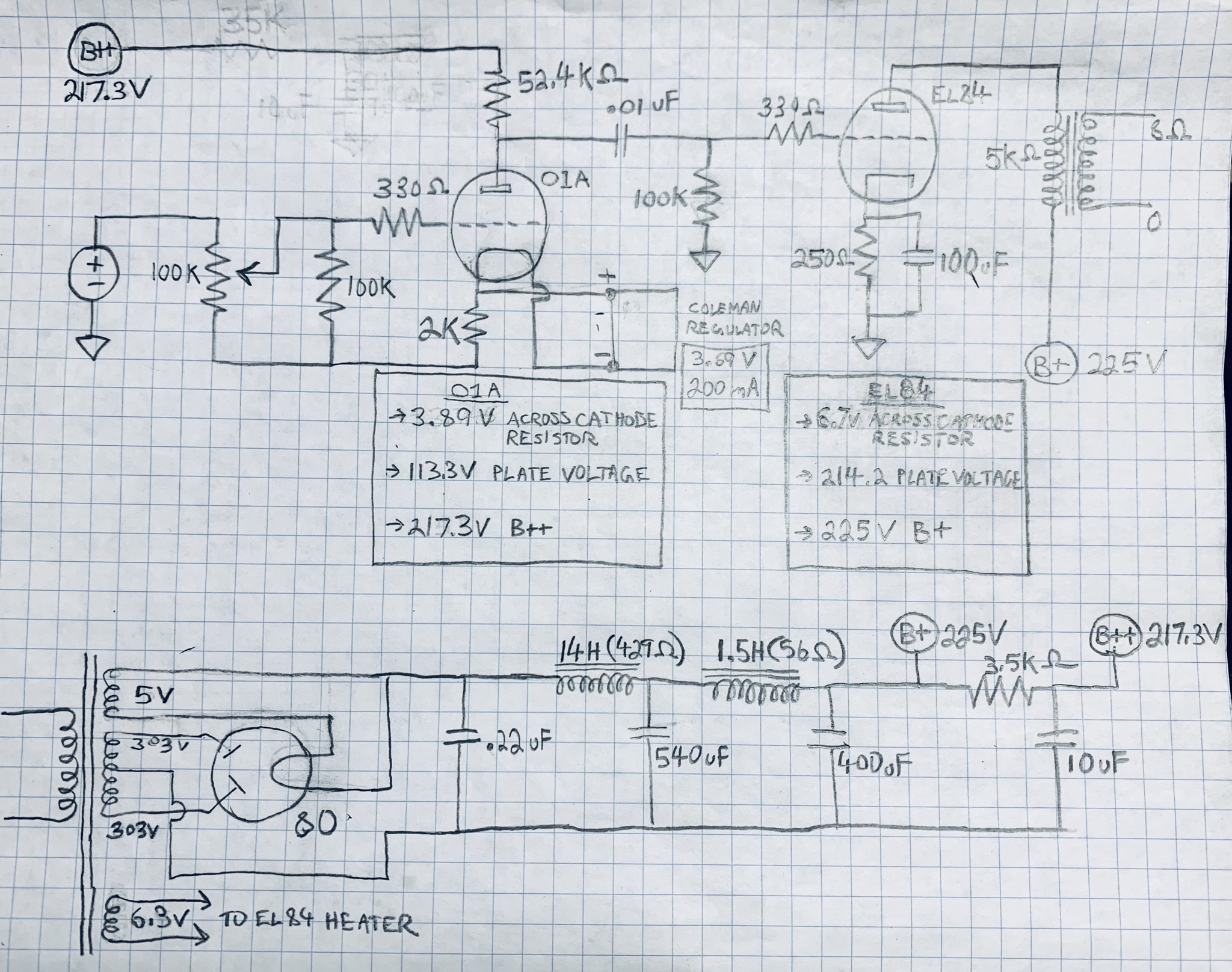

EL84 is in triode. I switched the output transformer I was using, which was a new one, to one that was once in another amp and is known to work properly. The EL84 sounds like it is buzzing steadily now at what sounds like 120 HZ. I had tried to increase the size of the power supply input cap to raise voltages a bit higher, but that resulted in the B+ voltage drifting up and down. I think John was right about oscillation in that case. The voltages now are a bit lower than I was shooting for, but they are steady. I will draw up the schematic as it now with all voltages and post it shortly.
This is the schematic of the amp as it is now.

tizman, if I am not wrong, you have two issues
Unstable B+
and
Hum
I think you should resolve unstable B+ issue first. Can you please tell us the current handling capability of the 14H and 1.5H chokes. We may run your PS in PSUDII and check if any issue there. Besides 01A is designed for 5 volt filament, why your supply is 3.69 volt? Yes CC is carbon comp.

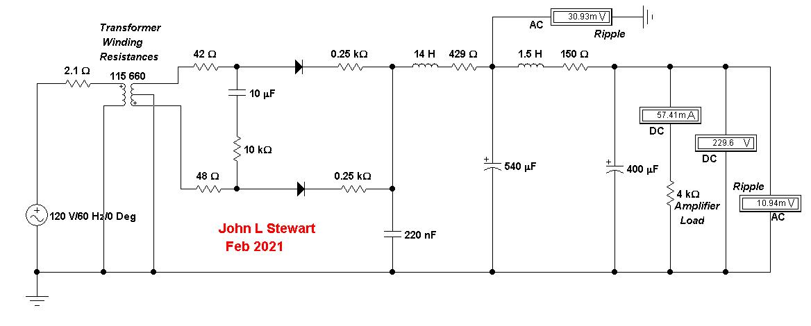

The power transformer’s primary resistance is 2.1 Ohms, and its secondary resistance is 90 Ohms.
Those are good numbers, typically what we see for these small PTs used in electronic circuitry in North America where the domestic supply is 60 Hz, 120V. For Minhaj the supply is 220V, 50 Hz.
So resistance/impedance of loads becomes
R = 2E / (1/2) I…………………………….4 E/I)……………..
And another 1.2X, wire winding on the core of inductors needs to be longer to provide the higher inductance required at the lower frequency (50 Hz). So the numbers for resistance loads on the domestic supply is very different than in North America.
The variations in voltages you are seeing are a sure thing caused by the loading of the portable heaters, the current required to generate heat that way is significant. There are entire books written on the problem associated with disturbances in power systems, I have a some here in my library. A couple of the companies I worked for sold equipment used in the diagnosis & failure in power systems.
The problems you are experiencing are difficult to diagnose without a scope. But with long wires where a grid lead might be close to a plate lead could trigger parasitic oscillation of the circuit. But I think your PS is OK.🙂
I’ll stuff those numbers into the EWB simulation, report back later.

Simulated your PS as is in PSUDII 14H L 540uf C filter makes stability/Rise time slow.
You may like to change this in order of 2 uf, 1st LC10H (100R) 100uf, 2nd LC1.5H (56R) 100uf, last RC 3.5K 10uf. this will give you 270 volt B+@40ma 10m ripple current and 260 volt B++ @3ma less than 1m ripple current. Stability and rise time 3 fold better.

Tomorrow, I am going to start from scratch and rebuild the power supply and amp circuit. There is something wrong with the power supply that I can’t figure out. Just now, the B+ voltage dropped to 190 Volts for no apparent reason. I suspect that there is an issue with the terminal strips I am using. Time for a fresh look tomorrow.
a 14H choke with 429R DC resistance may not be capable of handling 30-40ma load current. If so core will be saturated I know it will then fail to regulate but not sure if it will effect stability. Also double check all your solder joints and all the load resistors.
One easy trick to check stability of PS is to employ dummy loads (after disconnecting it from circuit load of course) and checking it with DMM.

The Hammond choke I am using is rated for 75mA, but I will try a different choke in that position.
