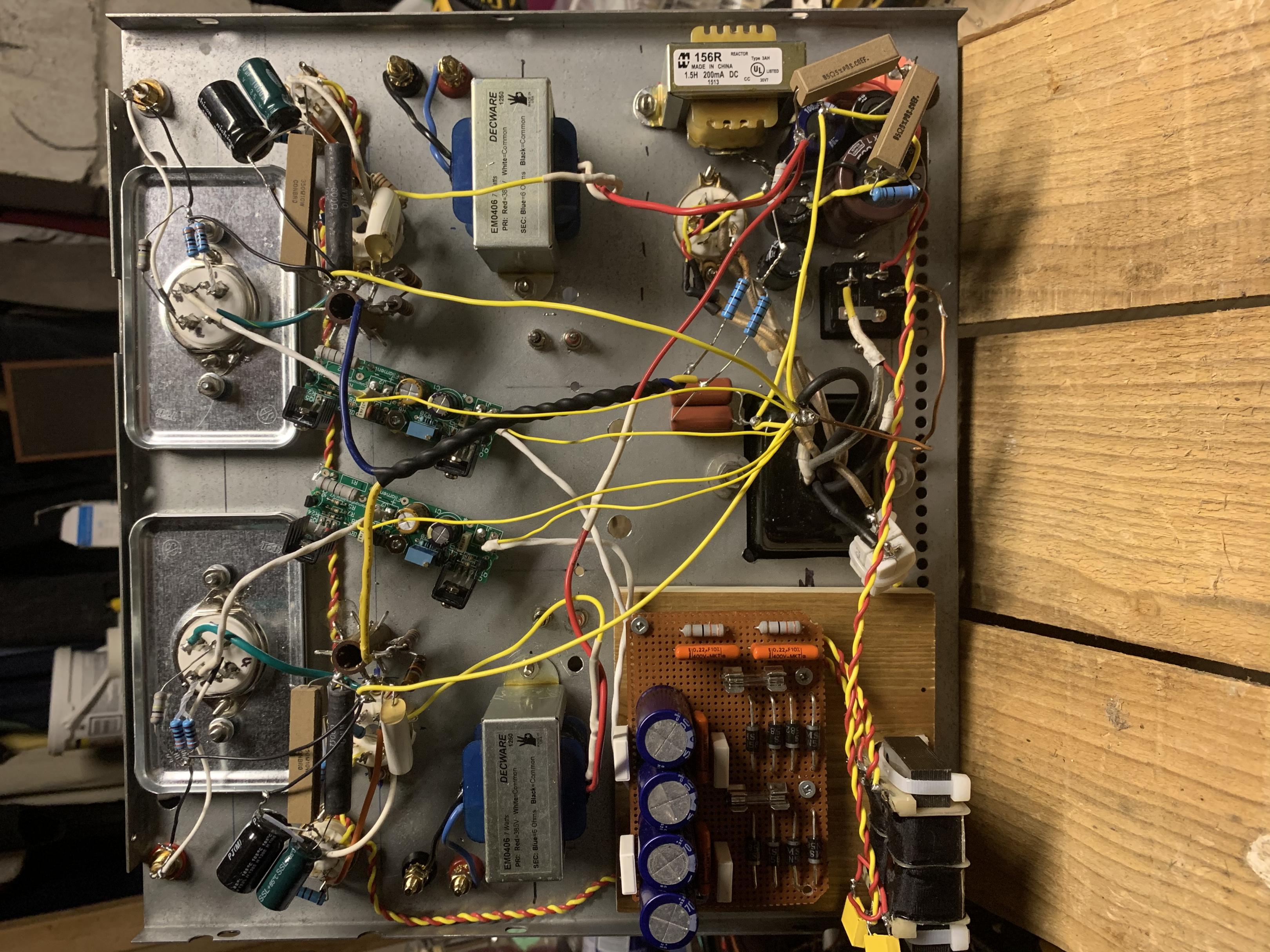

I looked more closely the pics, especially the tube's filament parts.
I don't understand one more thing: is EL84 tubes heating not part of HV transformer?
If I look it correctly, the twisted red/yellow filament wires (bottom view: on the left side from the back to left EL84 socket, than to the right EL84 socket) come from R.C filament transformer?
Is this grounded (with two few hundred Ohms from each socket pin), or lifted to about 1/4 B+?

euro21: The main transformer has a 6.3 volt winding that I am using for the EL84/6V6 tubes. I tucked the twisted red/yellow pair under the wooden plate that has the raw DC supply for the filaments on it, in the bottom right corner. Next to the power transformer there is a block made up of dropping resistors for the 6.3 volt winding, and I now added back the artificial centre tap resistors to ground. There was no change in the buzzy hum by adding the artificial centre tap or by lifting the 6.3 volt winding with 35 volts of DC.
I investigated the transformer for the filament supply, and it may have had one of the two primary windings terminal connectors broken off. When I was desoldering the transformer to remove it, the terminal came off along with the wire from the inlet. It may have happened just then while I was desoldering. Would having one of the two windings disconnected cause the problems I have been having with buzzy hum?
I have repaired the transformer by reattaching the disconnected terminal. Of will be ready to put back in tomorrow.

If you -temporary- move R.C. regulator boards closer to the amp centre (there is quite a lot of space here), is the hum changing?
The 6.3V AC filament wires passes through under the regulator boards.

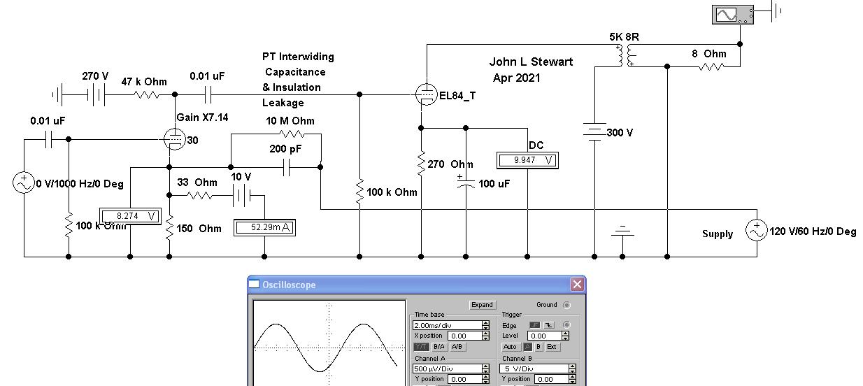

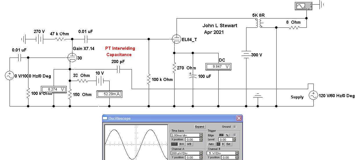

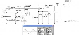

Uncommon Problems
I first noticed something odd in my amps many years ago that defied an ordinary explanation. I found there to be enough capacitance between the OPT windings & the core & between each other to make a difference in the end result. So much so that it was causing problems for my calculations of FB components to get stability.
On checking a common Hammond OPT I found the capacity from the primary to the core was ~20 pF at one end & ~200 pF from the other. So real inbalance for a PP circuit. I measured several others, they all had this sort of problem. The cause is that in common OPTs the primary winding begins at the core, there's a difference in capacitive coupling to the core from the ends of the winding. You will see the ends of the windings color coded so that the end of the wdg nearest the core is attached to B+. If it was the other way round the plate of the OP tube would have to drive a much larger capacity.
The interwinding capacities in PTs are sufficient that a small current can be coupled into a circuit, something that does not appear on the schematic.
In these simulations the conditions on the 30 filament are setup so that they look like they are driven by the external Coleman cct. The 33R resistor represents the 30 filament, 2V & 60 mA. The external filament PS is represented by the 120V 60 Hz supply at the lower RHS. A capacitive leakage current occurs thru the 200 pF interwinding coupling. The 60 Hz interference is 5 divisions on the scope about a mV p-p.
One of the example ccts on DIY was with the 26. Altho the gain thru that cct is about the same with the 30, the cathode cct is at a much lower impedance. So very little interference voltage can occur across the cathode resistor. A lot less gets to the speaker.
The 2nd sim has an insulation leakage component included. The interference signal increases to 2.5 mV p-p.
A large value cap shorts the interfering signal to common.
I can try that again but, in past iterations, the regulators were more in the middle and still made the same buzzy humming.
