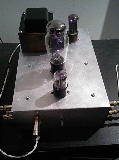

The 5998 is (arguably) identical to the WE 421A. My motivation for building the amp was this review of the FI 421A amp...
6moons audio reviews: Fi 421A stereo amp
I used the 5998 the same way that Don Garber used it in the 421A amp. One tube with one triode used per channel and a 6SL7 driver tube. With my operating point of 256 volts plate to cathode and -46.5 volt bias, or around 12 watts dissipation, I was getting just under 4 watts a channel. Have a look at the thread where I was trying to get help for its build...

That's a cool looking amp. The 5998 looks interesting, I'll have to take a closer look. But that's an awful lot of heater current for less than 4w output. Of course, it's colder where you live, so maybe that's a positive characteristic for you. What's the distortion level at 4w?I used the 5998 the same way that Don Garber used it in the 421A amp. One tube with one triode used per channel and a 6SL7 driver tube. With my operating point of 256 volts plate to cathode and -46.5 volt bias, or around 12 watts dissipation, I was getting just under 4 watts a channel.

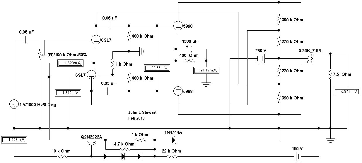

I thought your 5998 amp was SE using a single tube, one triode section per channel. Or are we talking about two different amps?FlaCharlie: jhstewart measured the distortion of the 5998 amp in its current form and gave me a printout, but I won’t be able to get to it until next week. He tried a few different drivers with the 5998 in push pull as well. It has two triodes, so each tube does a channel. From memory, I recall 10 watts in PP. It is a pricey tube though.

My amp is SE. I gave jhstewart a 5998 to experiment with and he tried it as a single tube in PP. In PP the tube uses 2.4 amps for heating the two triodes, which is high but, at 1.2 amps per triode, not crazy high.I thought your 5998 amp was SE using a single tube, one triode section per channel. Or are we talking about two different amps?

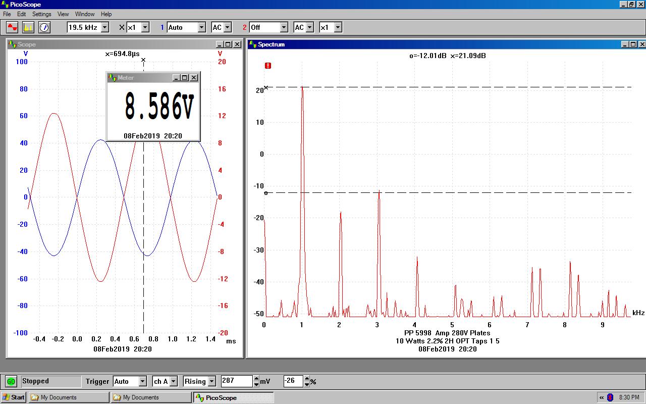

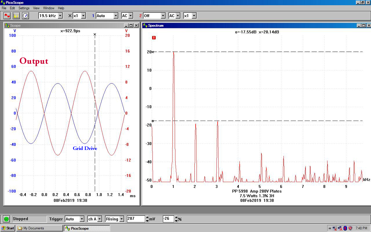

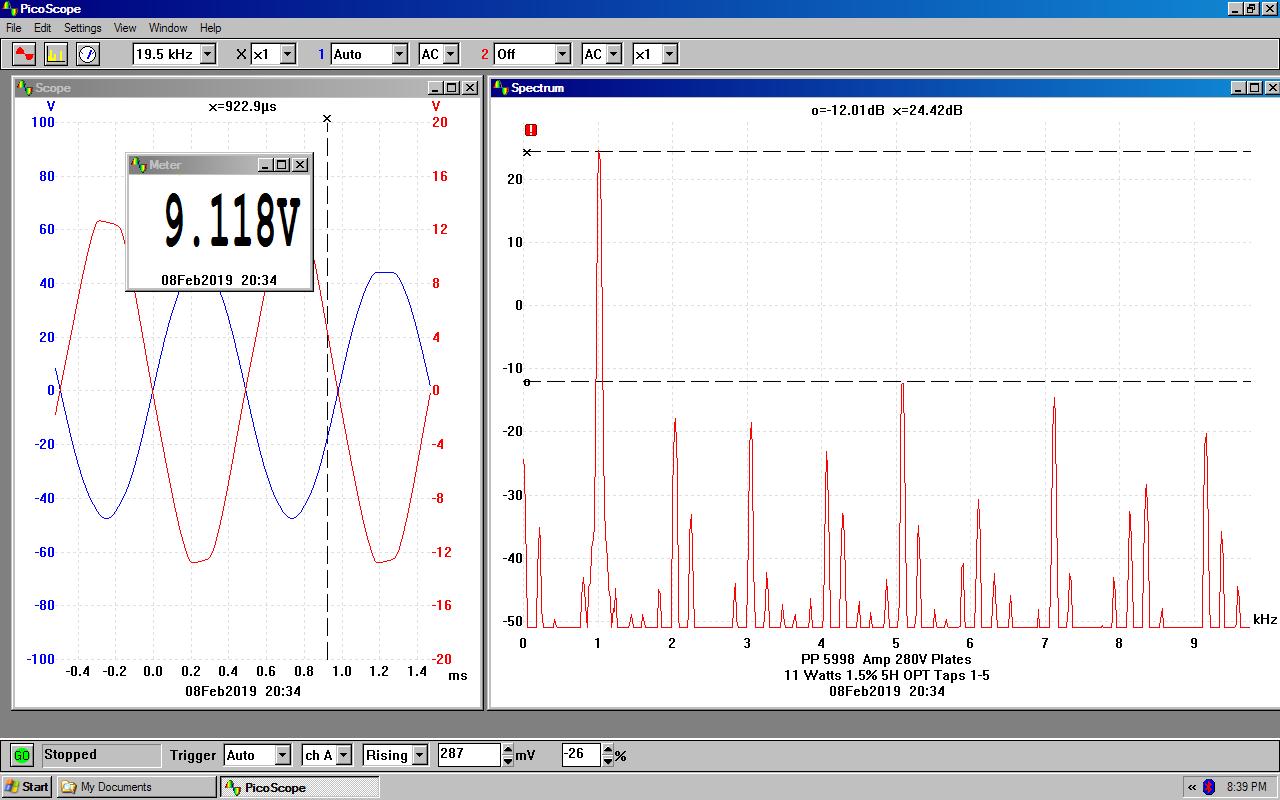

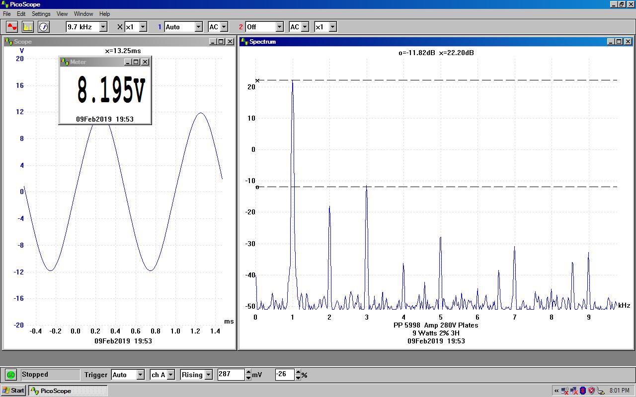

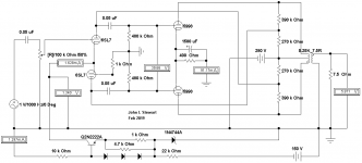

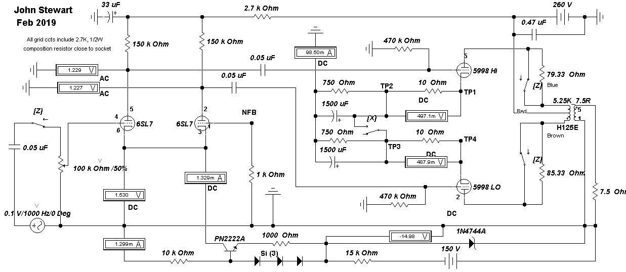

5998 PP Amp

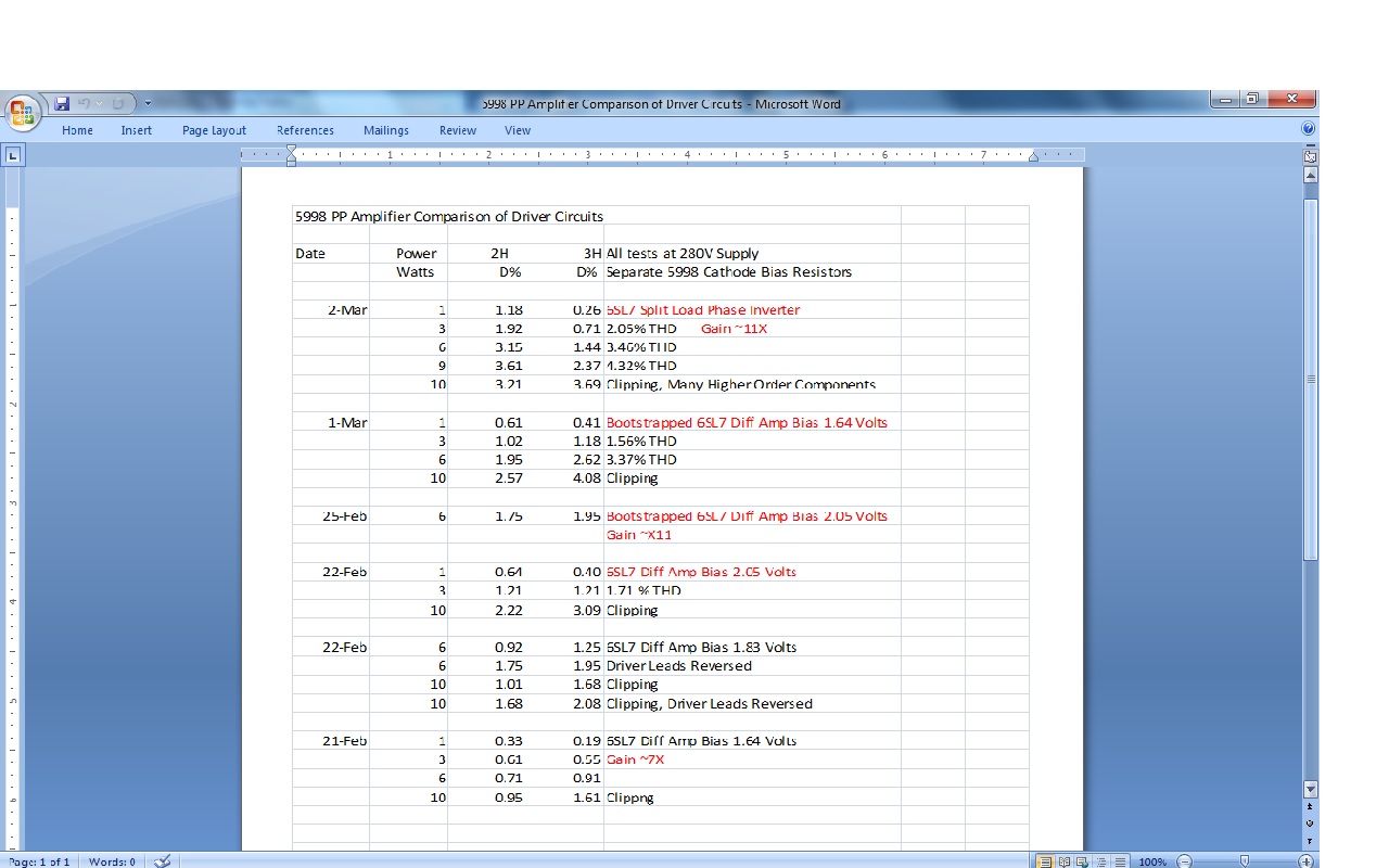

Some Results using Hammond 125E Universal OPT.
Damping Factor is 2.64
For 10 Watts Output 1.6 vrms is required at the input

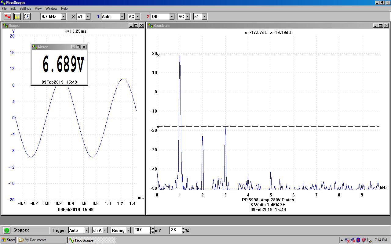

Intermodulation Distortion Measurements (IMD) are made by two methods-
Two Equal Level Frequencies, One & 1.6 KHz
80 Hz signal 12 db greater than 5 KHz, Sidebands of 5 KHz measured
Clipping begins at about 10 Watts
-3db at One Watt, 24 Hz & 16 KHz

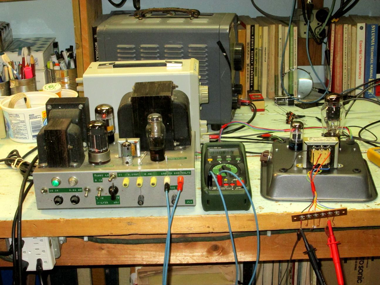

More 5998 Test Data
I tried many different combinations of driver & 5998 biasing.
And other sets of date covering PP 6BX7s (3W), PP 6BL7 (3W) & PP 6SN7 (one Watt). Much of the results are here in DIY on Lings thread covering his flea power 6SN7 project. The 6BL7 or 6BX7 can be used in his project with the proper OPT.
