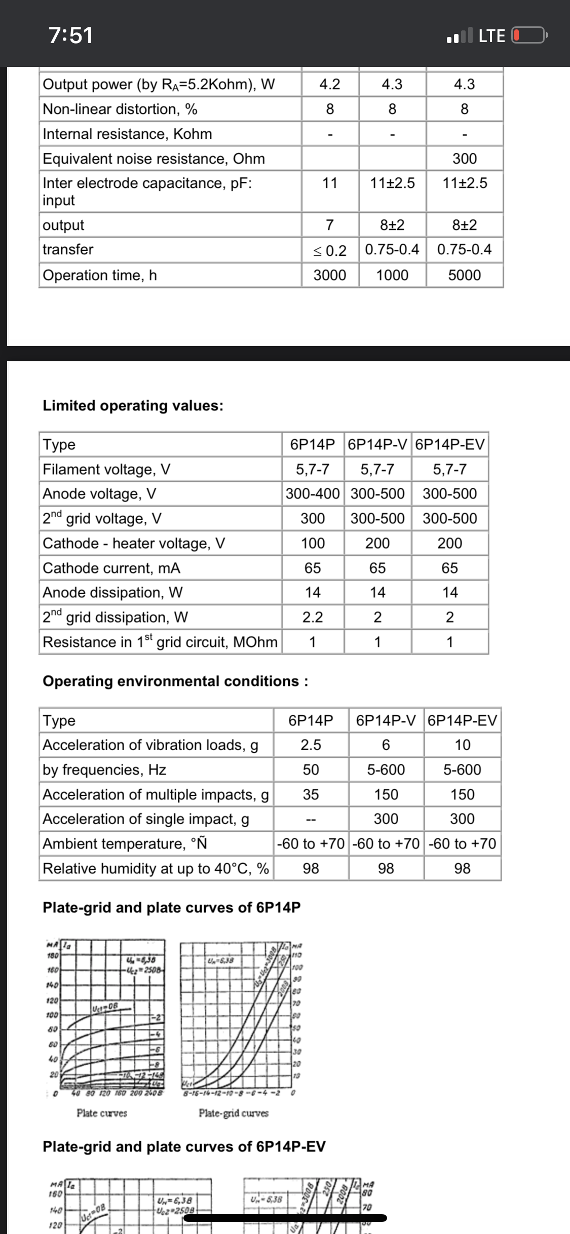

That’s good news, and not what I remember reading. That said, the above is not a data sheet for the 6P15P-EV. I can’t find a data sheet for the 6P15P-EV or 6P15P-ER (EB and EP). There are differences in the ratings of 6P14P, 6P14P-V and 6P14P-EV that may also be mirrored in the 6P15P tubes. Have a look at the attached screen shot. Could this indicate that the EV version of the 6P15P has a higher plate voltage limit or other different specs?

EV and ER have the same electrical specs at the very least. Possible 10% more plate dissipation for EV variant. The main difference is lifetime. Same as 6P14P, I think.
That table however is a bit misleading. The higher plate voltage than 300V is conditional for all variants. Only recommended for plate dissipation equal to or less than 8W. Instead the 330V for the 6P15P are not conditional.
