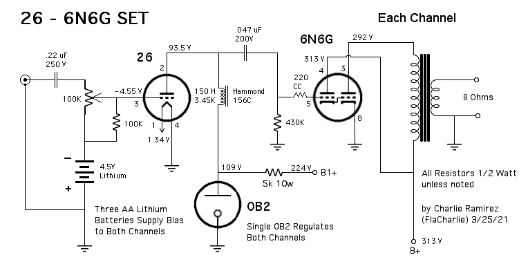

FlaCharlie: I am in the process of sourcing a few to try them out. For clarity, you use a DHT, then triode 1 of the 6N6G is the cathode follower, and triode 2 is the power triode? Is the 6N6G internally constructed so that it is set up as a cathode follower followed by the power triode? I’ll have a closer look at the data sheet as well. A three stage with a 30 followed by a triode connected 6P15P-EV, and then followed by a big triode or triode wired pentode could be fantastic if the qualities of the first two stages can make it through the last stage to the speakers.
tizman,
I am pretty sure that Rod Coleman can tell you what is the best way to apply the Coleman regulator for your type 30 tubes, and your amplifier.
He is a regular poster on this forum.
There may also be some good application information at his web site.
Rod Coleman has been very helpful. I have asked for, and received, help from him on multiple occasions. I feel like I’m annoying him with my many questions. There is information on the filament biasing of many tubes on his site, on Bartola Valves and on DIY Audio, but nothing for the type 30. The problem I am having with my amp may have been masked by adding a capacitor across the 30’s cathode bias resistor, but it is still there in reality. Ideally, I would fix the problem so that there is no need for the cathode bypass capacitor as I prefer a simple cathode resistor.
The DHT connects to the grid of the 6N6G, just like it does to the grid of the 6BQ5 or 6V6 in your current amp. The input triode is the cathode follower, the output section is the power triode.FlaCharlie: I am in the process of sourcing a few to try them out. For clarity, you use a DHT, then triode 1 of the 6N6G is the cathode follower, and triode 2 is the power triode? Is the 6N6G internally constructed so that it is set up as a cathode follower followed by the power triode?
The 6N6G can be dropped into the same socket as a 6V6. The heaters are still on Pins 2 and 7. The grid is still on Pin 5. The output plate is still on Pin 3, so that connection doesn't change either.
Here's the schematic of my amp, in it's current configuration:

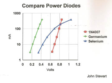

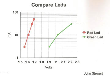

6A3sUMMER: I will try using LEDs to bias the 30 tubes. I believe that the Coleman regulators are not supposed to be grounded. Another option would be to use the Coleman regulators with filament bias. I’m not sure if that would result in a reduction of noise though.
In general silicon diodes have lower impedance & drop than any color of LED. And Germanium diodes even lower. The lowest drop LEDs begin at the red end of the spectrum & as we advance thru orange, yellow, green & so on the forward drop increases. There is also the IRED, infra red emitting diode.
The important spec for this application is the dynamic resistance at the operating current. The dynamic resistance is not E / I. It is delta E / delta I at the operating current. Need to read the data sheet carefully.
As an aside some of the guys at the HP SS lab constructed a balanced mixer using red LEDs instead of Shottky's. That can be used for a number of purpose such as a double sideband suppressed carrier signal. A starting point for a sideband transmitter. Matched sets of four Scottky's were sold for apps such as ring modulators & mixers.
We sold those LEDs by the million, the prices dropped like a rock!
LEDs & small signal diodes LEDs became a commodity & that part of HP was sold off to Avago Technologies.

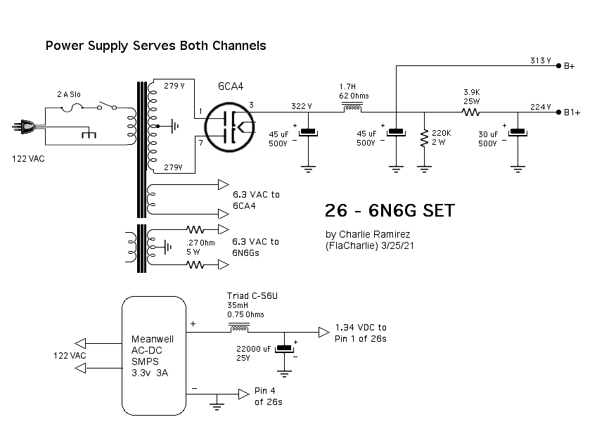

FlaCharlie: Looks great. Thanks for the schematic.

Is the 6N6G operated as a tetrode in FlaCharlie’s schematic attached above? As drawn by FlaCharlie, the power element looks like a triode. In the data sheet the power element has a second grid connected to the first grid and to the cathode. On the 6N6G power element, what is the part of the tube that looks like another grid element between the two connected grids and the cathode?
