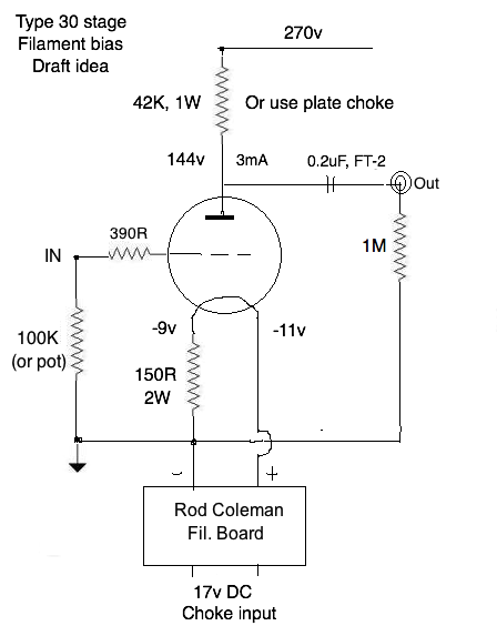

andyjevans: Thanks for the schematic. I will try another amp with filament bias and a plate choke as I have a pair of the 156C on hand. I also want to try the Bartola Gyrator on the plates.

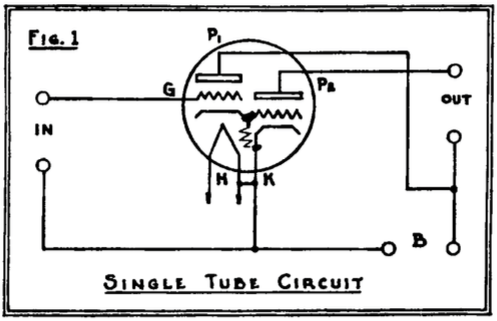

I don't see how a triode configured as a cathode follower that's directly coupled to another triode can be seen as a tetrode. But, then, I'm not the sharpest knife in the drawer. No doubt others will have a more informed answer regarding the technical aspects.Is the 6N6G operated as a tetrode in FlaCharlie’s schematic attached above? As drawn by FlaCharlie, the power element looks like a triode. In the data sheet the power element has a second grid connected to the first grid and to the cathode. On the 6N6G power element, what is the part of the tube that looks like another grid element between the two connected grids and the cathode?
The developer of the tube, Triad, seems to have dubbed the design as a "Triadyne", although the name doesn't seem to have caught on. The data sheet clearly describes it, and depicts it, as a dual triode.
For my schematic I had to draw my own version since, not surprisingly, I couldn't find one. My diagram is essentially the same as the one in their original data sheet for the 6B5, which was the first version of this tube. Since it's a small space I simply omitted the internal bias resistor. Triad also omits the resistor from less detailed diagrams in their data sheets.
I've attached the original Triad diagram from their extremely detailed data sheet. I think your confusion is based on the diagram shown in a data sheet published by a different manufacturer. It seems to me that the Triad data sheet should be considered the definitive version, since they invented the tube.
A survey of the data sheets published by other manufacturers reveal that there was no consensus on how to draw the internals of these tubes. While I find that to be curious, I'm more interested in more practical aspects such as the basic implementation of the tube and how it sounds.

#30 filament current is 60mA.
For example -one of recommended- bias point is 135V, 3mA, -9V.
If you use 150R as filament bias resistor, the 60mA current trough it results 9V bias.
Because this filament bias resistor is too large, I recommend to use few hundred uF capacitor paralleling.
#30 filament current is 60mA. For example -one of recommended- bias point is 135V, 3mA, -9V. If you use 150R as filament bias resistor, the 60mA current trough it results 9V bias.Because this filament bias resistor is too large, I recommend to use few hundred uF capacitor paralleling.
Yes, I used this "book" operating point in my suggested circuit. But I find that 150R doesn't need a bypass if you have good inductance on your plate choke. My plate chokes are 150H or more, and they cope fine with resistor values up to around 250R. Lower is better of course, but I'm not a fan of bypasses however nice the DC Link caps sound.
Another recommended operation point for the 30 is 90v, 2.5mA, -4.5v. This would allow you to cut the bias resistor value in half to 75R.#30 filament current is 60mA.

In your opinion, would this allow him to eliminate the bypass cap?
Another recommended operation point for the 30 is 90v, 2.5mA, -4.5v. This would allow you to cut the bias resistor value in half to 75R. In your opinion, would this allow him to eliminate the bypass cap?
As you say, you can play around with operating points and lower the resistor value. It all depends on the inductance of your plate chokes. The LL1667/8 should be fine.
Another way to do it is change the tube. The VT-67 is a type 30 with twice the filament current. So for 9v bias you'd have your 75R cathode resistor. Less microphonic as well.

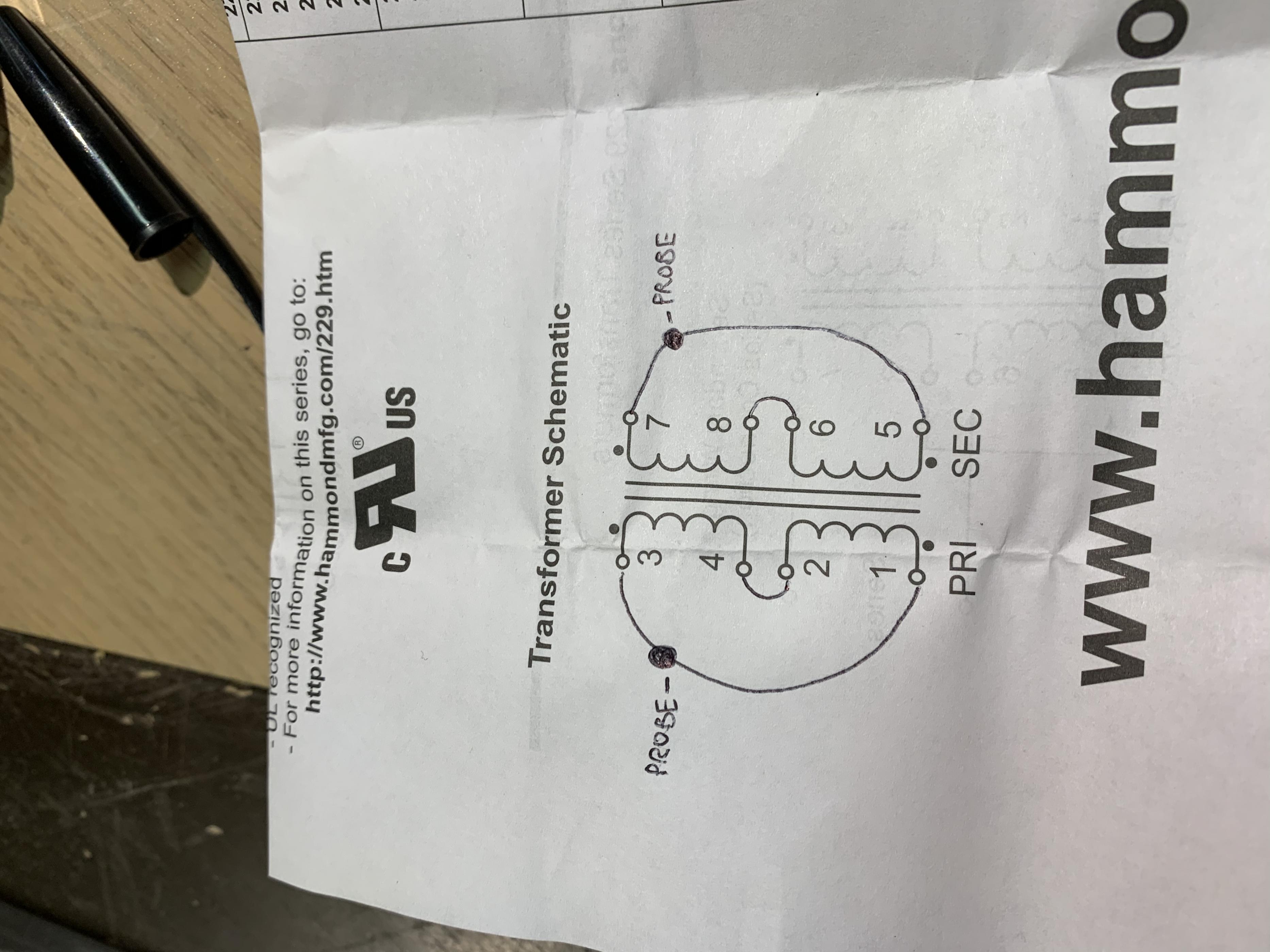

Rod: How do I properly measure capacitance from primary to secondary on the Hammond 229B16? It has two primaries and two secondaries. If I attach the DMM probes as indicated in the attached photo, I get 36 pF.
Short leads 1, 2, 3, and 4 together
Shore leads 5, 6, 7, and 8 together
Then measure from 1 2 3 4 to 5 6 7 8
At some frequencies that may be more accurate.
The results may show higher capacitance than the 36pF you measured.
Just my opinion.
Just my opinion.
6A3sUMMER: All the leads are shorted on both sides of the transformer as per the diagram, so 36 pF is the capacitance shown by my meter. This is below the range Rod said should be okay. He said "50-70 pF is usually good enough for filament supplies".
