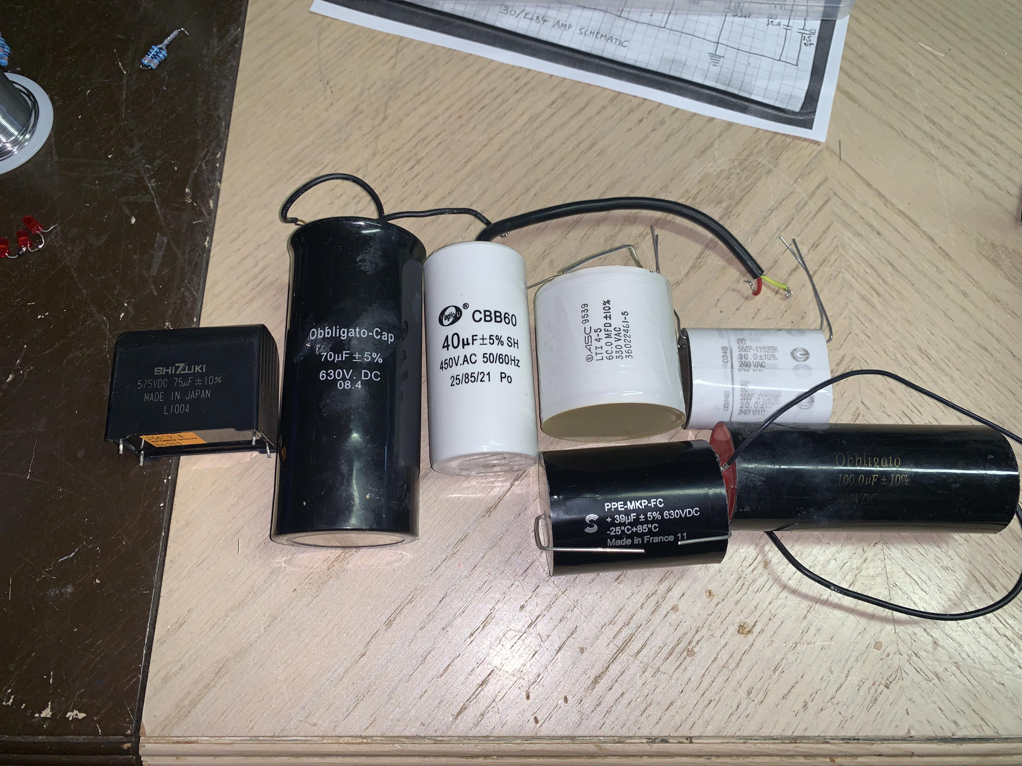

If you're not yet using DC Link capacitors as cathode bypasses, I strongly recommend you order a pair. I'm using Vishay and Kemet 40uF. Vishay gives slightly better treble, Kemets have a slightly richer midrange. WIMA and Epcos also make them. I'm pretty sure you'll hear an increase in clarity over electrolytics or other polypropylenes. I'm also using a 15uF DC Link as the last capacitor in the PSU. That makes a difference too.
andyjevans: How do DC-Link capacitors differ from regular film capacitors? I have used film caps for cathode bypass in past builds, and have used larger than normal chassis to fit them in.
andyjevans: I’ll order some on the next Digikey order. Is there a particular sku I should be looking for? At the moment the amp has Elna Silmic II on the 30 cathodes. The power supply is split at the final node for the 30s, and the last capacitors are 2.2 uF film caps. I do this on all amps for the final node to the driver tubes.
Up to you what values you go for. I did a shootout using cathode bypass on a 300b amp and the DC Link caps were audibly better than Clarity Cap polypropylenes, generic electrolytics and motor run caps. Vishay is more focussed, Kemet a little richer. Haven't auditioned Epcos or WIMA.

I have used a few different film caps. I have tried a number of large surplus film caps and ASC cans for cathode bypass. Values have always been 100 uF down to 40 iF. I have not compared different bypass caps in the same amp. In general, when I’m building a “serious” amp, I don’t use any electrolytics at all if possible. In the past this has been more about longevity of parts than sound quality. I have a large stash of biggish film caps. This is an assortment of the caps of which I have several of each. Will the DC-Link be noticeably better?

Well, you can do your own shootout in the same amp by using clip leads and attaching your various caps one by one as cathode bypasses on the outputs. I was quite surprised at what I heard. Also watch out if you are switching caps that you discharge the voltage on them - you can get unexpected shocks! (....as I did)
The DC link caps were audibly clearer than 2 good polypropylene caps - ICW PW series and very big ICW Clarity Caps rated 630v. Since these look to be comparable to the caps you pictured, my bet would be that yes, you will hear an improvement. And more so if you also use them as the last caps in the PSU. Try it and let us know.

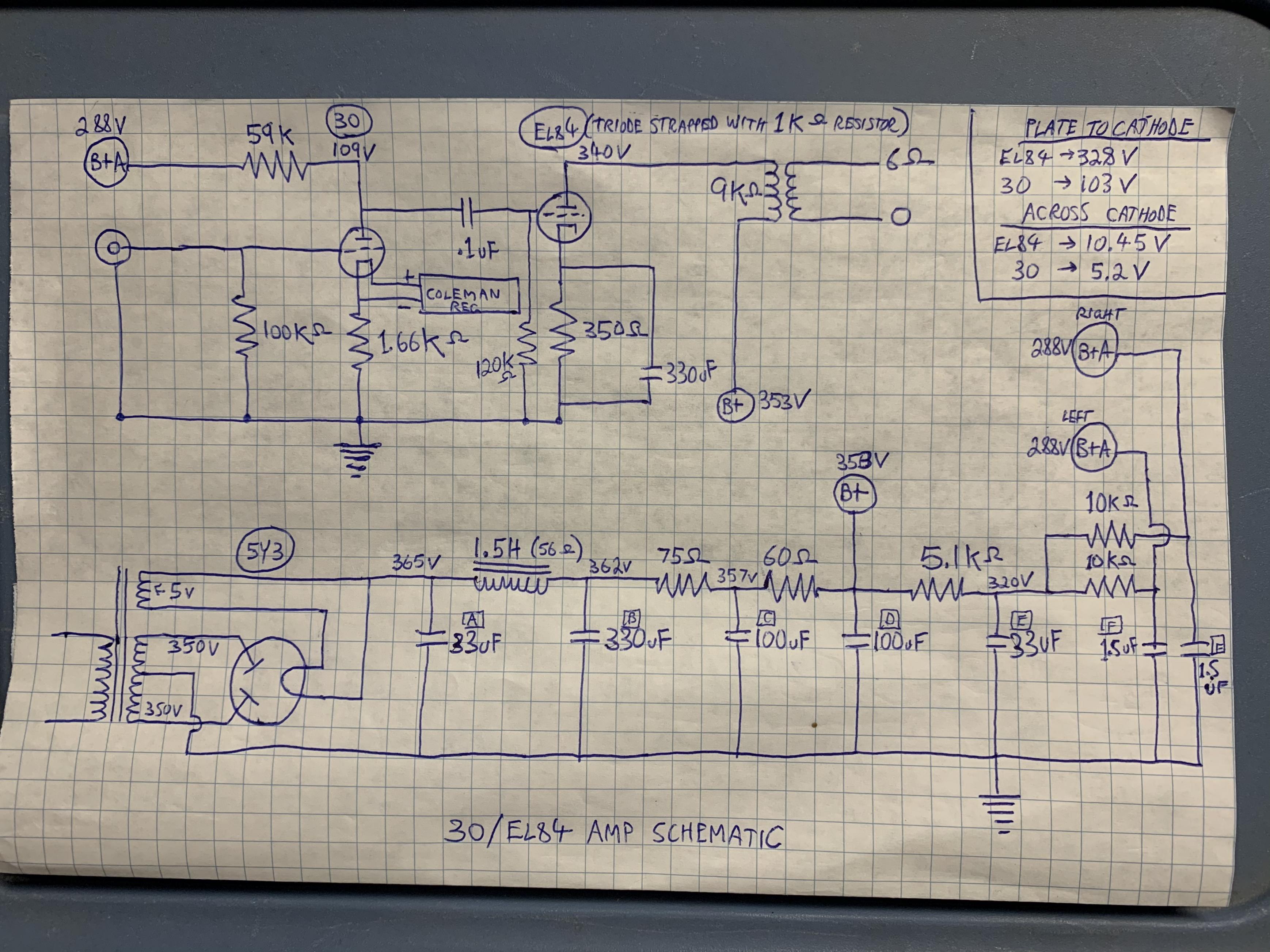

A 2.2uf as the last cap in the PS seems awfully small to me. Is there some reason for using such a low value?andyjevans: I’ll order some on the next Digikey order. Is there a particular sku I should be looking for? At the moment the amp has Elna Silmic II on the 30 cathodes. The power supply is split at the final node for the 30s, and the last capacitors are 2.2 uF film caps. I do this on all amps for the final node to the driver tubes.

FlaCharlie: The attached schematic is not exactly what is in the amp at the moment, but the power supply is close to the same. B+ for the power tubes comes off 100 uF capacitor D. There is then a resistor, 33 uF capacitor E, and then the supply splits for the left and right 30 tubes. At this point there is a 10K Ohm resistor with its own 1.5 uF to ground for each tube, and then the plate resistors. I have been doing this for years after noticing it done in a commercial amp schematic. The theory is that this serves to better decouple the channels from each other. Do you think the last cap needs to be bigger for a 30 tube's B+? The B+ is super duper clean in this amp. Arguably, unnecessarily clean. When I want to do it "right", I replace the 5.1K resistor with a small choke for even more decoupling from the power supply node feeding the power tubes.

A 2.2uf as the last cap in the PS seems awfully small to me. Is there some reason for using such a low value? I typically use somewhere between 15uf and 50uf but I can't say I've really done any A-B comparisons.
Yes - "somewhere between 15uf and 50uf" is what I use, exactly that.

andyjevans: Easy enough to up the value of the last two caps. I’ll try it out. Is there a formula for final capacitor size? Each 30 has its own capacitor.

I used split PS before, too, and I understand the theory behind that aspect. I was just wondering if there was any advantage, whether practical or technical, to using such a low cap value.FlaCharlie: The attached schematic is not exactly what is in the amp at the moment, but the power supply is close to the same. B+ for the power tubes comes off 100 uF capacitor D. There is then a resistor, 33 uF capacitor E, and then the supply splits for the left and right 30 tubes. At this point there is a 10K Ohm resistor with its own 1.5 uF to ground for each tube, and then the plate resistors. I have been doing this for years after noticing it done in a commercial amp schematic. The theory is that this serves to better decouple the channels from each other. Do you think the last cap needs to be bigger for a 30 tube's B+? The B+ is super duper clean in this amp. Arguably, unnecessarily clean. When I want to do it "right", I replace the 5.1K resistor with a small choke for even more decoupling from the power supply node feeding the power tubes.
Logically, it seems to me that doing so could have negative consequences if the small cap can't keep up with the demand. But, since I lack the knowledge and ability to measure, I don't know if that would happen in practice.
I also tend to build stuff with more PS filtration than it probably really needs. While a larger cap (15uf to 50uf) might be overkill in terms of smoothing, I'd rather have more energy storage reserve than I need rather than (possibly) not enough.

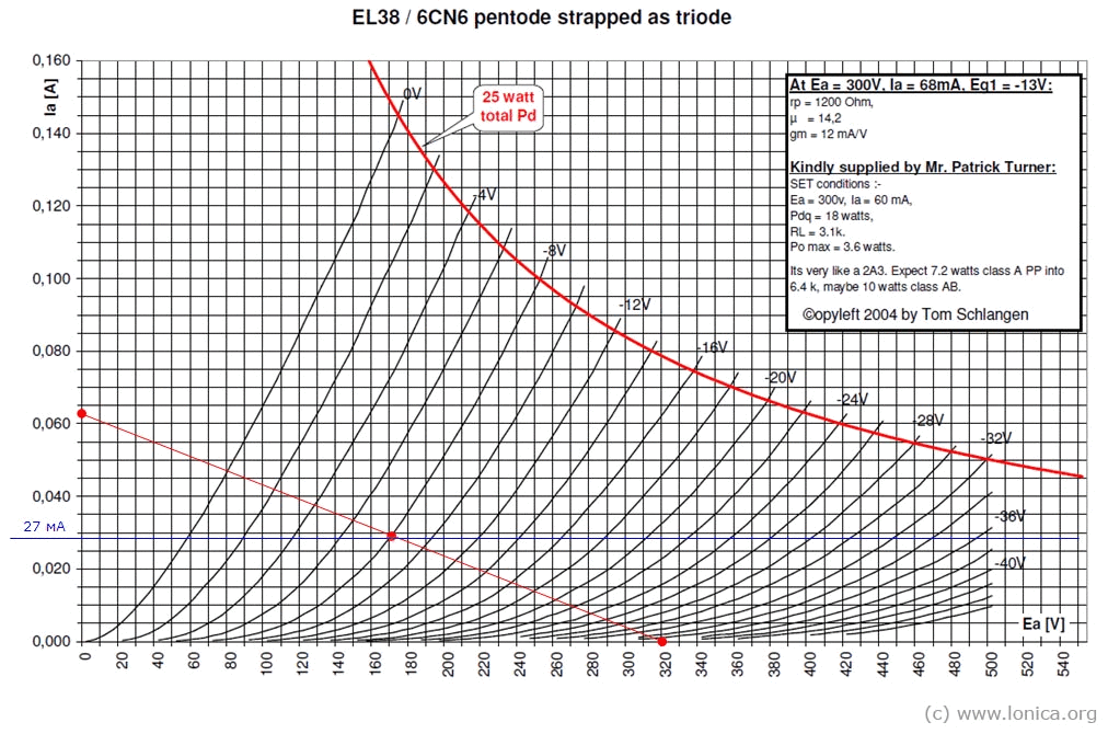

Andy..am interested about El38. What is its plate resistance when triode connected @say 350 volt anode to cathode at 50ma current? Do you have any triode connected plate curves? Regards
I think the place resistance is around 1.2K. I'm using a 3.5K OPT on the 4 ohm tap. Looks like it needs 5K primary. Curves here:
