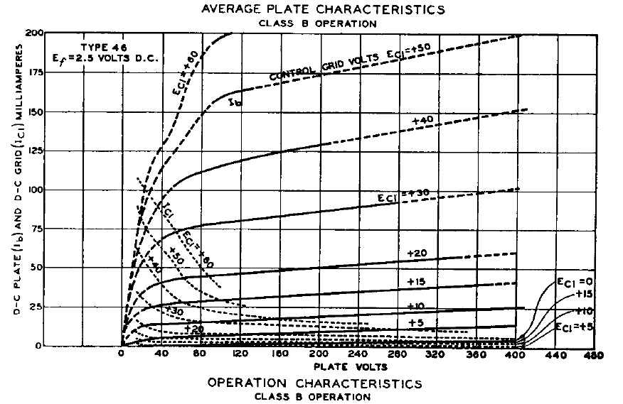

6N6G & Similar
Are nothing more than a high mu triode like a 46 driven into Class A2 by a direct coupled cathode follower. Nothing more, nothing less.
Refer to the 46 Plate Curves, looks like a pentode. To simulate the 6N6G the control grid would be biased up to something like 10V as an operating point by a direct coupled CF.
Worked for me using a 6F6 with G1 & G2 tied together, run in Class A2 driven by paralleled sections of a 6SN7 CF..🙂
The end result looks like a pentode. Unless one looks inside the glass bottle. Or sees no external biasing network.

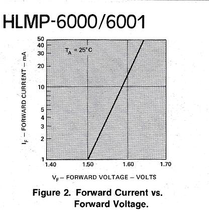

LED Biasing

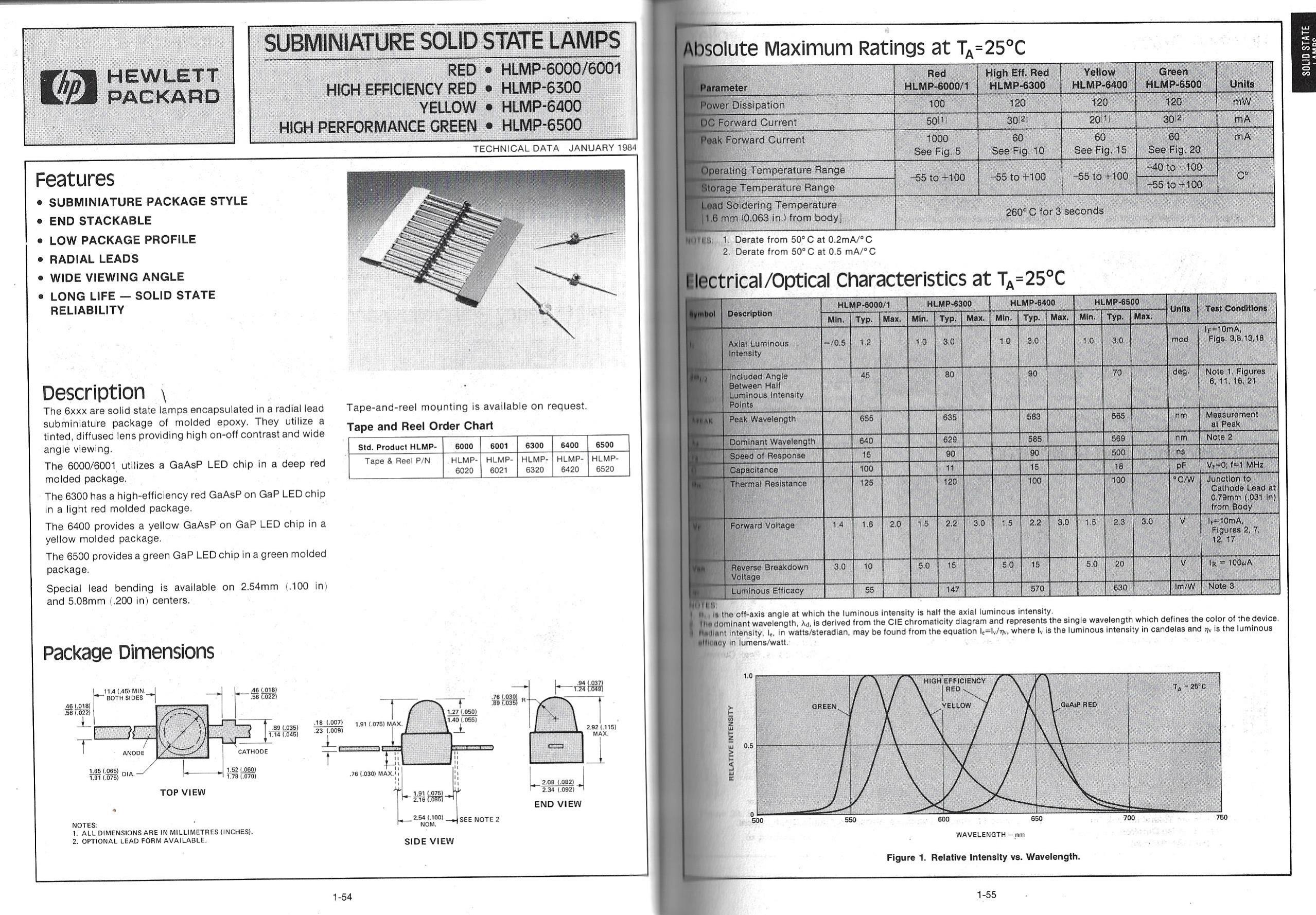

Many common LEDs such as the HLMP 6000 Series are max'd out at 50 mA If. Not a good idea if the filament current is included in the current thru the LED. But would be OK if only the 30 or other plate current.🙂
jhstewart9. I'm not sure how the filament current is involved when biasing with LEDs.

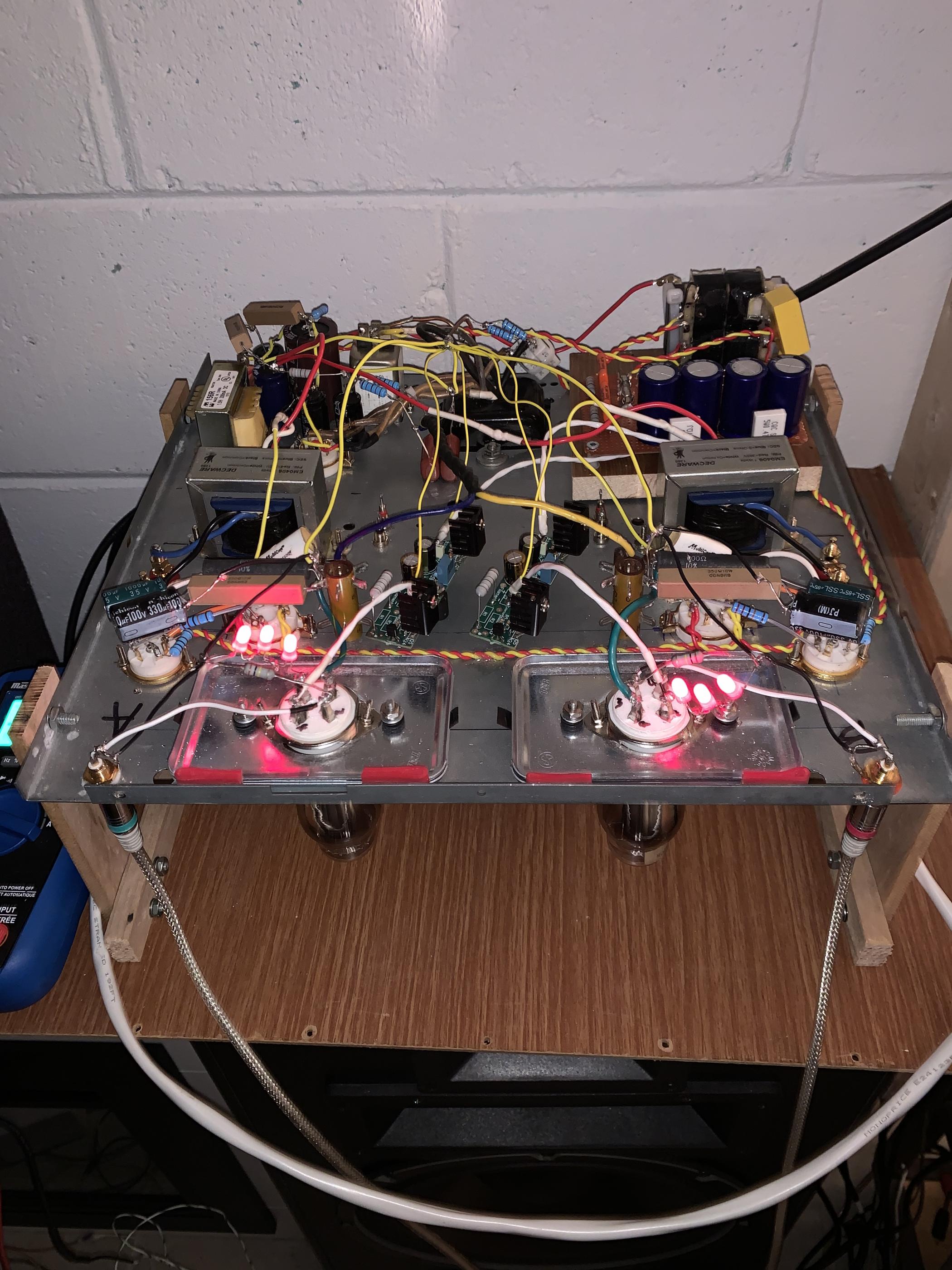

I removed the resistor and its capacitor bypass on the cathode and tried 3 regular 5mm red LEDs in series per side for 5.1 volts of bias on the 30 tubes. See the attached photo. The LEDs resulted in the least noise at the speakers so far. I listened to the amp for about an hour after the swap, and put the resistor and capacitor back in at the end of it. The amp lost most of the qualities that I really like about it with the LEDs in it. With the resistor and capacitor back in, those qualities returned. The sense of having a real musician playing in front of me returned.

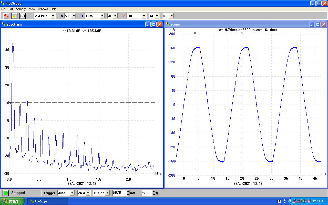

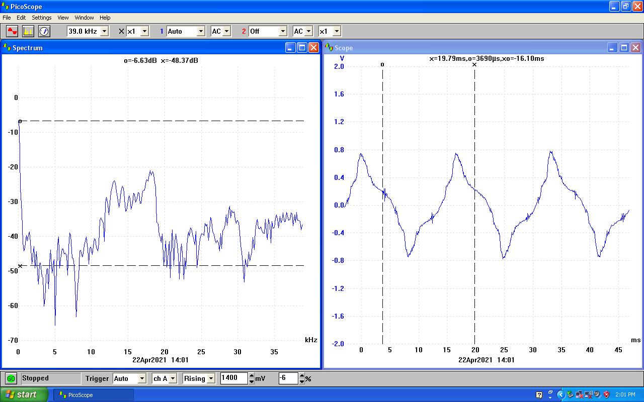

When many would take these capacities as insignificant as a path for interference, the interference spectrum in today's power systems contains a broad spectrum of harmonice caused by the myriad of switched mode devices we now use. 60 or more years ago flourecent lights were probably the only thing in the home that was a problem. But now we have an entire house full of devices that degrade power quality.
I measured the power spectrum here yesterday, we can see many higher order components. The higher the frequency, the easier to pass thru a small cap.
On the common mode measurement much interference appears. Notice the small glitcth on the 'o' marker, 3.7 mS on the spectrum display. That is caused by a large load somewhere on the system modulating the voltage. These are the kind of things that can get thru a common PT as common mode problem. A Faraday shield would eliminate most of that.
All this not usually a problem on an ordinary amplifier. But when the interference spectrum has an easy path into the cathode on a voltage amplifier, great care must be taken.
There is a large selection of test equipment on the market to measure these problems. The companies I worked for offering such test equipment were HP, R&S, Schaffner, Voltech, Keytek, Aeroflex, IFR & on & on. Other names in the industry would be Dranetz, BMI & many others.🙂

The LEDs form a voltage drop to provide the -ve bias to the 30 Grid, same as the normal 150R. But your numbers look ominous, did you ensure the 30 filament was still 2V? The lower bias measured indicates some of the filament supply voltage is lost!!😱
