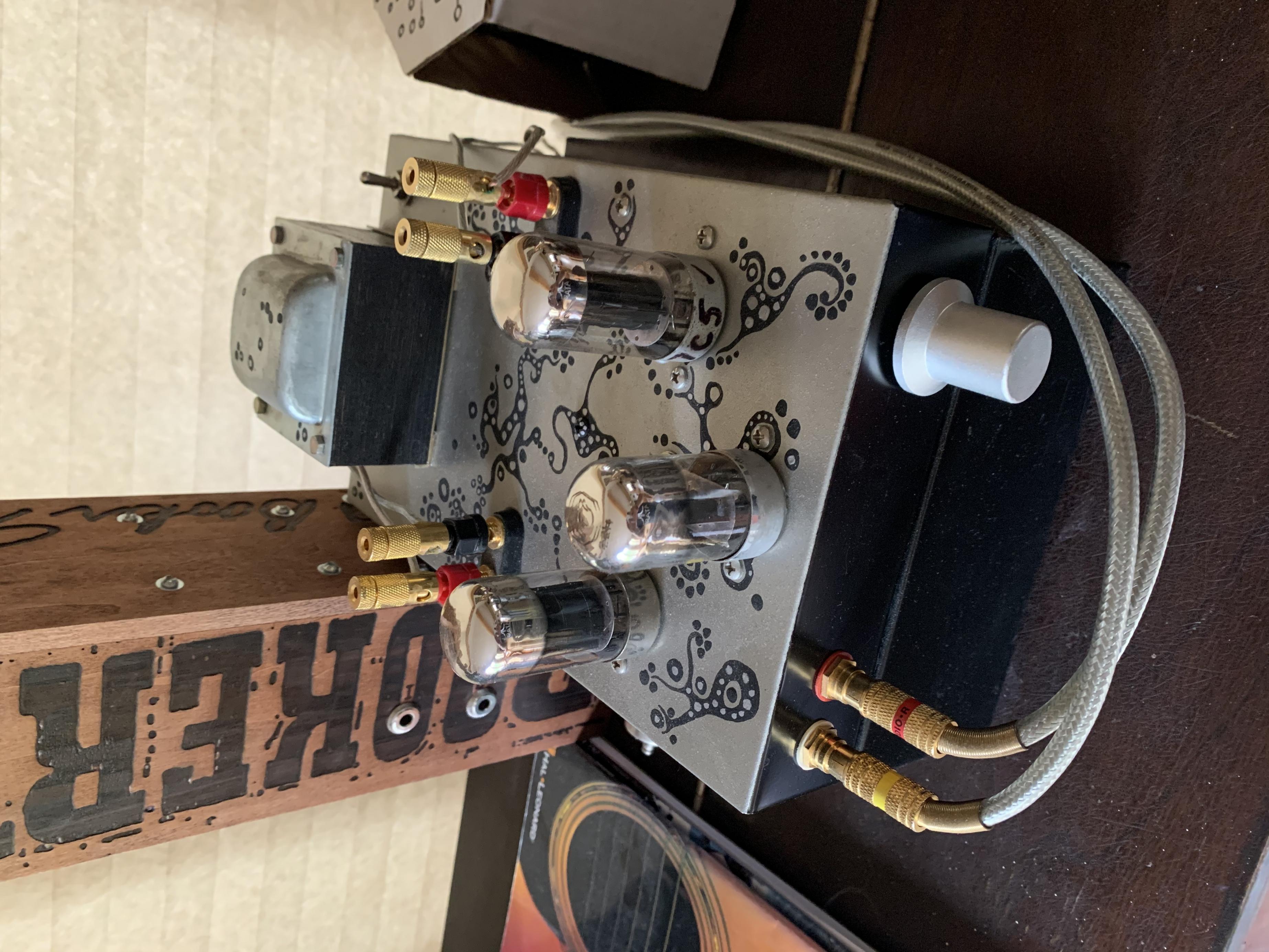

I like your cash box amp. I'm always looking for ways to use repurposed elements in my builds.
I’m uncertain about the theory on final cap size as well. I was under the impression that the final node for the driver tubes didn’t require a large cap, as it has a small draw, and that a film cap is preferable on that node, but I cant recall how I got that impression. I need to do some research. If anyone can point me to formula or rule of thumb, that would be great.
I love building into old metal boxes. I have built four amps this way using the innards of console amps. I gifted two of them and have two still. Attached is a photo of my loctal cash box amp.

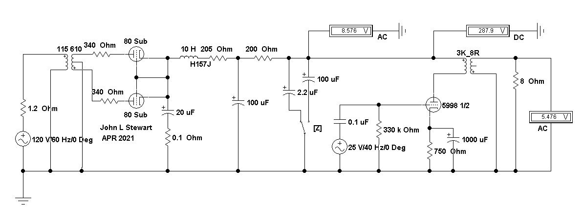

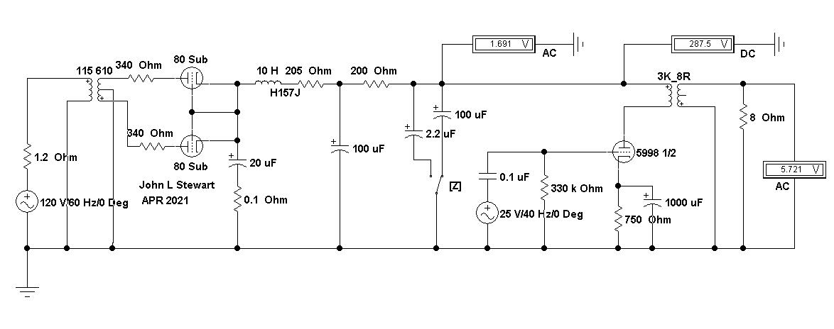

FlaCharlie: I’ll put some extra capacitance in parallel and give it a listen. It would be nice to have a clear answer on what is ideal though.
Amplifier Power Supply with ‘Trick’ Final capacitor
Thought I’d seen everything but this is something new. Given the lowest frequency of a Bass Guitar is 80 Hz while Piano & Pipe Organ is much lower, this is a great way to ruin the overall performance of your system. When the PS sags on low frequencies, that causes intermod distortion products to be created on all the other frequencies passing thru the amplifier to the speaker. Some may like that. These trick circuit modifications should come with a disclaimer. Such as ‘Your results may differ’. And if we could find the originator, ask why the feeble final cap improves the performance of the system.
But I’m not the listener, so enjoy. The simulations show the size of the AC voltage modulating the PS B+ by a single triode in the 5998 whens driven to 3.75W at 40 Hz. Two values of the final cap are selected by the Key “Z”. A too small cap in the PS filtering is a leading cause of ‘motor boating’ in amplifiers.🙂

jhstewart: Please explain what the sims are showing, and how this impacts the performance for this amp. There is a big difference in the AC measurement. Does the large current draw of the 5998 triode affect this? In the case of this amp, the power supply is split at the 30 tube. The 30 has a current draw of 3 mA. The small 2.2 uF capacitor is on the driver tube rather than on the power tube as shown in the sims. I understand that the sims are meant to show what happens when cap size is small vs big, but what is the impact of cap size with a much smaller tube with less current draw?
The split of the power supply at the point where it goes to the left and right driver tube is supposed to be an attempt at decoupling the two channels from each other. My understanding is that this is the designers reason for the split. As to the size of the capacitors, the small size may just be their way of saving some money. It is easy enough to increase the amount of capacitance on the driver tubes on this amp, and I will try it soon.
It would be useful to have a guideline that should be followed for sizing the capacitor that feeds a node. In the case of this amp as it set up now, the power tubes draw close to 100 mA. At the power supply node for the power tubes, there is a 100 uF capacitor. As the power supply splits before the nodes for the 30s, each has a 2.2 uF capacitor. Each 30 draws around 3mA. Is it a uF/mA equation? If so, the power tubes have 1 mA/1 uF. The driver tubes draw 3 mA and have 2.2 uF, which is 1 mA:0.7333 uF.
Again, as I have already said, I don’t know how to figure out what constitutes a properly sized capacitor for a given power supply node. I welcome any sources of reading material or methods that can be used to figure this out. I haven’t found any online yet but I may be looking in the wrong place.
For a single-ended amp, the power supply is in series with the load. Maybe just ask yourself what you want to be in series with the load. (And is also quiet enough for the job, etc.)

Chris: That is a good question. I recall very spirited threads here, and on other forums, about what a good power supply should be like. There was not very much in the way of hard science and measurements in those threads. People mostly had opinions based upon listening. The tension between listening and measuring was, and is, always present.
Here are some of the things I read:
-I should avoid series resistance as much as possible in a power supply because it kills dynamics. For this reason big H value chokes with low resistance are preferable to resistors to get the same smoothing. A power supply should always have less than 100 Ohms of total series resistance, with 50 Ohms being the target.
I try to keep series resistance to the power tubes low in my amps. This amp has 191 Ohms of series resistance in the power supply before the power tubes. I'm 91 Ohms over the limit.
-Too much capacitance is bad. It bloats the sound.
I don't follow this, and in fact usually go too far in the opposite direction.
-Got to be Black Gates, film caps are not as good and forget about electrolytics.
I have never even seen a Black Gate that was over 16 volts.
-Ideally, every tube should have it's own power supply. When a transformer is shared between stages, or between channels, the stages and channels modulate each other and sound quality suffers. When using a single power transformer for a two channel amp, take every opportunity to decouple stages and channels.
When I build an amp, I do try to decouple. The split of the power supply at the 30's is me trying to decouple the channels from each other. Ignoring the cap size, does the split as implemented in my amp decouple the two channels, or am I wasting my time and effort?
