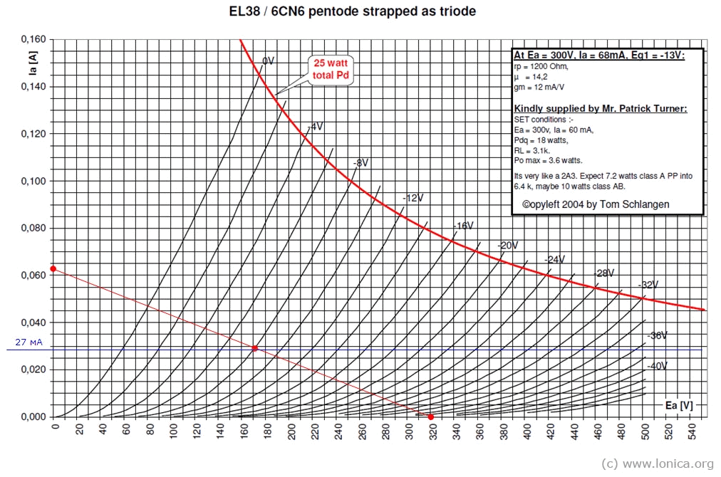

EL38 is in triode with an O-Netics 3.5K OPT on the 4 ohm setting. Haven't measured power out. Dissipation is around 18W, 260v a-k at 70mA. Yes - 2 stage amp as usual for me. The 10Y was great as a driver but I also used EL33 which was pretty good too. I imagine a 2P29L would be a nice driver, though I didn't try it.
I assume your speakers are nominally 8 ohms, correct? If so, that would present a 7k load to the tube.EL38 is in triode with an O-Netics 3.5K OPT on the 4 ohm setting. Haven't measured power out. Dissipation is around 18W, 260v a-k at 70mA. Yes - 2 stage amp as usual for me. The 10Y was great as a driver but I also used EL33 which was pretty good too. I imagine a 2P29L would be a nice driver, though I didn't try it.
There don't seem to be any curves for these, much less triode curves. How much negative voltage do you have on the grid? Are you using cathode bias? If so, what value resistor?
Any thoughts on using drivers such as 26 or 01A?
Yes, speakers Alpair 10M are nominally 8R. Curves here. I think you need a bit more current than the 01A and 26, though I did use 01A for a while before going back to 10Y. A cathode follower or source follower is often used with the 01A but I never rigged it up. Cathode bias -11v, 156R resistor 3W. DC Link cathode bypass (40uF) on all my amps these days - they've kicked out everything else, love them. Vishay or Kemet.
Thanks, Andy. Did you try connecting your speakers to the 8 ohm tap of the OT, assuming it has one?Yes, speakers Alpair 10M are nominally 8R. Curves here. I think you need a bit more current than the 01A and 26, though I did use 01A for a while before going back to 10Y. A cathode follower or source follower is often used with the 01A but I never rigged it up. Cathode bias -11v, 156R resistor 3W. DC Link cathode bypass (40uF) on all my amps these days - they've kicked out everything else, love them. Vishay or Kemet.
I ask because the curves specify a 3.1k load for SET operation. You'd be getting a bit more power output using your OT at 3.5k. Power output is listed as 3.6w max, which I assume means at 10% distortion.
So you're probably getting a bit less at an effective 7k primary. Lower distortion, though, and perhaps your speakers just work better like that.

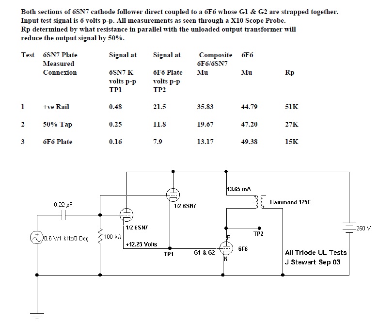

A good estimate of DF can be made using Rl / rp, so the 6N6G DF would be about 7/24 or ~0.29. Very much like a pentode without NFB. The final DF is a bit less due to OPT resistances, Etc.
A very good description of the 6B5 & the equivalent 6N6G is given on the 6B5 Triadyne data sheet. Plate curves very much like any common power pentode are given on p6 & p8. The plate resistance can be lowered to give better DF by connecting plates one & two together. But then there is less power as is the case when plate & screen of a pentode are connected together.
A bench tested example of a composite tube such as the 6B5 is attached. The 6B5/6N6G can be run in UL too.
