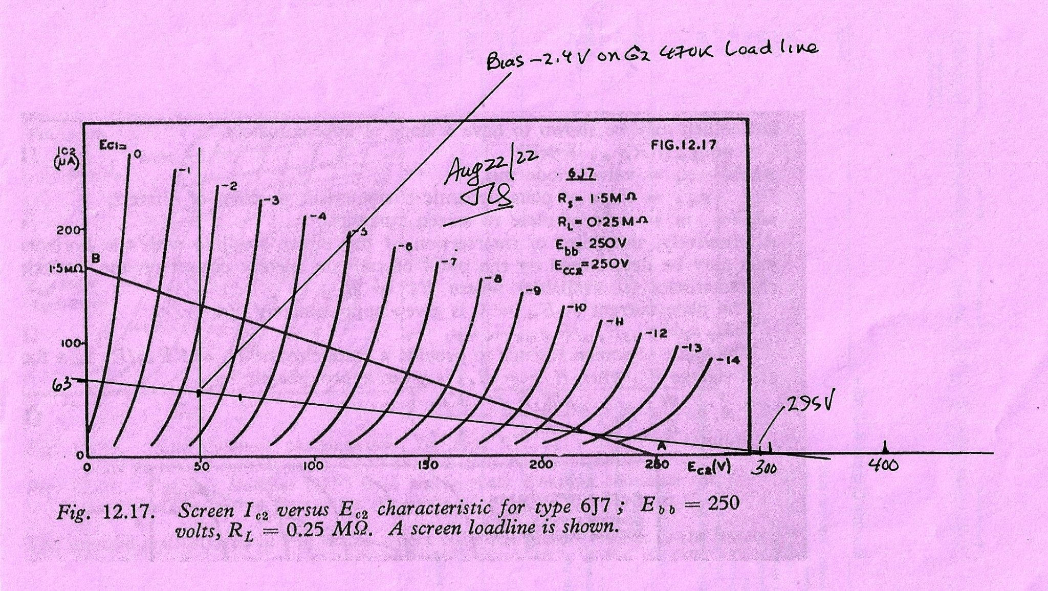

I made an error here, not sure why, the bias voltage should be 0.86 mA x 2K, that being 1.72V,
There is also one slide missing, I'll stuff that in later. 😱
So here is the slide missing from last nights entree. A plot of a 470K loadline on the 6C6/6J7 screen curves.
At the 2.4V bias reported in posts 31 & 39 the screen would be at 50V. The result puts the 75K loadline in
the steepest position possible while not shortening the possible voltage swing available. When the effect of
the following AC load of the 2A3 grid resister is about the limit.
A better condition would be Rl of 100K & Rg2 of 400K. 🙂
Also, if you're interested, you could touch on the topic of G1-G2 mu and the "inner triode" of a pentode.
Think I may have done some of the preliminary on that while looking at the G2 part of the design process.
I'll put something more formal together & post in a few daze. Kinda busy here with manual labor, gotta
limit time on DIY.

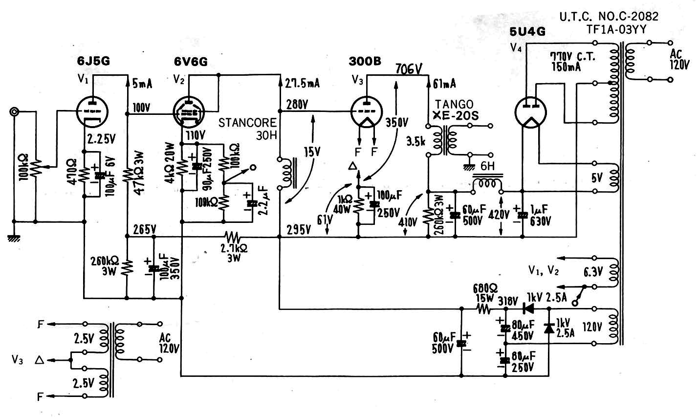

What about a 6v6 driving the 2a3? I ask because I've got some old engraved coke bottle sylvania begging for some electricity.
Yep, ~2k Rp, ~15mA will drive the 2A3 well.
3 stage DC amplifier well recieved for 30 years (attached), adjust for 2A3.
Note: some values on the schematic dont add up, but good for illustration.

This is the approach I considered. 12HL7 triode-connected driver, at 30 mA cathode current and 250 plate volts. Amplification factor is 30-40 (thanks to Smoking Amp for this recommendation). Samples of this tube selected on curve tracer may be very linear. The drawbacks are very high Gm (oscillation!) and driver's idle current half the output current. The advantages are possibility of using currently produced ITs and very low driver output impedance.

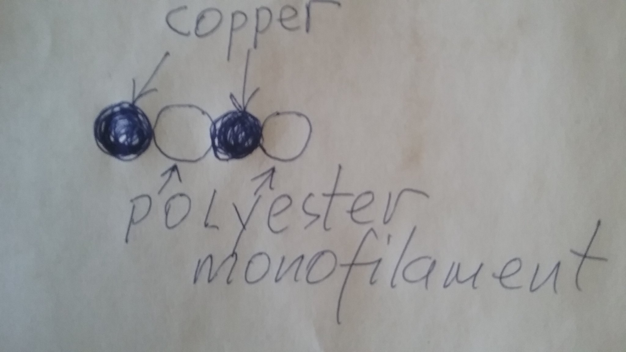

DIY interstage transformer
A good 1:1 interstage transformer is easy to make because it can be wound bifilar. One problem of bifilar transformer is high capacitance between primary and secondary. This can be reduced by spacing wires with polyester monofilament of the same diameter.
The thinnest available is 0.1 mm, so it can be used with 0.1 mm wire. Wind with 1 wire thick layers and place your favorite insulation (mine is Teflon film) between layers. Use your favorite type of core (mine is permalloy or amorphous). Core gap is adjusted for best compromise between inductance and DC current.
Another problem of a bifilar transformer is that it can be connected in only one way. Flipping secondary ends will result in severe degradation of high frequency response.

Nice idea for a 1:1 interstage transformer. But . . .
The wires are not as tightly coupled, the one major advantage of bifilar winding techniques.
And, as you properly mentioned, an audio bifilar transformer should never have the ends swapped.
As properly built, and used as intended you get the closest coupling between the primary and the secondary.
And . . . you get the capacitive coupling between bifilar primary and secondary.

With bifilar wires at 0.1 mm separation, magnetic coupling between windings is still almost as tight as with notmal 0.01 mm separation (two layers of wire enamel). Extra separation may add a few mH to leakage inductace, but that's nothing compared to leakage inductance of a non-bifilar transformer.

If you use a given wire size to make a bifilar transformer that Also includes a dielectric wire spacer, the transformer laminations will have to be bigger, and the wire length longer too (you do want the same inducance, right?
Not to mention that a small amount of air spacing between the bifilar wires of dielectric constant = 1, may not have a large winding to winding capacitance, but replacing air with a modern dielectric material like polyester monofilament that has a large dielectric constant much much greater (dielectric constant >> than air), the polyester might create as much or more wire to wire capacitance. Point of diminishing returns.
