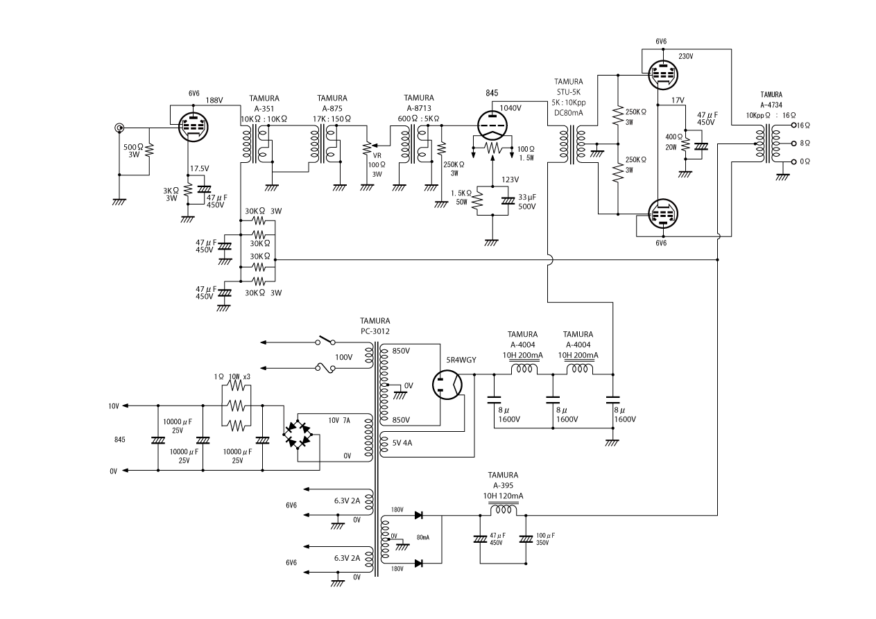

Isn't it funny that in some of his amplifiers Sakuma used two transformers back-to-back - because a single interstage transformed with required characteristics was not available? Like plate-to-line followed by line-to-grids.
He sure did like his Tamuras. I am also intrigued that he would sometimes put a rheostat on the low impedance end between his transformers, presumably for volume and possibly tone control. Also, and 845 in SE IT-coupled to a pair of 6V6? Gotta love that.
What I meant was that you need a certain level of quality in your reproduction chain for TVC to make a difference.I don't know about "hardly any difference" with a Slagle autoformer, which generally comes after the stage rather than before. Users report significantly better sound.
Using low value wirewound potentiometer as volume control makes sense to me, even if it requires back-to-back step-down and step-up transformers. One might ask why TVC is better than a traditional resistive attenuator. I think the answer could be lower thermal noise of low resistance, and more transparent quality of solid metal conductor compared to semiconductor or metallization films.He sure did like his Tamuras. I am also intrigued that he would sometimes put a rheostat on the low impedance end between his transformers, presumably for volume and possibly tone control. Also, and 845 in SE IT-coupled to a pair of 6V6? Gotta love that.
Driving 6V6 with 845 is totally nuts from traditional point of view, but maybe that's the famous chef's recipe for a perfect sound flavor?
The whole amplifier is nuts, 'Unique sound because no one in their right mind would ever build one the same'. So, then it is 'art'?.. okay, so let it be art.Driving 6V6 with 845 is totally nuts from traditional point of view, but maybe that's the famous chef's recipe for a perfect sound flavor?
Consider the output stage clips with 35Vp-p and the input tube has a voltage gain of 9.5. You could remove three interstage transformers, the DHT and its 1050V B supply, run the whole thing from 250VDC and to full output with less than 1.5vRMS input. And, if you display it in a restaurant as the result of 'trancending ego boundaries', you can still call it art ;-)

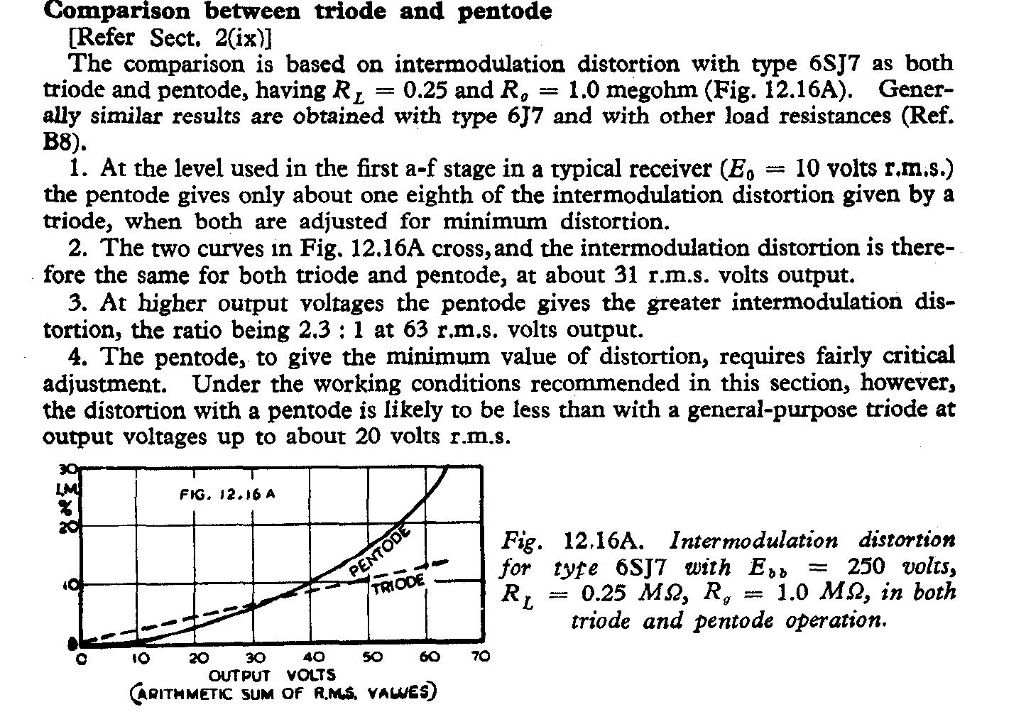

How about voltage amplification by pentode and applying about 16dB of GNF? If the idea of GNF goes against the grain one could always turn the penthode into a triode (like Tom Schlangen did with EF184 and ECL84 here http://www.audiodesignguide.com/New2A3/ETF06TS.pdf).
Good point & verified long ago as shewn in this piece lifted from RDH4. In this case the pentode connexion has betterHow about voltage amplification by pentode
distortion figures than the same tube as a triode up to 21 vrms. That would fully drive any power tube whose cathode bias is 30V.
At levels for normal listening the pentode driven output stage amp should perform better than it triode driven opposite.
The pentode sound thing may be something left over from the triode vs pentode sound debate resulting
from the daze of mass conversion of AM receivers to pentode output toobz. 😀
