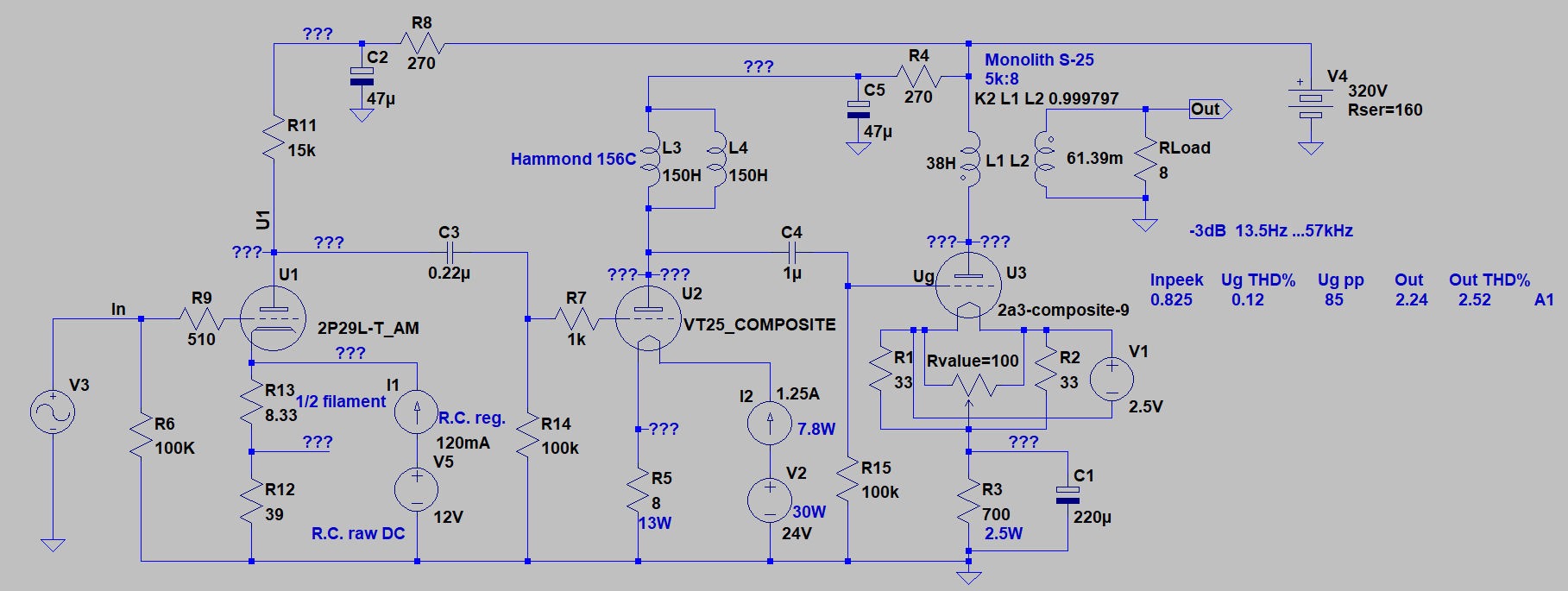

Do you thought to use 10Y as cathode follower?I could build a 3 stage 2a3 amp with 2P29L input and 10Y driver.
2P29L stage hasn't enough gain to drive 2A3.
??? I was talking about 3 gain stages. 2P29L > 10Y > 2a3. Or 10Y > 71A > 2a3 or whatever. All DHT. Very tedious to build all that, but as you know single DHT stages don't have enough gain by themselves.

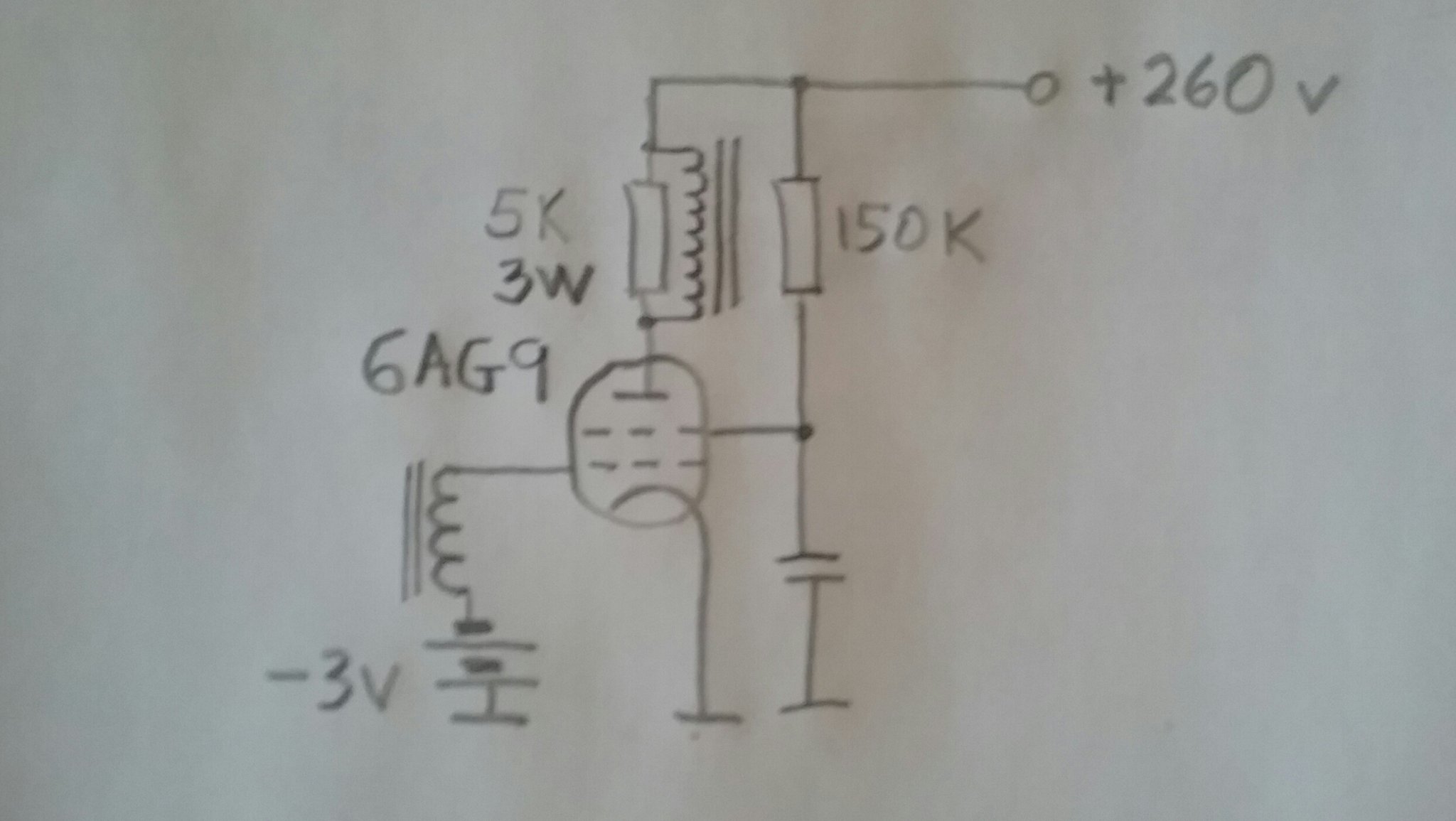

There is an interesting tube for those who would like to experiment with different types of drivers. 6AG9 is a 12-pin compactron that has high current pentode section and medium mu triode section. The schematic above is for the 2A3 driver using the pentode section of 6AG9. As shown, voltage gain is about 55 and bias current is about 8 mA. Only the primary of the 1:1 interstage transformer, and the secondary of input transformer are shown. Of course, the circuit can be modified for RC coupling, cathode bias, and no-transformer input. Screen decoupling capacitor of 0.1 uF is sufficient.
The triode section of 6AG9 is equivalent to paralleled-section 6A6/6N7. Very linear.
Dirt cheap tube.
Sorry, my bad in previous post. Screen resistor should be 62 K, not 150 K, with minimal value of bypass capacitor 0.25 uF. Should have double checked before posting.

What is the function of the 5K resistor?View attachment 1085516
For DC conditions it does very little (assuming interstage primary resistance about 1K ohm). For AC conditions it is swamping amplification and giving a steeper load, resulting in higher distortion.

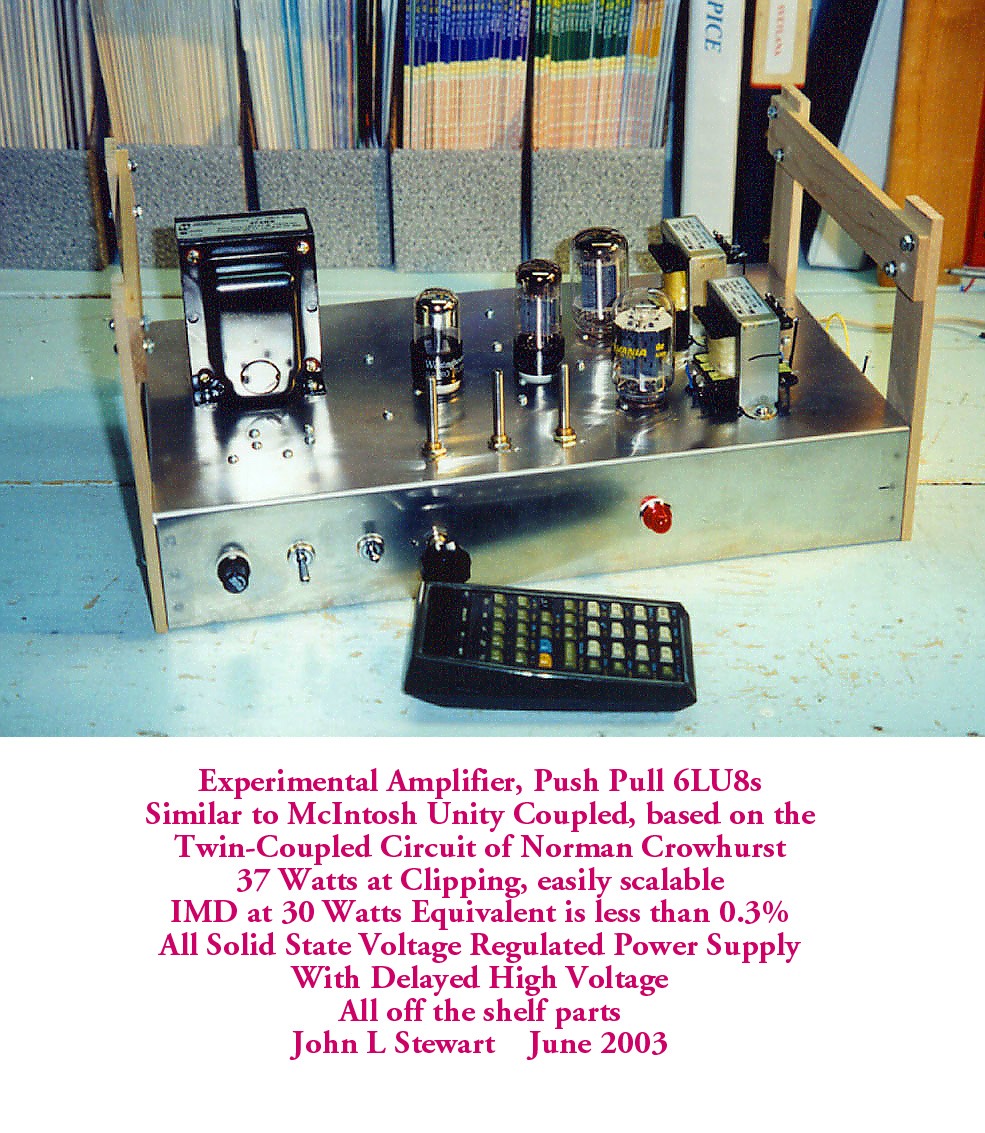

I did two projects using the 6LU8, a tube similar to the recommended 6AG9. One was PP 6LU8s in my take
of Crowhurst's Twin Coupled Amp. a poor mans version of a McIntosh UC circuit. It worked very well,
with 400V of B+ it clips at ~35 watts, And very good numbers for both THD & IMD..
The other is an SET or SEUL thing, that was OK too. While developing the amps I tried the 6LU8 in
SE Pentode, the results were so poor I didn't use the data as part of the final article,
Based on that observation the 6AG9 may not be a good choice as a driver,
Both articles were published in Glass Audio/AudioXpress. 😀

Indeed, DC is determined by resistance of transformer's primary. This way plate voltage is maximized (better utilization of B+). For AC, transformer is out of the way, so plate load is determined almost entirely by the resistor.What is the function of the 5K resistor?
Keeping resistor value low allows the use of commercially available interstage transformers.

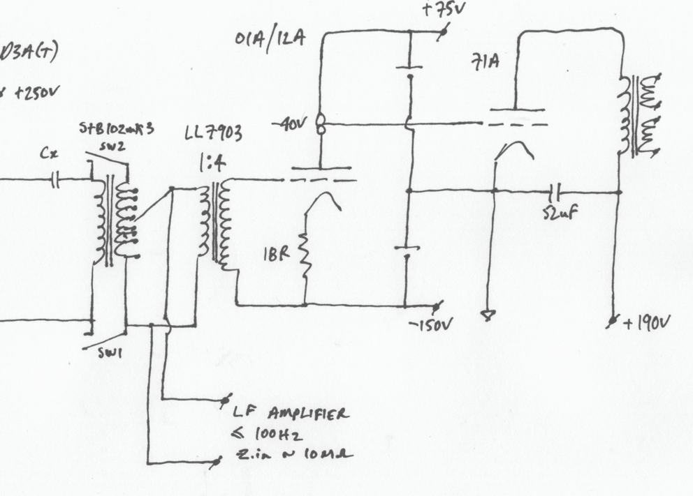

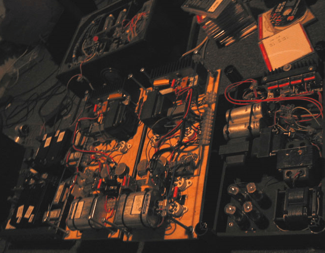

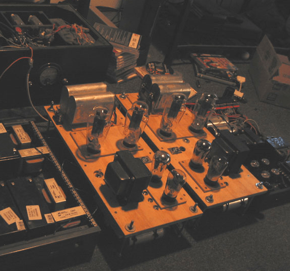

This was my 01A > 71A > PP 2A3 with Buds IT and OPT, which ultimately became PSE 2A3 with UBT-1 OPT (3 stage DC) before being 'decomissioned'. With heating complexities, I was with a 45V 250mA CCS regulated supply and series heated the input and driver, then moved to SLA batteries to acccomodate a slightly different front end with 1:4 input (LL7903) and split rail supply.Or 10Y > 71A > 2a3 or whatever. All DHT. Very tedious to build all that, but as you know single DHT stages don't have enough gain by themselves.
