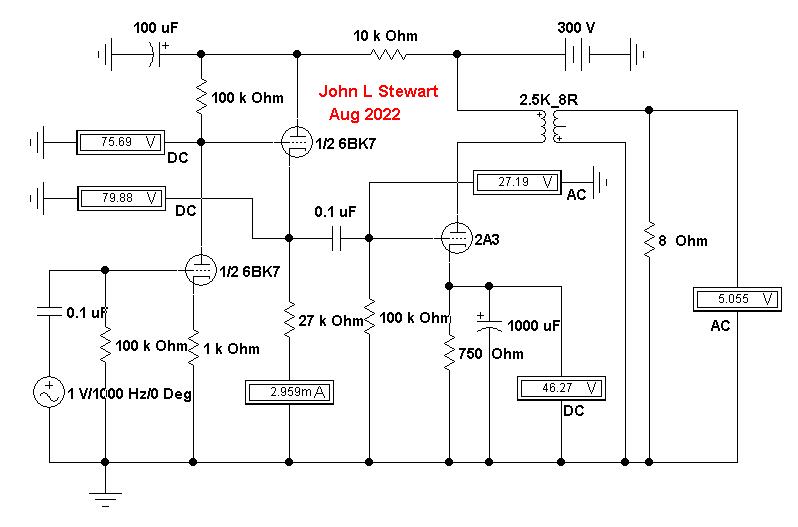

Another Alternative. First Pass.
One volt at the input drives the 2A3 to clipping. 👍

I am struggling to understand it. The first stage seems to operate at a very non-linear low voltage low current region for this type of tube. Why not running it at its recommended high current? Plate resistance would be low enough to make the cathode follower unnecessary. Then, on top of it, this isn't exactly one of the most linear triodes.
If additional CF stage is considered, a pentode driver can be very substantially improved. Like E80F/C.F. driver with less than 0.2 Vrms in and less than 1% driver THD at 2A3 clipping.
As the short note sez, it is a first pass. The first stage plate current is 1.77 mA. In this sim I’m simply looking at cct voltage & current levels.
The finale version was to be a small pentode triode. There are a few suitable, for example the 6AN8 or 6U8. I rejected several others since the Pd of their triodes was not high enough to support the high current of the CF.

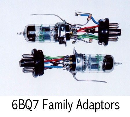

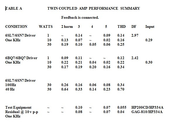

Many underestimate the performance of these meant for TV & FM tubes. While doing the performance tests on my take of Crowhurst’s Twin Coupled Amp I put together two adapters for the amp front end, a two stage differential amplifier. The 6SL7 & 6SN7 were replaced with 6BQ7’s. The measured performance is much better than most would have thought. Primarily because they heard what others were saying but never tried to check the results themselves. The distortion measurements were taken by a PicoTech virtual instrument & an HP 334A THD meter.
