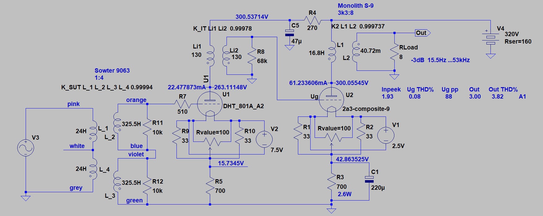

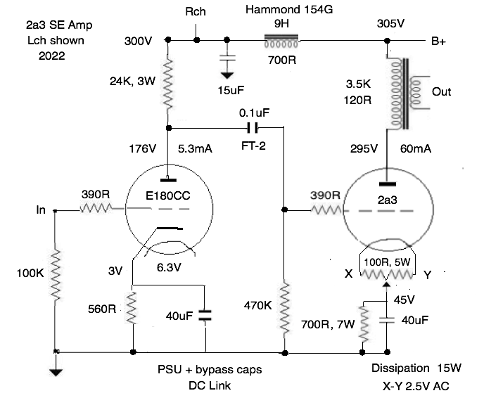

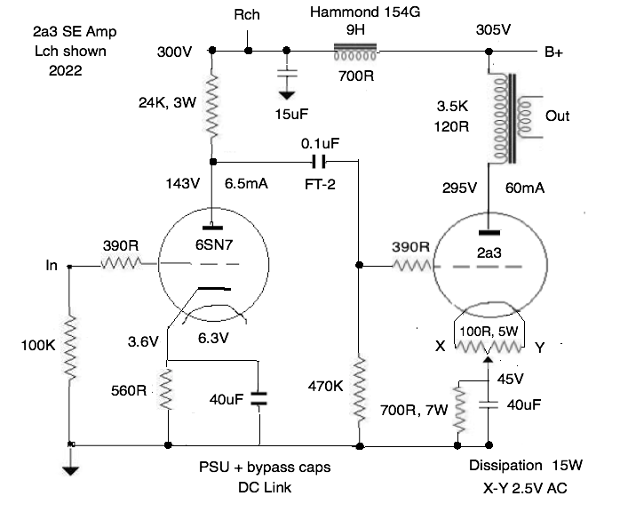

Here's a very simple circuit which sounds good to me. I put in 2 sockets - one octal and one 9 pin and the same circuit works for 6SN7 and E180CC depending how much gain you need in the first stage.
Low -3 dB point of IT in this circuit is 25-28 Hz. The transformer-coupled 57 will present 40 K impedance to 2A3 grid, not 100 K.
Input transformer has other benefits: isolation from ground loops, possibility of balanced input allowing longer interconnect, and possibility to tweak overall gain.
The best bias for 2A3 is also from permanently wired battery. Six 9 V batteries. BTW, I am not claiming that this is capacitor-free design. Last filter capacitor is in the signal path in any SE amplifier.
Yes, I'm well aware of turns ratio squared as the multiplier for drive impedance; 100,000 ohm was a colloquial expression - it may as well be 100k.
Consider a 2k Rp type driver with mu 50+ that can operate into 1:1 IT.. you have better LF, HF, a less compromised transformer (build), and 20 times lower drive impedance, ie. 2k ohm.
1:4 input and 2:1 interstage would be much better, depending on other things which are not considered like the source to the amplifier, but also unneccesary, I dont see the advantage (in any meaningful way) of an input or interstage transformer when you need only need 90vp-p for full output at the 2A3 grid.
This is the approach I considered. 12HL7 triode-connected driver, at 30 mA cathode current and 250 plate volts. Amplification factor is 30-40 (thanks to Smoking Amp for this recommendation). Samples of this tube selected on curve tracer may be very linear. The drawbacks are very high Gm (oscillation!) and driver's idle current half the output current. The advantages are possibility of using currently produced ITs and very low driver output impedance.
High current drivers for DHTs have been advocated by such eminent designers as Sakuma and Olson. However, I believe that 30 mA driver for 2A3 is a bit of overkill. Whether it will result in better sound comparing to lower current drivers should be determined experimentally.

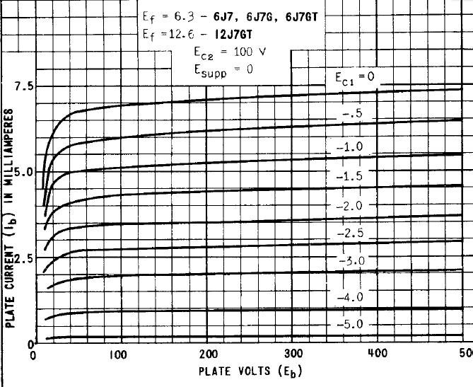

There isn’t much data available covering the 6C6. With the exception of the inter electrode capacities all the 6J7 data can be used for design. The most comprehensive set of data I was able to find was published in 1945 by AWG (Amalgamated Wireless Valve of Australia), all attached here. Another good source is published in RDH4.

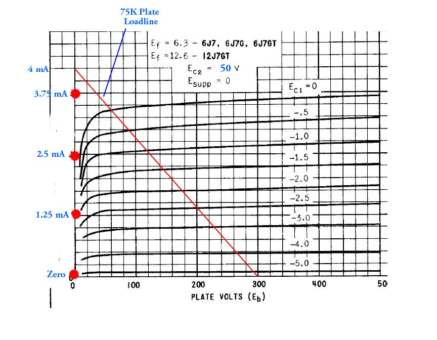

Referring to Post #12 the calcs shew plate current to be 0.7 mA, the screen current is 0.16 mA so the total cathode current would be 0.86 mA. And across the Rk of 2K that would be 1.47V. Reasonably close to the measured value of 1.7V.
OTOH in Posts #31 & 39, the screen voltage is measured at 86V while a plot of the 6J7 screen 470K loadline shews the screen voltage would be less than 50V. That is too large a difference to ignore. There appears to be an error.

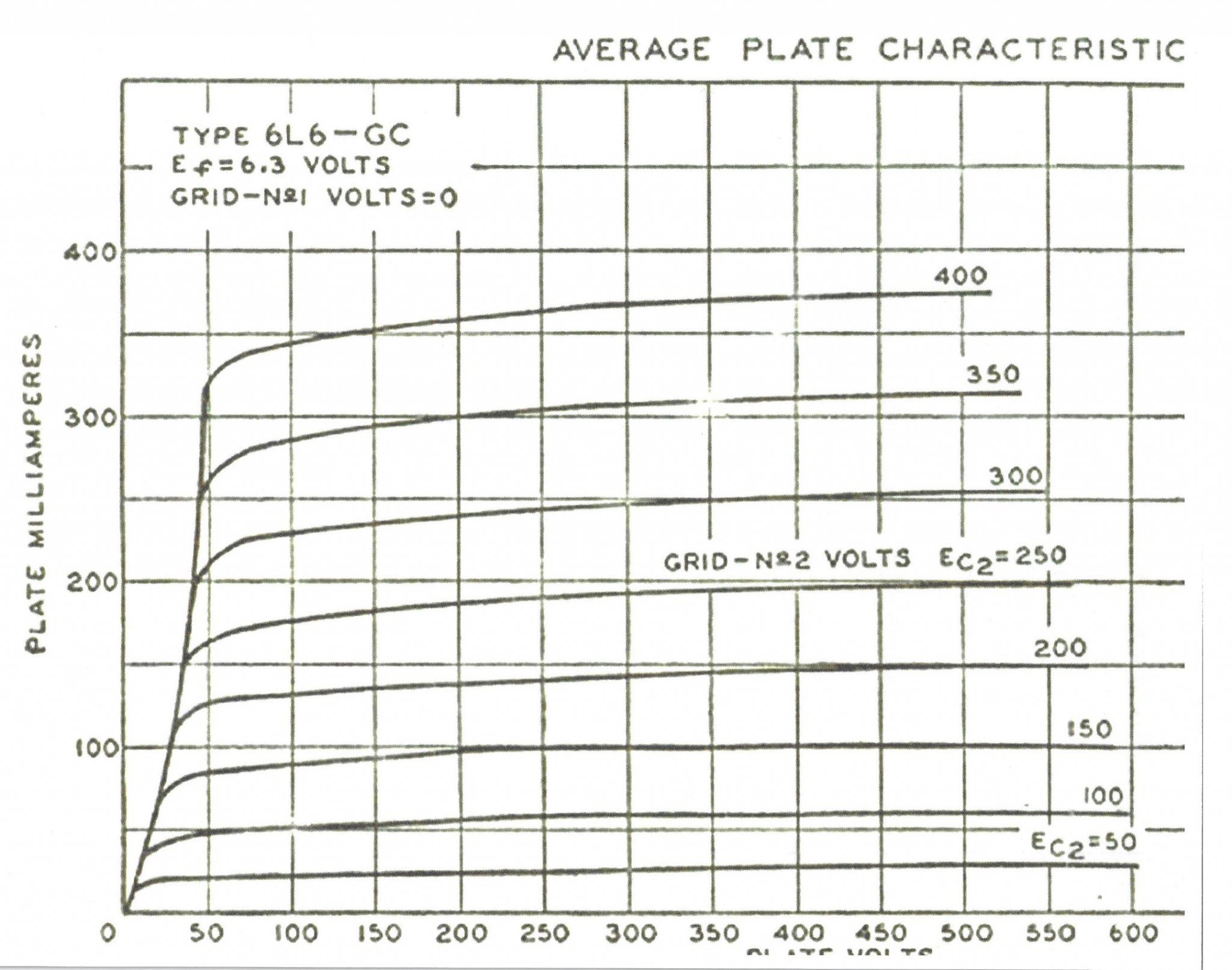

Many experimenters don’t realize the pentode plate family of curves is very dependent on the screen voltage applied. That holds no matter whether the tube is a voltage or power amplifier. Unfortunately there is very little data of that kind published for pentode voltage amplifier tubes. But there is quite a bit covering power & beam tubes. A typical example on the 6L6GC can be found in some data sheets. The plate family of curves inflates to the line where grid one is a zero volts.
For voltage amplifier tubes the relation is close enough to linear to allow an estimate of the plate family when operated at a screen voltage other than what is published. If the screen voltage is halved the plate family of curves collapses’ to about ½ the current at normal voltage. Care must be taken, too steep a loadline will go thru the top of the plate family.
For sharp cutoff pentodes used as voltage amplifiers a method often used to decide on a screen resister value makes use of the ratio of plate to screen current at the same or similar voltage. For the 6C6/6J7 that is 4:1. The ratio of the plate to screen resistors then becomes 4:1. If the plate resistor is 75K as it is here the screen resistor would be 300K. Then use an Rk that sets the operating point somewhere on the plate voltage that will adequately drive the output tube. 🙂 👍
