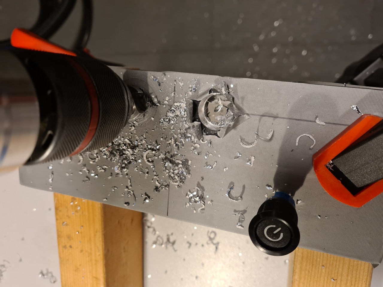

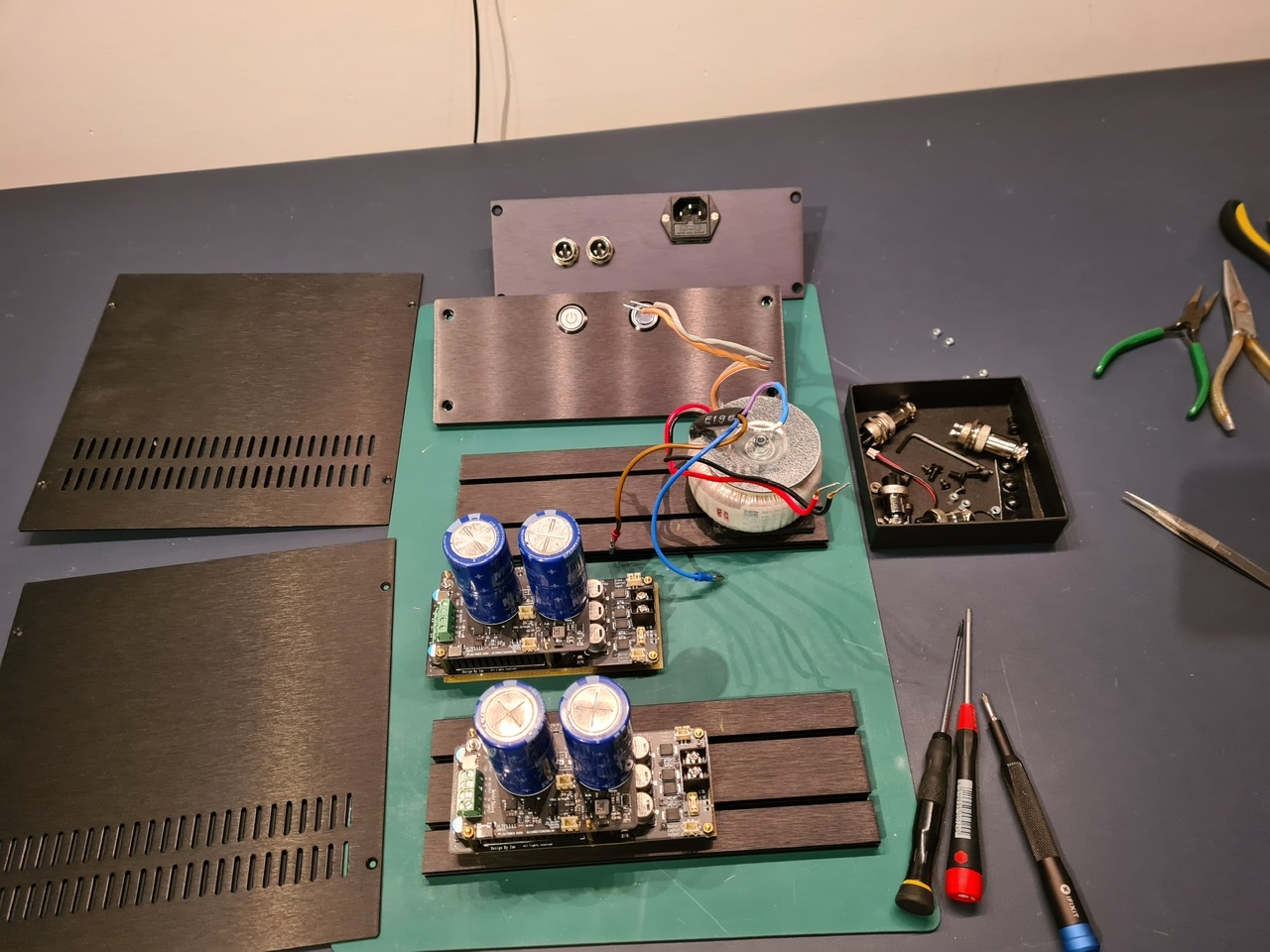

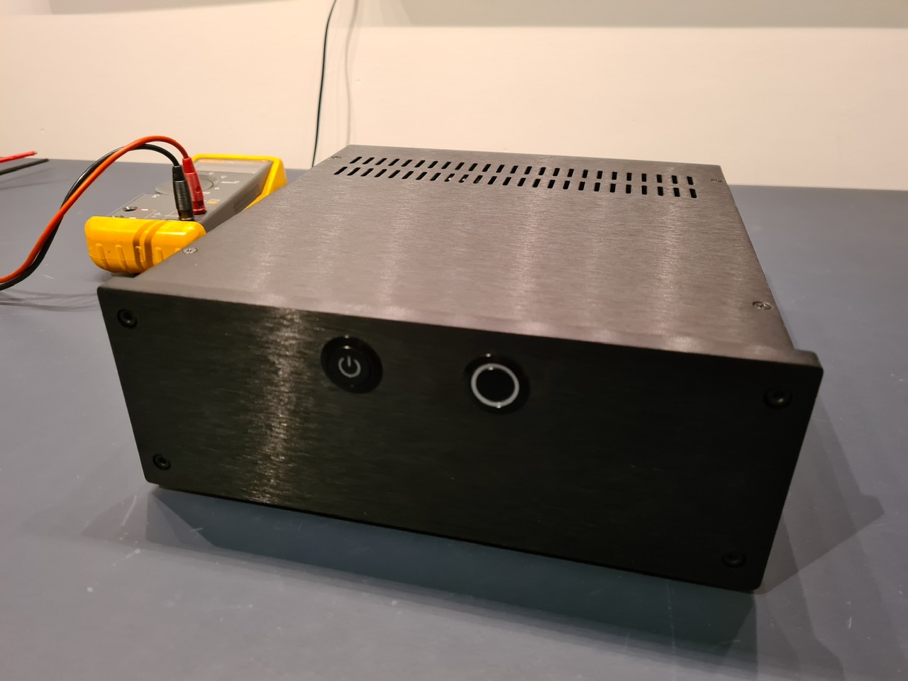

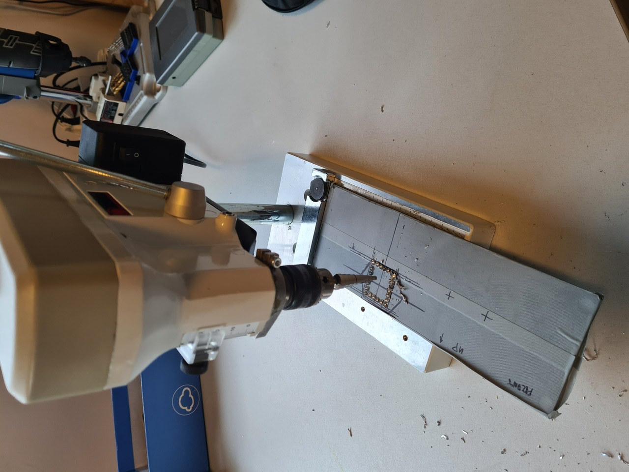

Nice boxed linearpi with UcConditioner
I finally got around to building my linearpi and UcConditioner in a nice box.
It is currently switched as 10v output but can be split into 2x 5v. With an extra output connector.

Supersurfer that came out quite nice, I was looking at casing my hairball up and was looking at some rectangular aluminum extrusion. I was also wandering about filtering EMI before the transformer and was thinking the power entry modules were not up the load will have to ck them out again. Also I am building a piconditioner and was wandering if I should glue the caps the the circuit board?
Bill

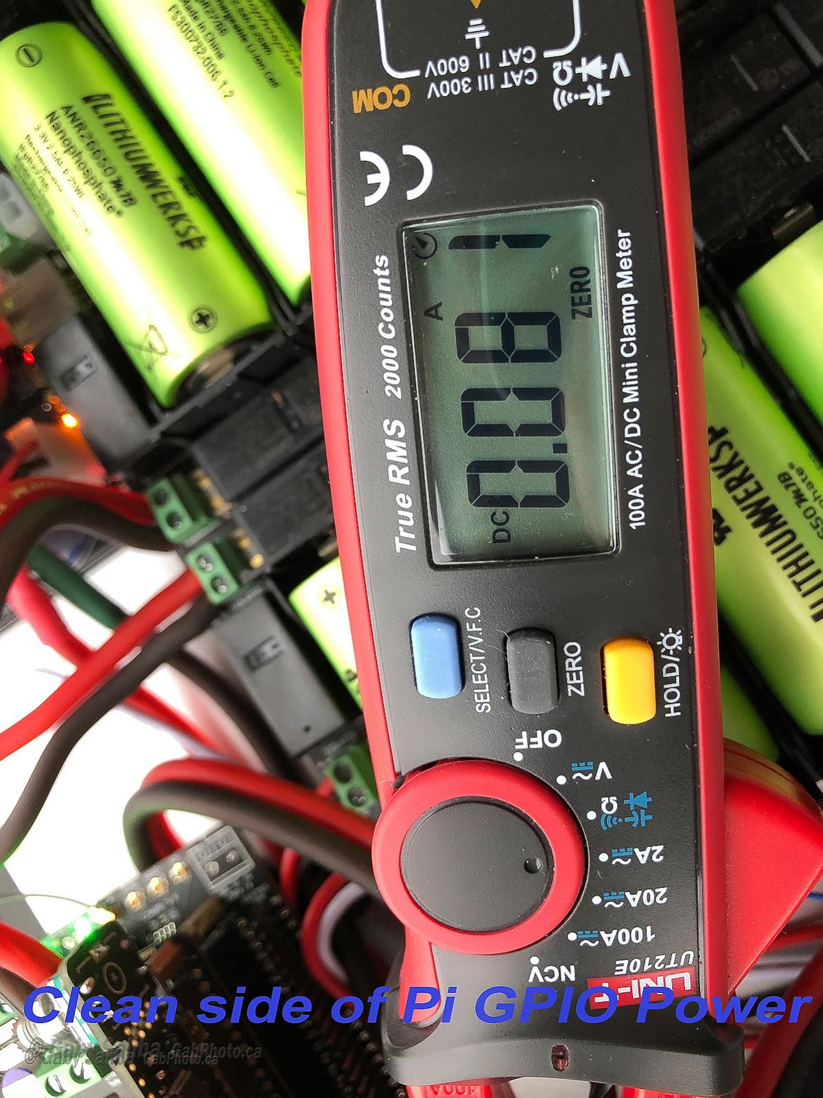

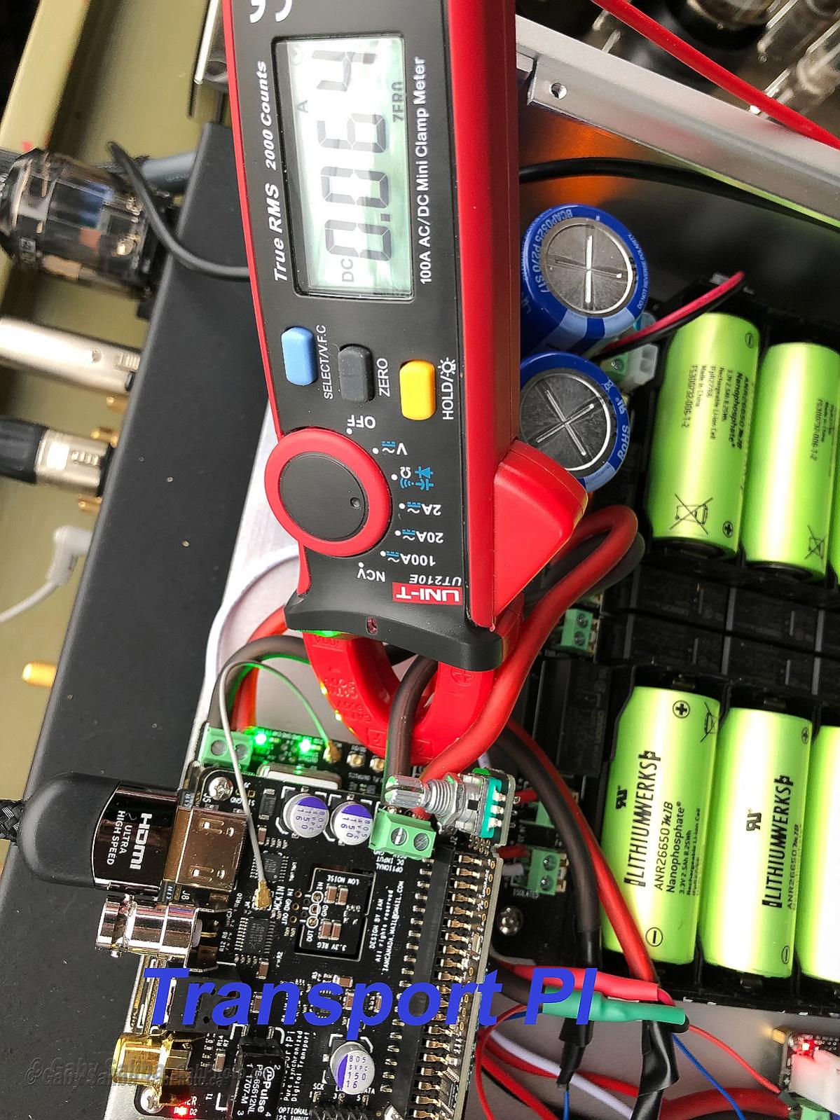

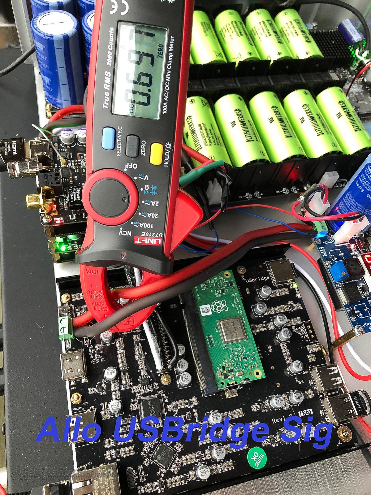

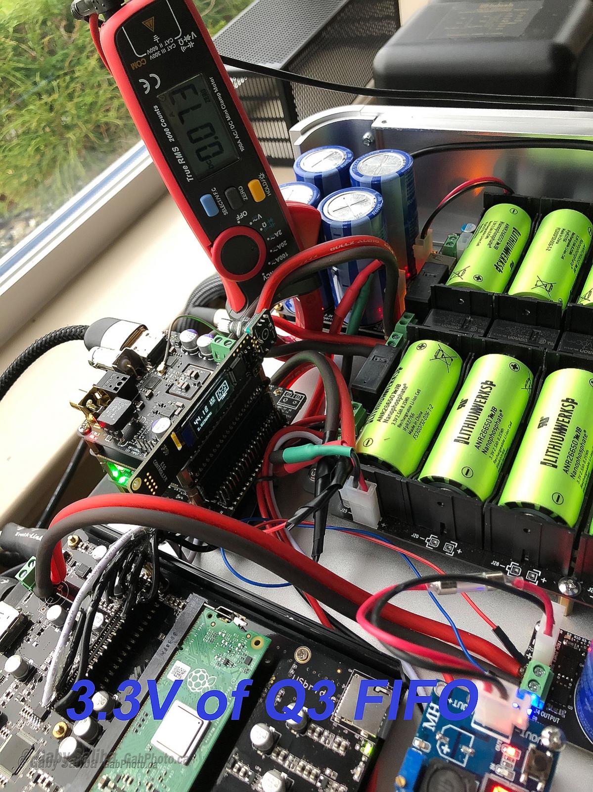

[Does anyone know what the power consumption is of the 3.3V connection on the FifoPi Q3?]
I took some measurements of various parts in my system and attached photos of the results hope that helps.
