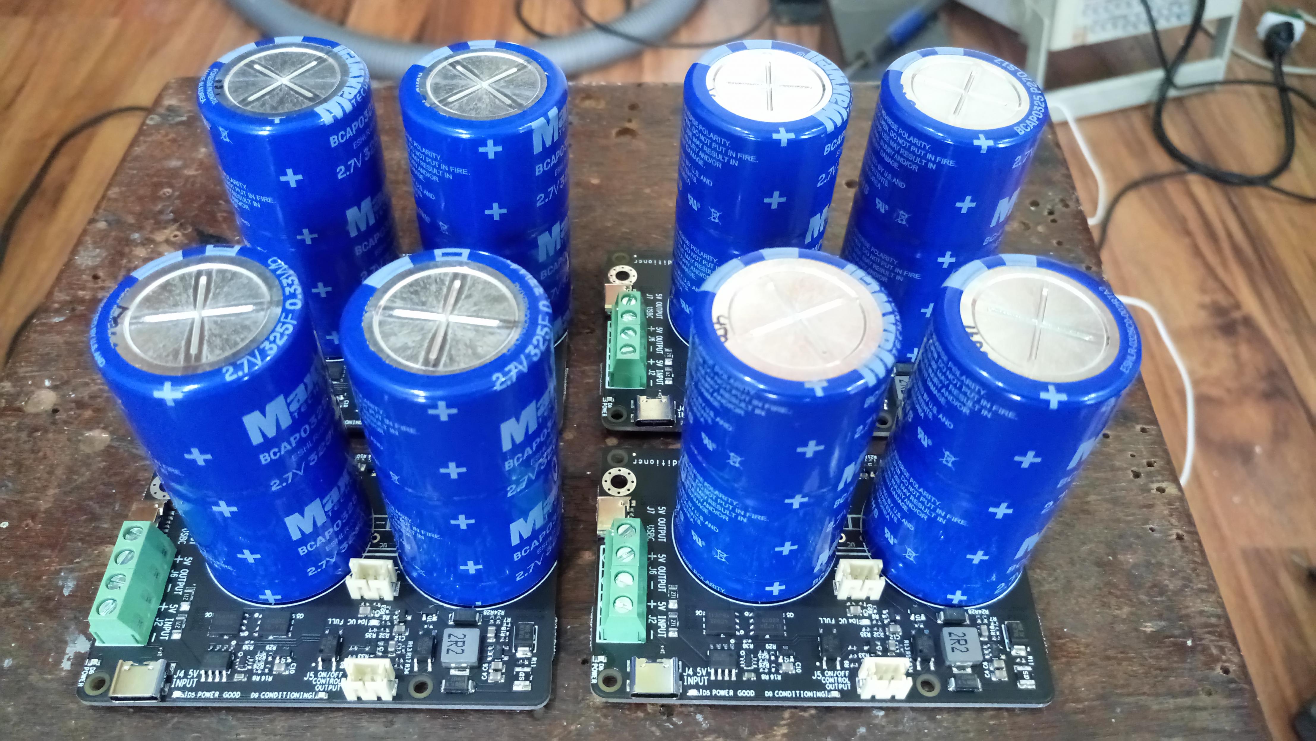

Ian isn’t the only one who have discovered the positive effect supercapacitors have in a well designed power supply.
Especially in the lower frequencies it’s easy to hear that supercaps has an advantage over standard caps.
That’s nice but does not really impress us. It is only 2F against 325F for one supercapacitor on Ians boards.
The Allo Shanti and Farad 3 ( Farad Power Supplies )
power supplies also use small supercaps in the range of a few F.
The difference with the big 325F caps is that these have a much lower ESR.
I use a UcConditioner on the output of my Shanty PS

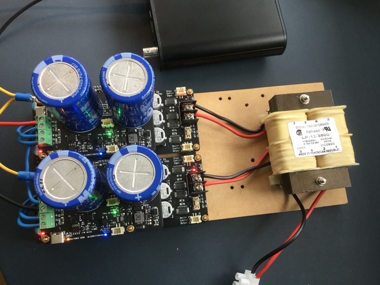

Need help !!
I have two 5v Ucconditioner board that I want to connect in series to get 10v on output, but the conditioners suck the life out of my two doede dac psu’s which is rated 1A each, is this simply not enough current, or am I missing something ?
No problem with 5v input on each conditioner separatly.
Need help !!

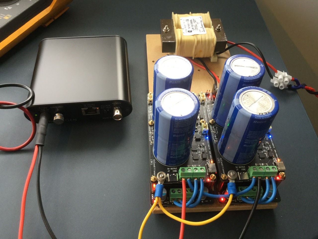

You cannot connect then in series to a 10v input. They need to be fed separately with galvanic isolated 5v power supplies and than you can connect the output in series for 10v.
I did it like this:
