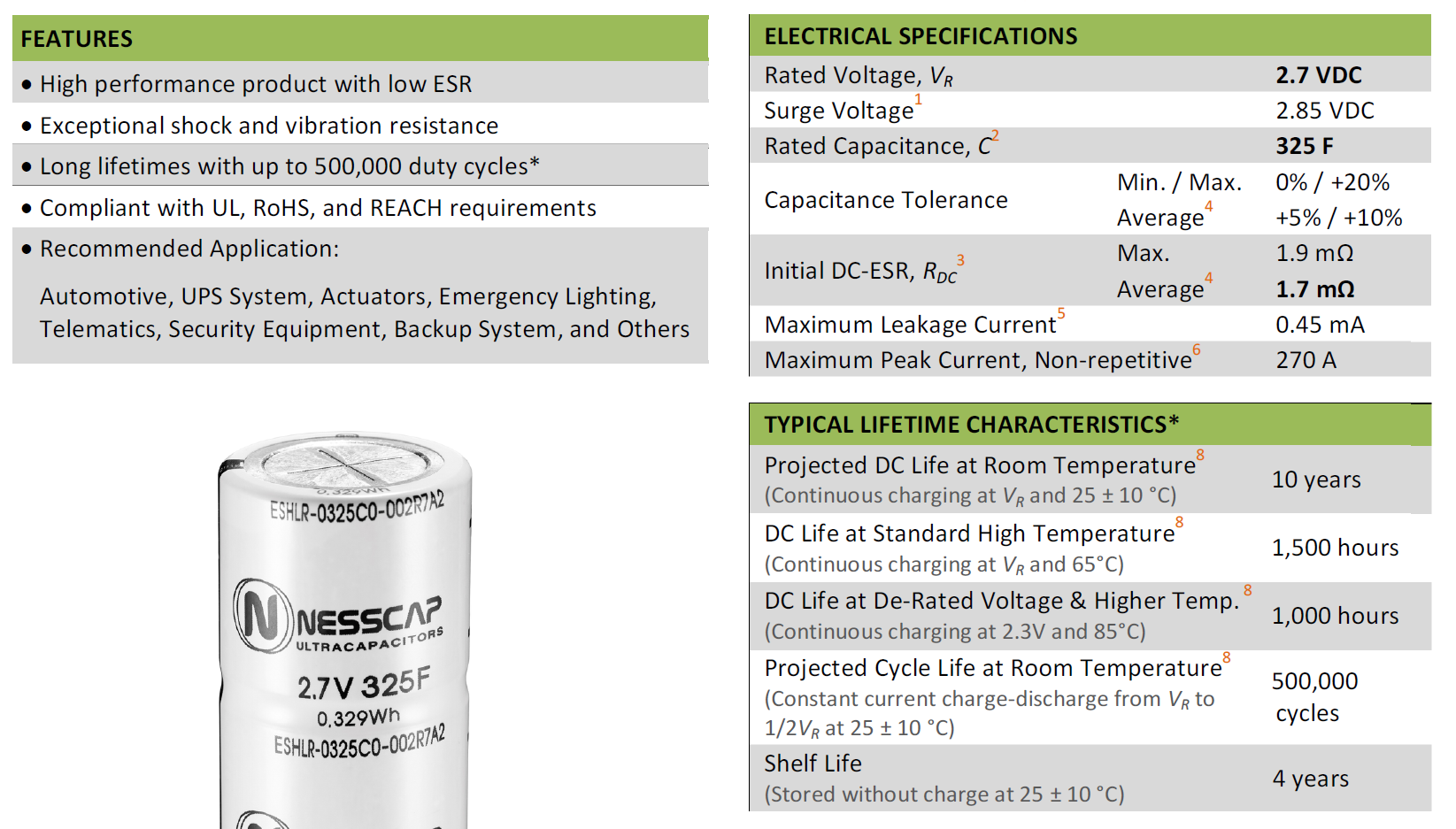

Both ultra capacitor power supply and LiFePO4 power supply are passive power source. They are totally different to all kinds of regulators which are based on feedback. The most important thing is the perfect load response, much better than any regulator.
Both of them are ideal solution for DAC projects with amazing sound quality. Ulara capacitor power supply is a little bit better but the difference is minor. However the LiFePO4 power supply would be cheaper and easy to integrate into a all in one solution.

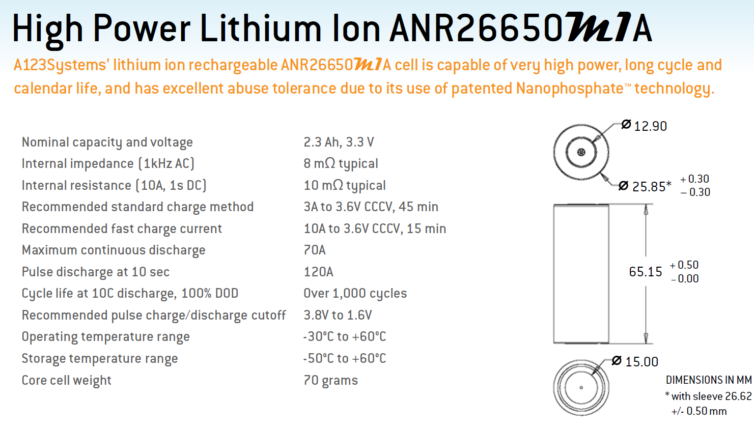

When power is turned on, all the output rails will be pure LifePo4 battery rail and will be also 100% isolated from each other. I don't want to do anything to degrade the quality of the battery power supply. When it's turned off, all batteries will be charged by a CC-CV charger automatically. The charging progress will be managed and with monitoring.

Ten batteries run around $150. For how many charging cycles will they last?
@rayma
I have a LifePO4 battery cell which started 4 years ago, for my daily use, still powerful by now. It should have been recharged for more than 400 times if I do it every 3 days. I really love this battery. Much better than any other chemical.
BTW, specification says 1000 times.

Rayma,
I've had the same experience as Ian over about the same period of time. I use two cells, one to recharge while the other is in place, so each has about half the use (until one of them, harboring an undisclosed suicide wish, became involved in a brief but spectacular welding incident).

Hi Ian. How do you intend to do the switching between the ultracap banks? Relays?
Great projects as always, cannot wait![]()
@analog_sa
To switch between ultra capacitor banks, relays would have better isolation performance. However, they are a bit noisy, even to switch them every 5 to 10 minutes.
MOSFETs don't have this kind of problem, but they have small leak capacitance around tens of pF. This number could be still reduced by half if to switch both ground and power rail at same time.
MOSFET solution could also be complicated but more flexible.
It's really hard to decide
